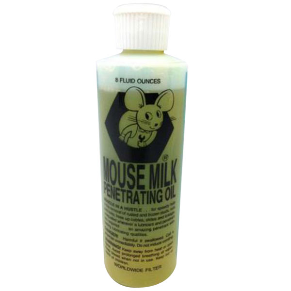

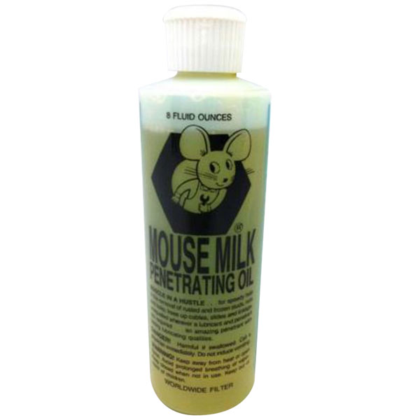

My only suggestion without using a watchmaker would be use penetrating oil (mouse milk if you can get your hands on it) let it soak for awhile then use a tooth brush to work it out and remove the corrosion.
If its from a female mouse I suppose you could give it a go. I don’t think male mouse milk is worth the effort.
640
2,892
😗 Does take awhile to milk the bastards!
I waited for this reply. But serious it’s amazing shit. I use it on aircrafts all the time to free up the most impossible stuck crap.
782
1,387
Learn something new, every day.

The lug was soaked in WD40 over the weekend. I suspect that other substances, such as the penetrating oil that was suggested, might have been even better but this was to hand for a first attempt and has done the job.
