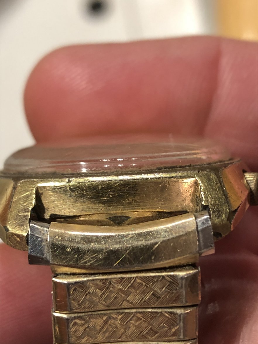

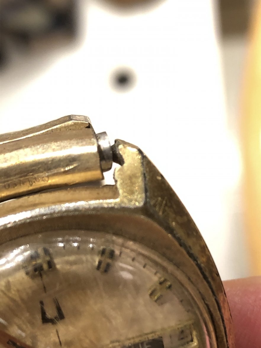

151
131

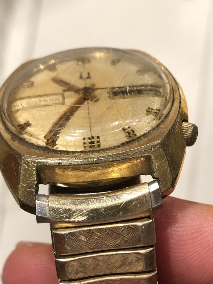

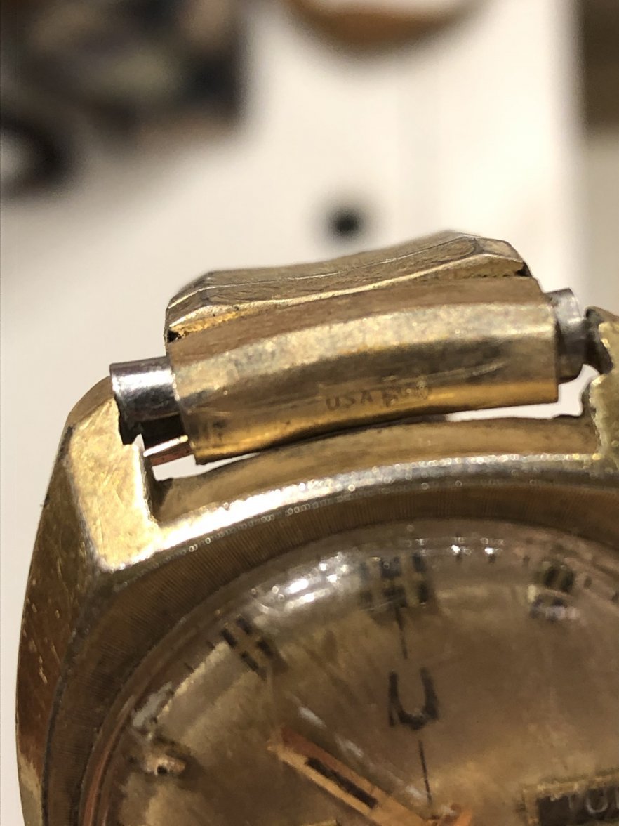

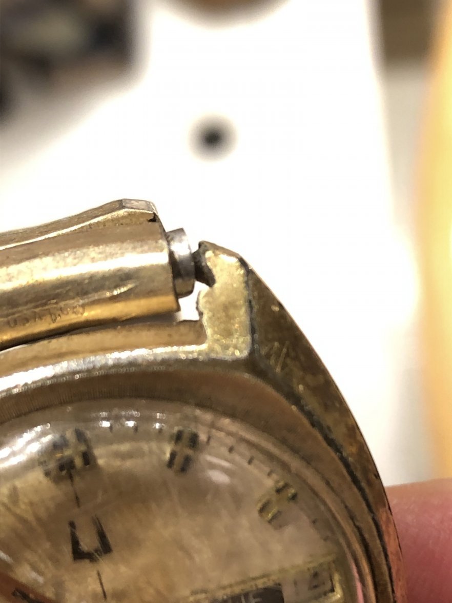

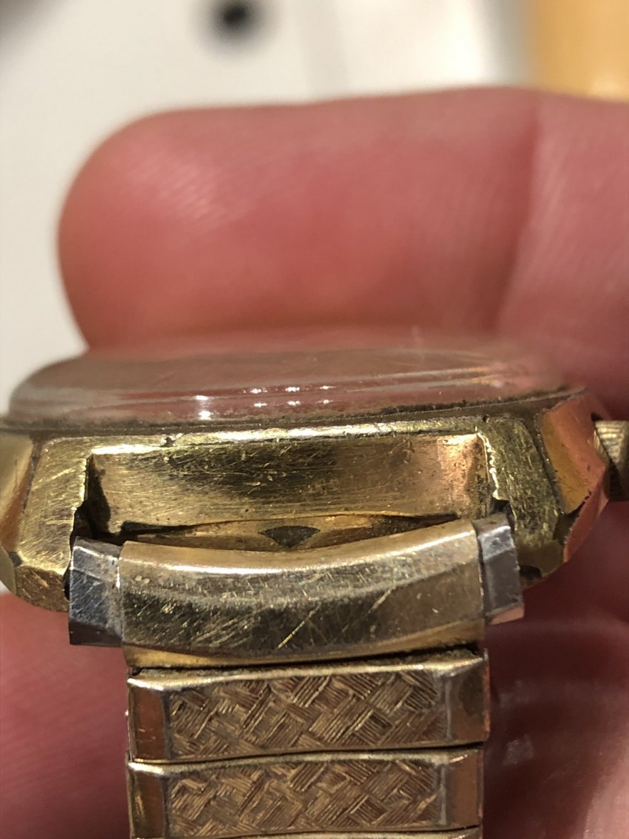

The question occurred to me because I stumbled on some threads about lug hole wear and laser welding repair.
7,335
23,772

My straps hold my regular spring bars in so tightly that I think the effect would be similar to the quick release bars. I’ve seen mild wear after many years of use, even by stainless bars on a gold case, but nothing significant. There might be even less wear of the bracelet set up, as the bar is sort of stationary in the lug holes, and depending on the type of end-piece, it may just minutely pivot around the bar.
I think that’s got to be from decades of use and grit and funk getting in there. Small particulates (like sand, skin- other nasty shit) gets into any moving parts and acts as an aggregate over time..we are talking decades of daily use. Keeping you stuff clean (semi-annual bracelet cleaning) is the best bet.
Spring loaded endlinks on flexi bracelets from the 60’s/70’s however are an entirely different matter.
18,319
27,673
