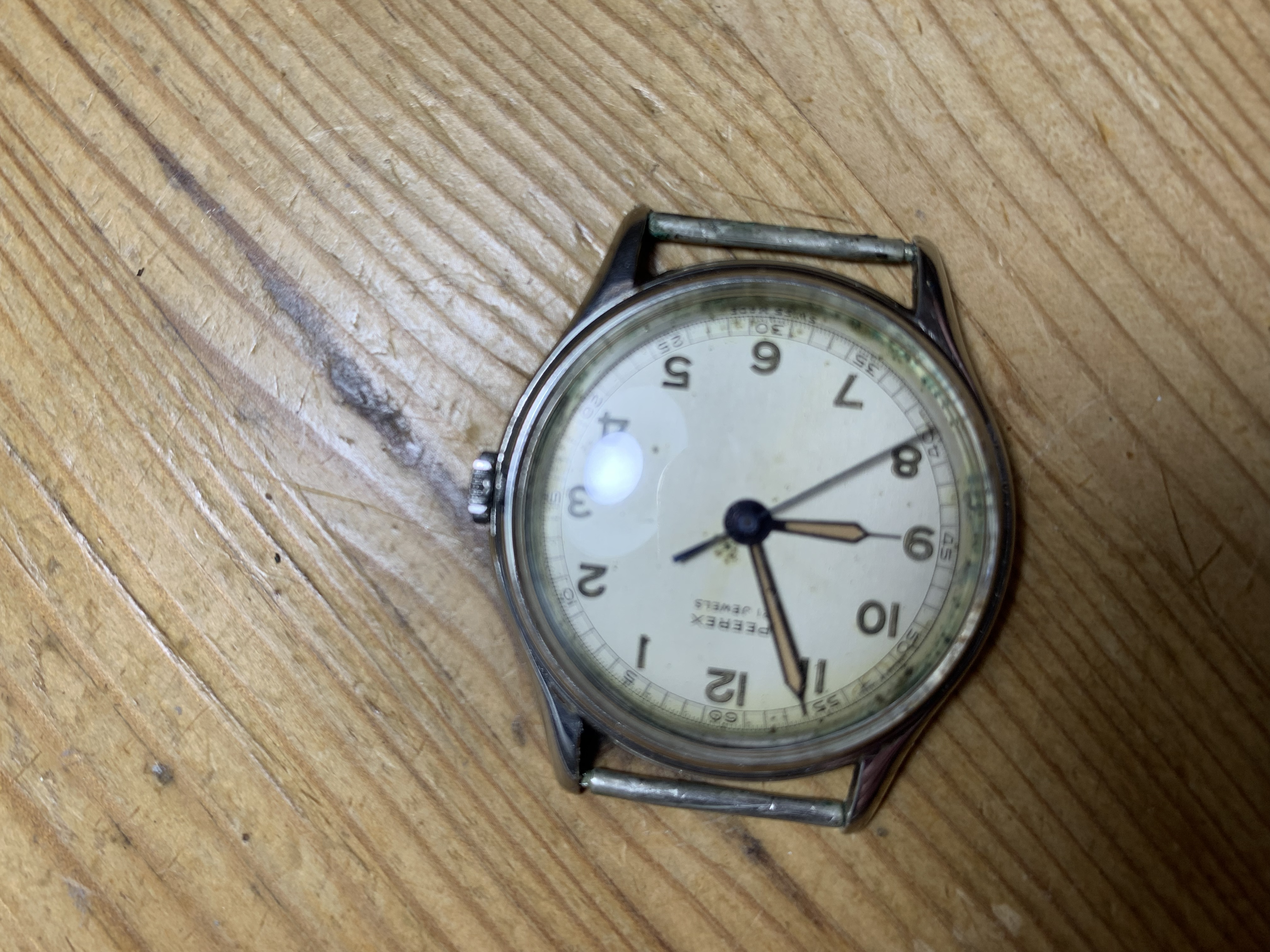

I have just bought an early Perex and want to fit it onto a Bonklip band I recently obtained. The watch had a broken Comfortflex which I bent to remove as I could not get the spring bars off.
As you can see below there is very little room to move, the bars rotate so must come off? Should I snip them and replace or leave well alone and 'bend' the Bonklip on?

it can be removed. apply signal oil and try to remove some gunk.
2,681
3,161
If there's no steel bracelet, just get 2 nose pliers and bend the bars slowly inwards, but it's still a good idea to oil beforehand because sometimes the pins fuse into the case, if one breaks inside it's a harder task

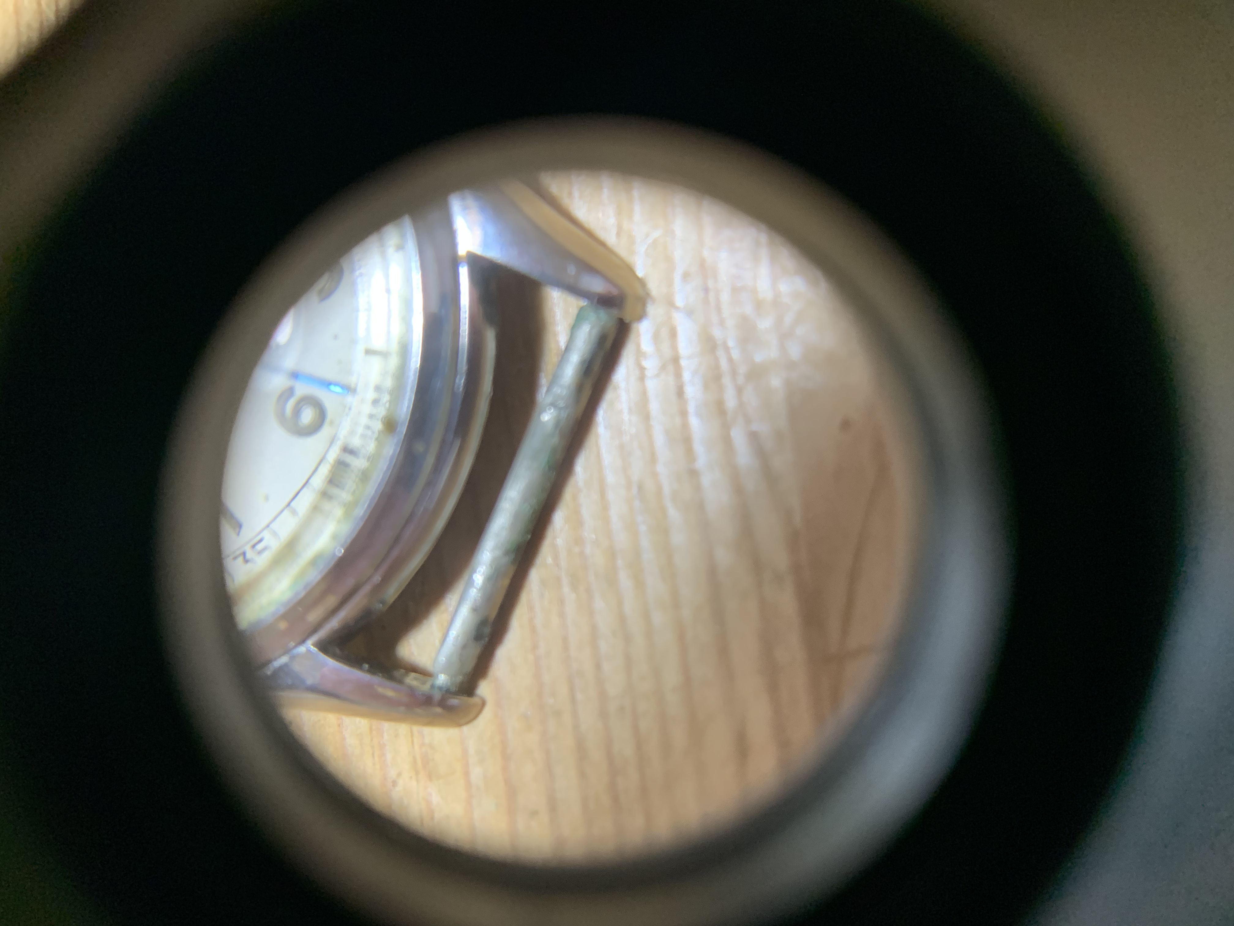

Looking at the lower lug in the pic taken under the magnifying glass I'd almost think it might be a female bar with pins on the lugs.

Male, but I have no idea how they were squeezed in!
Easy to put in… but these made for drilled lugs are almost impossible to remove without cutting.

Not knowing the history of those spring-bars, I would remove them and install some good new ones. If necessary, I would cut them.
8,743
69,528
Cut them & get new ones.
Leaving those old corroded springbars on the watch is asking for trouble.

Thanks all, used a cutter and removed them with no problems. I then cleaned and put in new ones, AOK.
