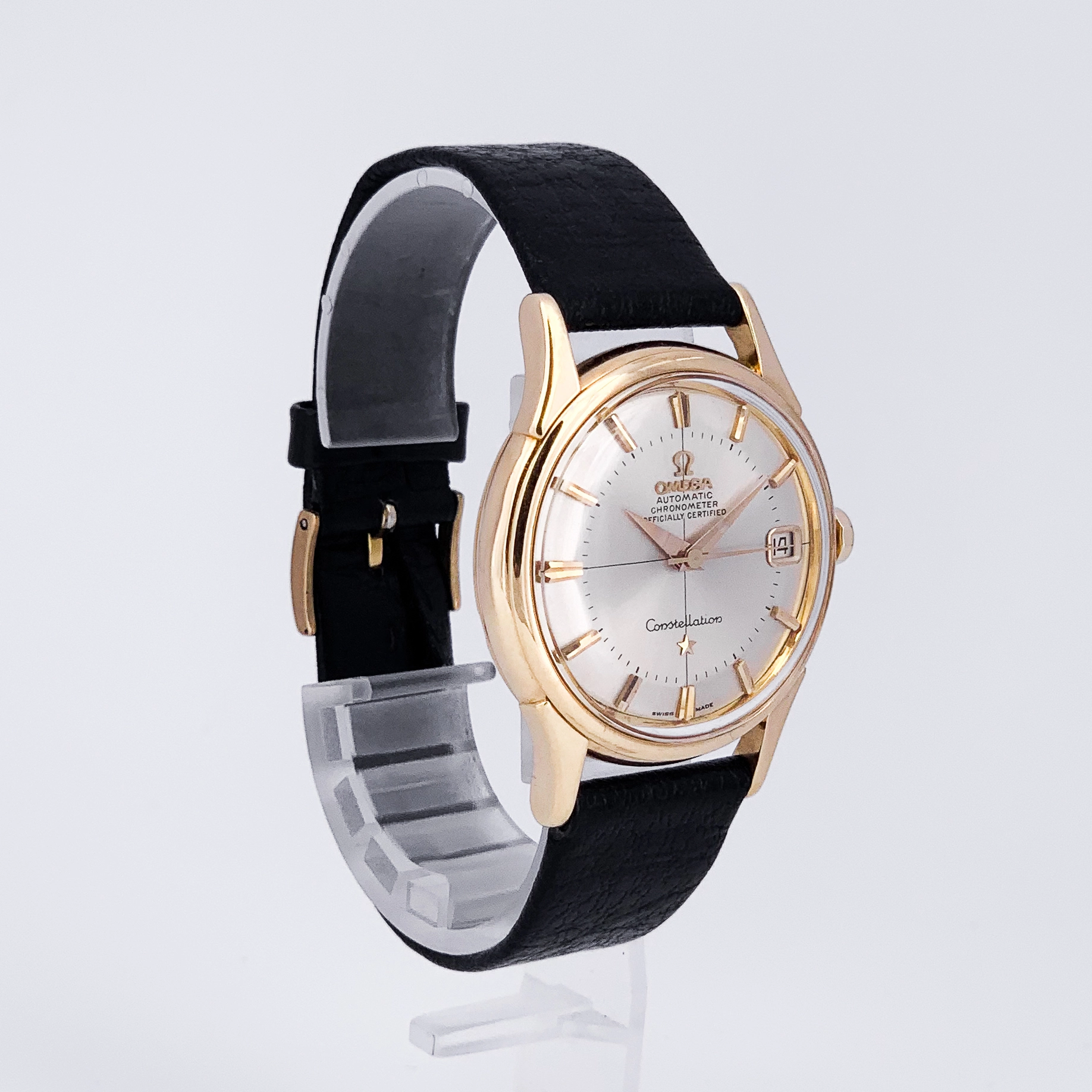

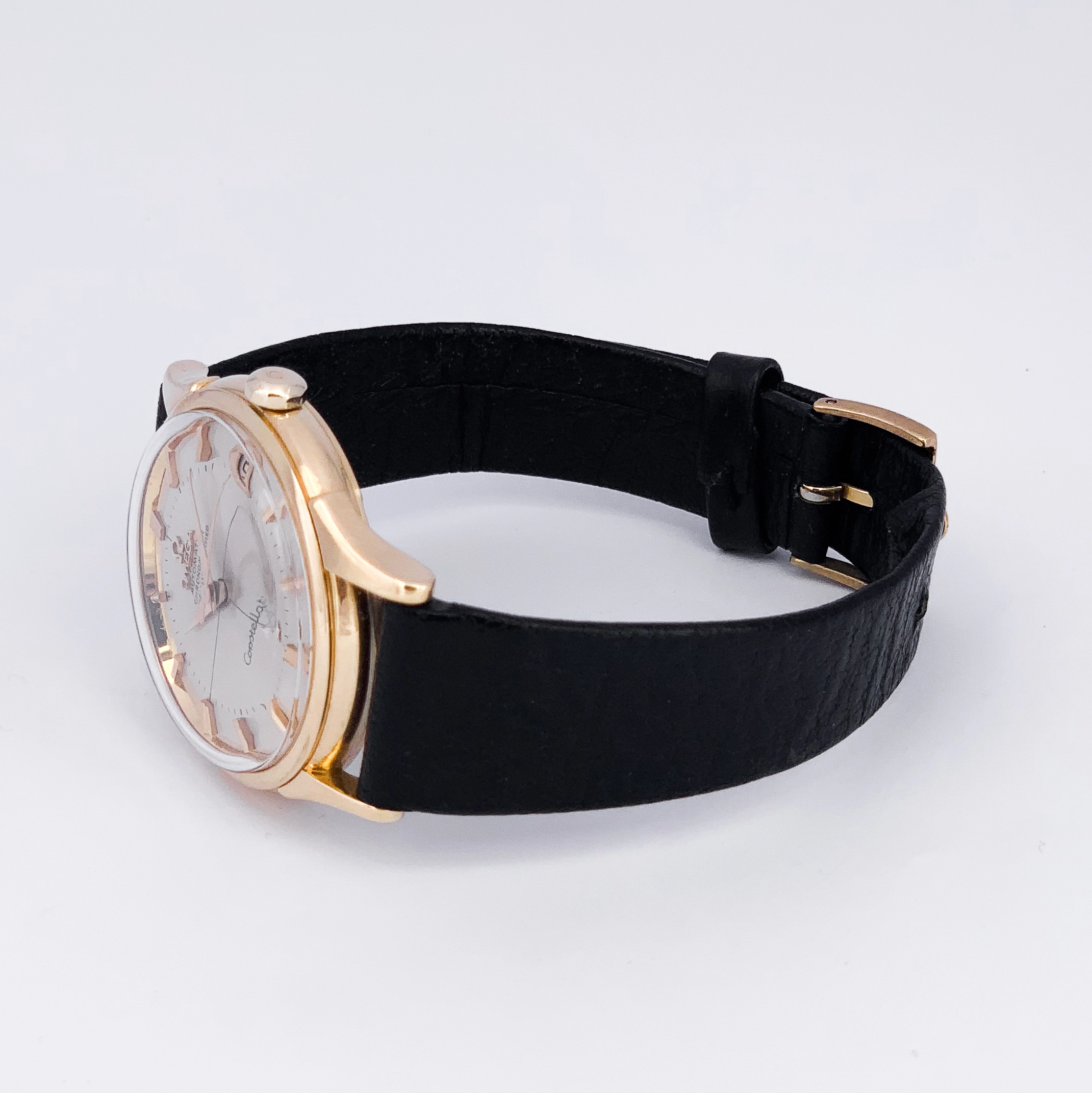

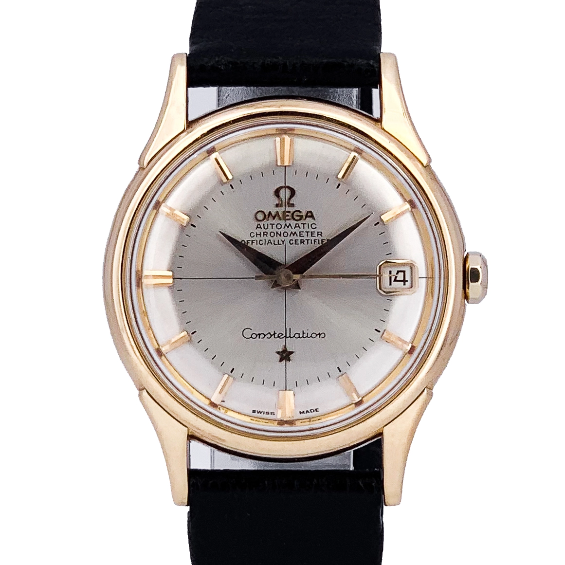

Dear all,
I was checking this (from what I can tell) very nice Constellation in full gold from a dealer in my home town of Rome.
They say it is a reference 168.004/14.
From what I could gather online, this doesn’t look like a 168.004, which has different lugs, but also I could not find any reference with these lugs and that dial.
Would be grateful if you could help me shine some light on this

Hi, we like pictures.
But it looks like a 14393. However, it's a bad redial and the case is heavily polished. Stay away from it.

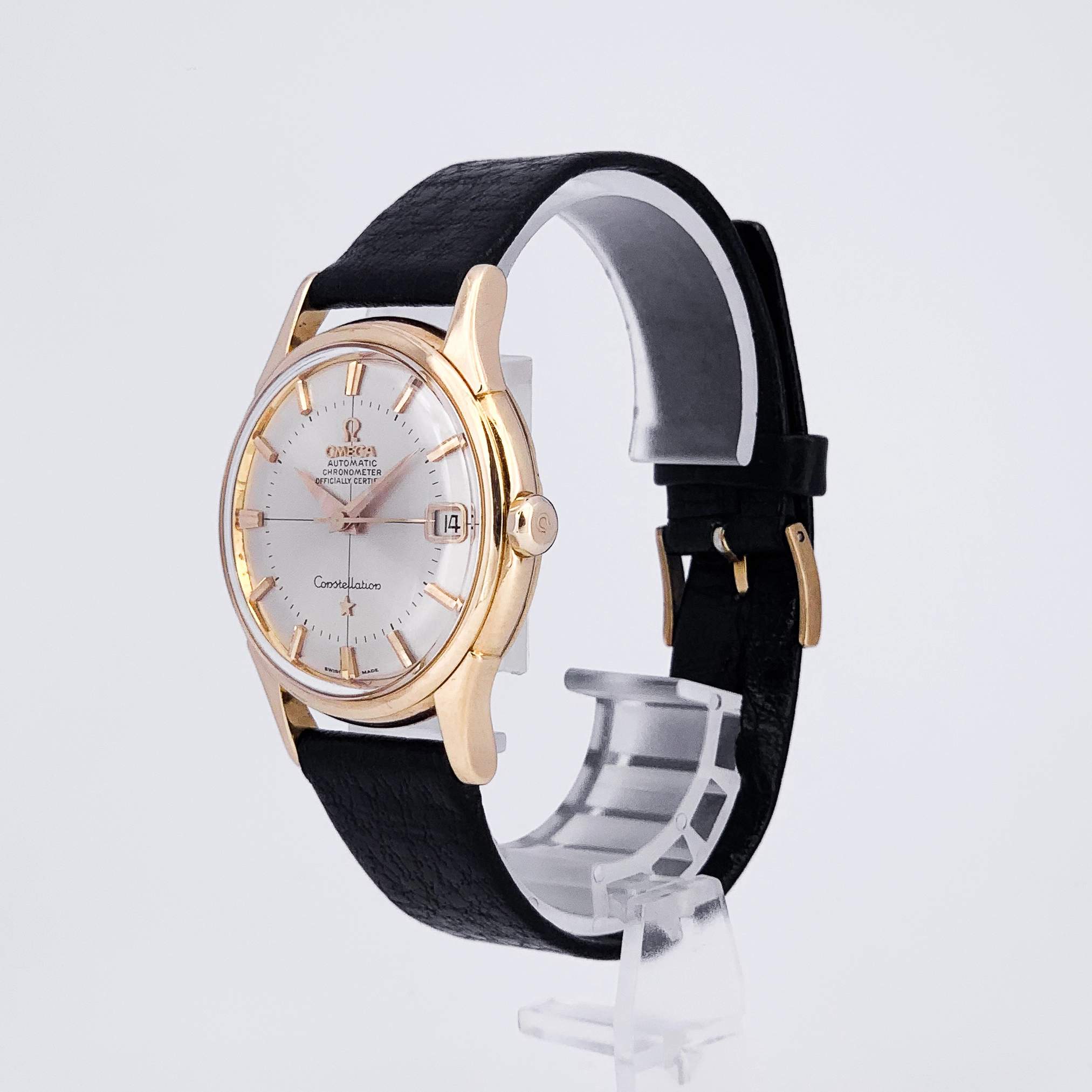

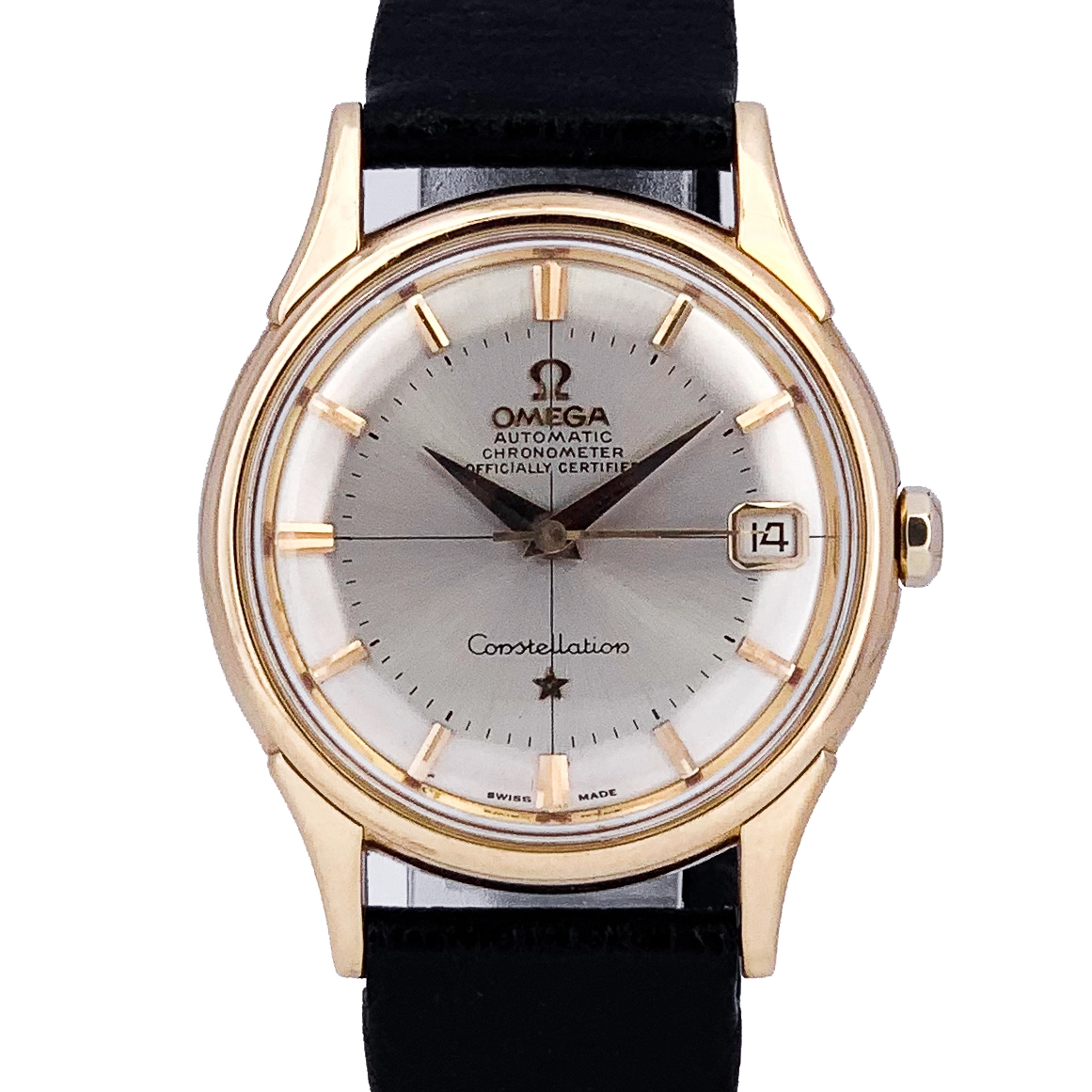

Adding pics since the OP hasn’t:
Well, thank you 😅 was not sure pictures were still desired.
So, I can see that the cross line is a bit wonky, but to my untrained eyes the text looks good.
Would be awesome to know how did you spot it is a redial?
13,571
23,557
The font is too heavy, clumsy and of too port quality to be genuine Omega. Real crosshairs from this period also go through the text rather than stopping and starting again as this one does.

You should look at a few thousand pics of known originals to train yourself😁. Or post likely candidates here before you bid. Best to post clear pics and tell us what research you have done.
Ps the Swiss Made looked poor and stood out to me, along with all the others issues mentioned.

As often happens, fancy and overexposed pics = run away.
We just miss gloves, here.
