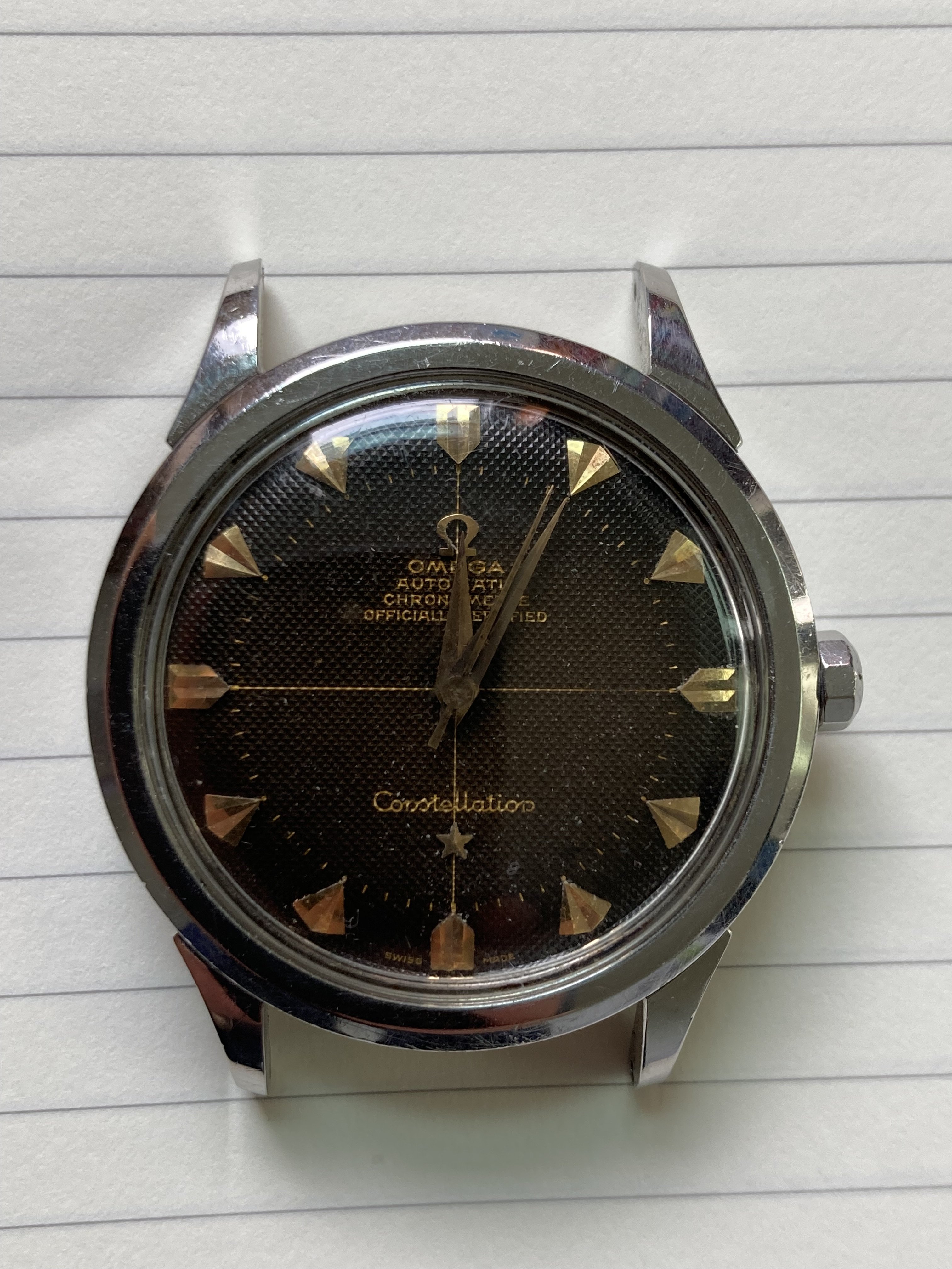

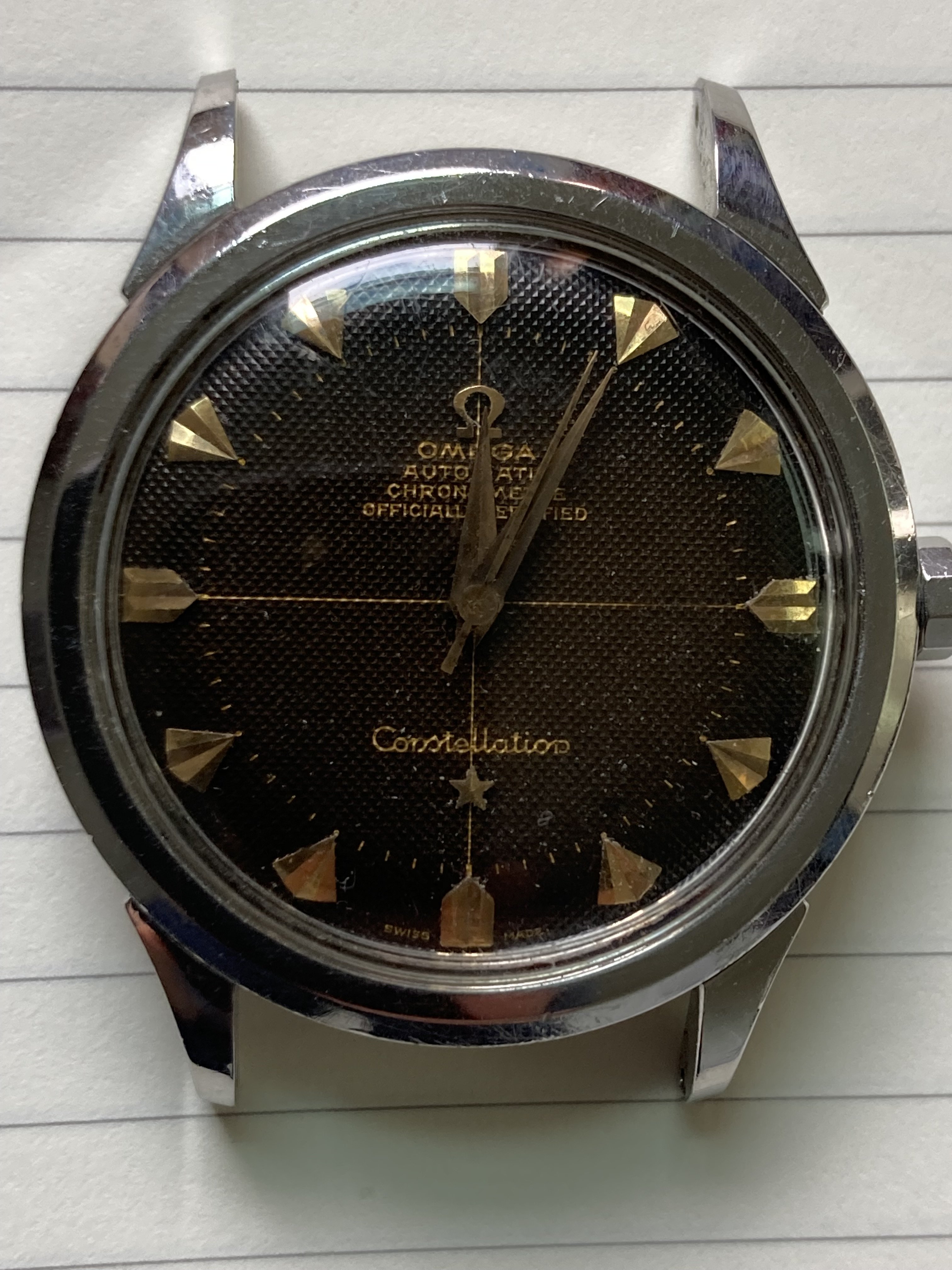

Hi again, everyone--I thought I would do this on a separate thread.
I think I would like to seek out an Omega BOR bracelet and endlinks that would be appropriate for this watch.
I'm hoping that some of you can help me be sure I know what to look for! (and maybe where to look for one!)
Thank you!
~Chris

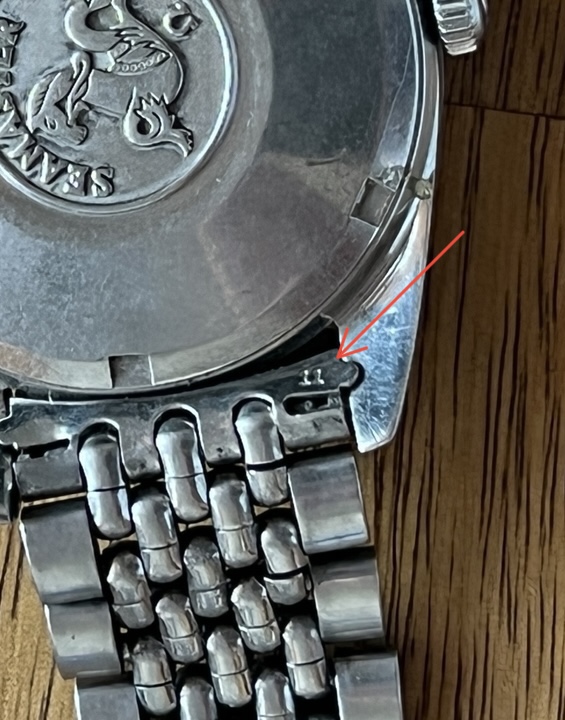

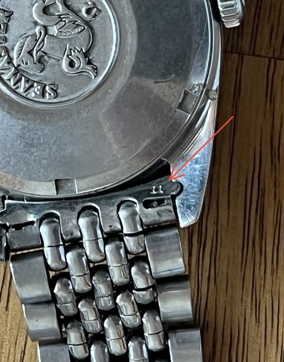

No worries. Here’s an example. Not a Constellation, obviously, but it’ll do to show you how the marks on an endlink look like:
OK, I see!
That helps a lot! thank you once again! 😀
