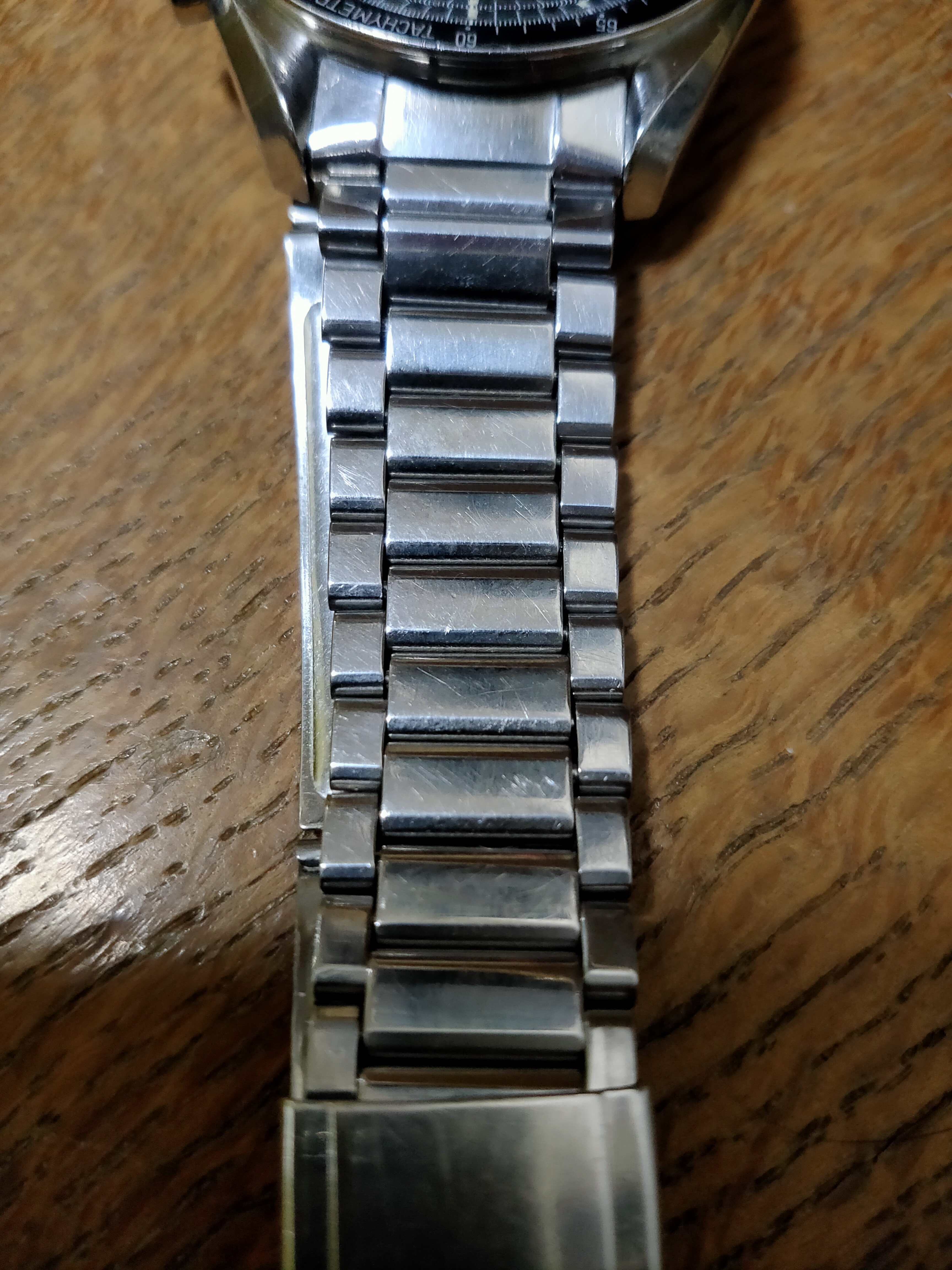

I have a 1997 145.022 and really like the older bracelets. Would a 1175 bracelet & 640 endlinks fit correctly?
521
980
If it's a 1997 Speedmaster Professional, wouldn't it be 3570.50?
At any rate, both the 145.022 and 3570.50 have 20mm between lugs, so I think the 1175/640 will fit.

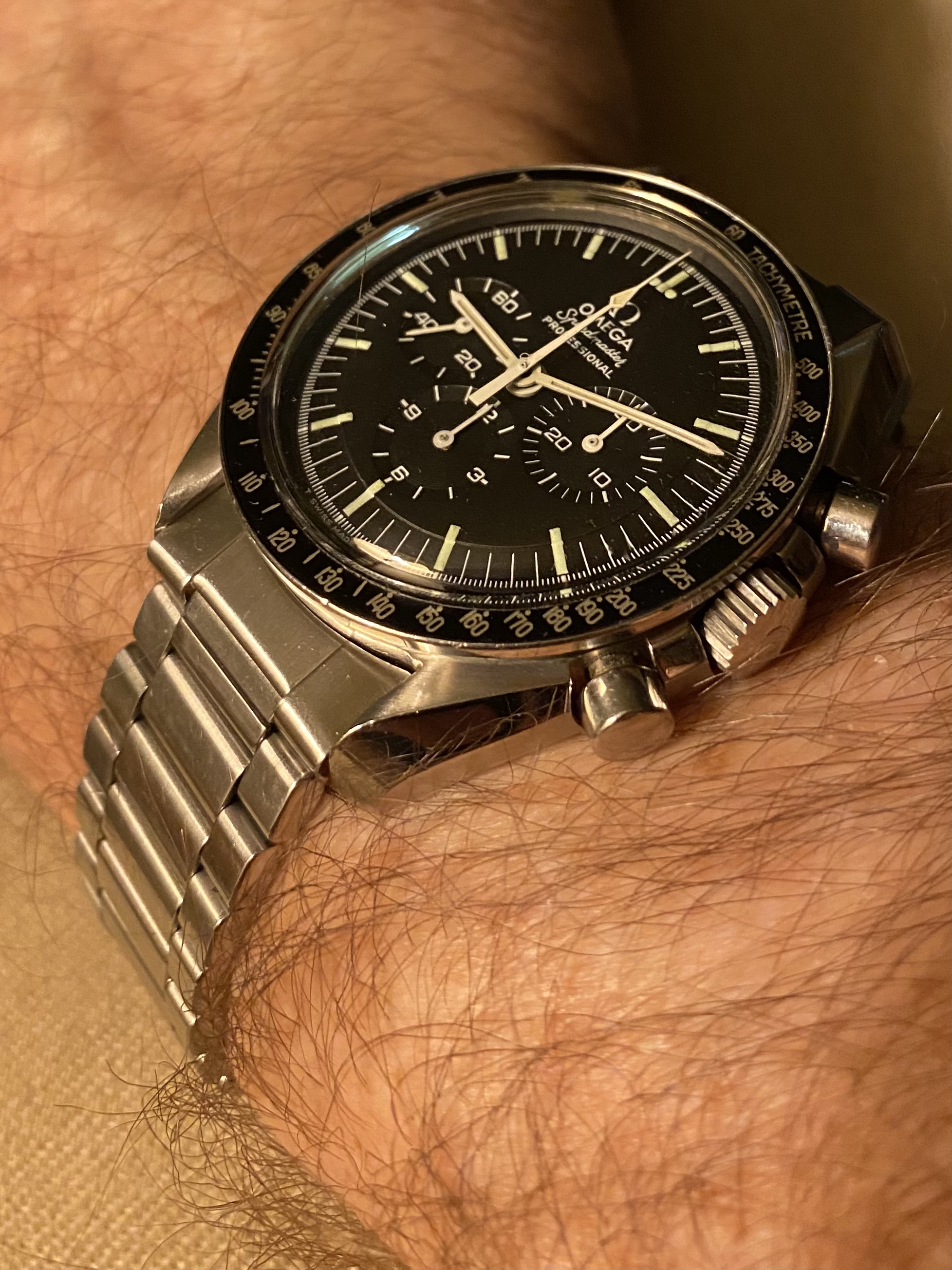

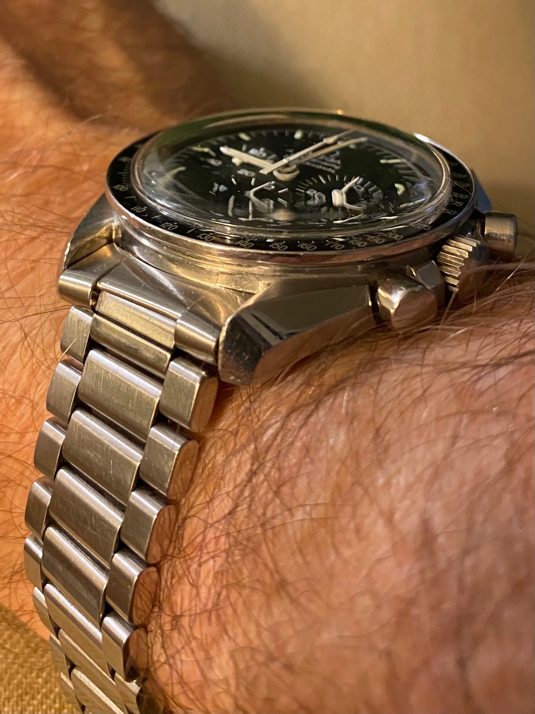

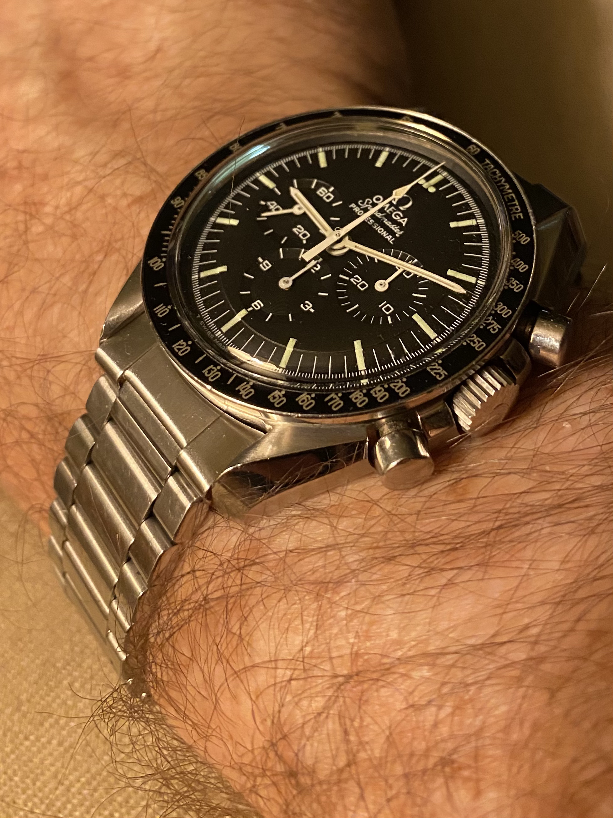

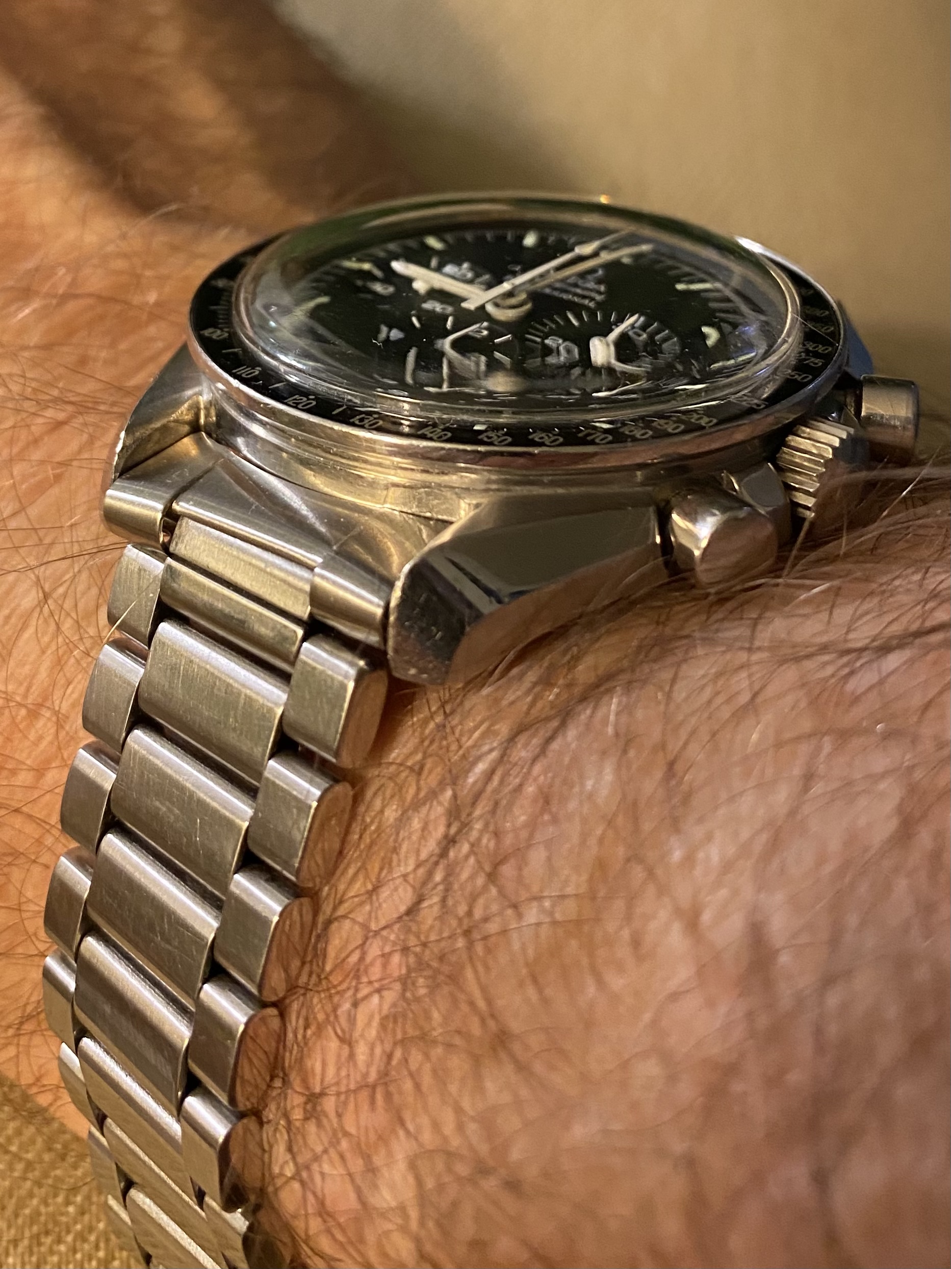

By the way, my 145.022-71 with 1175/640 looks like this.
618
1,310
Brilliant thanks.
