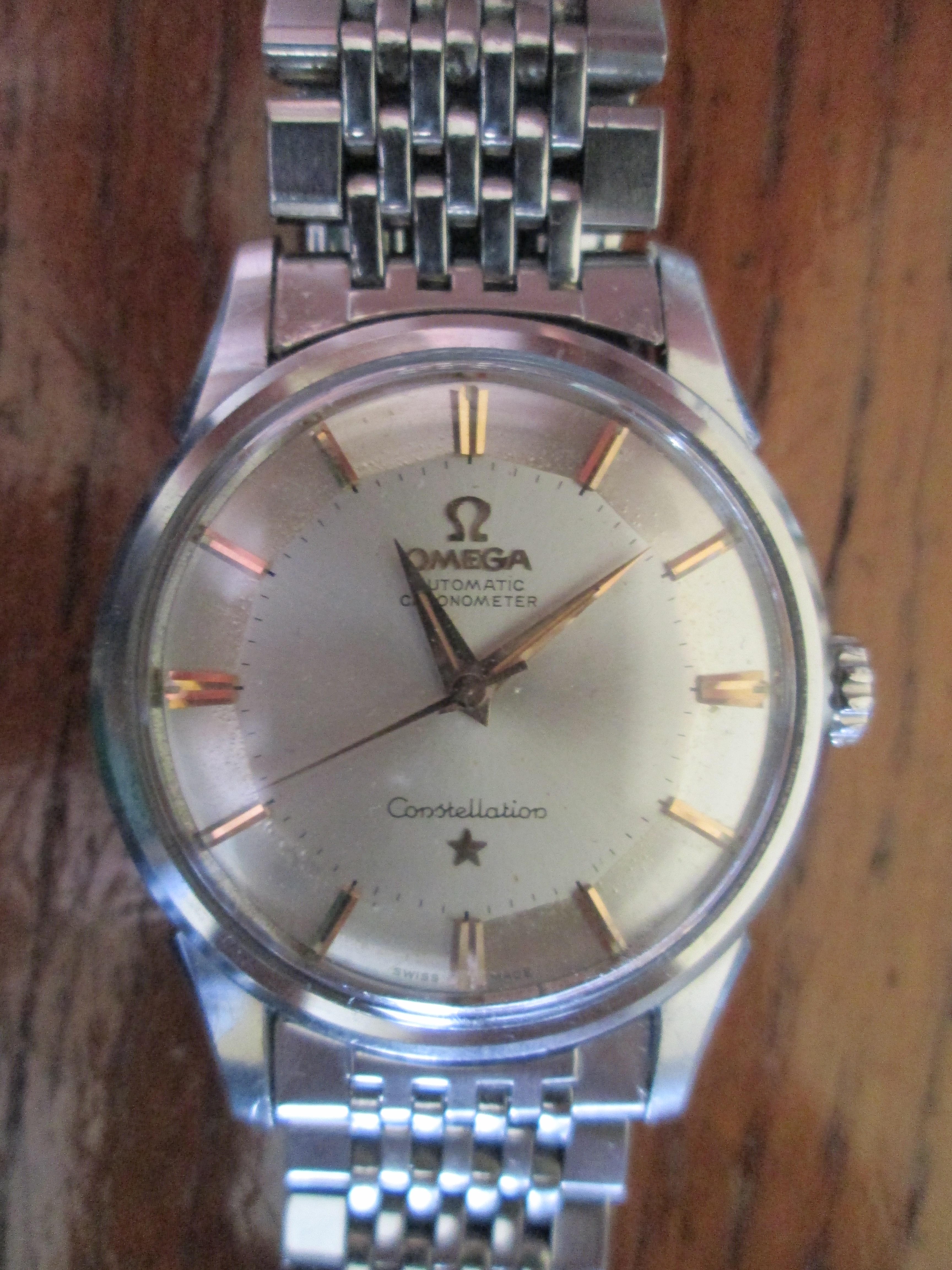

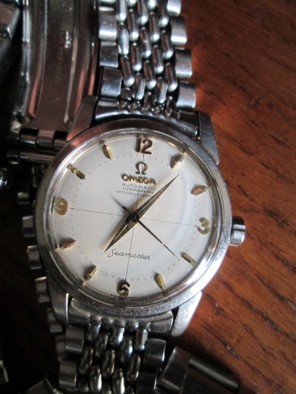

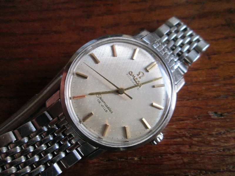

This was my first decent vintage watch. It came with this BOR which I think has always been on it. Hopefully you can see how the lug shape and the finer lines of the case match the shape of the BOR links.
A 5-row BOR on an earlier Seamaster. Everything about the watch is bolder and rounder, and this is reflected in the design of the bracelet.
Then you have the 14381 Constellation, which can carry off either type.

@Edward53 thanks very much for taking the time to post those, I can indeed see how well the 7-row works in the first pic - that has pretty much made up my mind about the 7-row.
So pleased I posted this thread to avoid disappointment 😀 always ok to carry on educating myself.

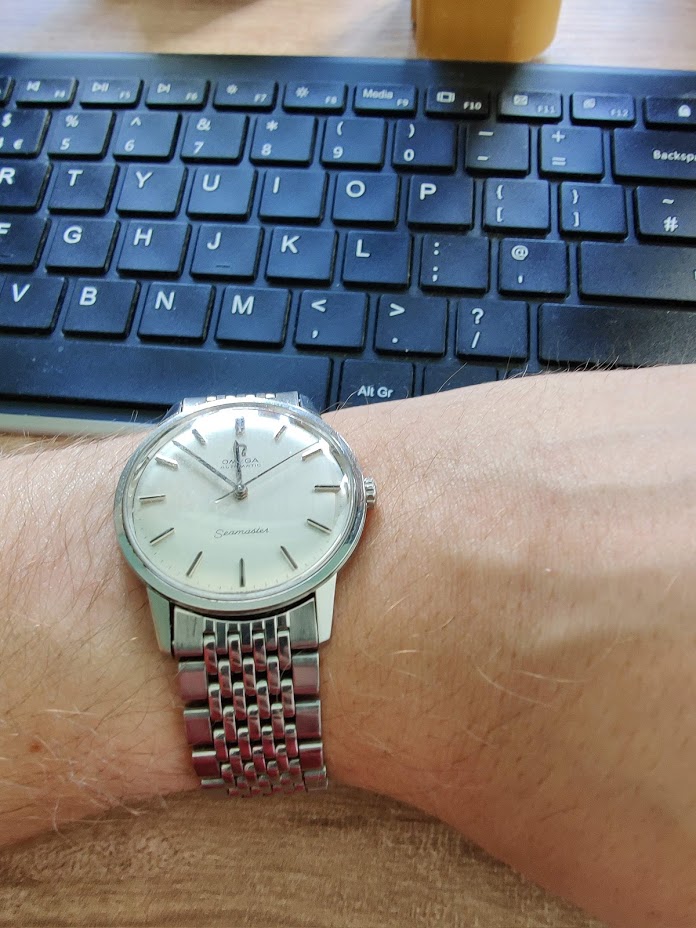

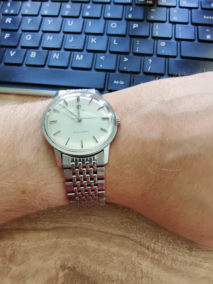

Hey all,
Just thought I would update that I managed to bag myself a 7 row BOR and got it fitted (after some definite fiddly re-sizing) 😁 thanks for all the advice above on this one in my quest!
Cheers,
Dave
Some pics:
