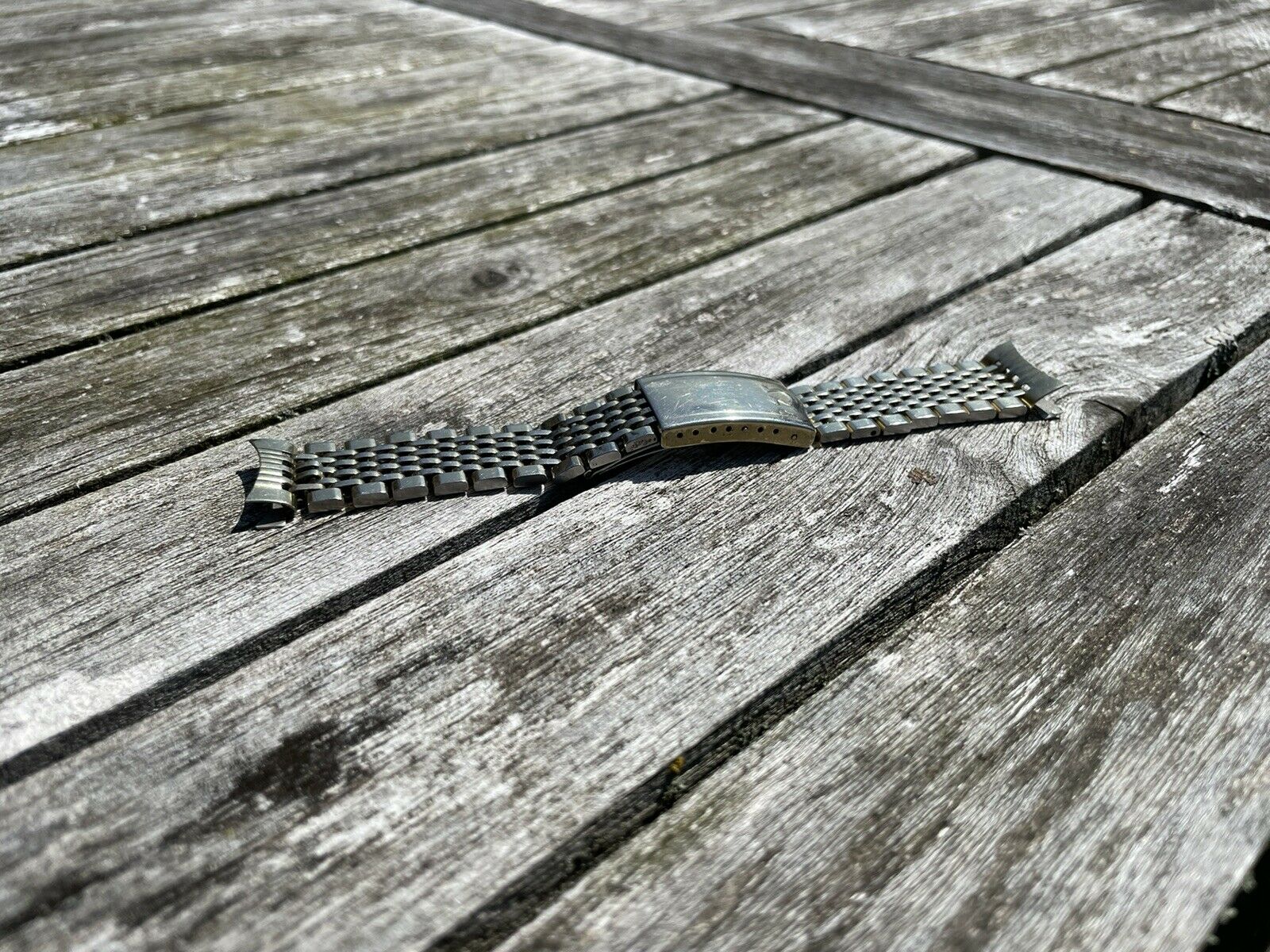

Hello,
I have looked through a number of threads on which BOR bracelets fit with which Seamaster De Ville models and I am currently thinking I am looking for a 1037 with 570 end links.

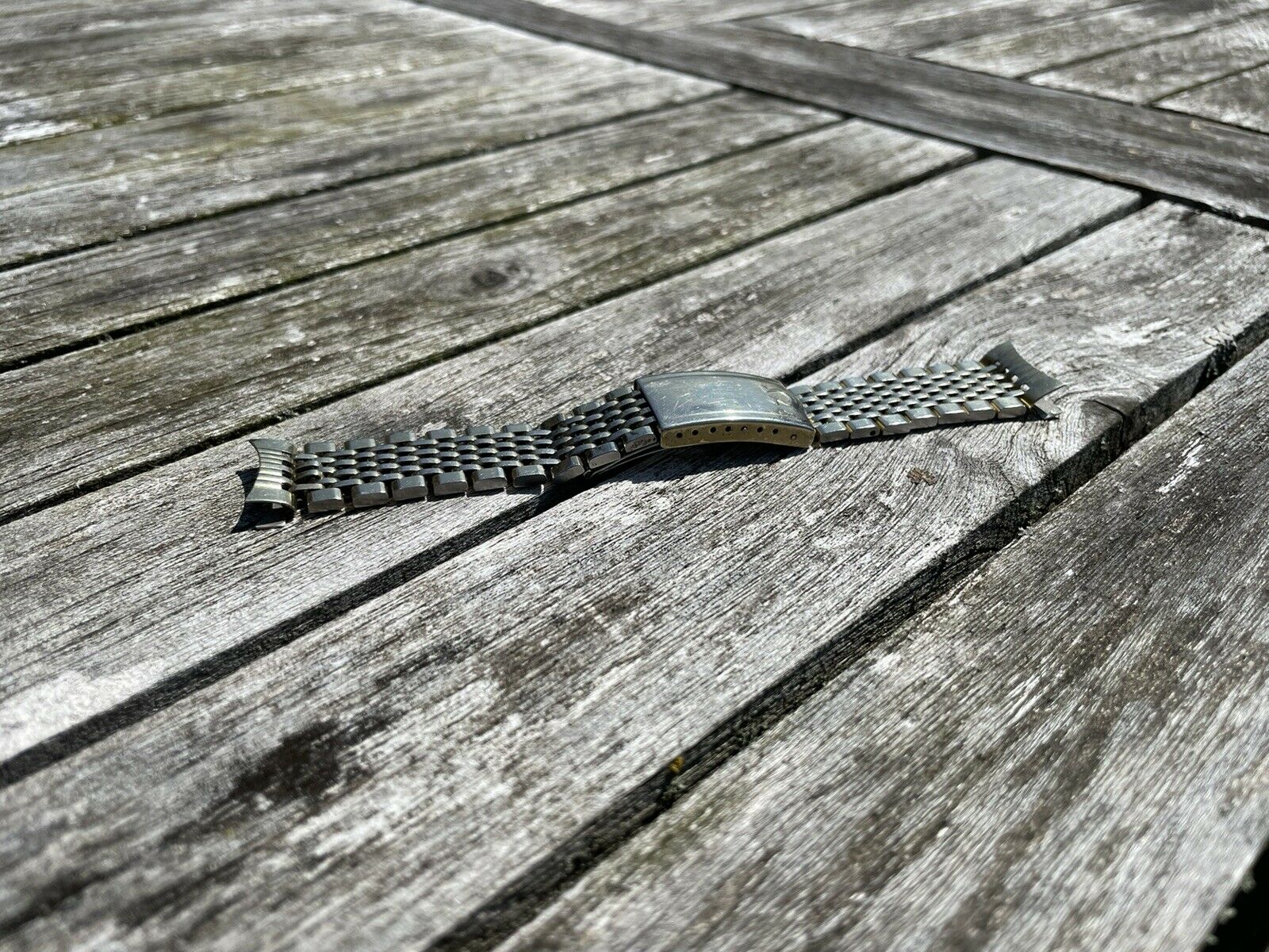

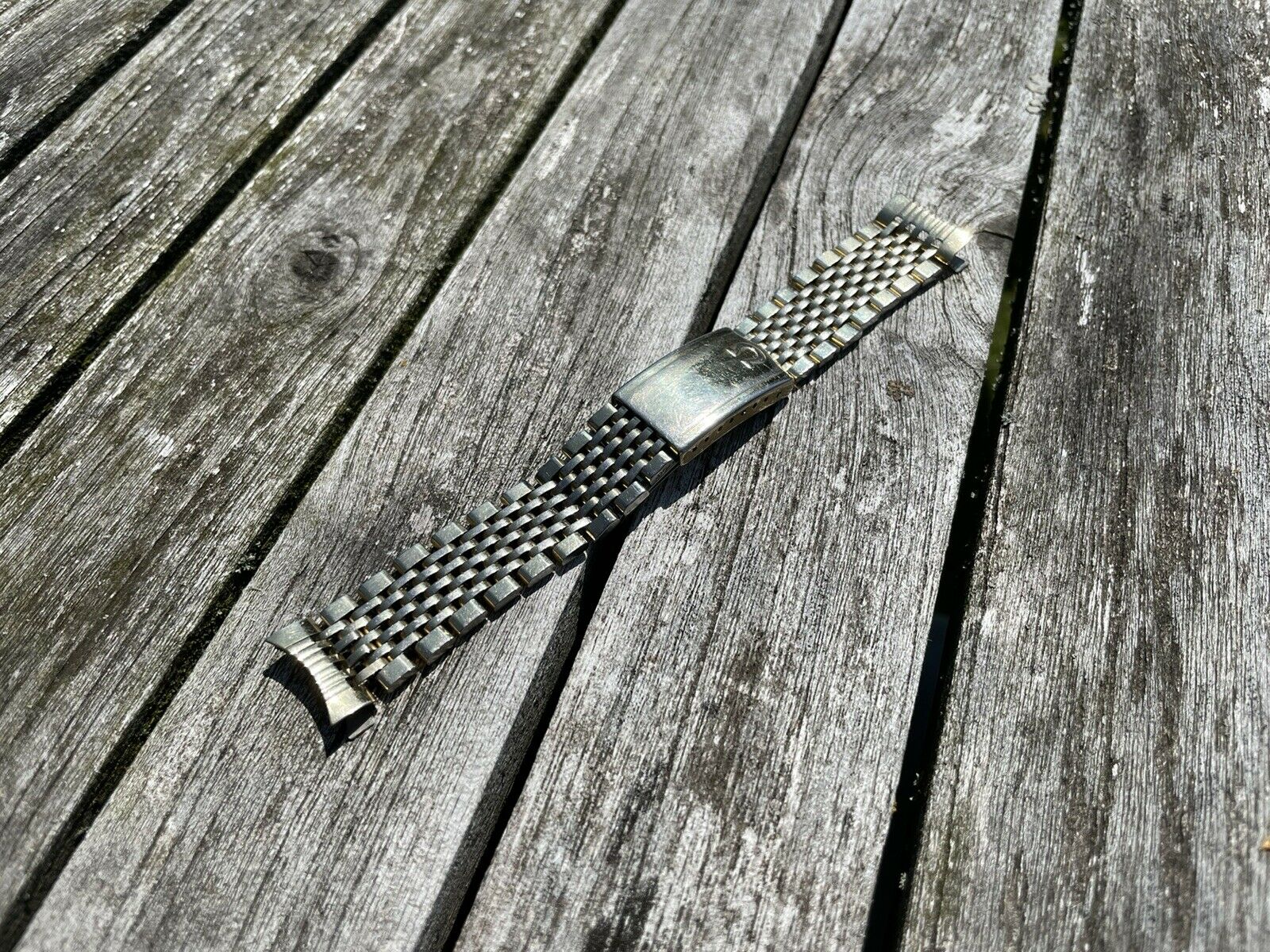

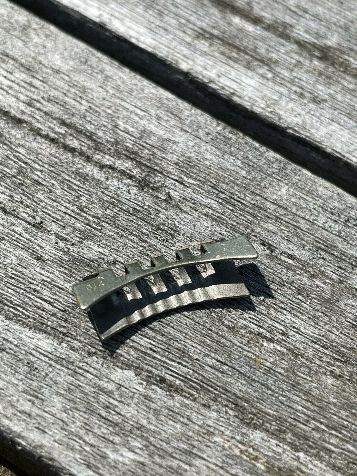

I have found a 1037 bracelet but it has 614 end links (see photo).

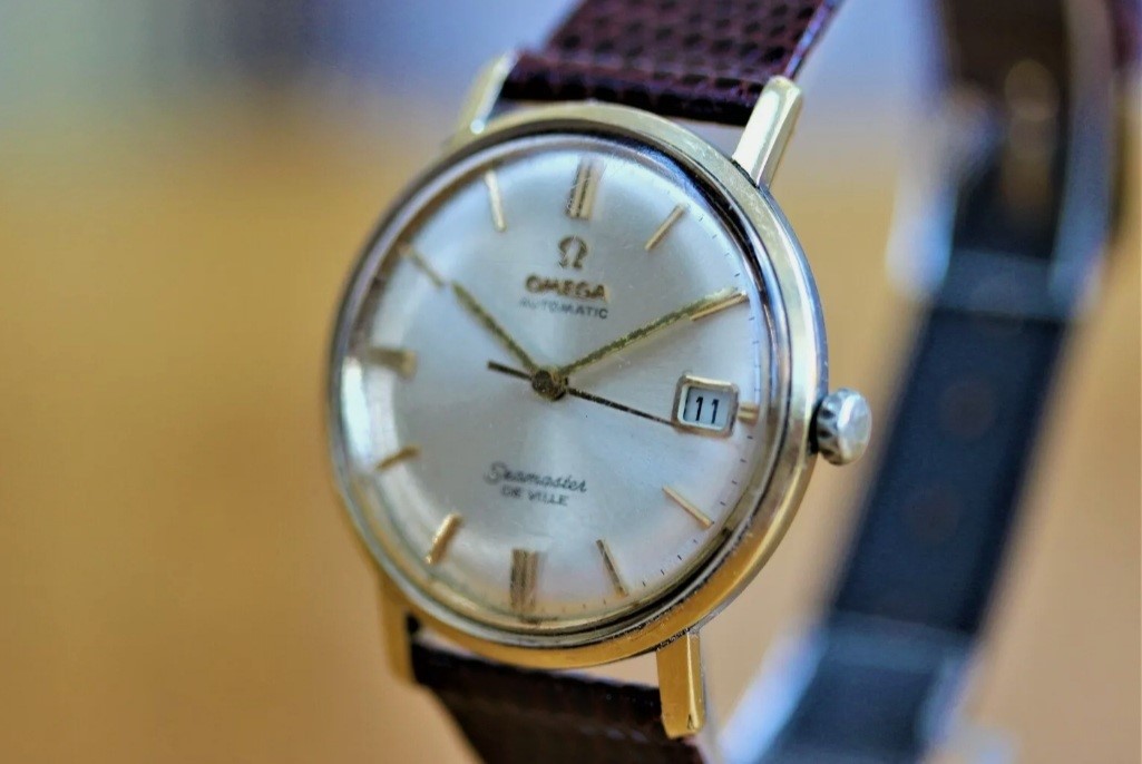

Will this fit ok with my Seamaster De Ville (I think it is a 166.0020 ?) ?
If not, is it worth picking up the bracelet and keeping and eye out for the other end links or do these tend to be sold together?
Any advice would be appreciated..
Tom

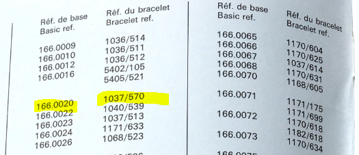

End link are hard to find to reasonable prices and buying at Omega even worse. Better to find a complete bracelet with 570 end pieces IMHO.
3,133
5,571
Looking for the end links on their own will be a nightmare. I doubt the 614s will fit. As mentioned above, best wait until you can get it all in one. 70 end links are also ok.
1,599
6,869

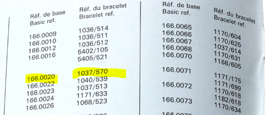

First of all, apologies for going slightly off topic: Interesting picture! Could you please share the source? I'd love to look up what my 168.001 should have come with. 馃榾
To the OP: Well done finding a matching bracelet!

Thanks to this, I now know that my Chronostop has a 1037 bracelet, but with 138 end links and a No. 27 clasp. When new (1971), it came with a leather band, and the dealer sold me the 1037 bracelet ca. 1975.
ANY clues where a 1037, all by itself, might be found? Mine has stretched to where is cannot be adjusted to fit properly.

Did you try eBay? It looks like there are several for sale right now, including one without endlinks, if you don't want endlinks.
