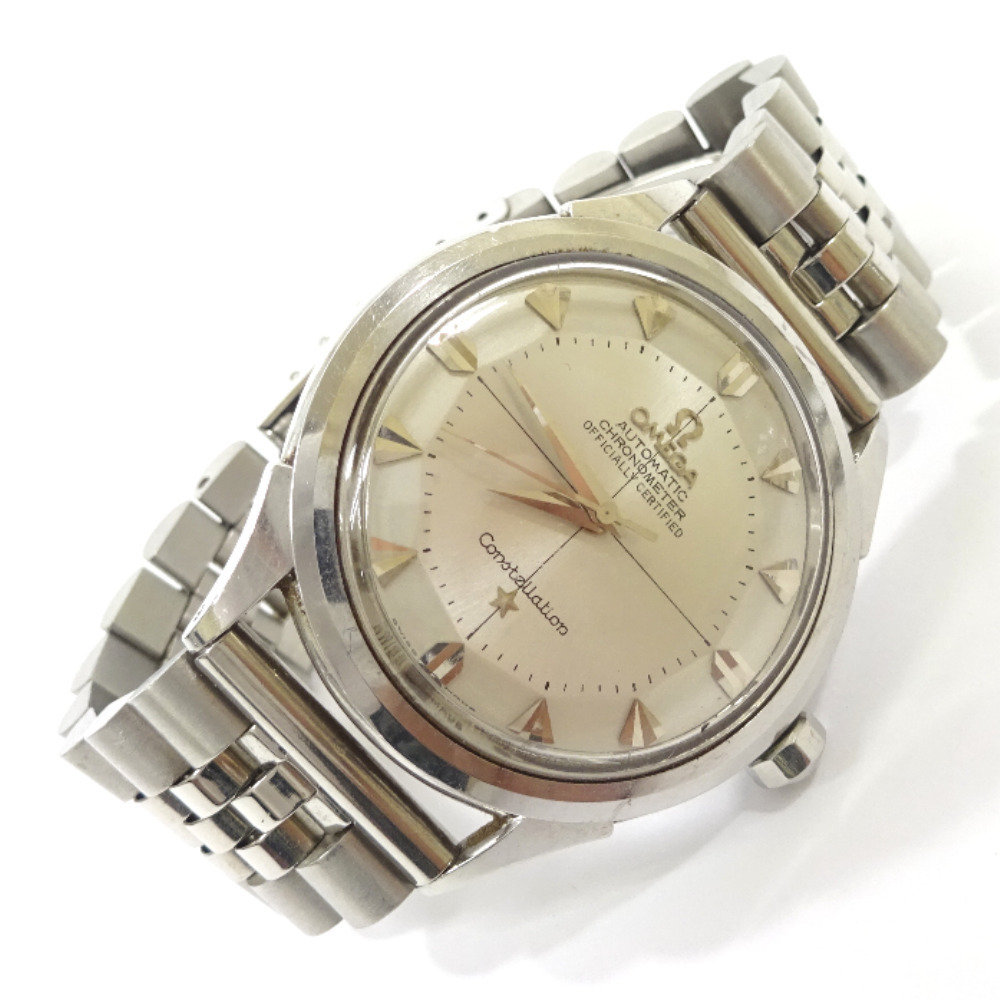

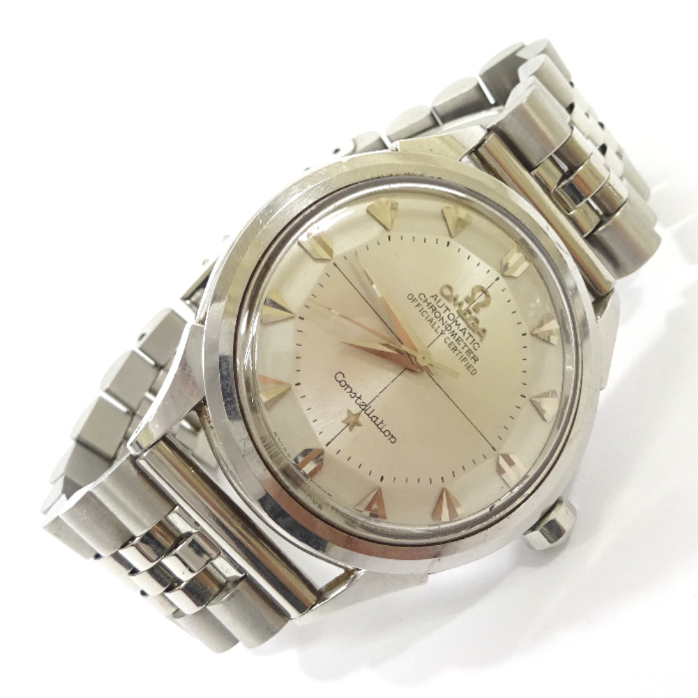

Posts 236 Likes 126 Sturmvogel 路Jan 26, 2020 Hello, Can an expert tell if this is a redial or original dial? Looks almost too nice to be original, but I am not sure. What about the crown? Thanks! Cheers, Roger
Posts 236 Likes 126 Sturmvogel 路Jan 26, 2020 Thank you both!! I suspected it may be a redial. Too bad.

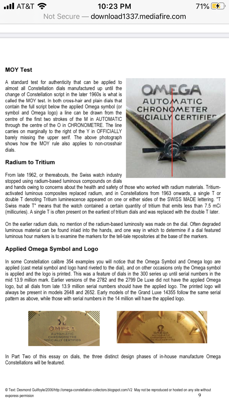

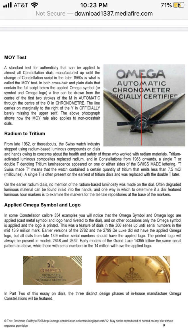

Posts 5,026 Likes 18,608 Shabbaz 路Jan 28, 2020 Watchout312 Search MOY Omega Constellation. But remember. MOY is just one tool which you can use to determine if a dial is correct. But it's not 100%. There are genuine connie dials who fail the MOY-test
