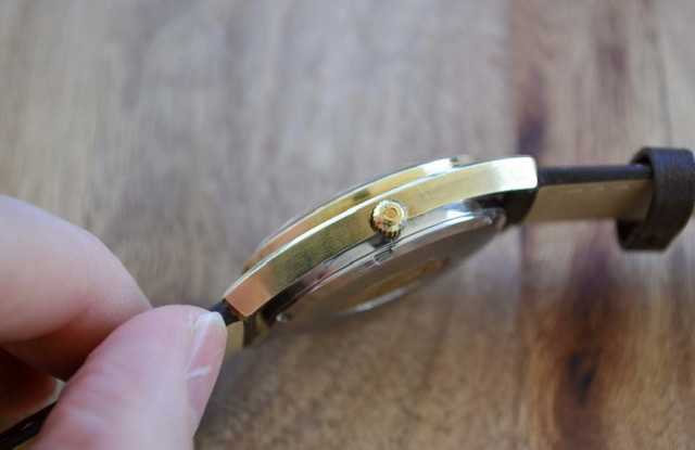

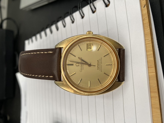

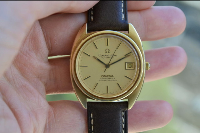

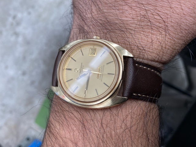

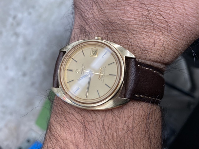

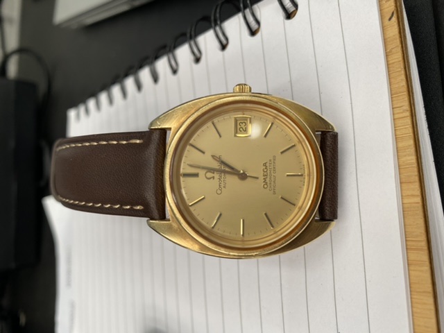

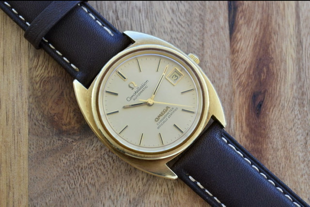

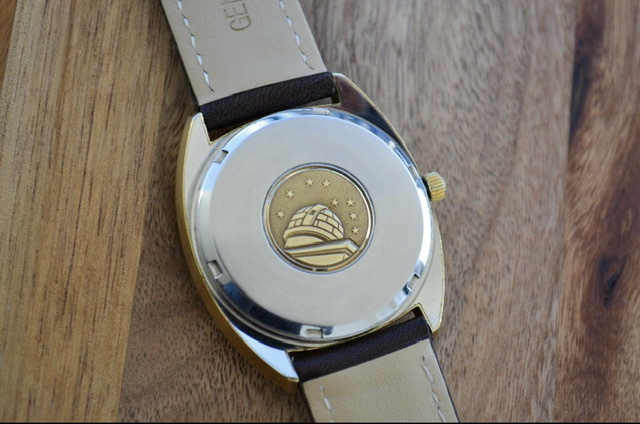

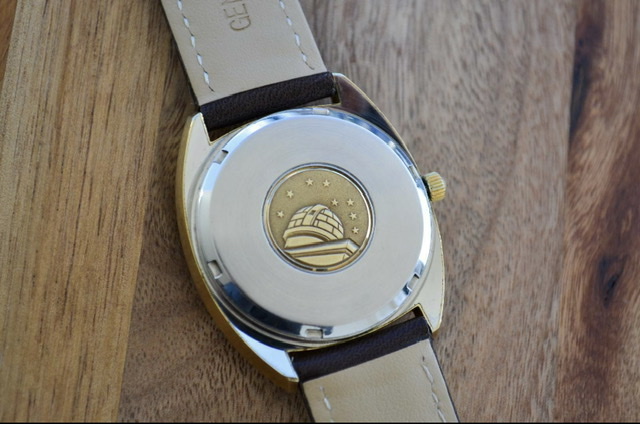

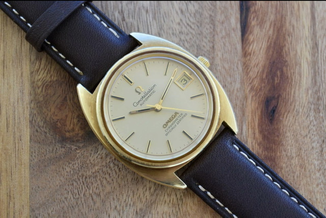

Hi all,
picked up this constellation yesterday. Needs a bit of TLC but I am pretty happy with it.
Crystal isn’t original and will be changed and case need a bit of TLC but I intend on breathing new life into this old girl.
It has a 564 movement and is ref 168.017.
1966-67 me thinks.
905
1,739

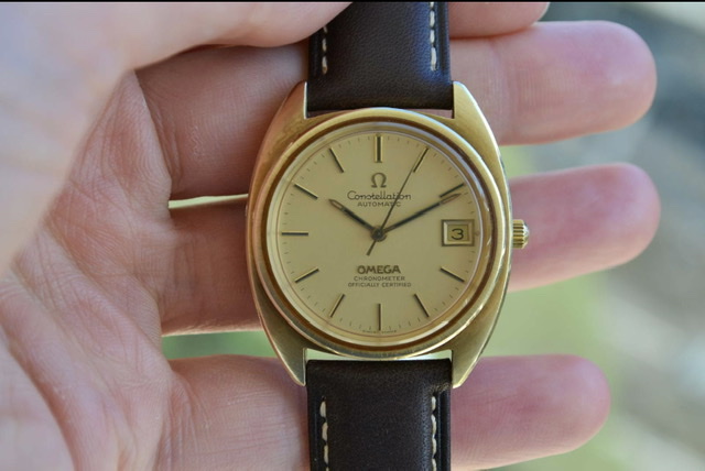

Also I have been told in the Facebook forums that the omega logo being down the bottom and the constellation logo being above signifies it being an Omega made to be sold in the Japanese market.
can anyone confirm?
Do you know this for sure?
I don’t think that dial has anything to do with Japanese market, it just a later evolution of the C case from the early 1970’s.
168.056 with 1011 movement would be my guess.
I have seen this dial with cal. 564 movements. Could be a transitional piece. No way to tell from the photos. However, the OP could test to see if the date has the push-pull quick advance (564) or 2nd crown position bi-directional date advance (1011).
The cal. 1011 example would be thinner when compared side-by-side.

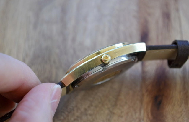

So the date is 1st position and goes both ways. I can go from the 3rd to the 4th or from 3rd to the 2nd.
can’t open the case back. It’s on too tight and I don’t have a safe way to do it without risking scratching it so I’ll take it to my watch smith to open and we can see then.

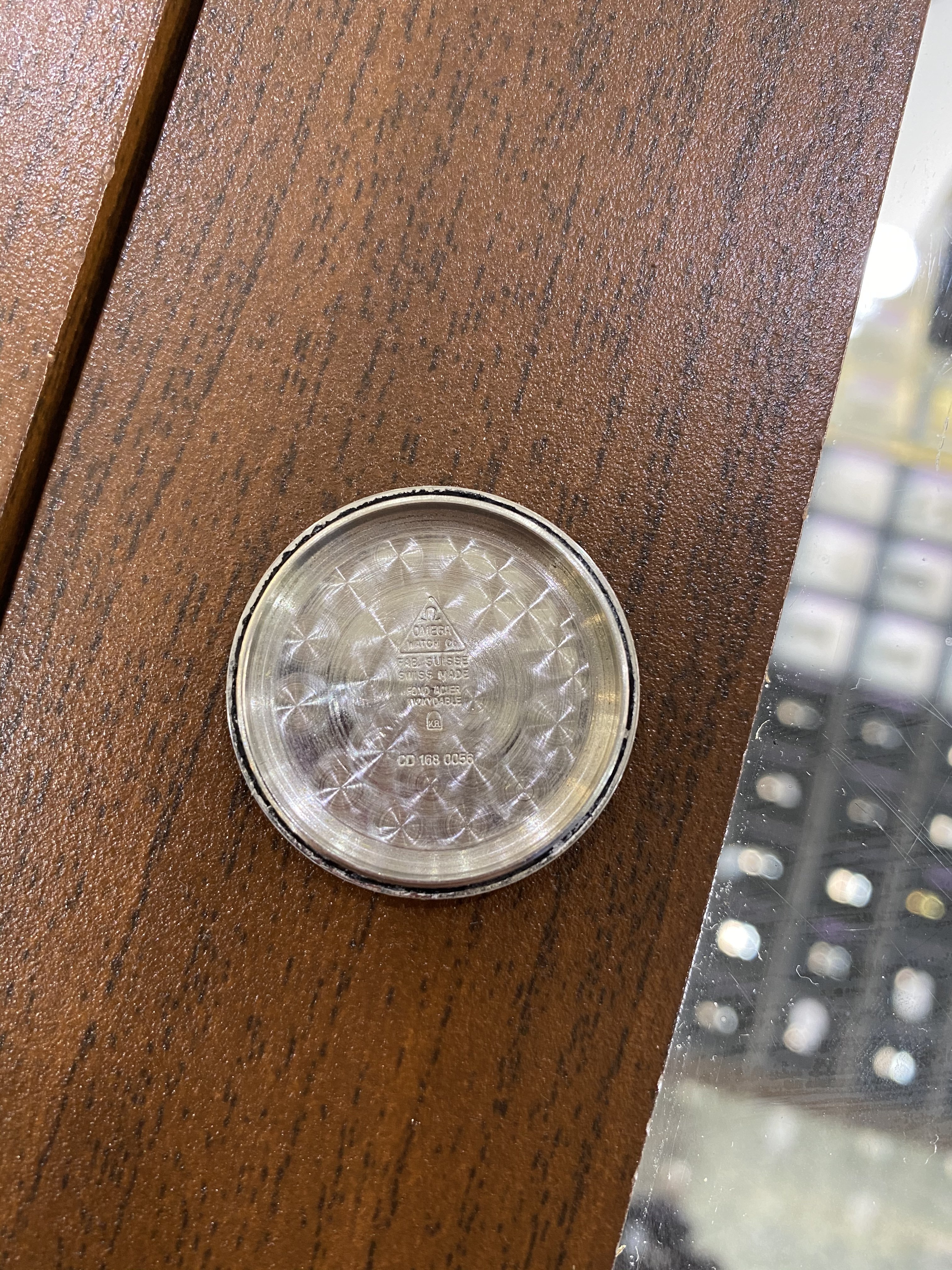

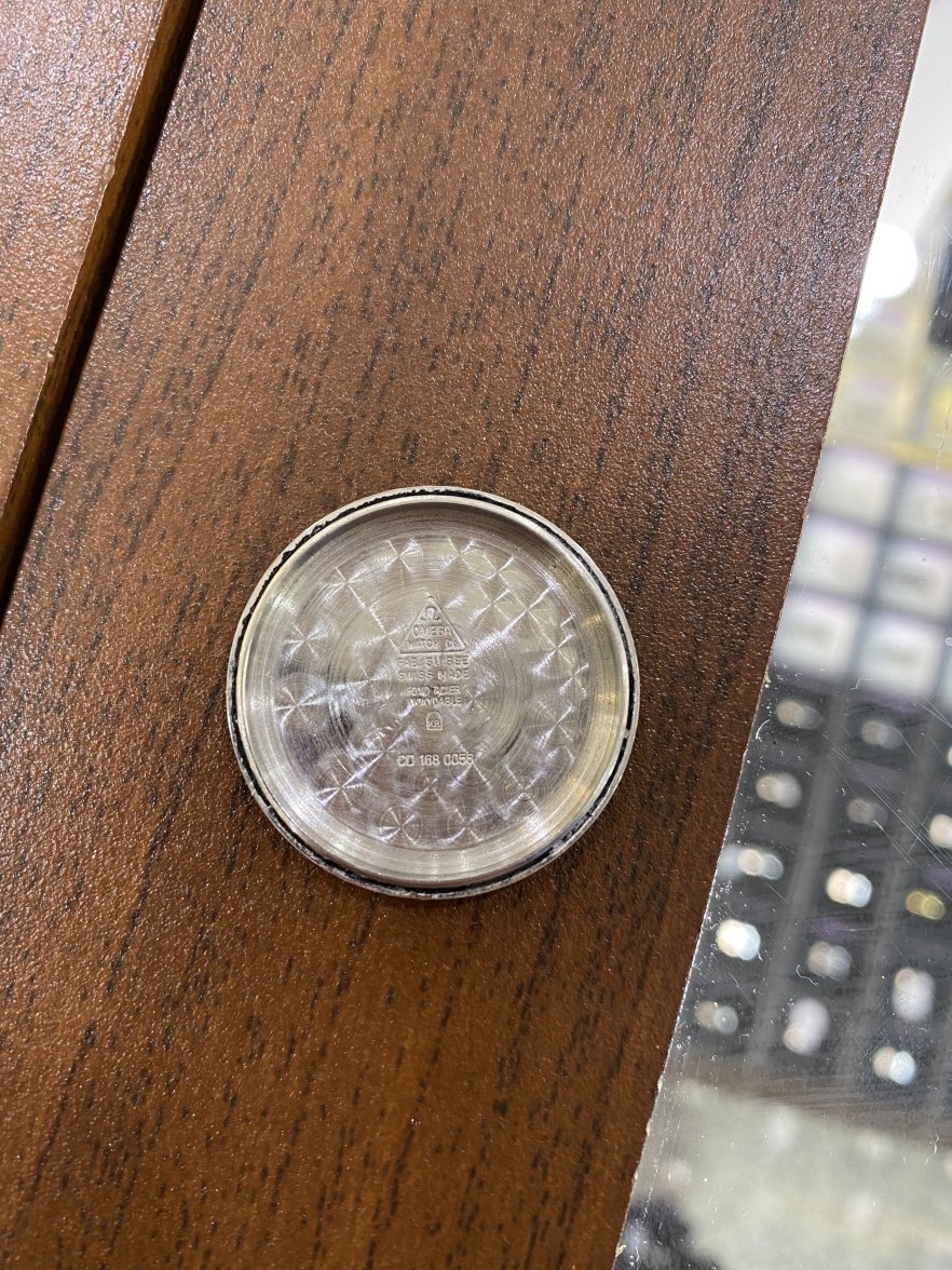

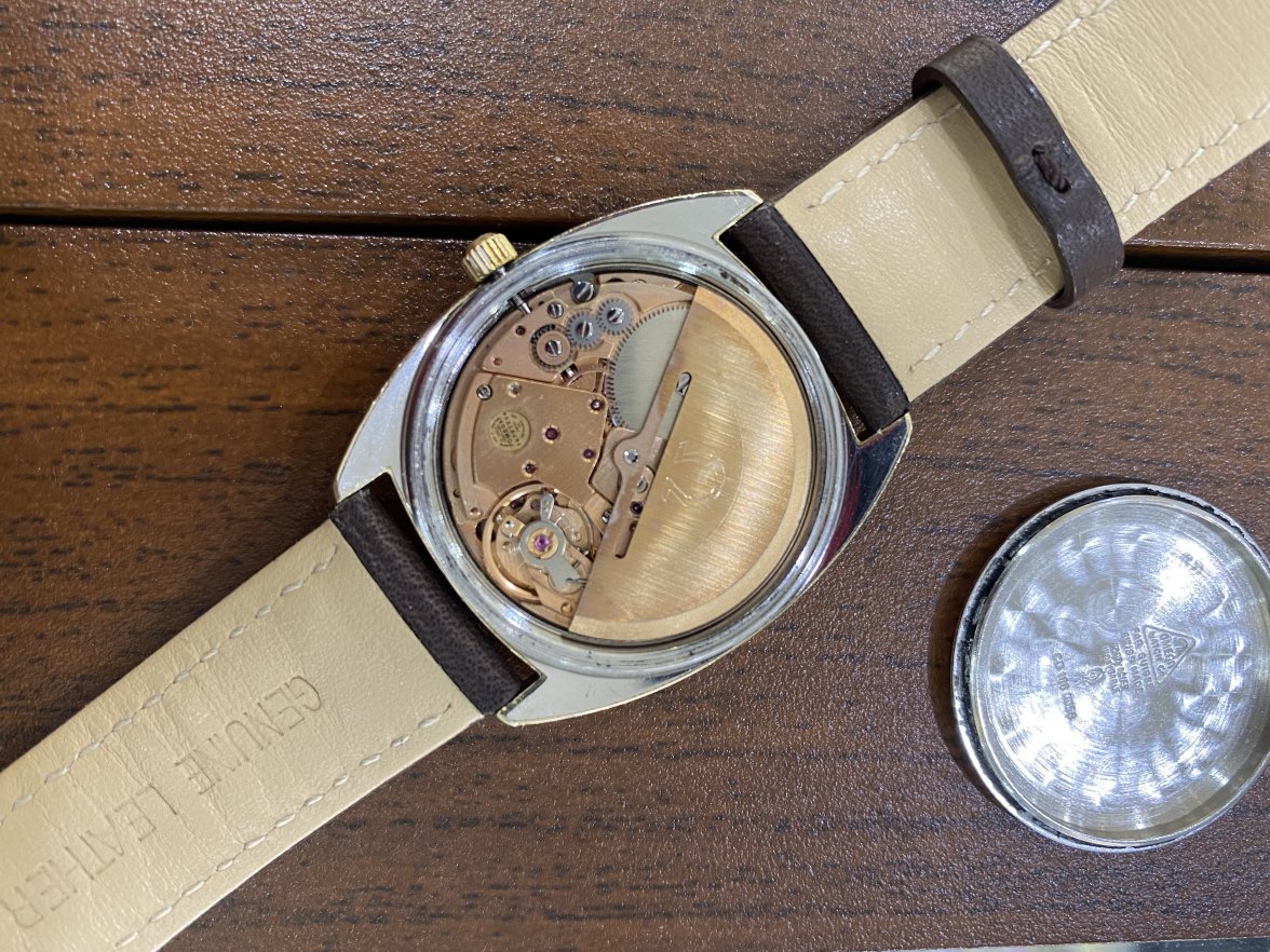

905
1,739

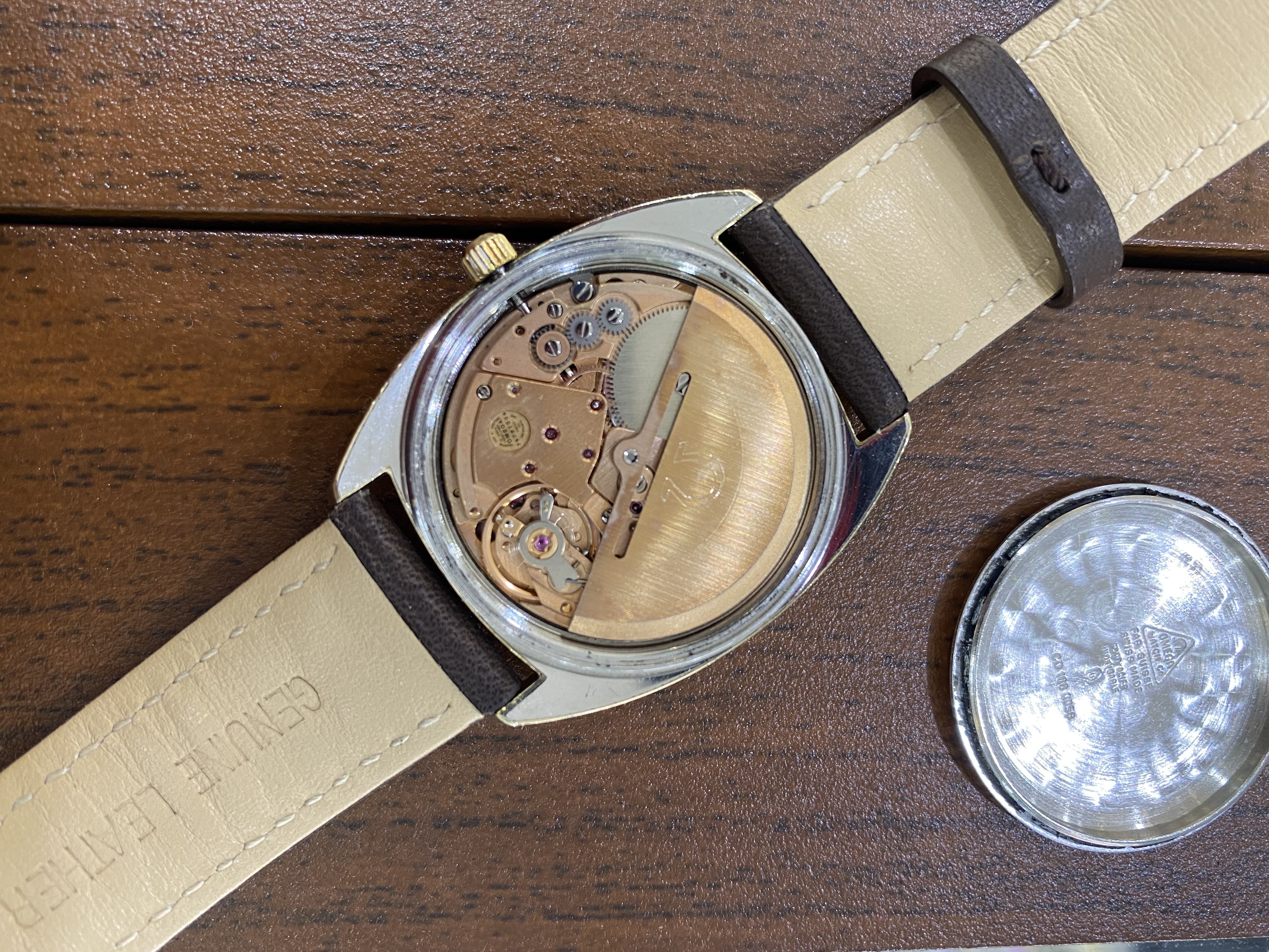

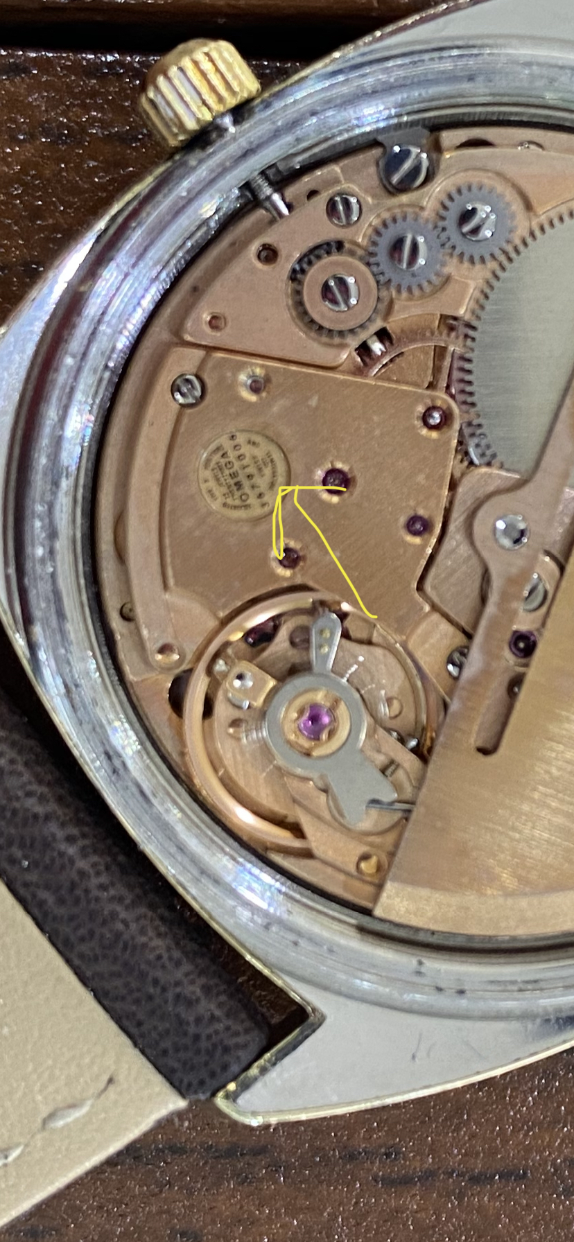

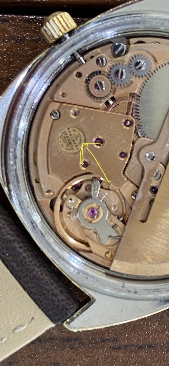

So here are photos of the case back and movement.
on the case back it’s confirms that this is a 168.0056 and I have marked where I think the 1011 is marked on the movement. Couldn’t see it with my eyesight and the iPhone isn’t much better I’m afraid.
