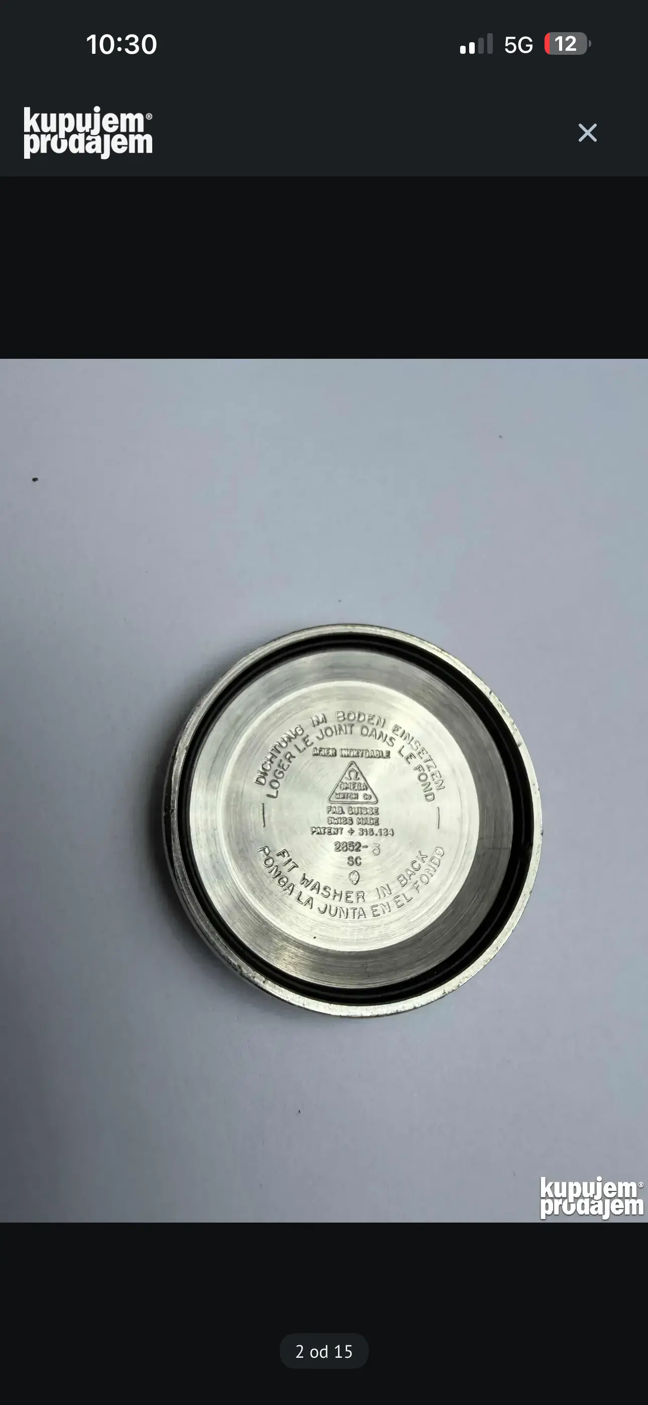

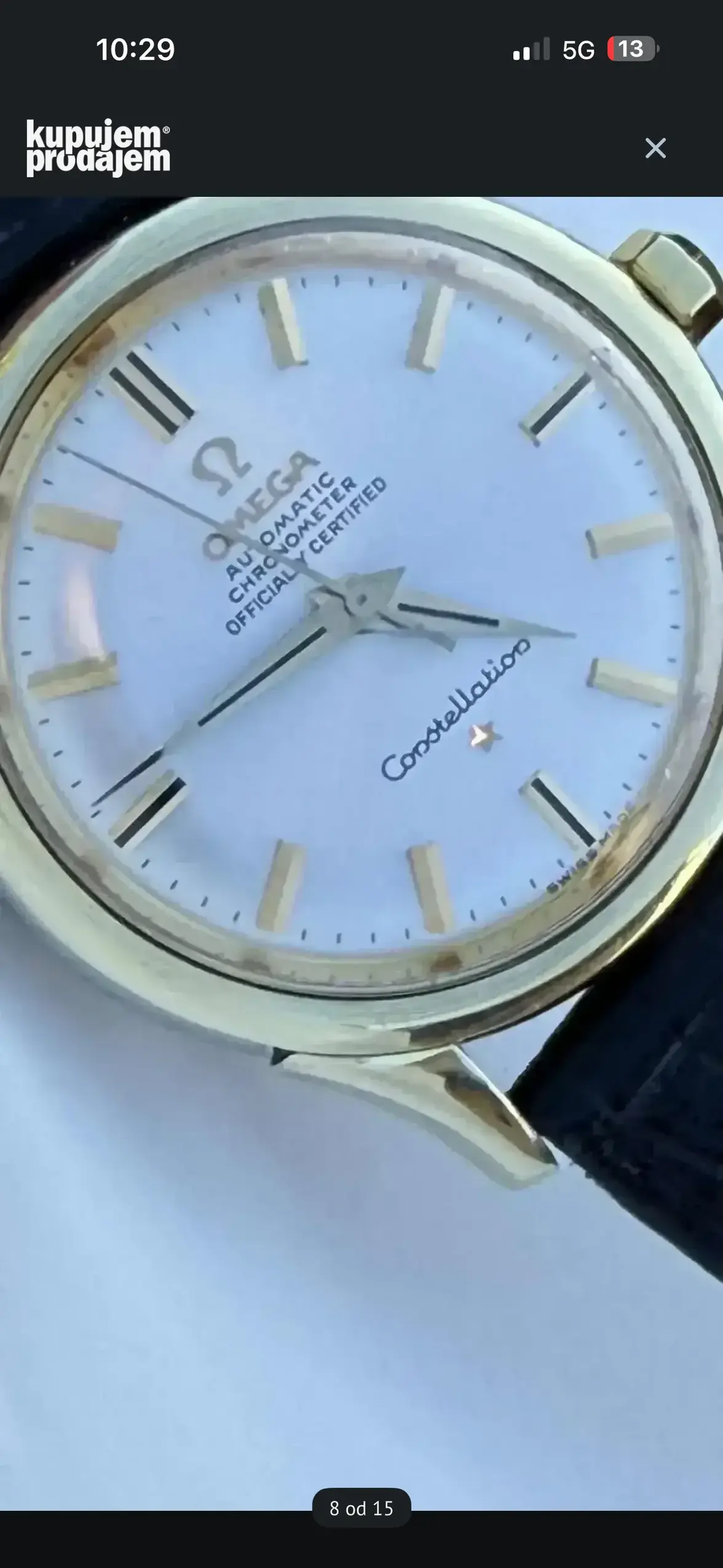

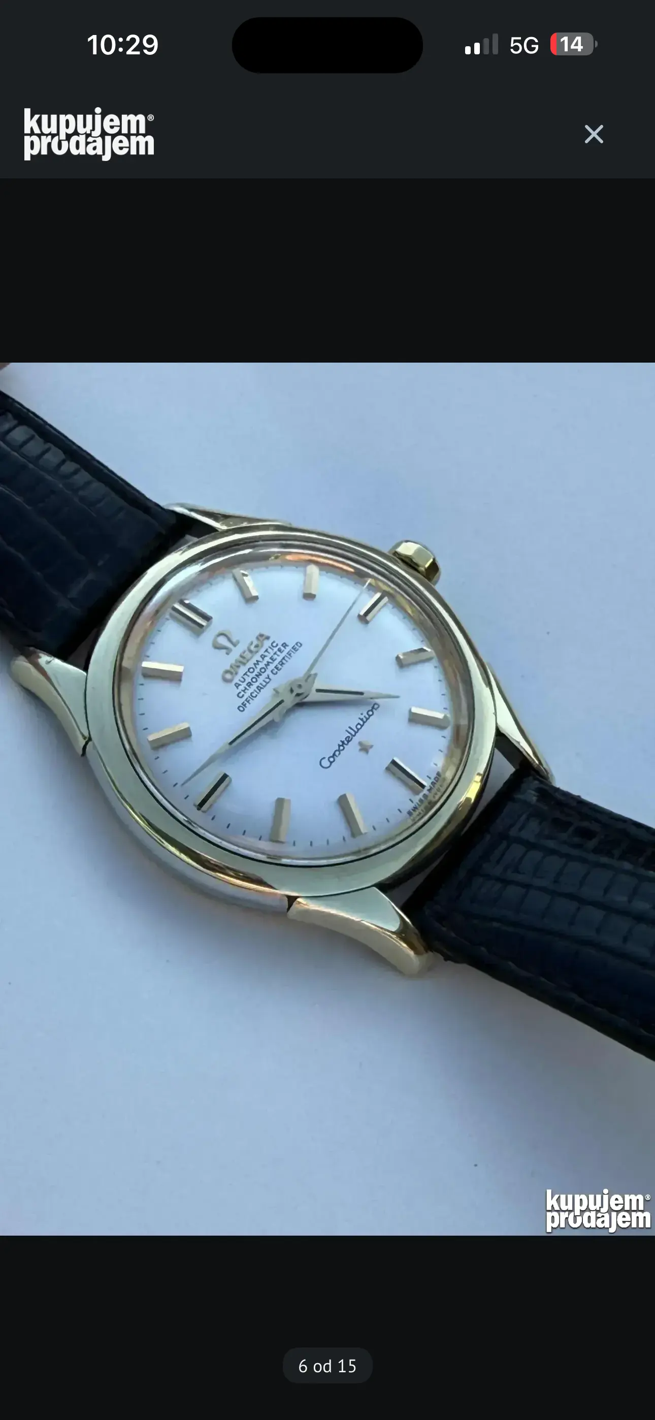

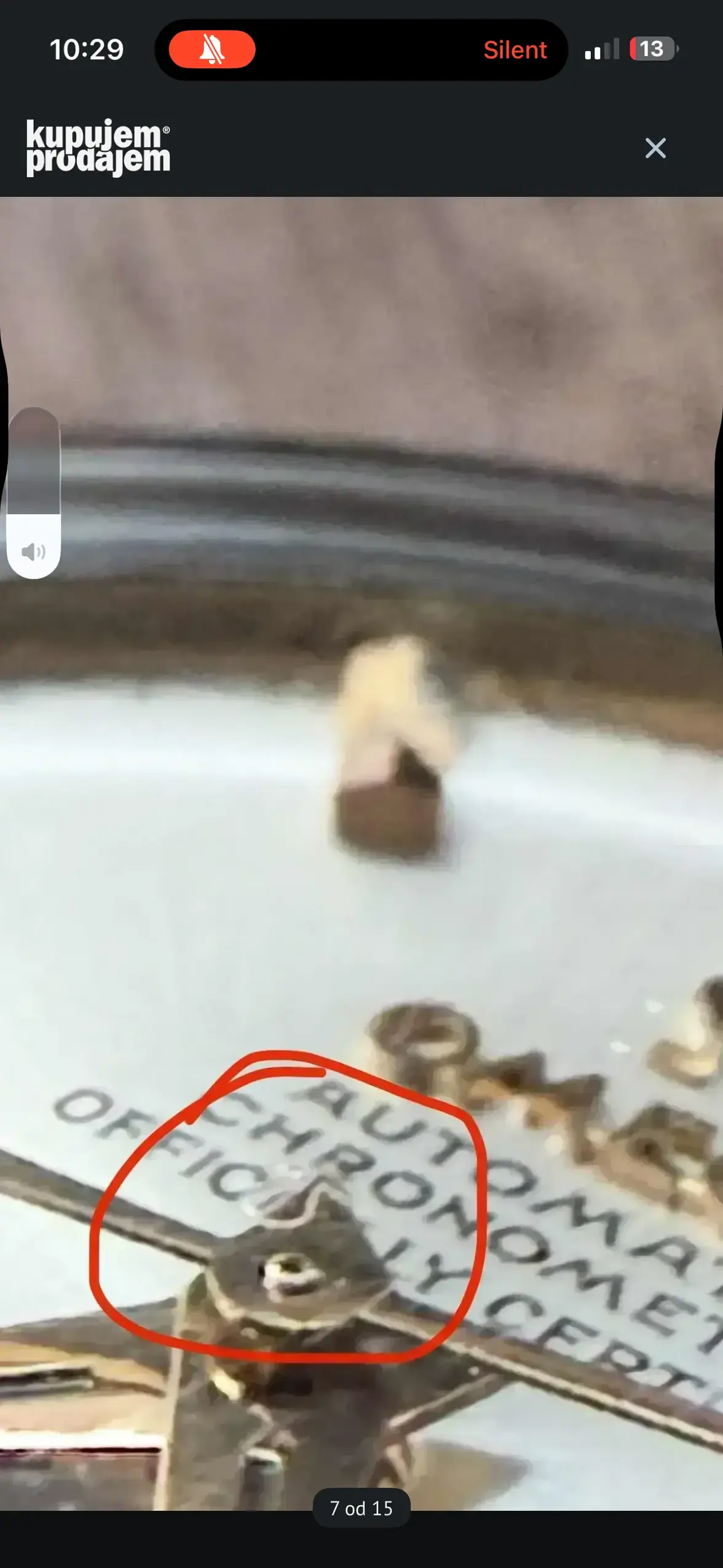

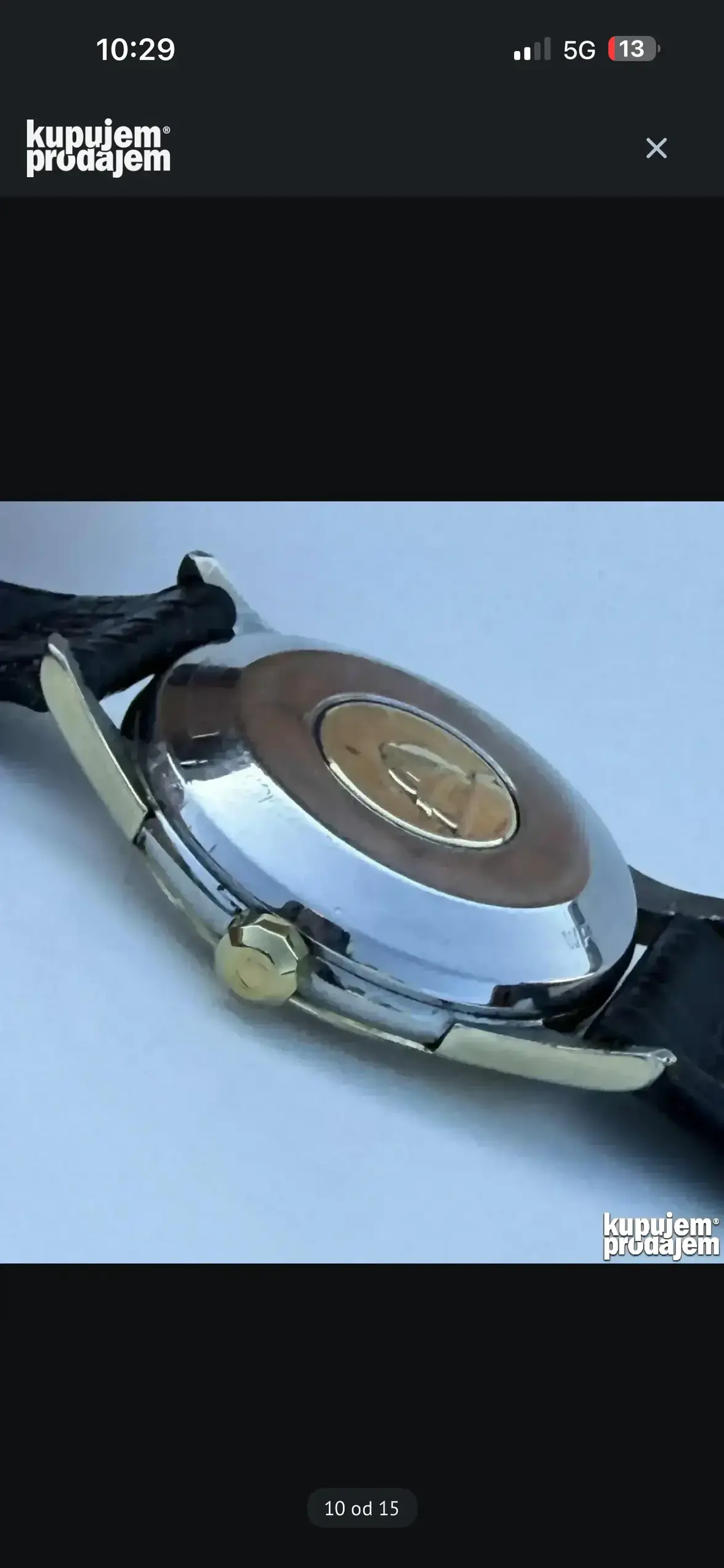

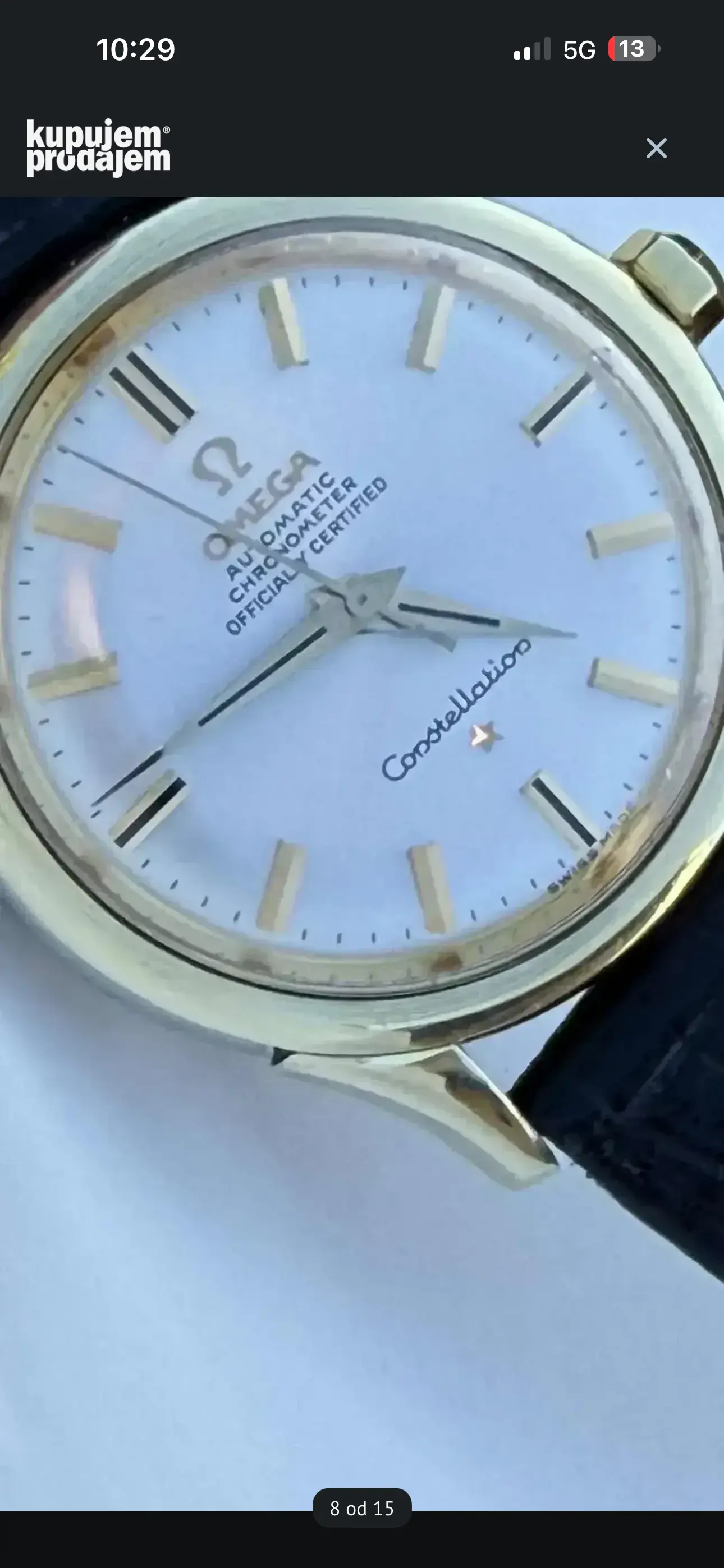

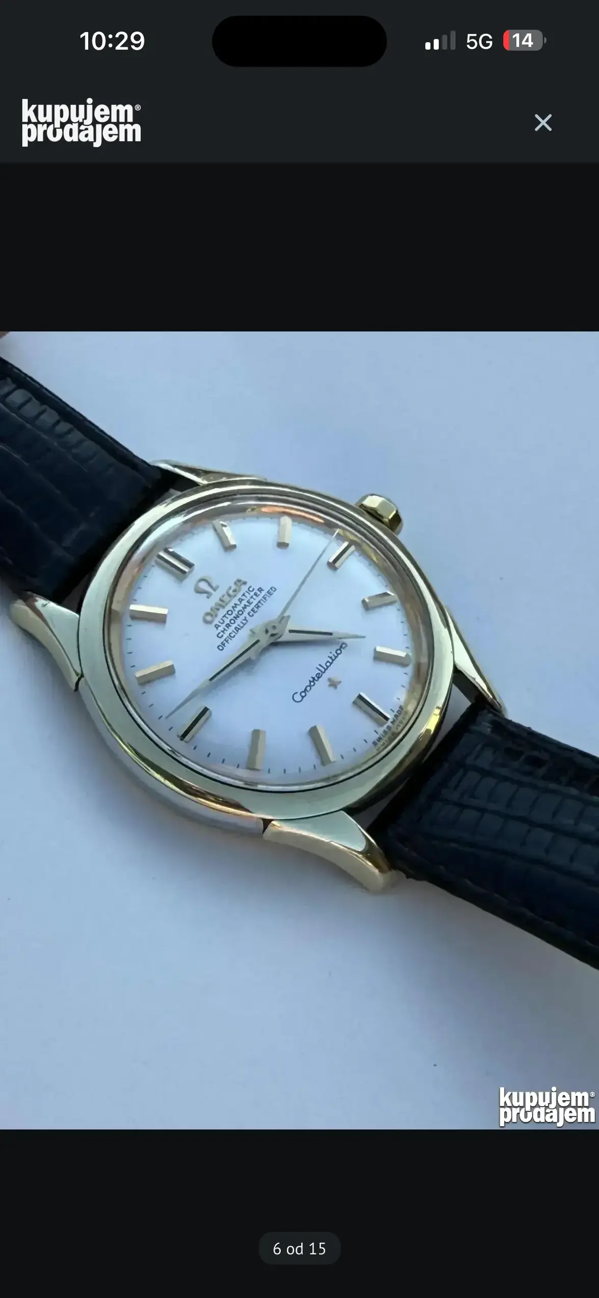

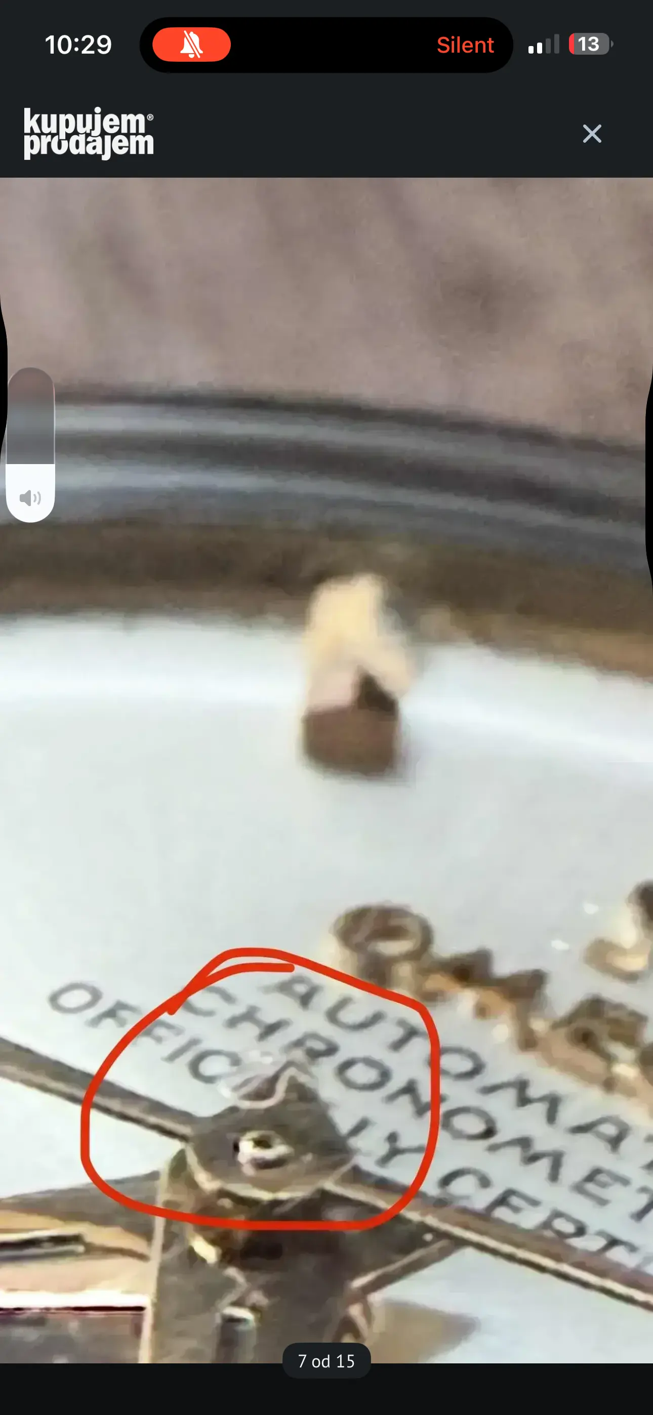

Please help me, after my speedmaster I want to buy my first vitage Omega so I'm afraid to make a mistake. Is there something you don't like about the watch from the pictures? looks like it has some replacement parts but i'm not sure. any help would mean a lot to me. Thank you.

It looks to me to be a bad redial in an over polished case, I wouldn't buy it.
63
163
I also think it's a re-dial: the minute markers are of different sizes and thickness (look, for instance, at minutes 2, 3, and 4); and the font of 'Constellation' is off.

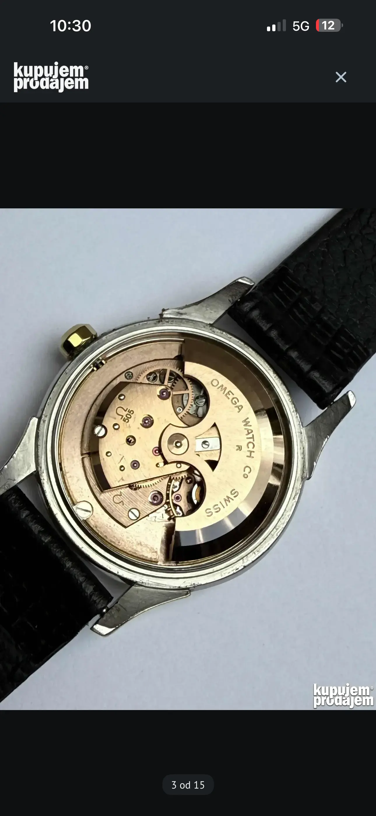

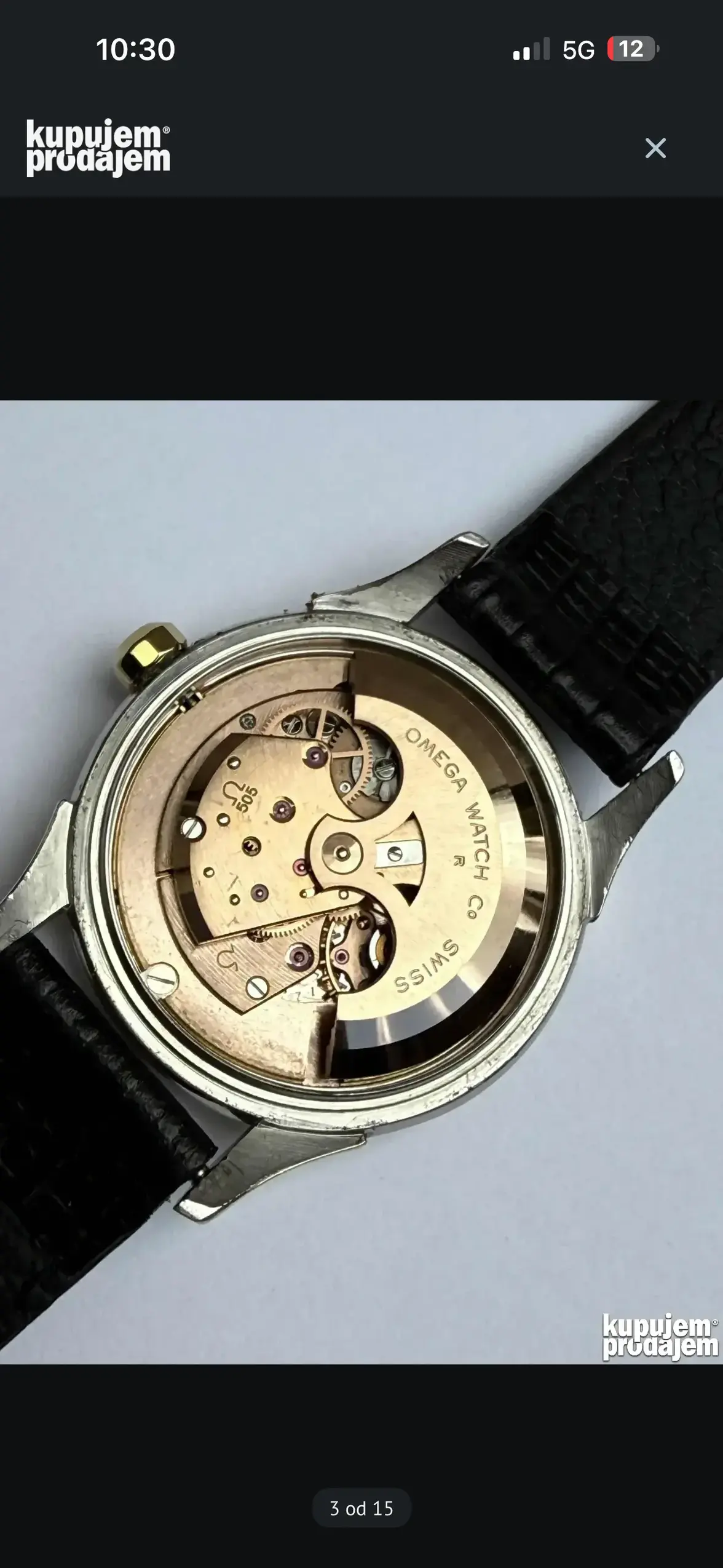

The movement (cal. 505) is at least correct for a 2852, though
162
160
On first glance, it strikes me as a redial.
Didn't these caliber 505s have the adjustment and jewel information printed on the rotor or was that only in some of them?
The rotor has an "R" mark. I think this indicates a service replacement from memory.
Maybe @Archer can verify?

Ah. That would explain it.

Always be suspicious of a 2852 with chronometer spelling.
Not sure about what that means. On the 55X/56X series the replacements have an "O" on them, so maybe, but not something I can say for sure.
