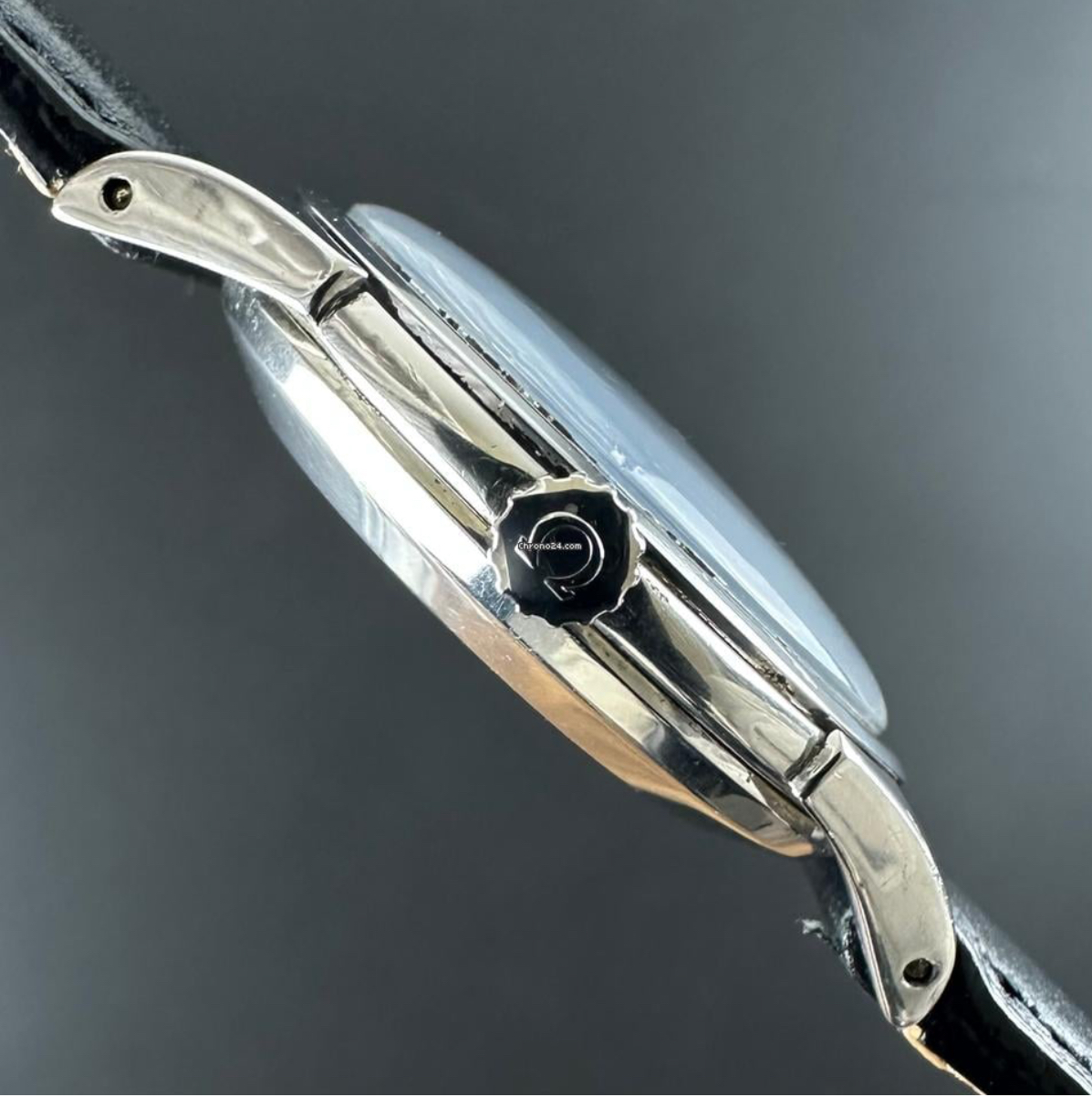

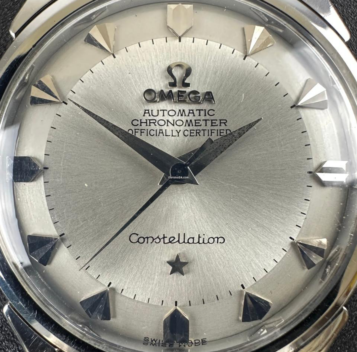

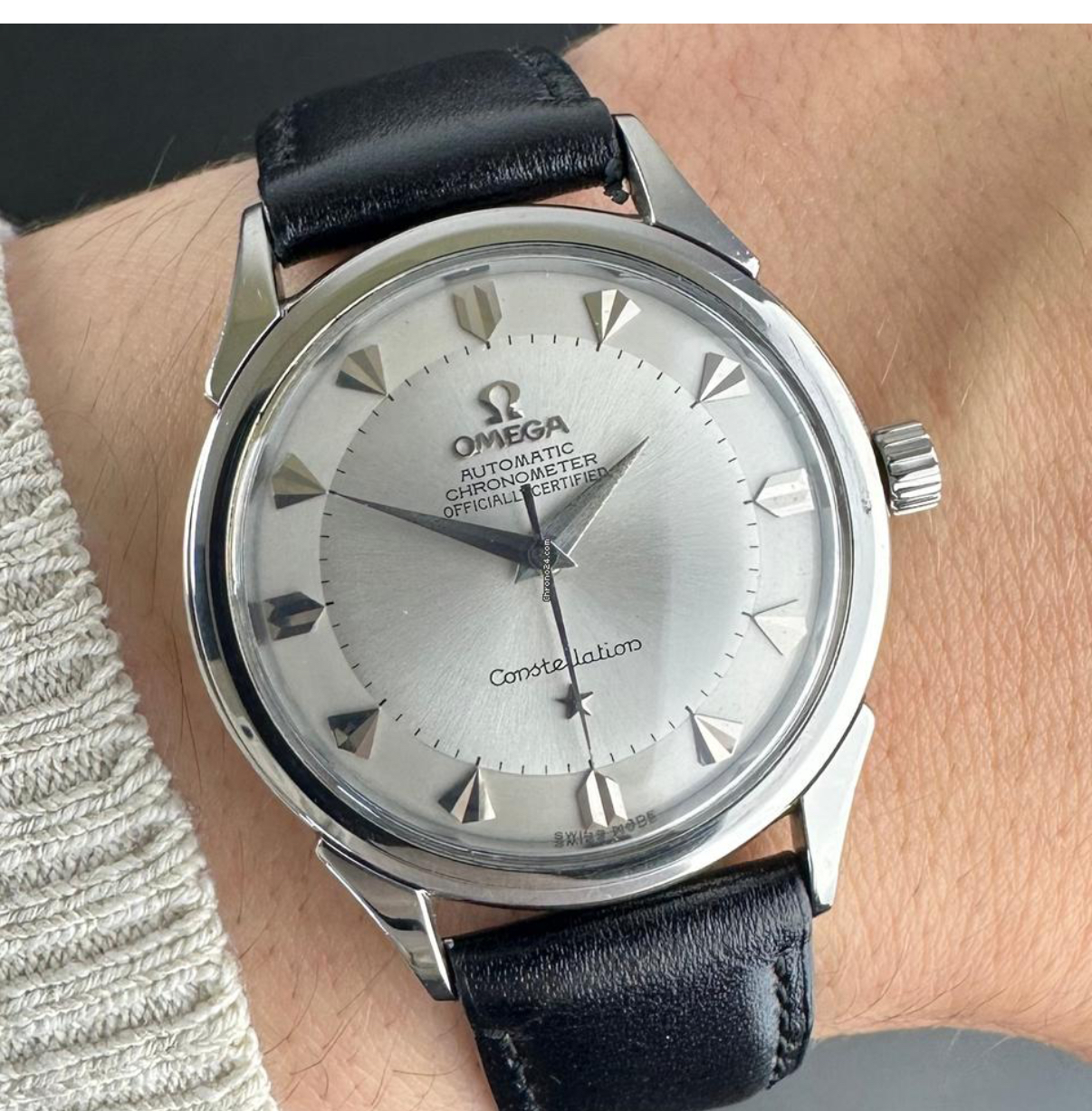

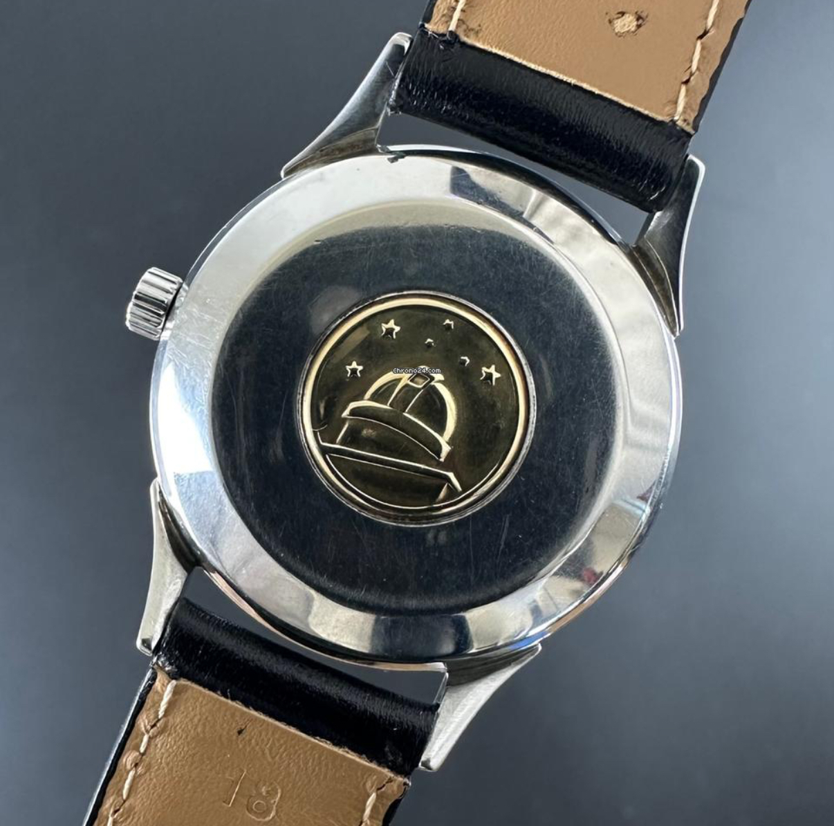

Hi everyone! 馃榾 I would like to know your opinion about this watch. It looks in very good condition. Thanks in advance for any advice and for sharing your knowledge

If you're looking for a collectible example, this would not be a good purchase. The dial is poorly repainted and the case is in very poor condition because it has been aggressively polished on a buffing wheel. I'd suggest taking some more time to study constellations and vintage watches in general, starting with the learn how to fish sticky.

Thank you very much Dan. I must admit I鈥檓 a bit lost with all the references. Fonts looked legit to me but I was wrong. How did you spot it was repainted? would you suggest any source for studying besides this forum? thanks!

Study a few thousand examples and it will be dead obvious within 2 seconds.

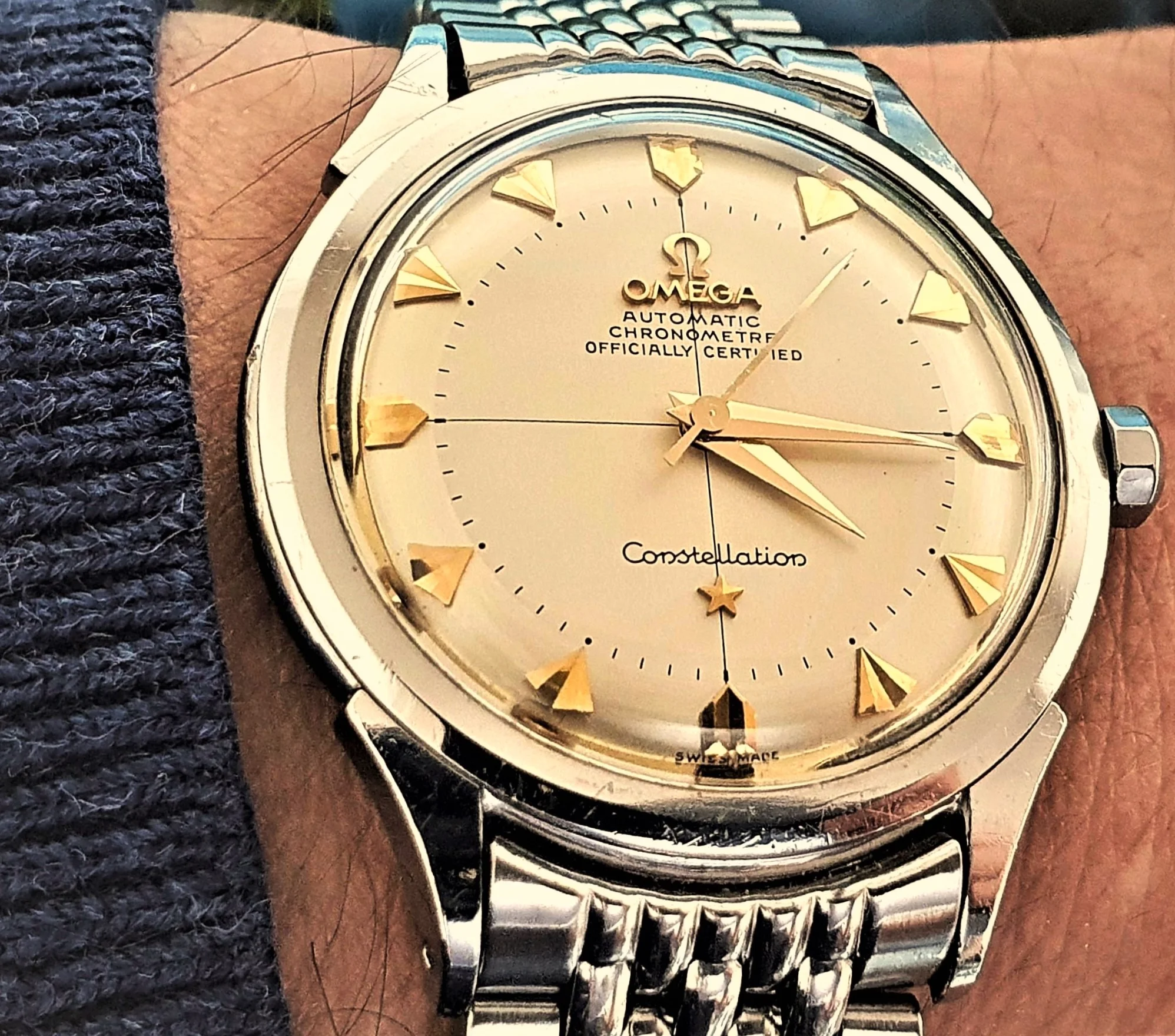

I might be wrong since I'm new too, but I'll try from what I think. The font is wrong, especially in above section. It may be closer to 60's model. It should be "RE" instead of "ER" in chronometer. For this reference, hour markers should be dots not small rectangles. Besides, it doesn't seem to pass the MOY test.

Thank you very much! I鈥檓 studying more using the omega collectors blog that Peemacgee suggested.Lots in inconsistencies in the font indeed
