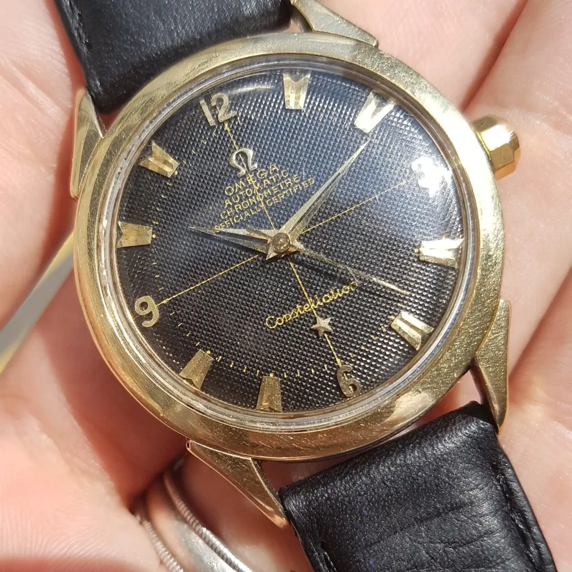

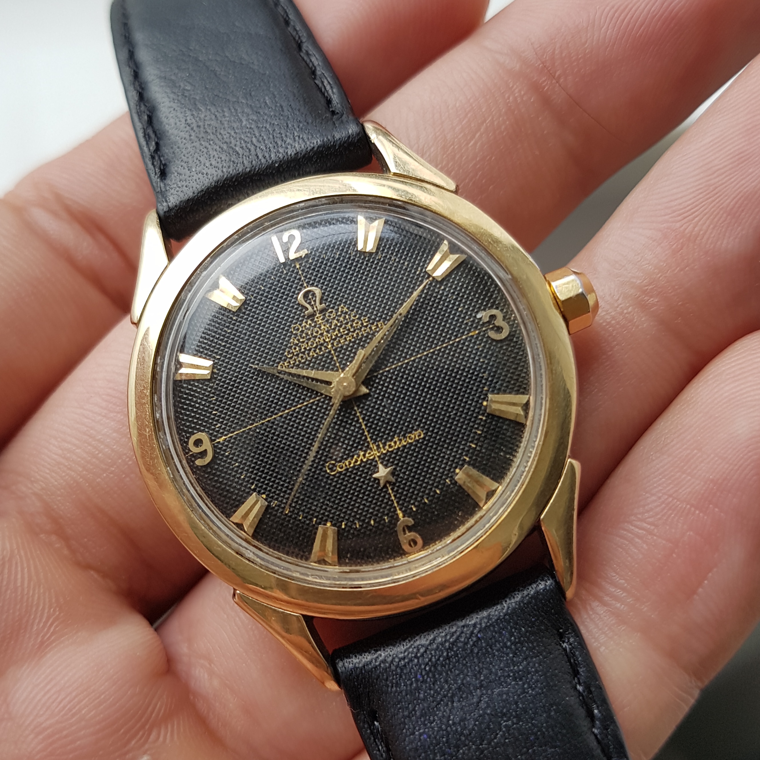

Even the rarer the original black waffle-dial version sold on the forum for only around US$3,000.
7
3
That’s far too expensive for this frankenwatch.
When was this black dial sold? Could you be so kind to share the link? 🙏🙏
250
740
I believe it was this 2652 sold back in 2018, here:
