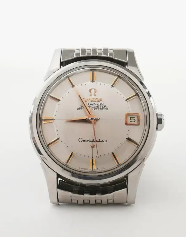

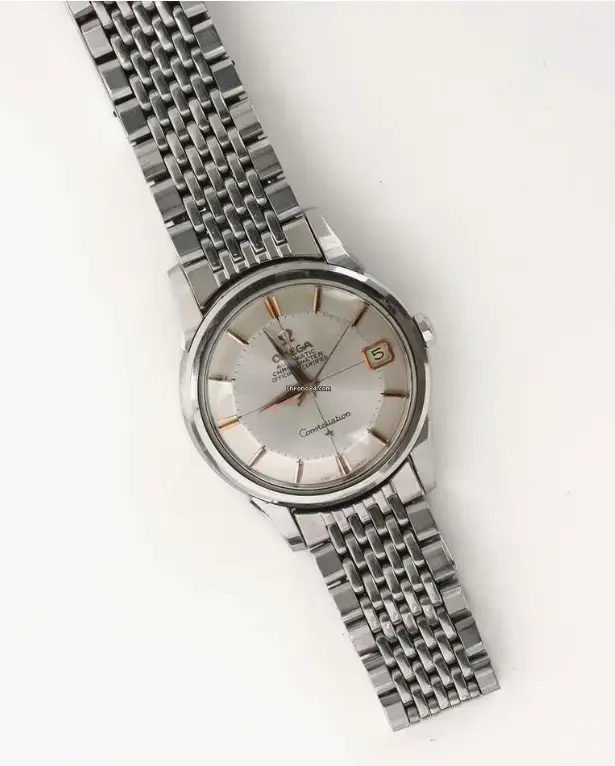

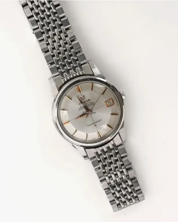

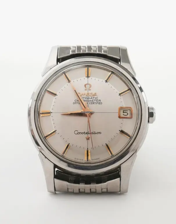

Before we weigh in, what are your concerns?
Am somewhat new to Omega and don’t have the level of knowledge others have. I haven’t seen a ton of these mixed metals dials. Want to know before I consider buying
6,832
10,502
My immediate concern would be - if the listing says it is a 168.005.
After that, the hands being over the text and the less than sharp pics are somewhat of a hindrance to assessing the dial.
4
As a newbie and still finding my feet, I would guess the 'S' doesn't look right in Constellation
8,877
62,872
Well, all the fonts and spacing all over the dial is wrong including that "s". Plus the heavy handed placement of the ink.
