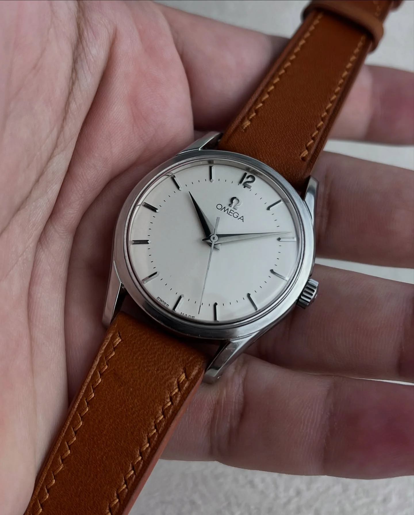

Need advice: Is this cal 283 dial a re-dial?
4

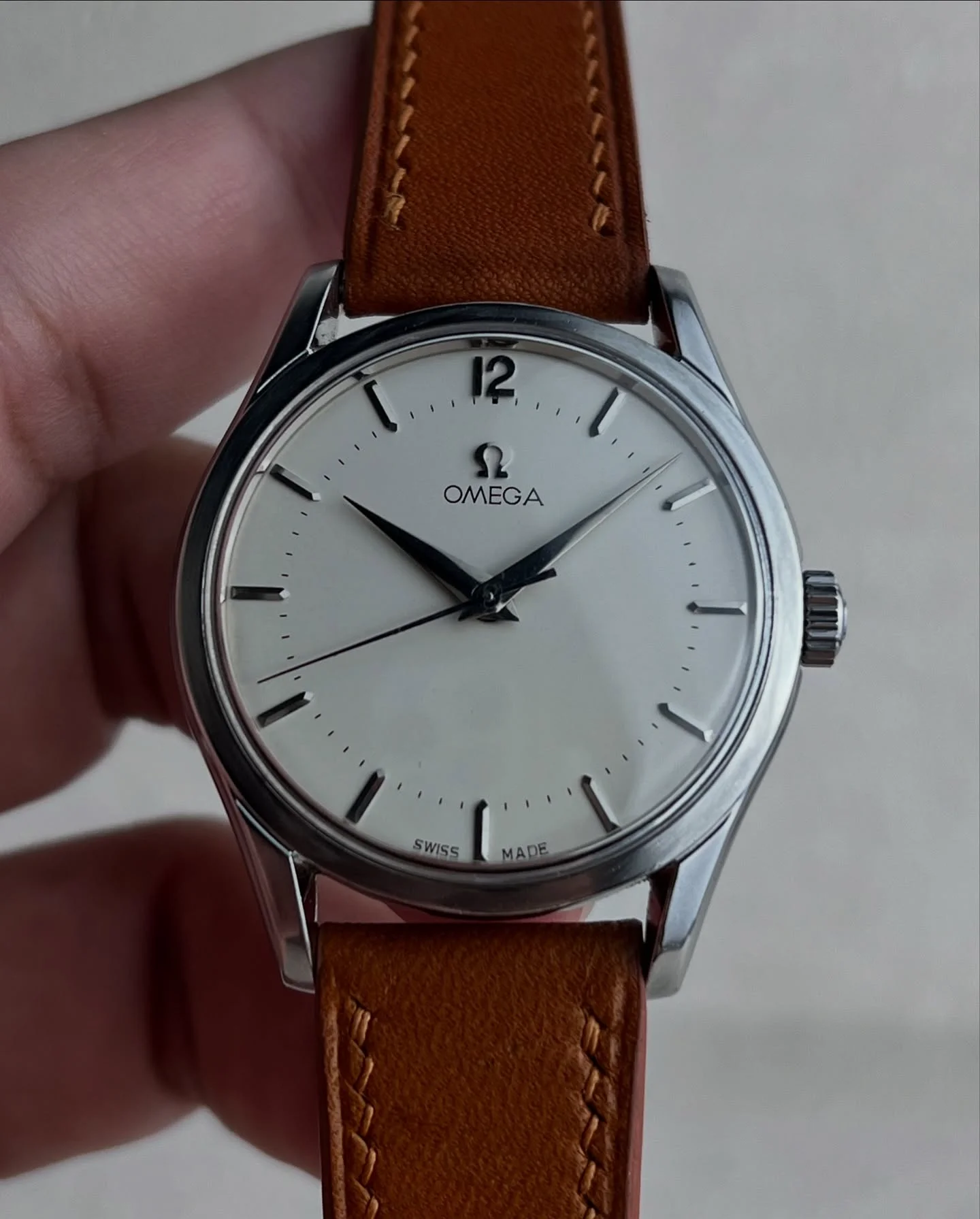

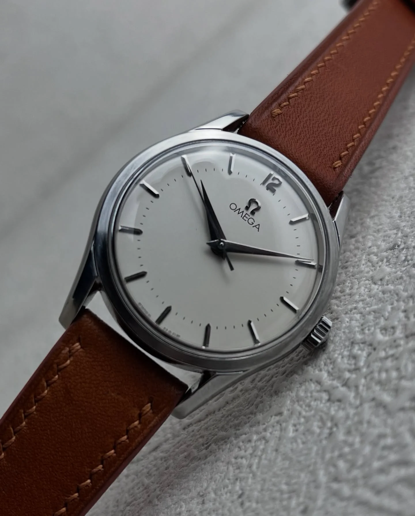

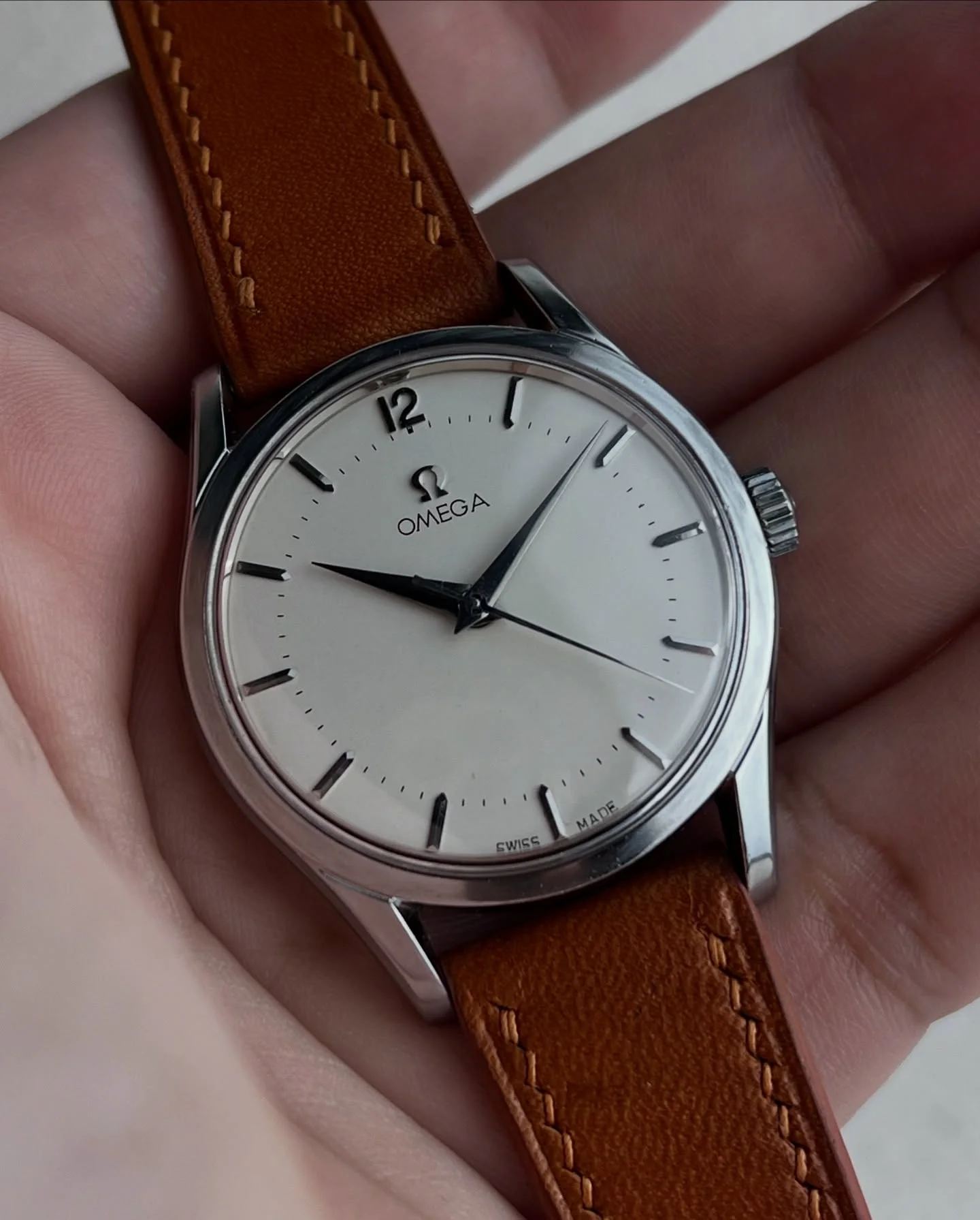

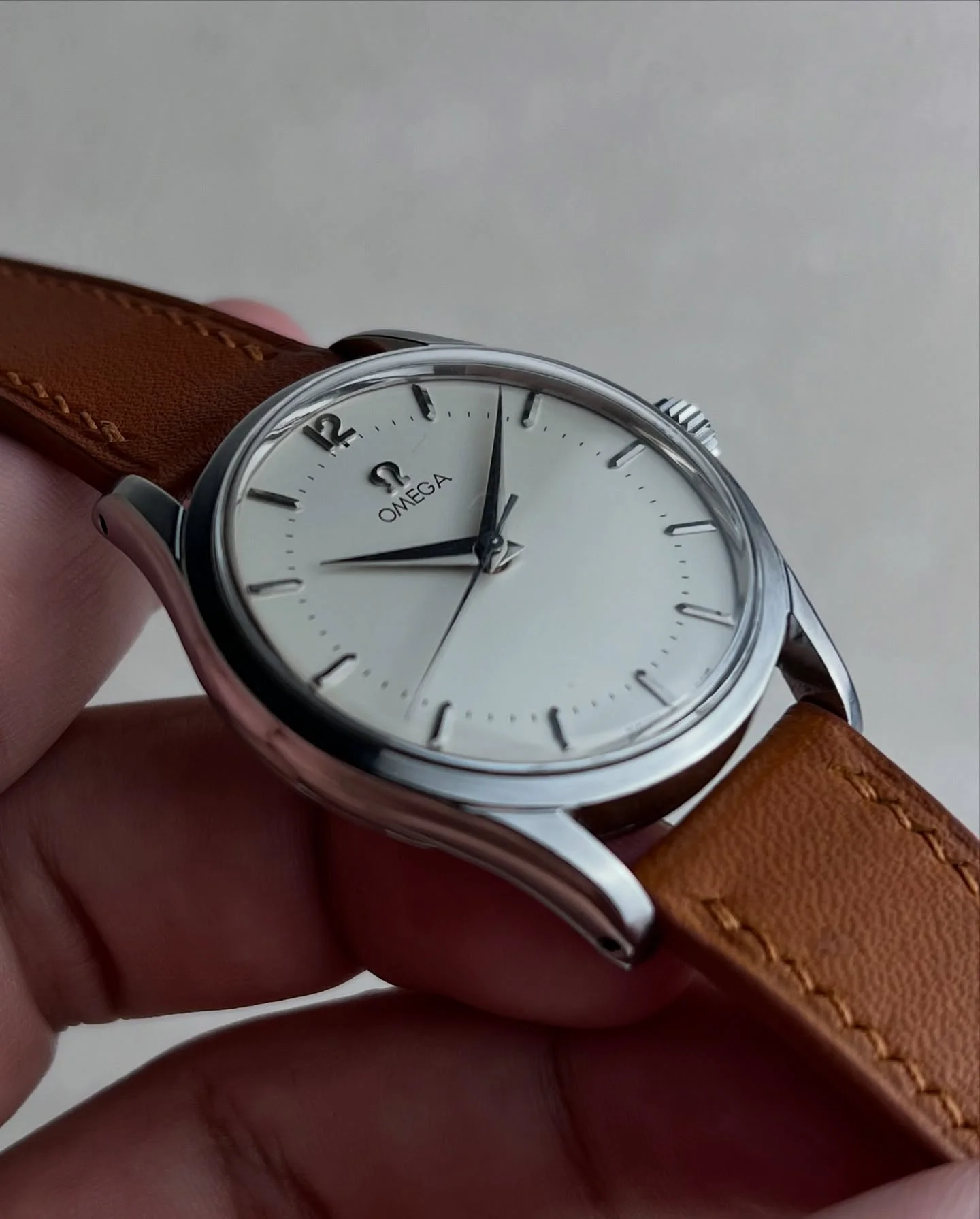

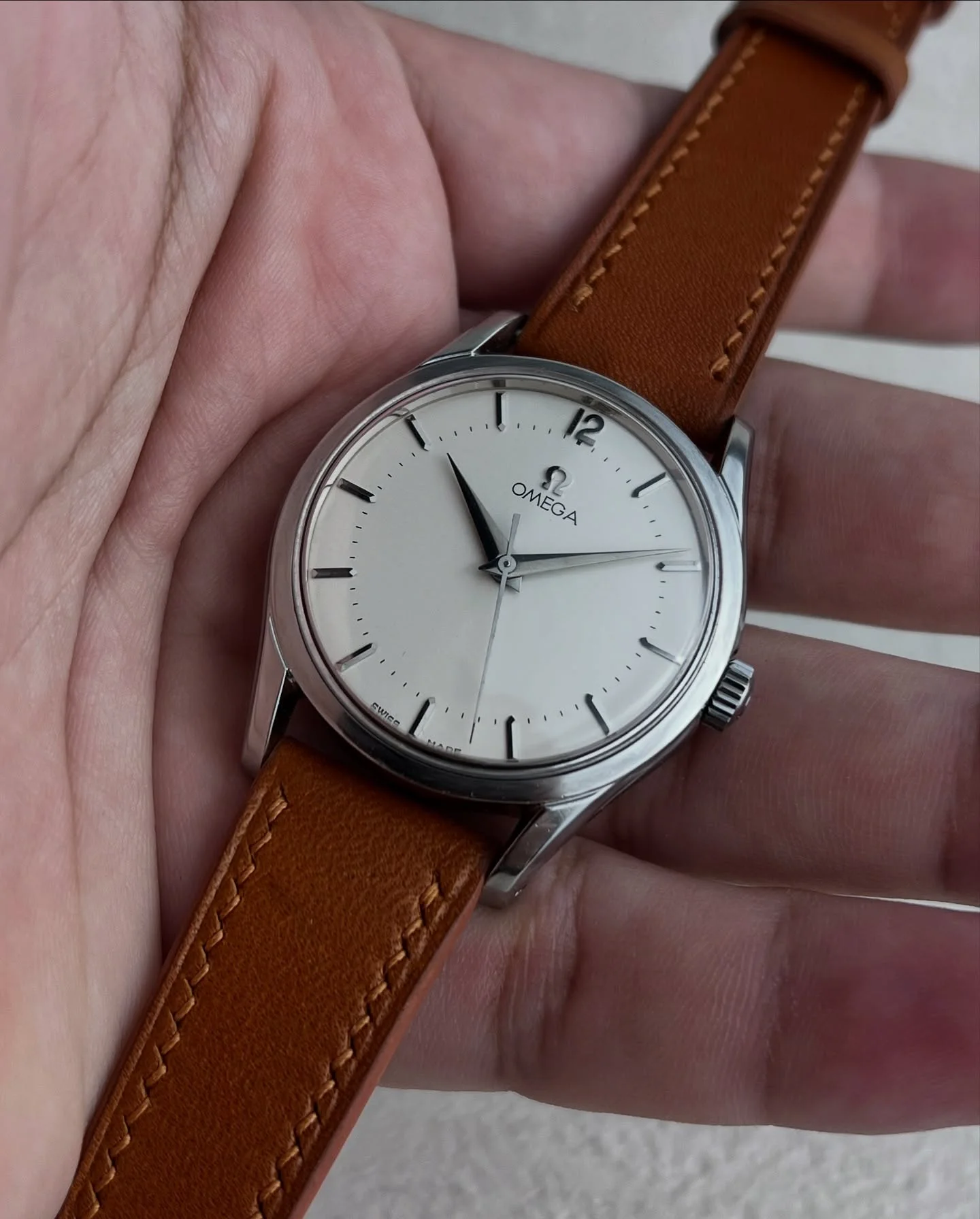

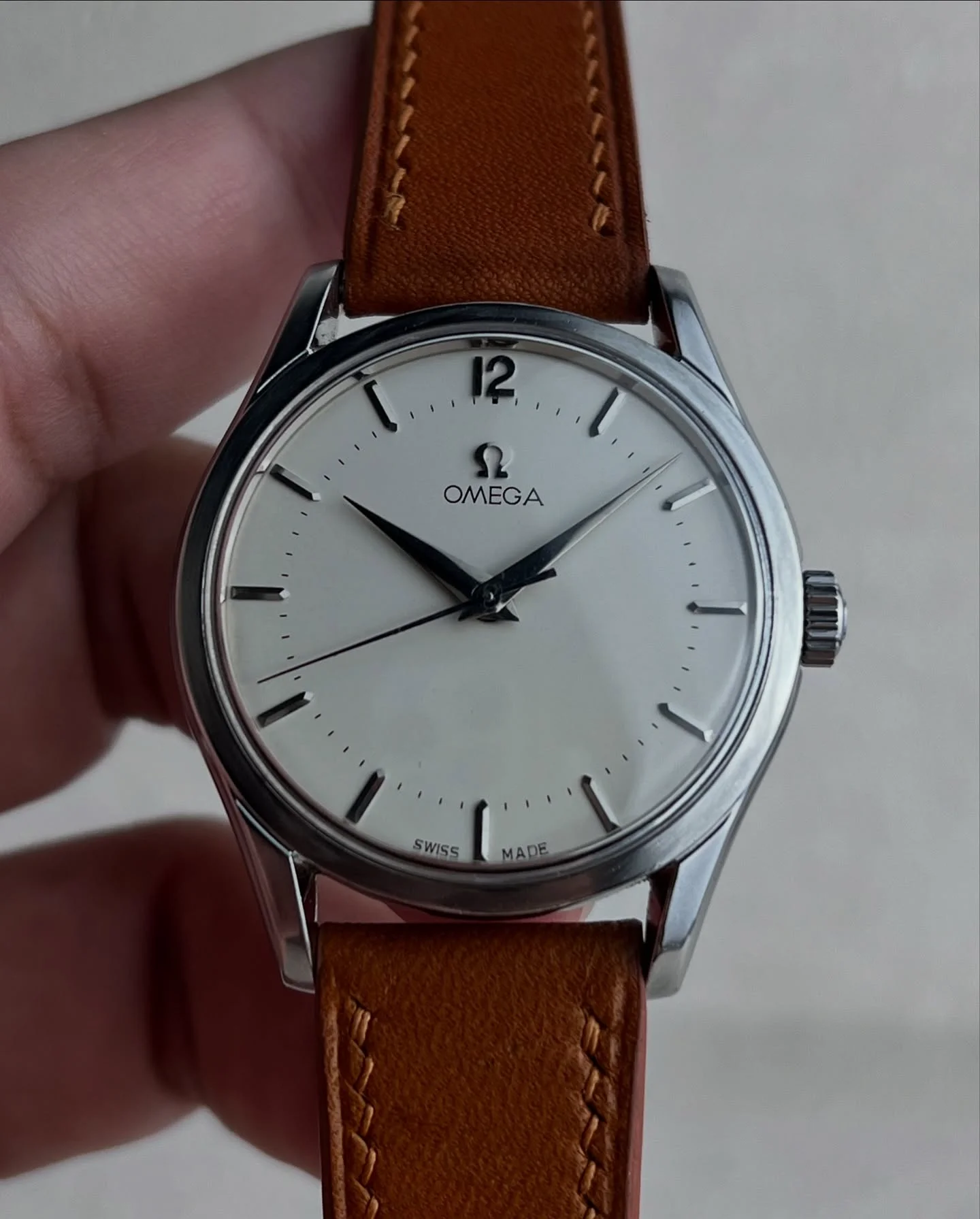

Hi.. a new member here looking for buy first omega vintage watch
I found this listing from a local online seller: Omega cal 283. The dial looks very clean, but I cant decide whether the dial is original or a repaint? I found that the Omega font is suspicious, but I might be wrong.
The seller asking for around 750 usd
Any input would be very appreciated, thank you!

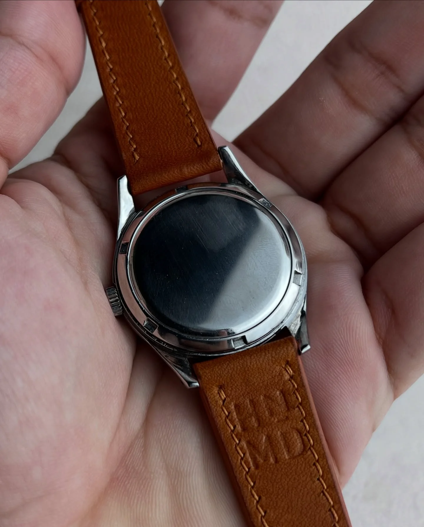

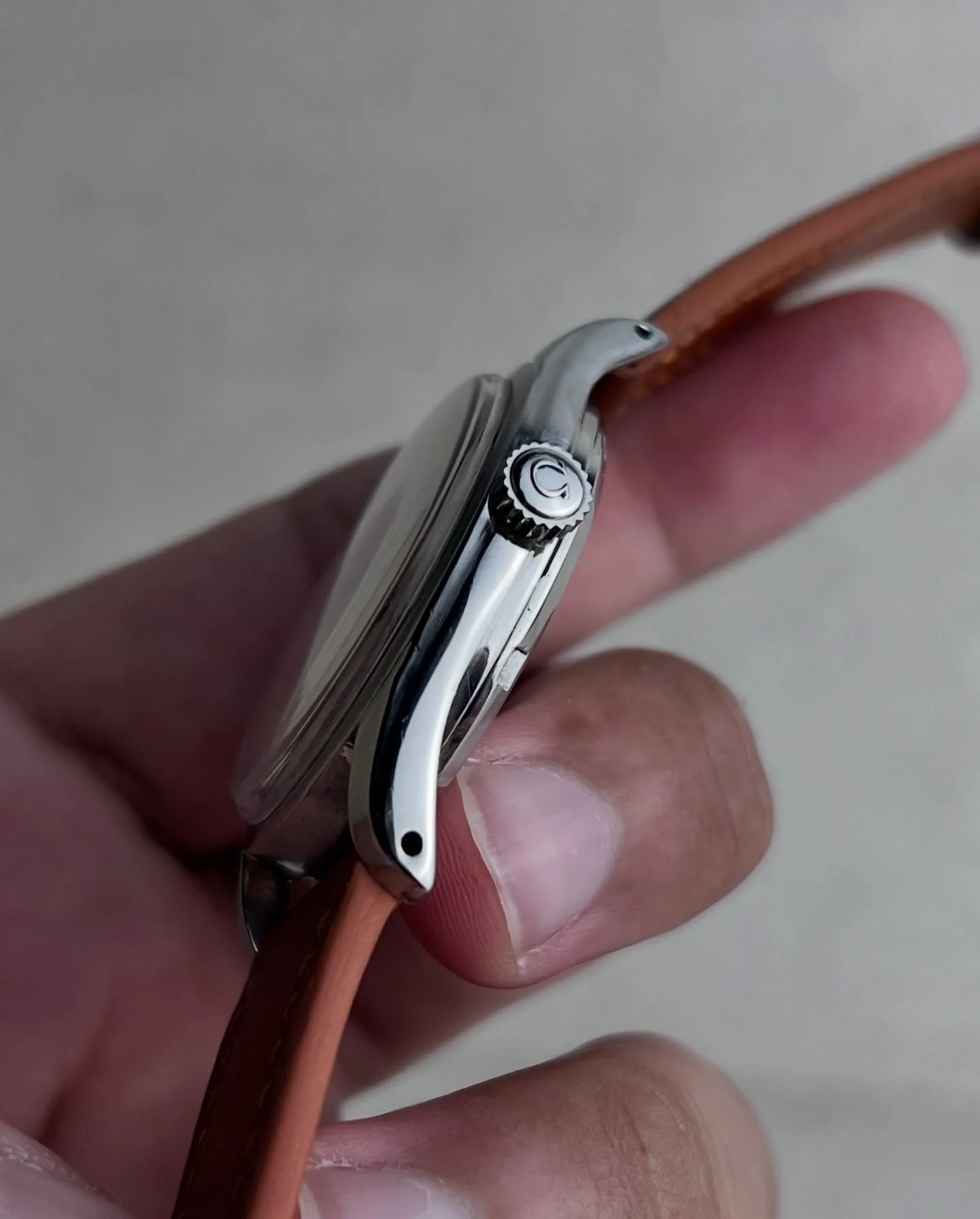

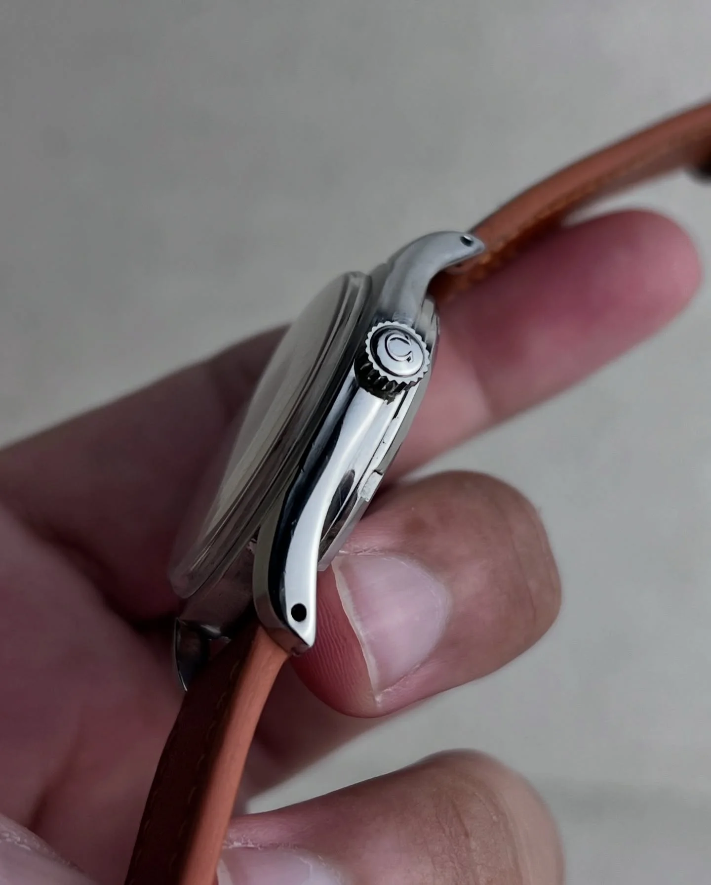

Repainted and polished case and probably a replacement crown.

Redial. Look at the font and the spacing of the minute hashes, particularly around 4 oclock

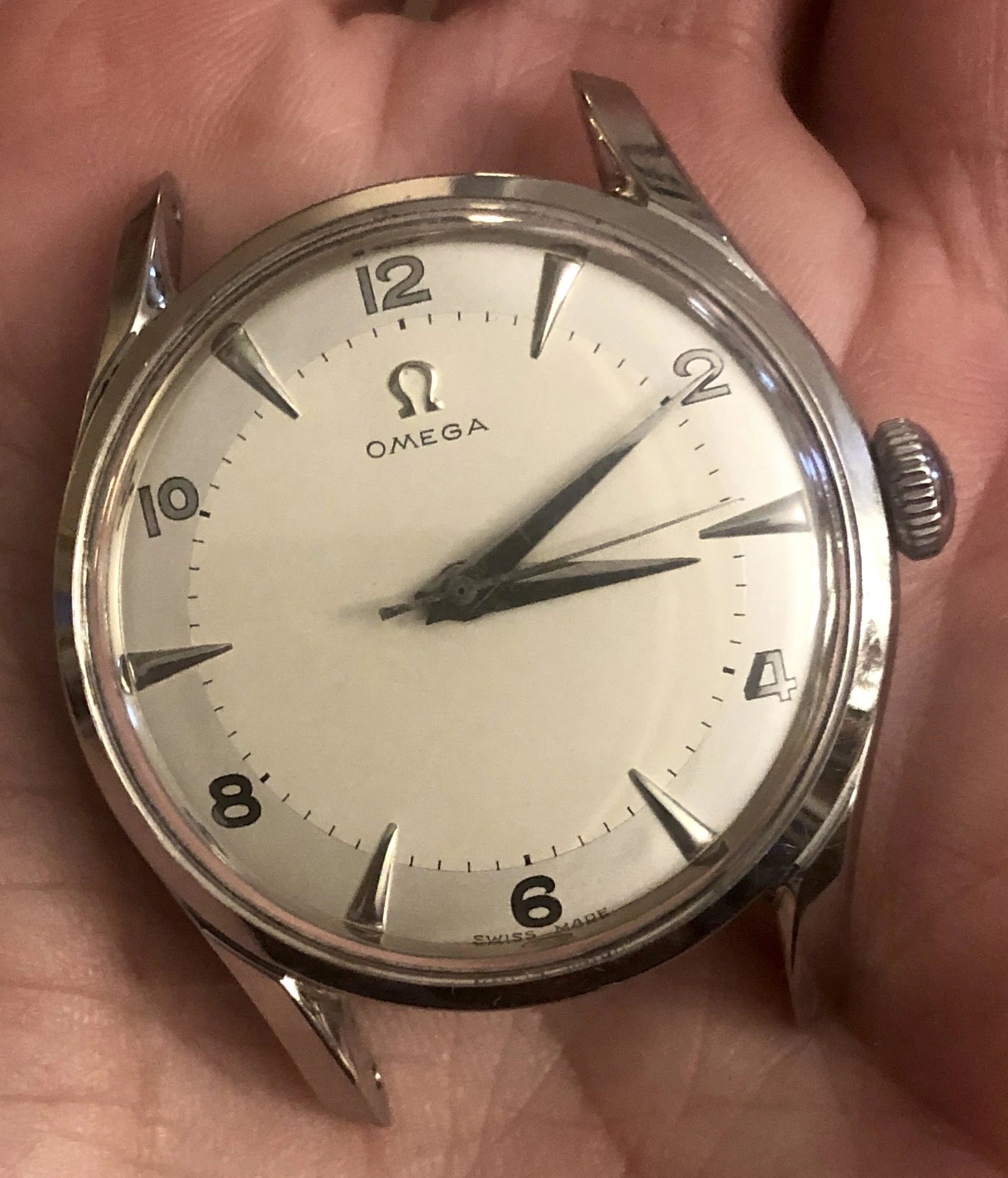

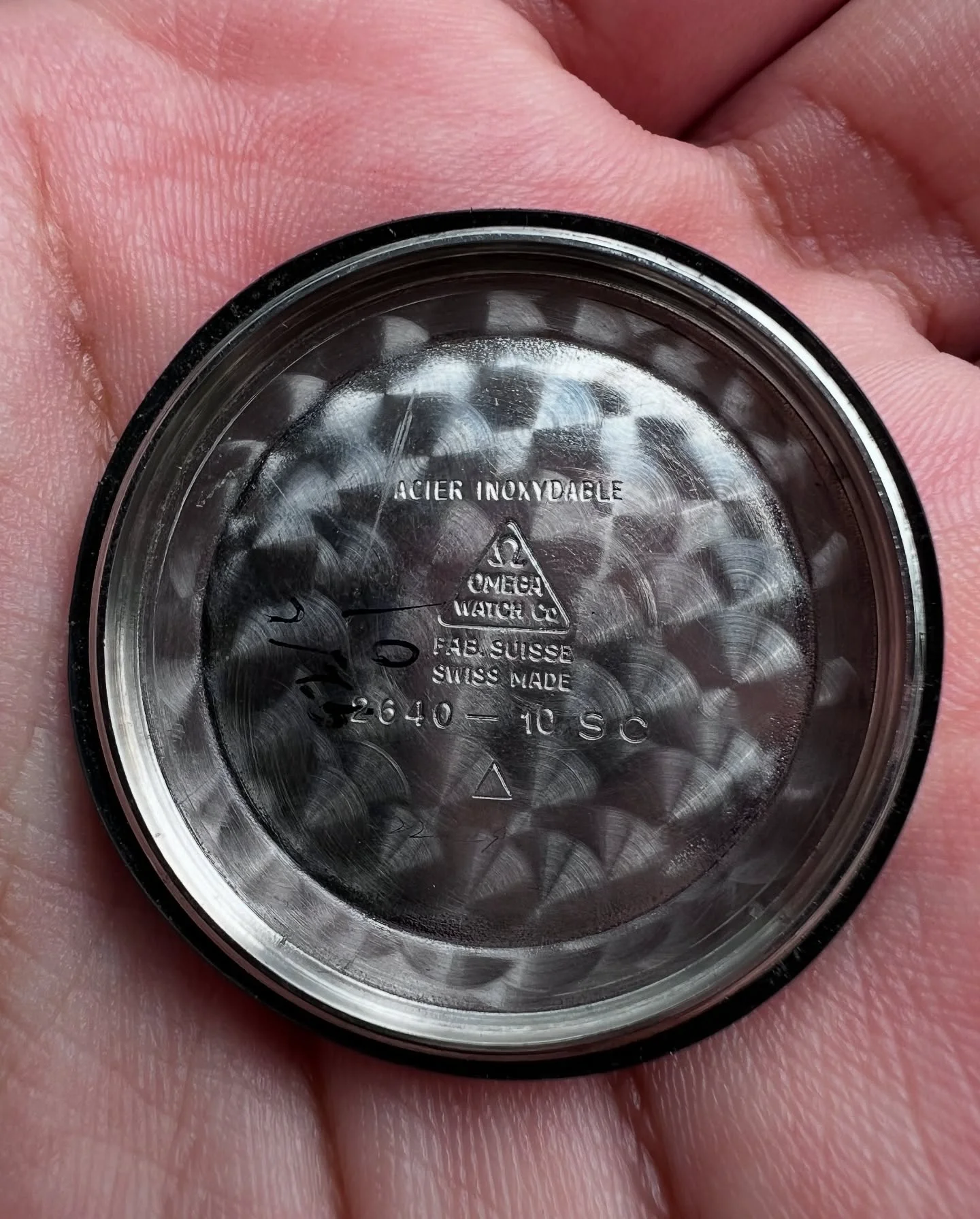

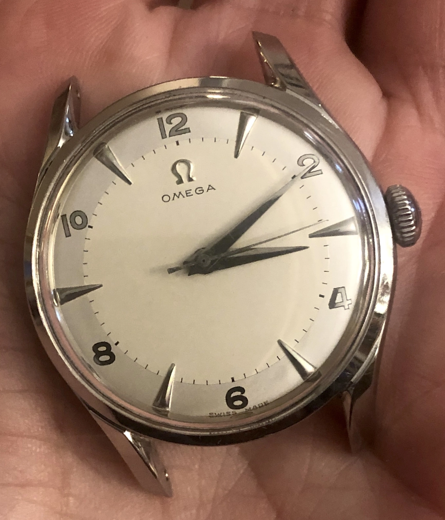

My 2640.
thanks for the photo reference! so the font is in really different style and its indeed a repaint. good to know!

thats 3 reason to not buy it then. thanks for the suggestion too! I will look for cal 601 as I searching for manual one.
one thing that Im curious, may I know how did you found that the case is polished?
yeah after look into it again, around 4 oclock indeed has different space. thanks for pointing it out!
