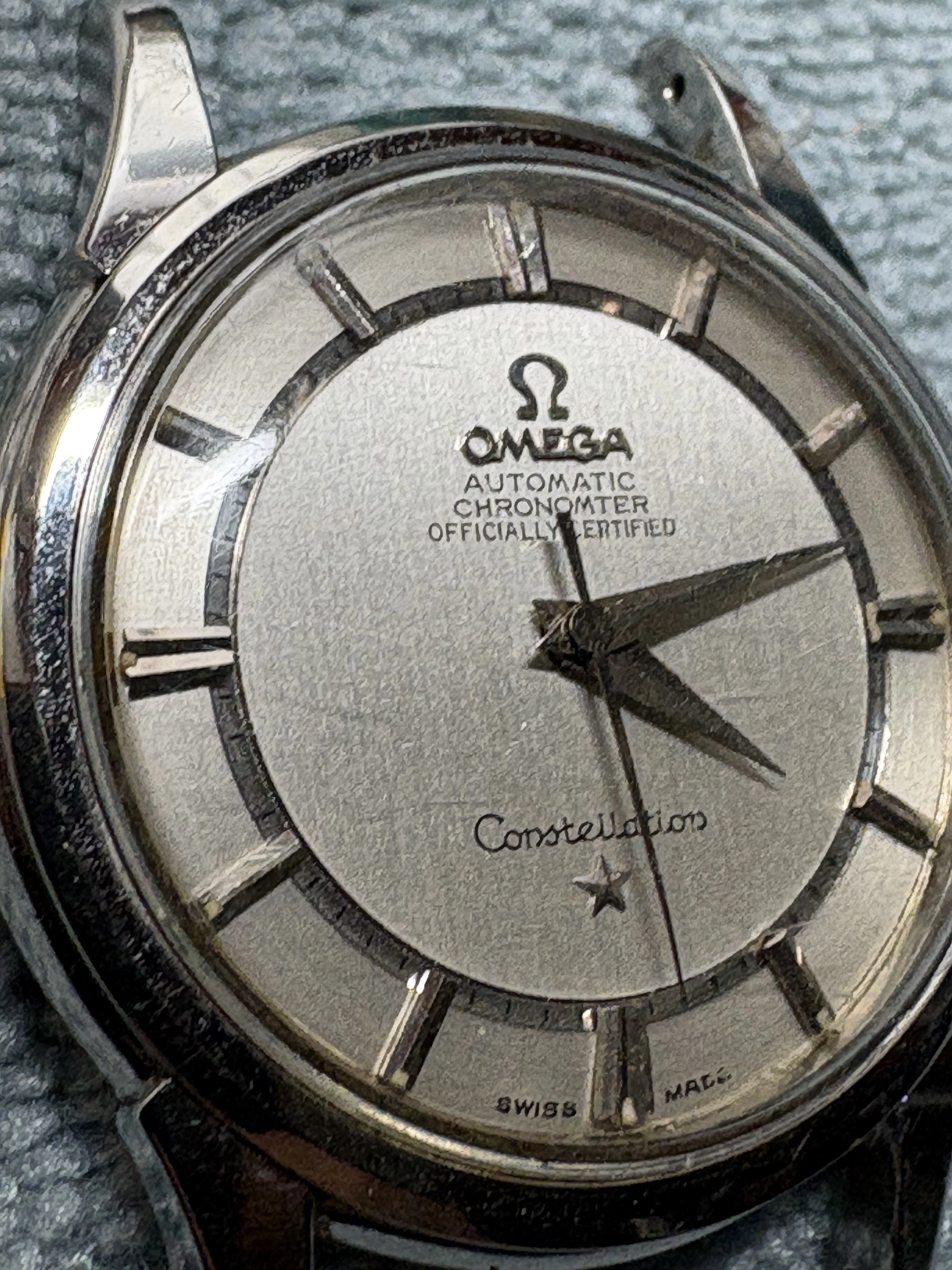

Hello everyone,
I would appreciate some help from the vintage Omega experts here.

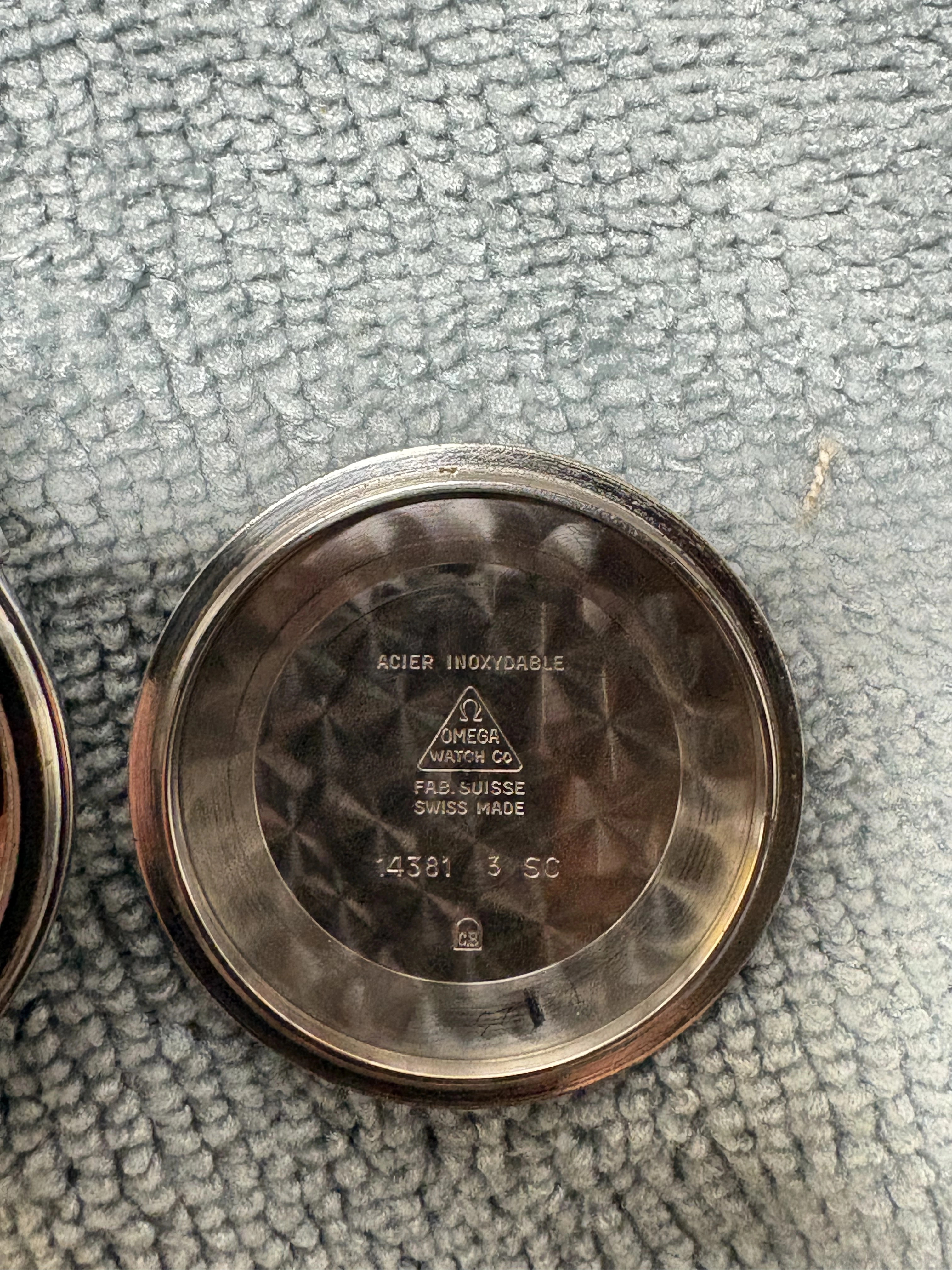

I have a vintage Omega Constellation ref. 14381-3-SC, fitted with a Cal. 551 automatic chronometer movement, serial number 17012667.
This watch belonged to my grandfather. It had been stored in a drawer for more than 40 years, and I recently took it out again.
The case and movement appear to be consistent with a late-1950s / circa-1960 Constellation 14381. The caseback is marked 14381 3 SC, and the movement is Cal. 551.

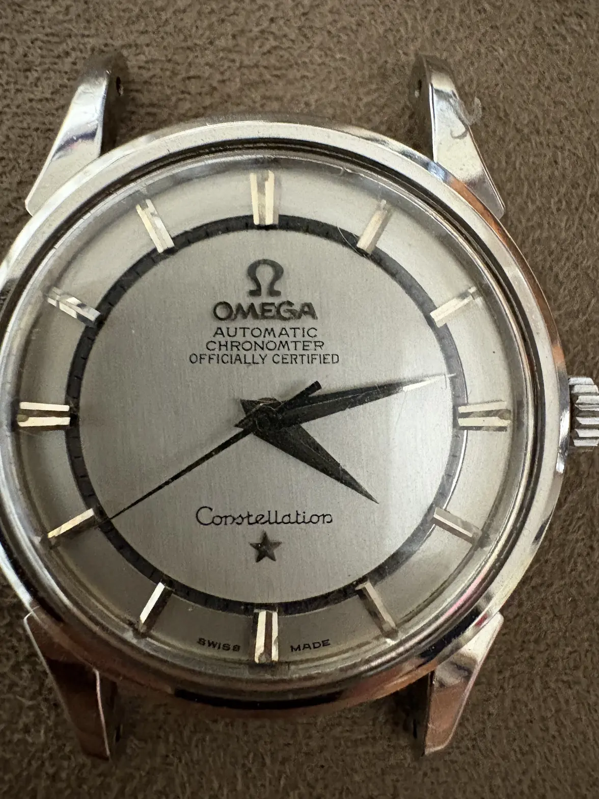

However, I noticed something unusual on the dial.
The dial clearly reads:
“CHRONOMTER”
There is no “E” between the M and T.
I have looked at quite a few examples of original 14381 dials, but I have not been able to find another example with this exact spelling.
My question is very specific: has anyone here ever seen a confirmed-original Omega dial with “CHRONOMTER” spelled this way?
If so, I would be very grateful if you could post a photograph or provide a reference to the watch.
I am not simply looking for opinions on whether the dial “looks right”. I would particularly like to know whether this spelling has ever been documented on an original Omega dial.
I have attached photographs of the dial, the caseback, and the movement.
Thank you very much for taking the time to look at it.

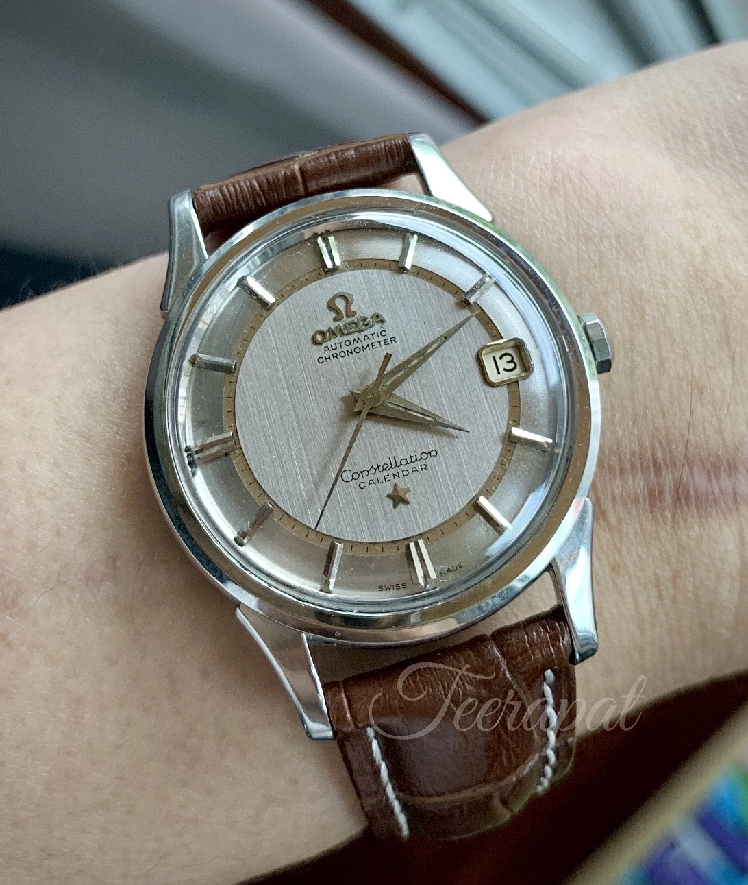

Spelling errors like this are telltale sign of a redial.
14381 ref generally, but not always, has 2 lines of text at top, without Officially Certified like this example. Some have 3 lines.
Railtrack dial seen on some.
The font is off and the surface texture of dial also support redial. This was commonly done back in the day at time of service to make watch look better if there was water damage for example. It’s still a nice watch and heirloom.

Thank you very much for your detailed reply and for posting the comparison photo.
Your comments about the font and the surface texture are very helpful.
I was particularly unsure about the “CHRONOMTER” spelling, as I have not been able to find another example with this exact spelling.
It is also interesting to see another 14381 with a railtrack dial.
Since this watch belonged to my grandfather and had been stored in a drawer for more than 40 years, it is quite possible that the dial was refinished during a service many decades ago.
Would you consider the “CHRONOMTER” spelling itself to be strong evidence of a redial, based on your experience with vintage Omega dials?
Thank you again for taking the time to examine it and share your experience. I really appreciate it.
100%

As above the dial has been repainted at some point in its life.
The lettering on the dial is close but not as original Omega fonts and arrangement and there are no original Omegas with that spelling of chronometer.

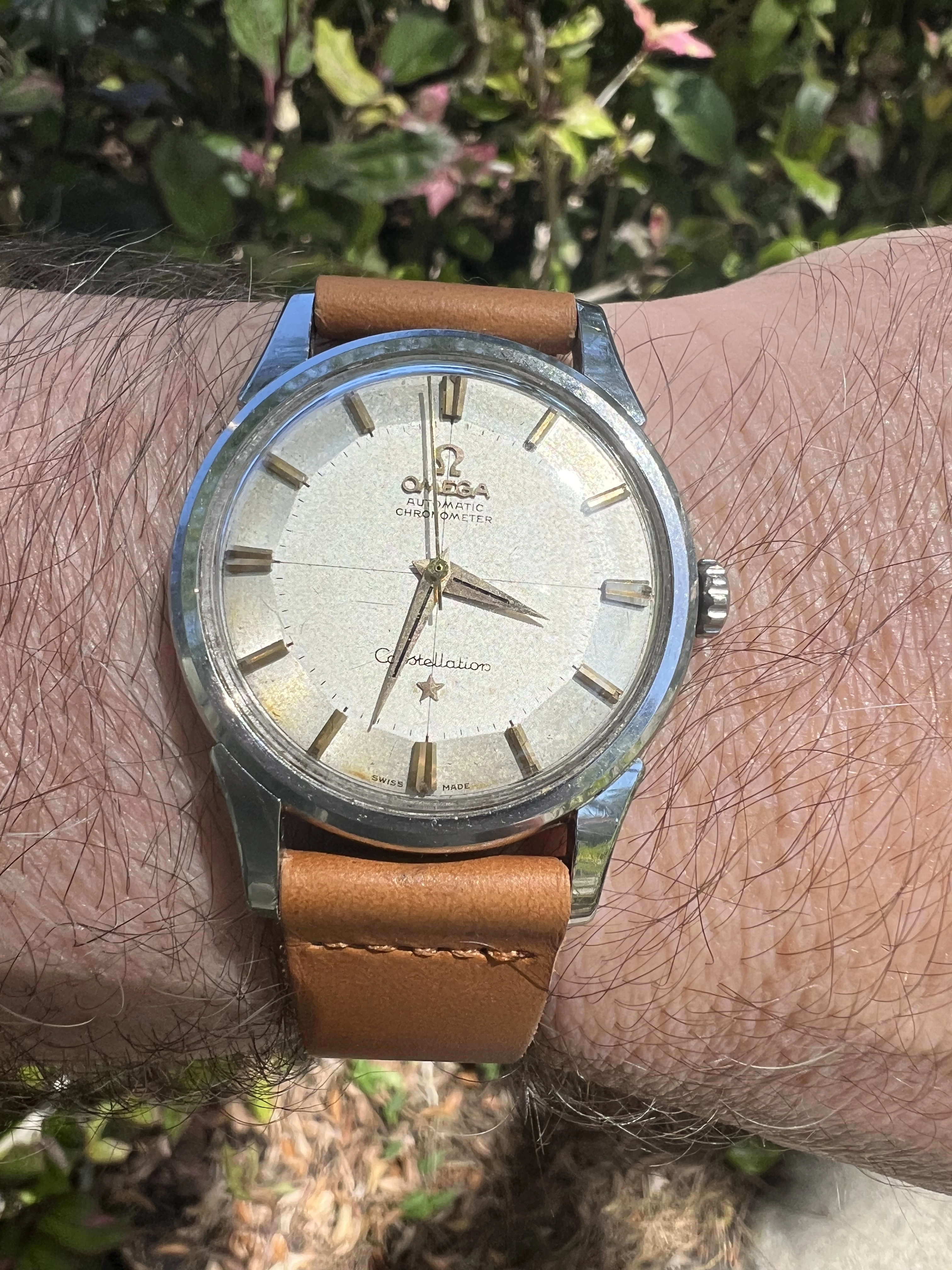

My rail-track Constellations all look like this, and from what I remember, the other examples I’ve seen also came “without” the words Officially Certified.

Thank you very much for your detailed reply and for taking the time to examine my watch.
Your explanation about the lettering, font and surface texture is very helpful.
I was particularly interested in your comment that you have not seen an original Omega with the “CHRONOMTER” spelling. This was exactly the point I was hoping to clarify when I started this thread.
I had suspected that the dial might have been refinished, but I wanted to hear from people with experience with vintage Constellations before drawing a conclusion.
Since the watch belonged to my grandfather and had been stored in a drawer for more than 40 years, it is quite possible that the dial was refinished many decades ago, perhaps during a service.
I will also have a look at the Constellation threads and Desmond’s website you recommended.
Thank you again for your help. I really appreciate you sharing your experience with me.

Once you have looked at a few (hundreds) of Constellation dials the redial is quite obvious - but not necessarily so obvious to the uninitiated.
However, this doesn’t mean that you shouldn’t enjoy your grandfather’s watch as it is - as a rather splendid heirloom.
(It even comes with its own amusing anecdote about a dyslexic watch restorer)
