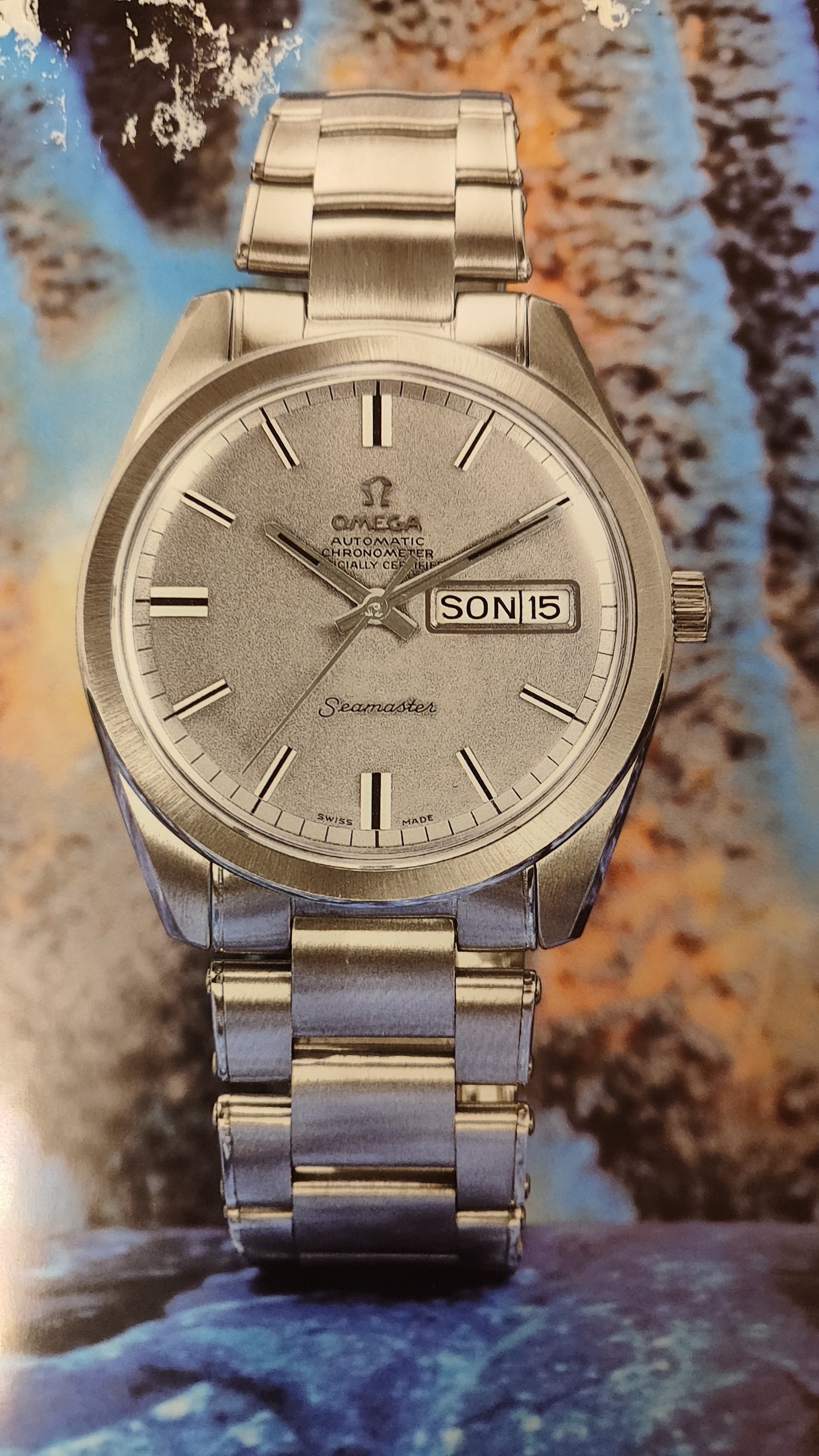

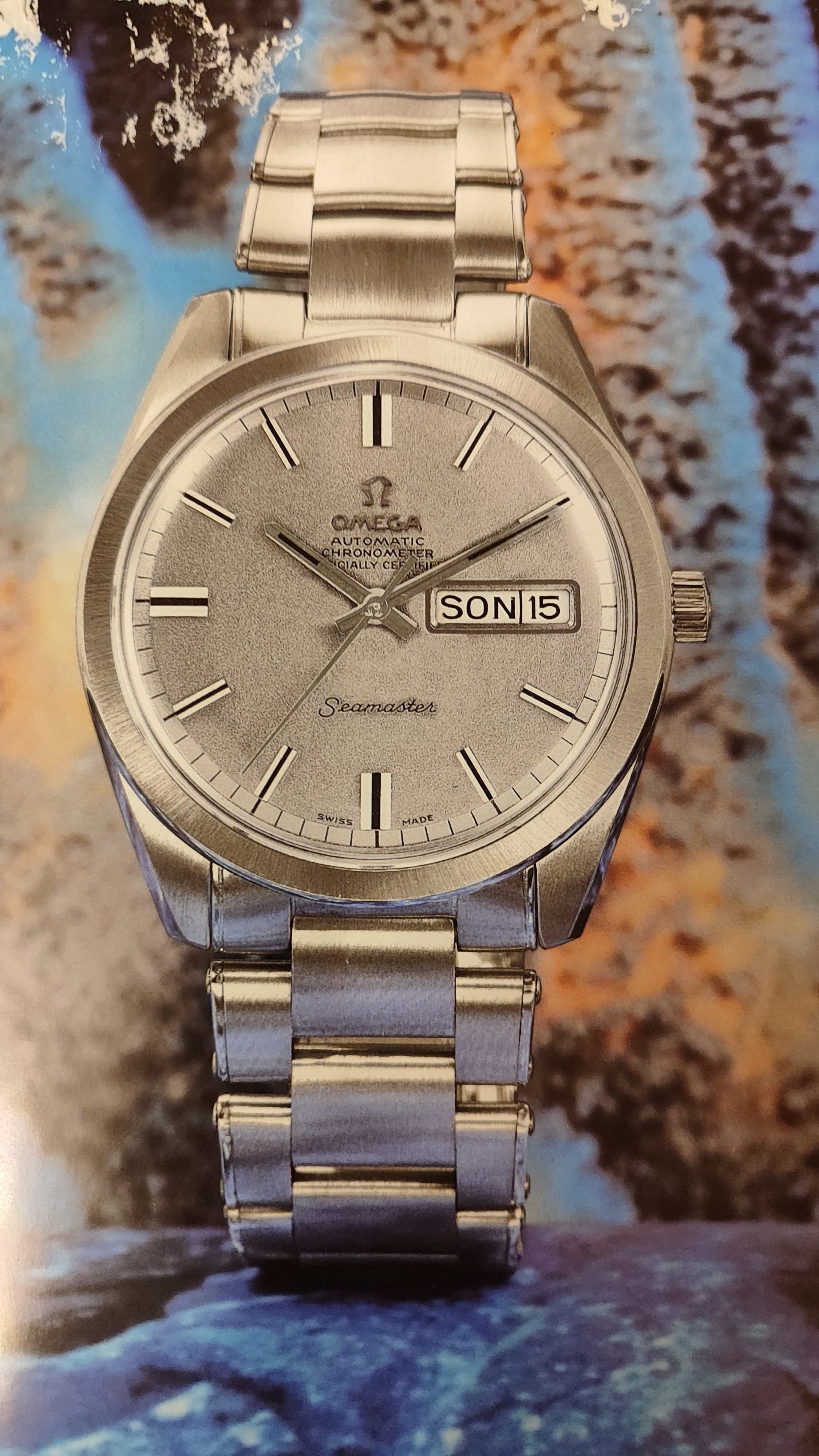

@OneTwo found a 168.023 from a 2007 Omegamania catalog I had laying around. Apparently a white gold version also exists with a matching white gold bracelet. To me it looks like the 1124 you pointed in your post.

@OneTwo the catalog page provides the reference as a BC 168.023, but not much more information. It states that it's exceptionally rare and I believe that.

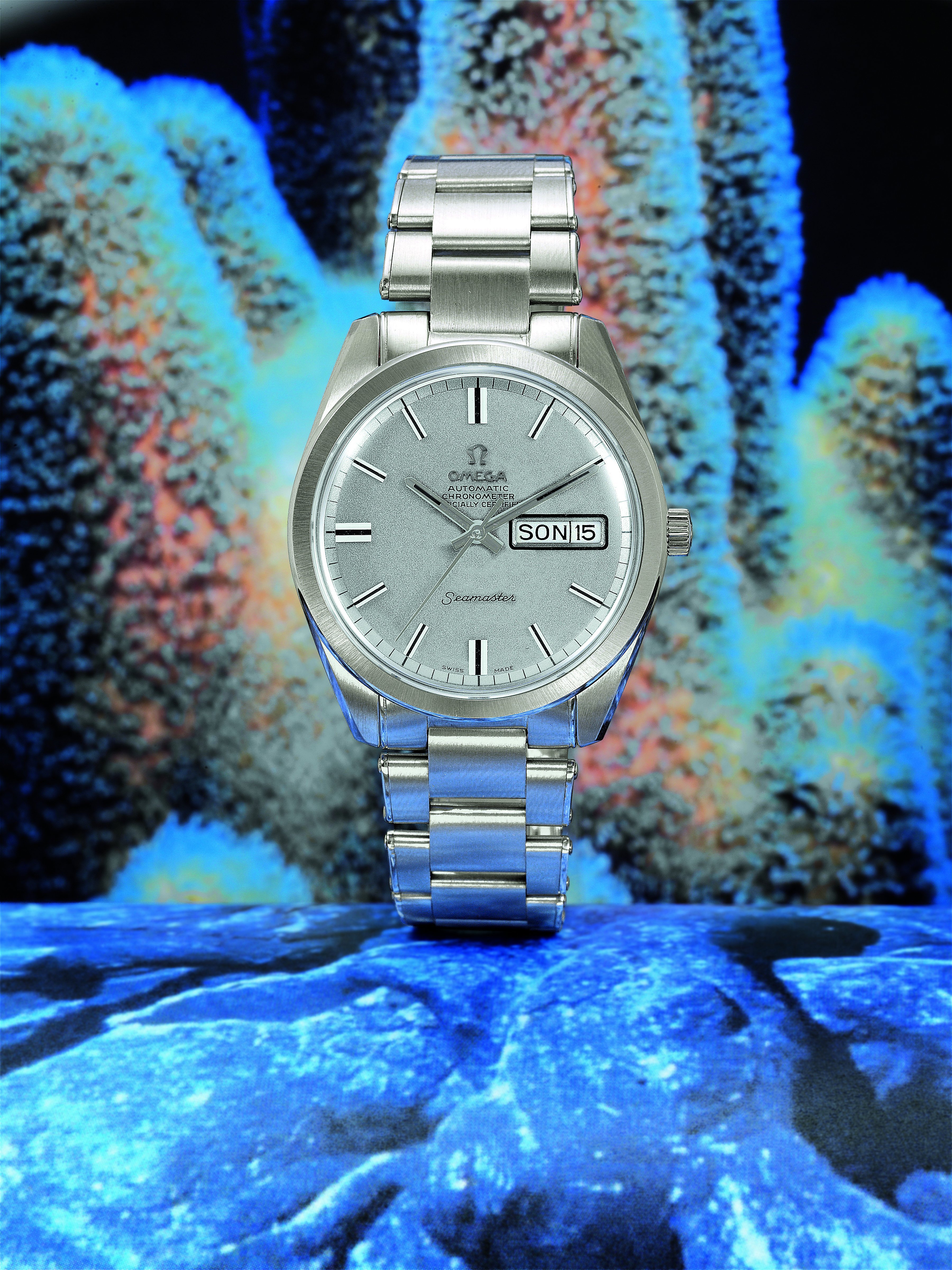

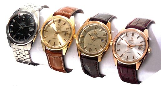

Wonderful @GuiltyGear Thank you! Did a quick search and found this article that had a photo of one as well. The applied Omega logo on the dial is different though. I've never seen that on another with one of the more modern applied logos so interesting to see.
They also had this photo which I assume, since there is no step on the dial is the solid gold case line up of the 168.022.
That black dial example though!!
https://catalog.antiquorum.swiss/en/lots/omega-lot-158-118?page=6
Tried a quick google search to find the OmegaMania Auction and ended up finding all the auction lots including the White Gold BC 168.0023. Enjoy this hi-res photo of it (even had to reduce the size to be able to post to OF).
