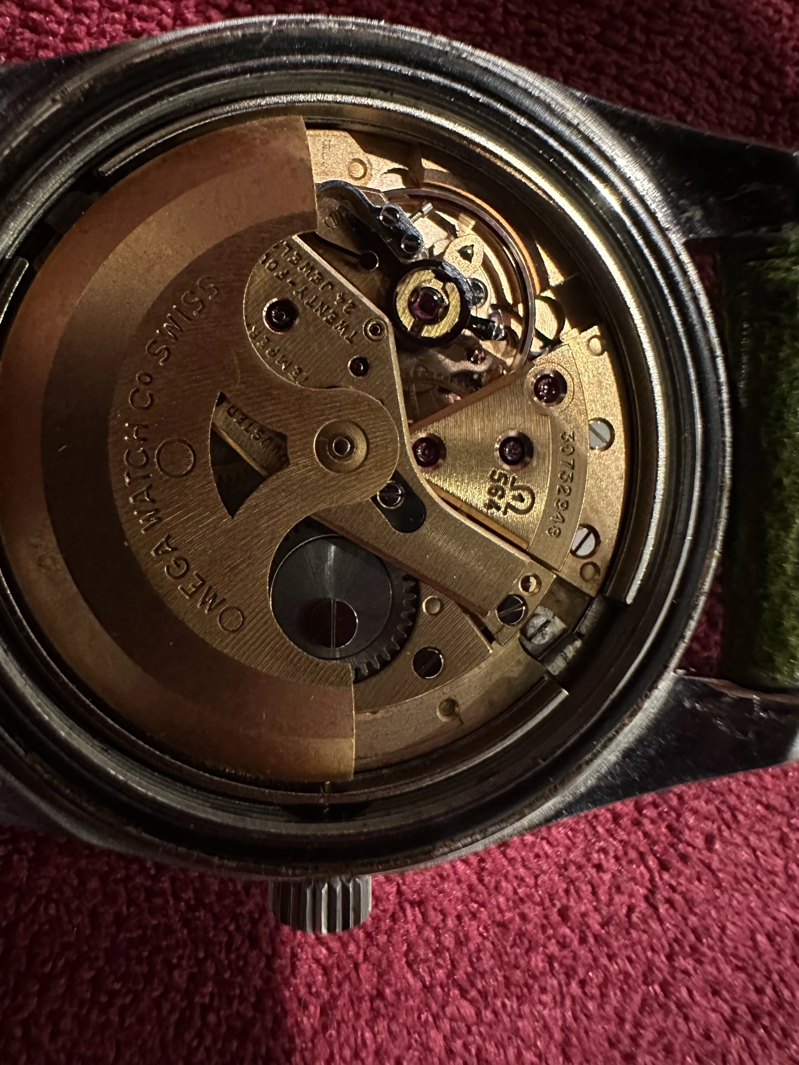

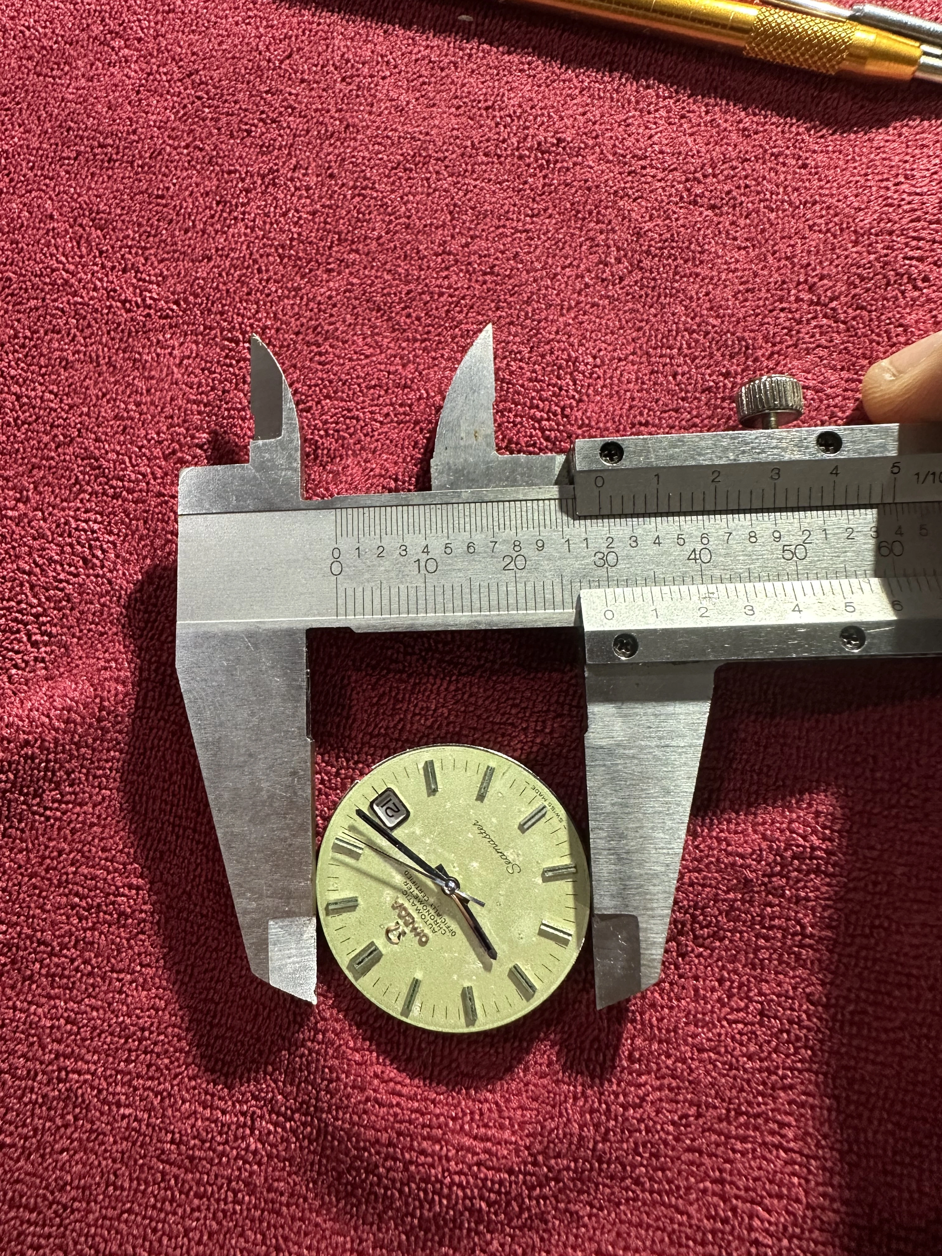

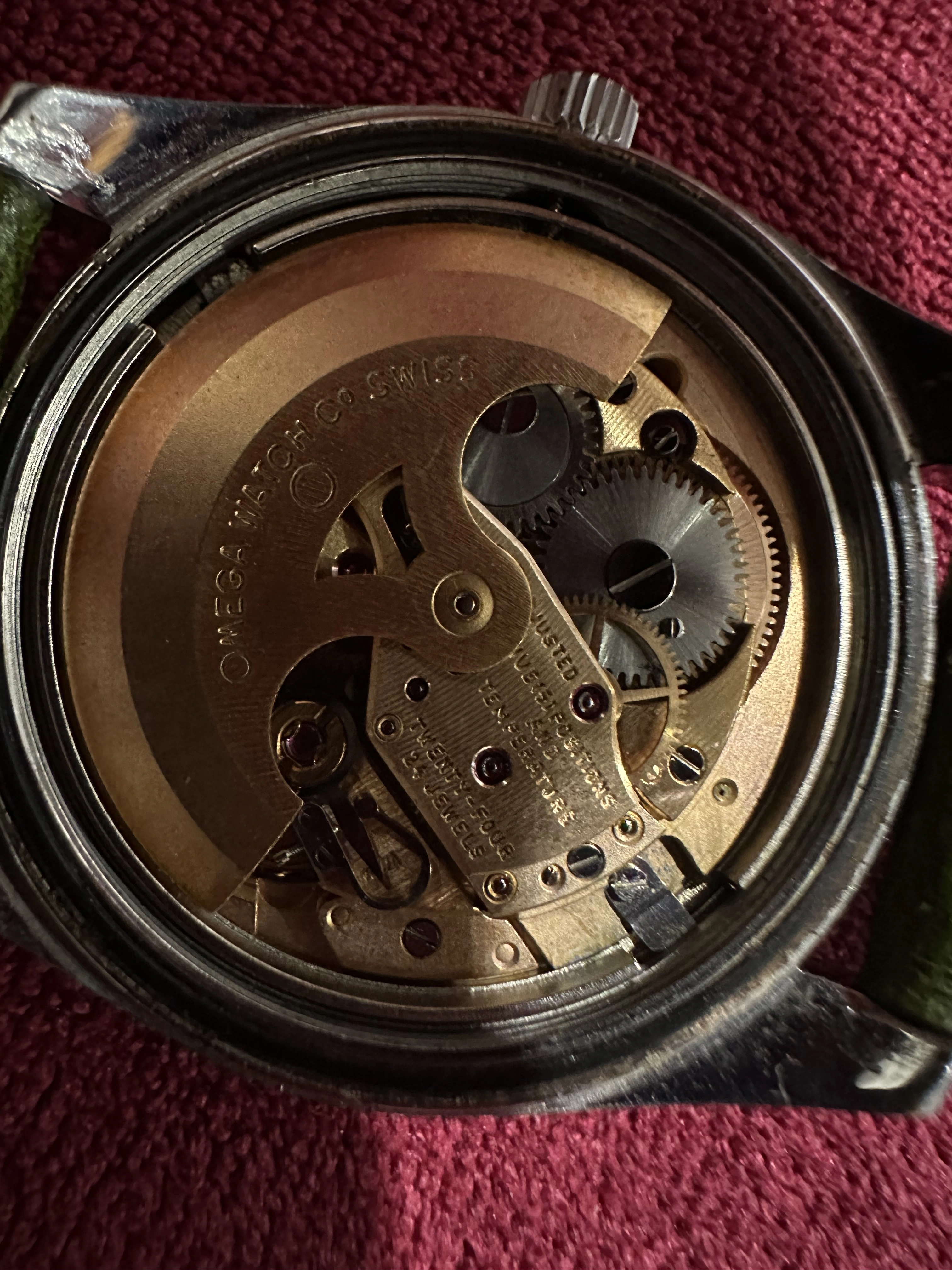

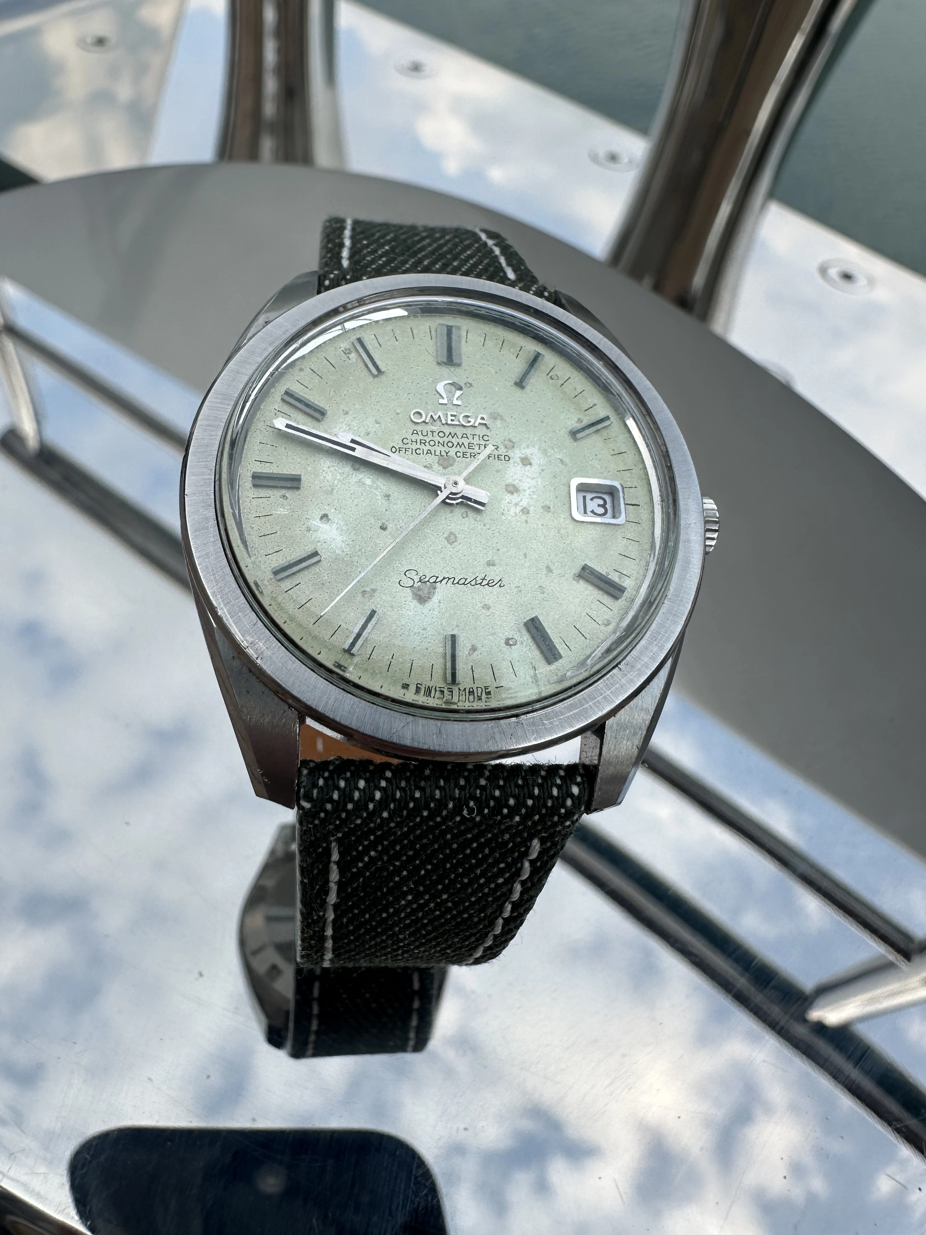

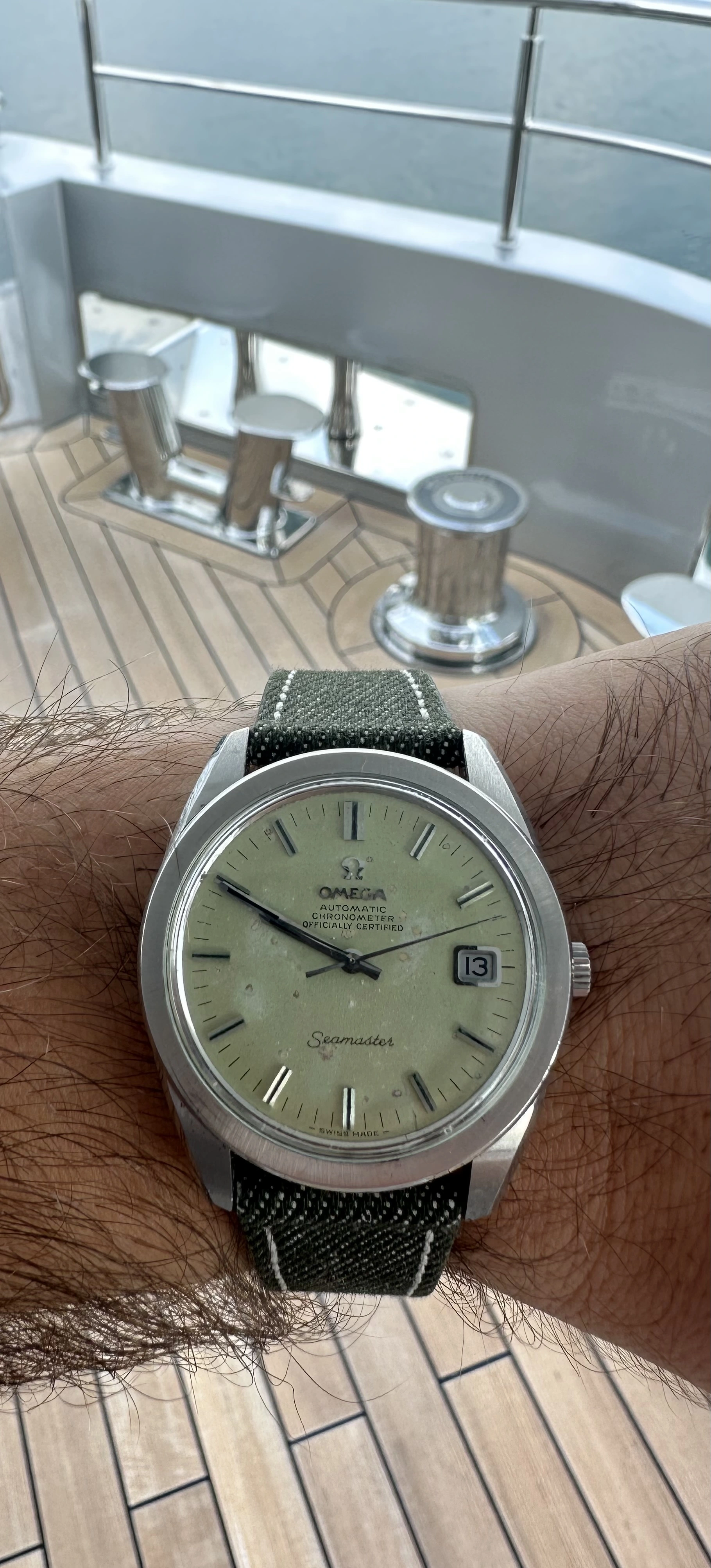

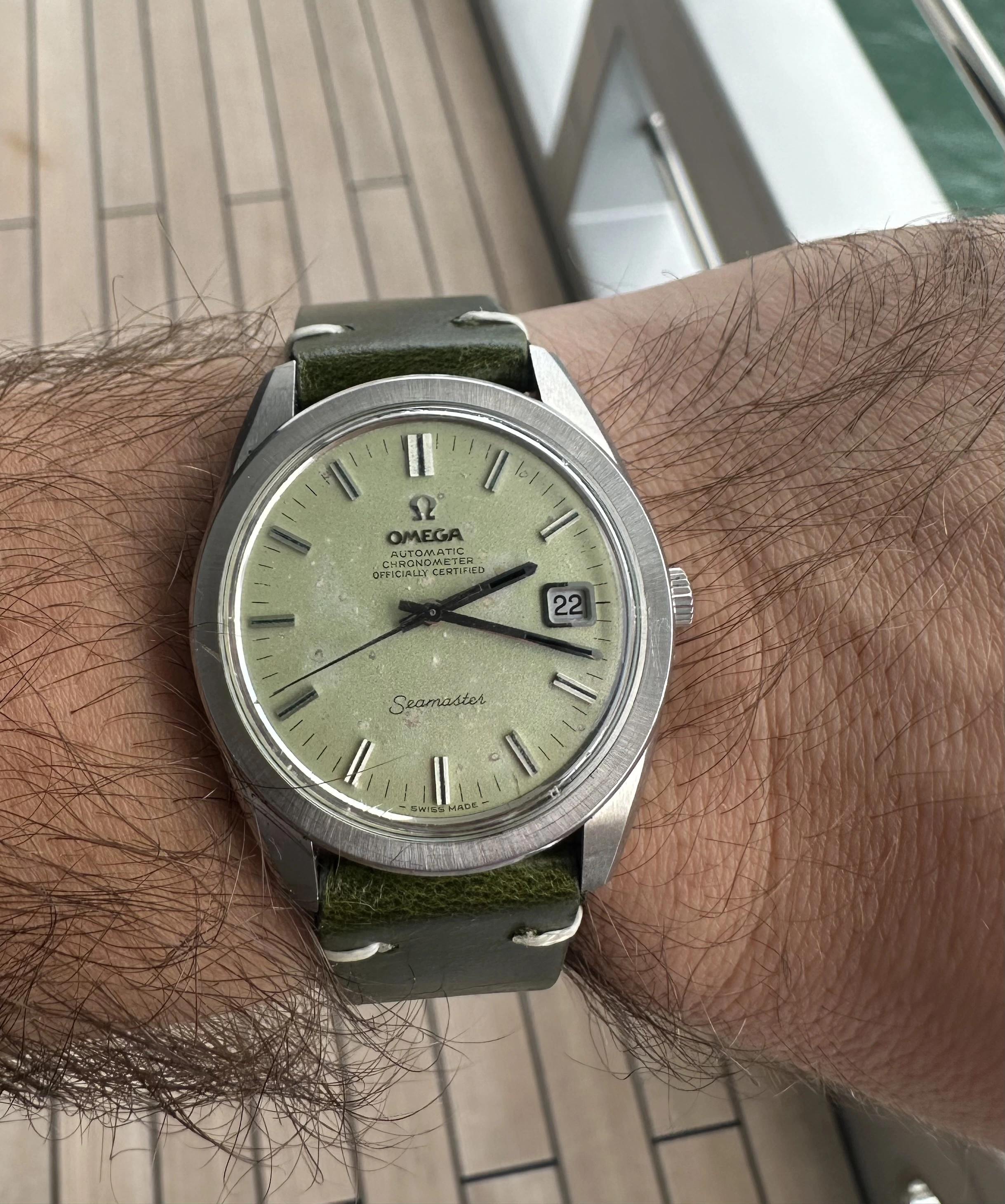

Hello everyone. A few days ago I bought a vintage omega seamaster 168.022 with 564 movement and I have a few questions that I would like to ask you. I would be grateful for any help.

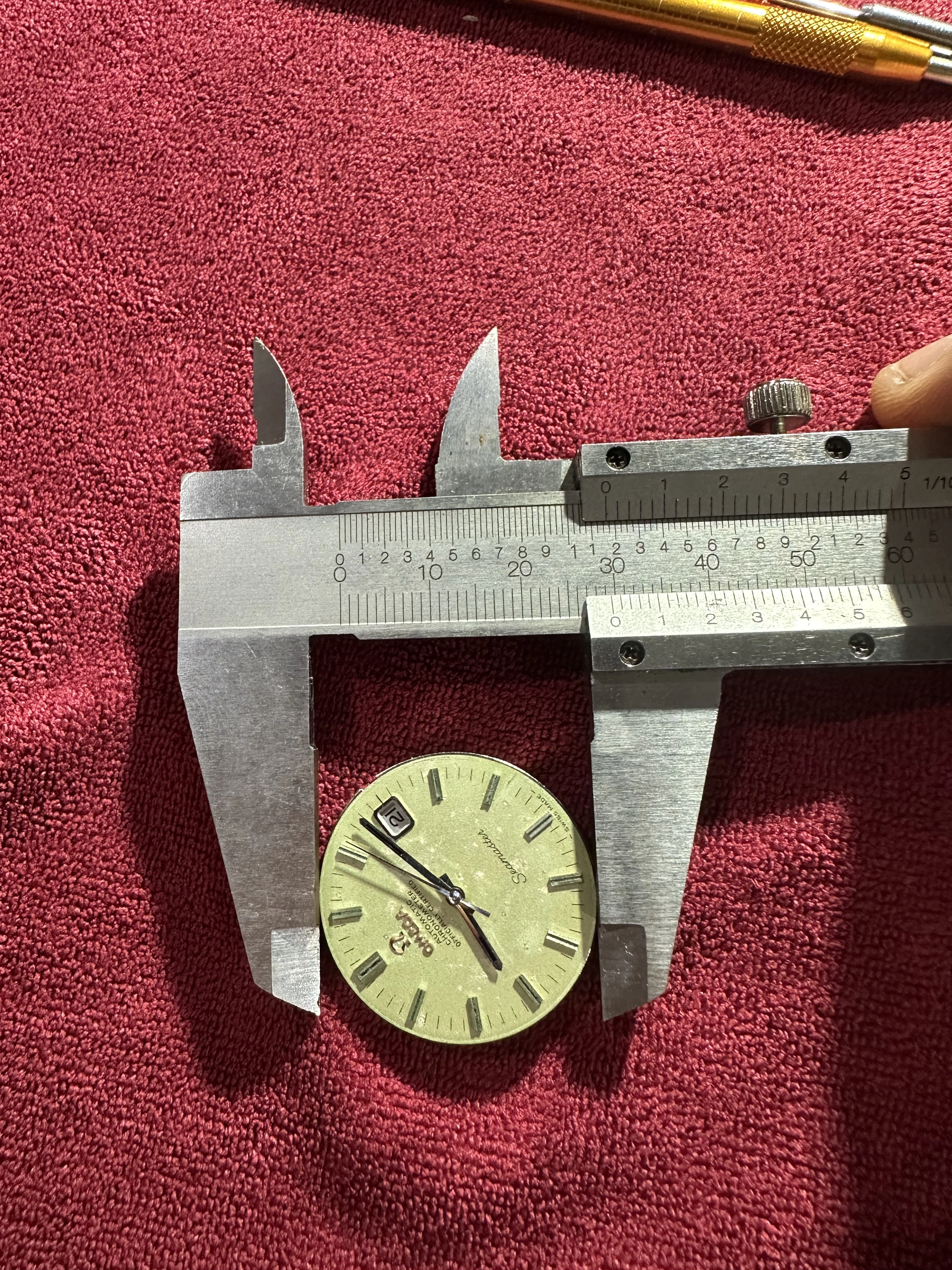

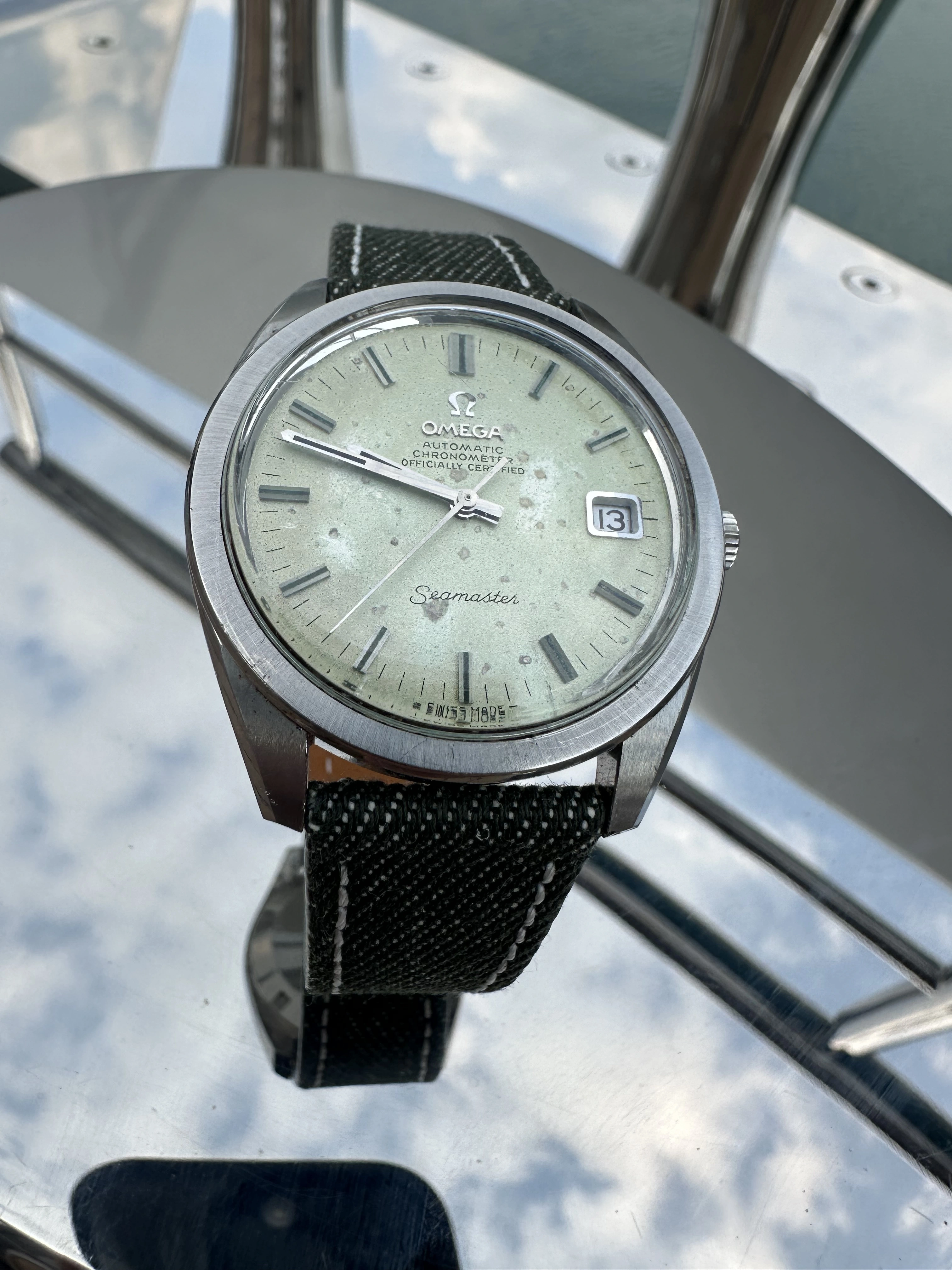

1. I would like to know what dials (other than the original) can fit this case and movement? Unfortunately, my dial is not in very good condition, I am leaning towards replacing it, but at the moment I have not found similar options for sale.
2. The dial is green and very beautiful, but I have not found similar ones on the Internet. Do you think this is a rare version or has it simply changed color over the years due to some processes?

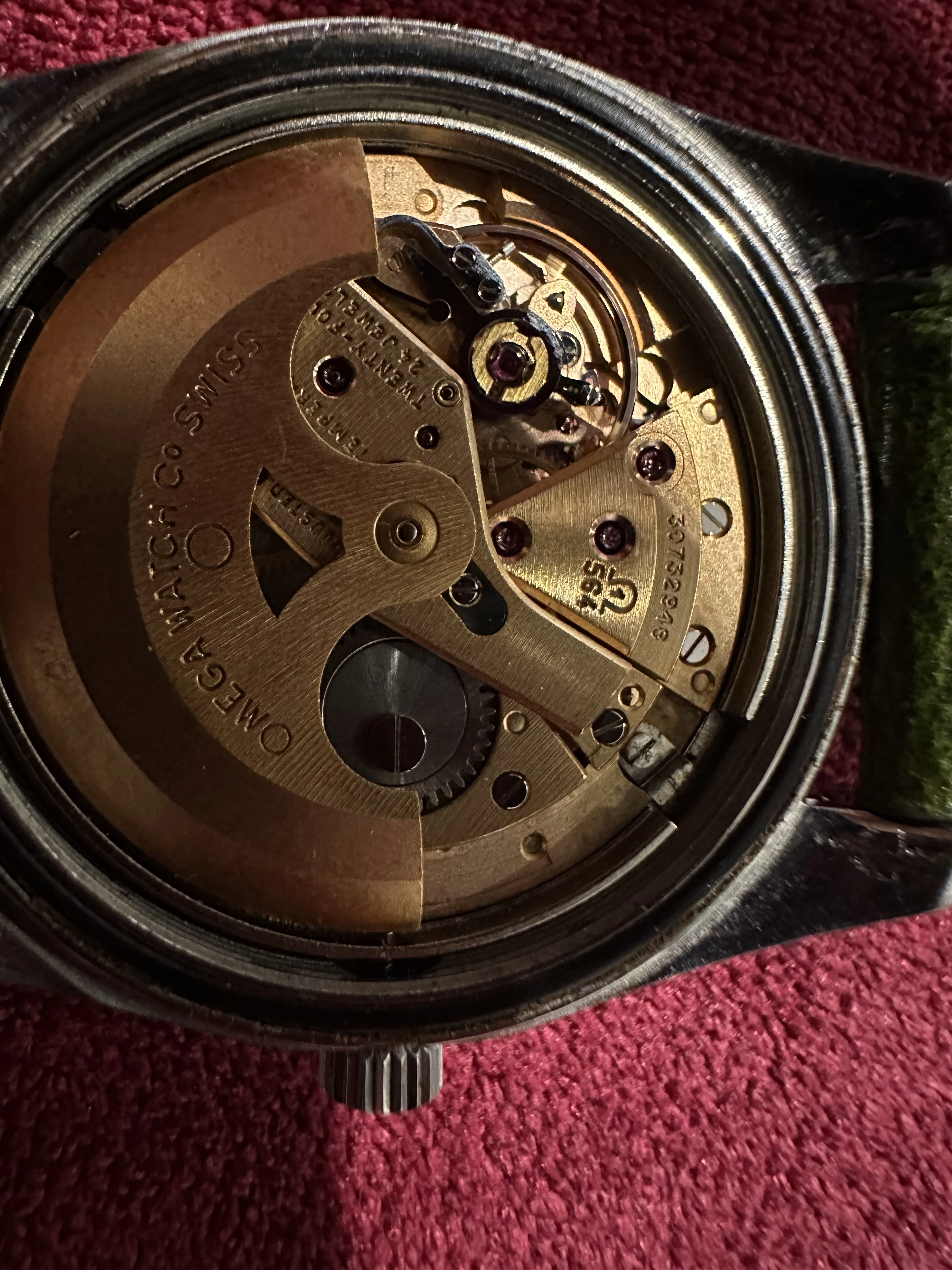

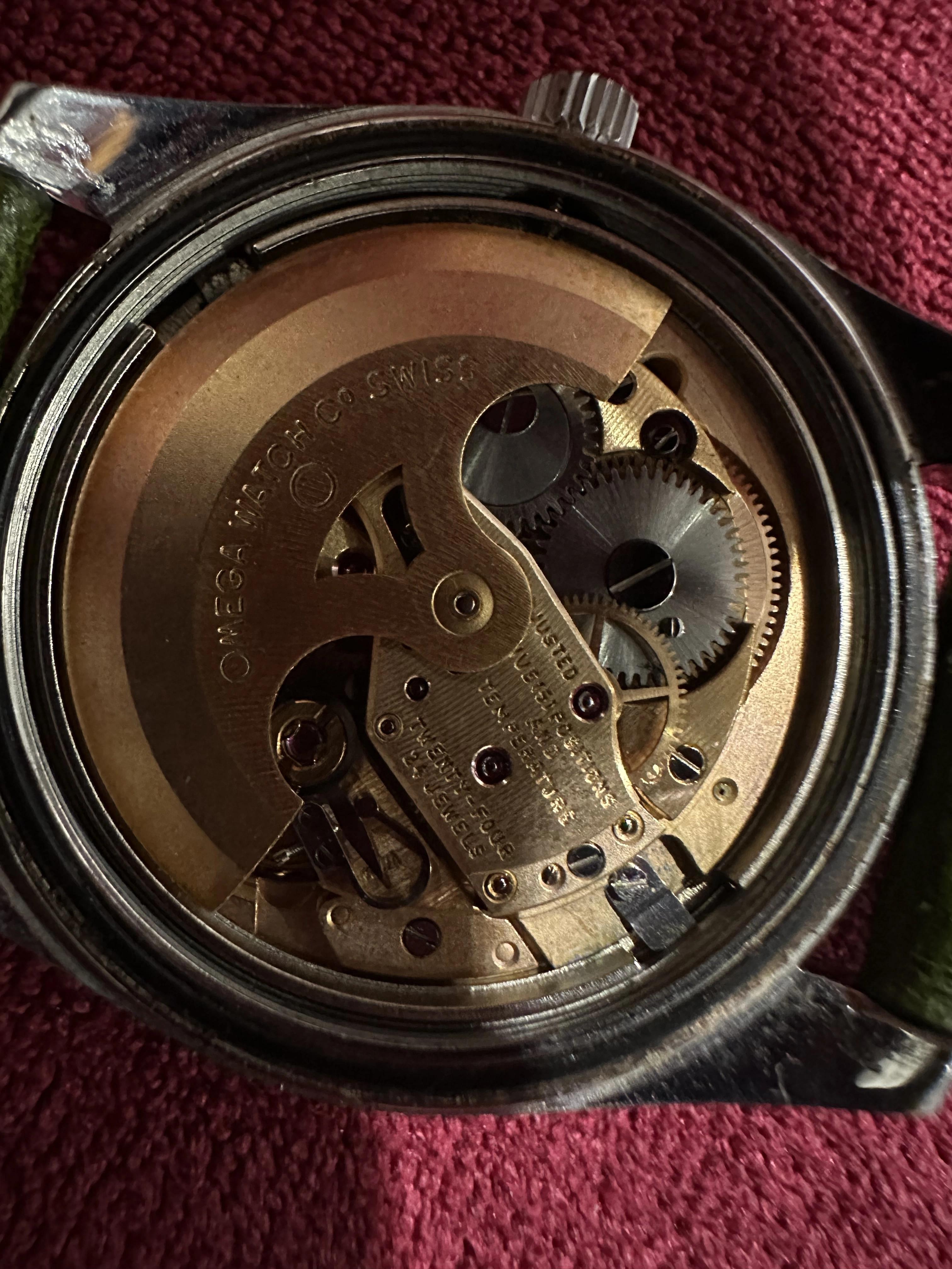

3. Unfortunately, the quick date change does not work, although the mechanism itself works well and accurately. What could be the problem?
Also, if anyone has an original dial for this model for sale, I would be happy to discuss buying it. I would be grateful for any answers to my questions. Thank you!

The color of the dial is the result of damage

The problem with the date could be a broken part.

That reference only came with two or three dial types, the sparkle dial you have (I think), the radial silver dial and a starburst silver dial.
Note the case is a dial reference for both chronometer and on chronometer versions. Assuming your dial is original you need a chronometer signed dial to avoid a mismatch between dial and movement.
Unfortunately it’s not going to be an easy task. It’s unusual to find loose dials, more so in good condition and you only have a small number of dials that are correct. Unless this watch has sentimental value, it’s going to be much, much easier to simply sell this one and buy a complete watch with a better dial.

hello. thanks for your reply. regarding selling, i'm not sure it makes sense because their price might be too low. i like this watch, the movement is still very accurate and i would like to try to restore it. but you're right, i haven't found such dials for sale. I'll hope for luck in finding the dial.

Great reference! I agree with the advice given. Even IF you find a good condition correct dial (highly unlikely) that cost plus the service needed to swap it and fix the date mechanism will be no question greater than the cost of if you had just bought one in better condition.
The dial is either refinished or oxidized or both, but the greenish tint is cool so I'd say just get it serviced and enjoy as-is. 😀
Or as suggested unless of sentimental value sell it and save up for a better condition one... they are out there. Best of luck!

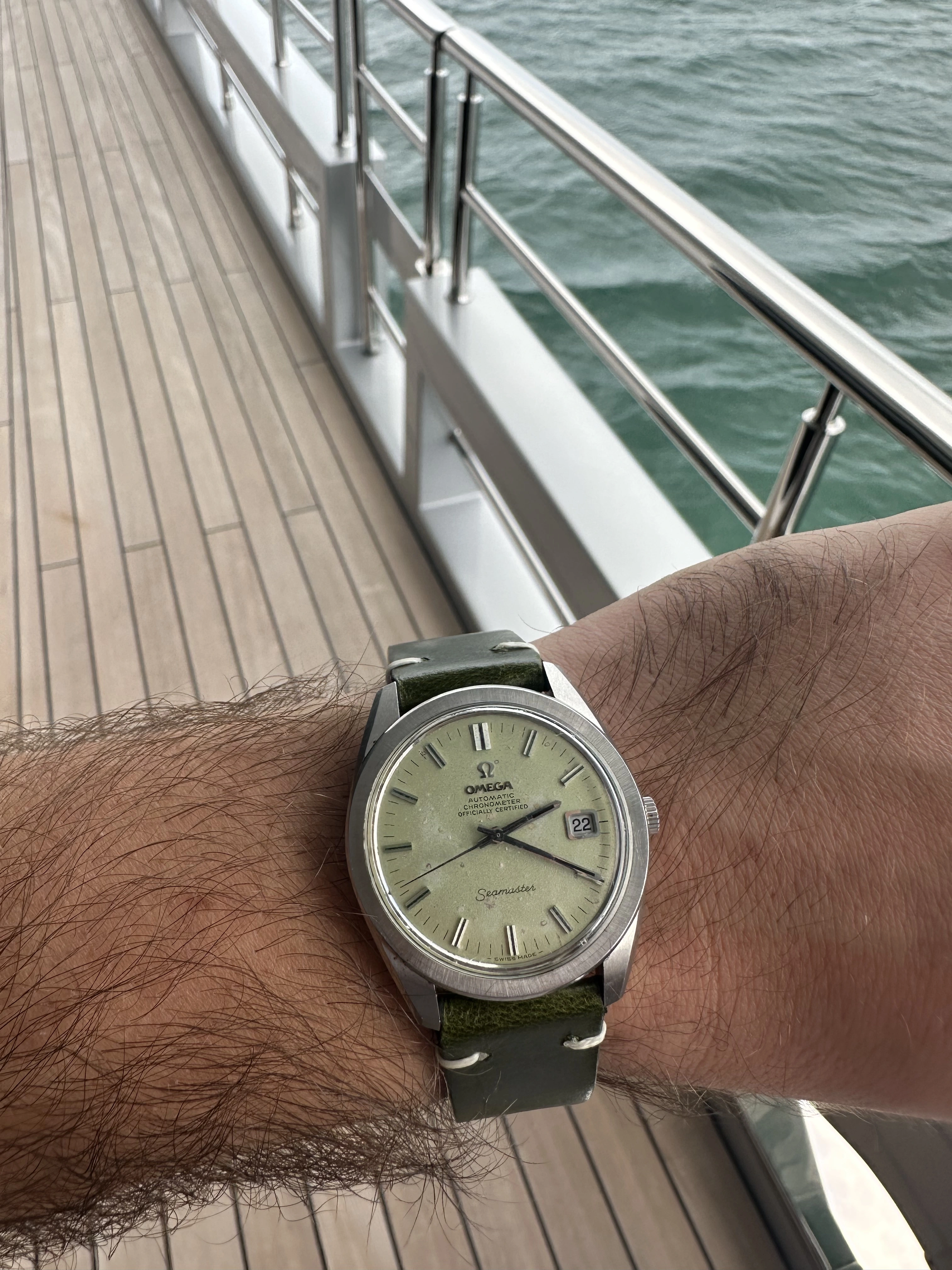

Just a thought as I noticed the date is 21st in one picture and 22nd in another... are you aware the quickset date works by push-pulling the crown (not turning it)?

Hello! i agree with you that a full restoration of the watch can be expensive and probably does not make sense. the watch runs well and is very accurate (i would say that it is even more accurate than my speedmaster 3220.50.00) the date changes automatically every day, only the quick set does not work. but i will be honest with you, i bought it at a local flea market for a price slightly more than 250€ and i do not regret anything. it is a very nice watch and the green dial only makes it unique. the only things that bother me are the dots on it, the damage. that is the only reason i am looking for a new dial in good condition.
yes i know, the fast date set is done by pulling the crown out not rotating it.
