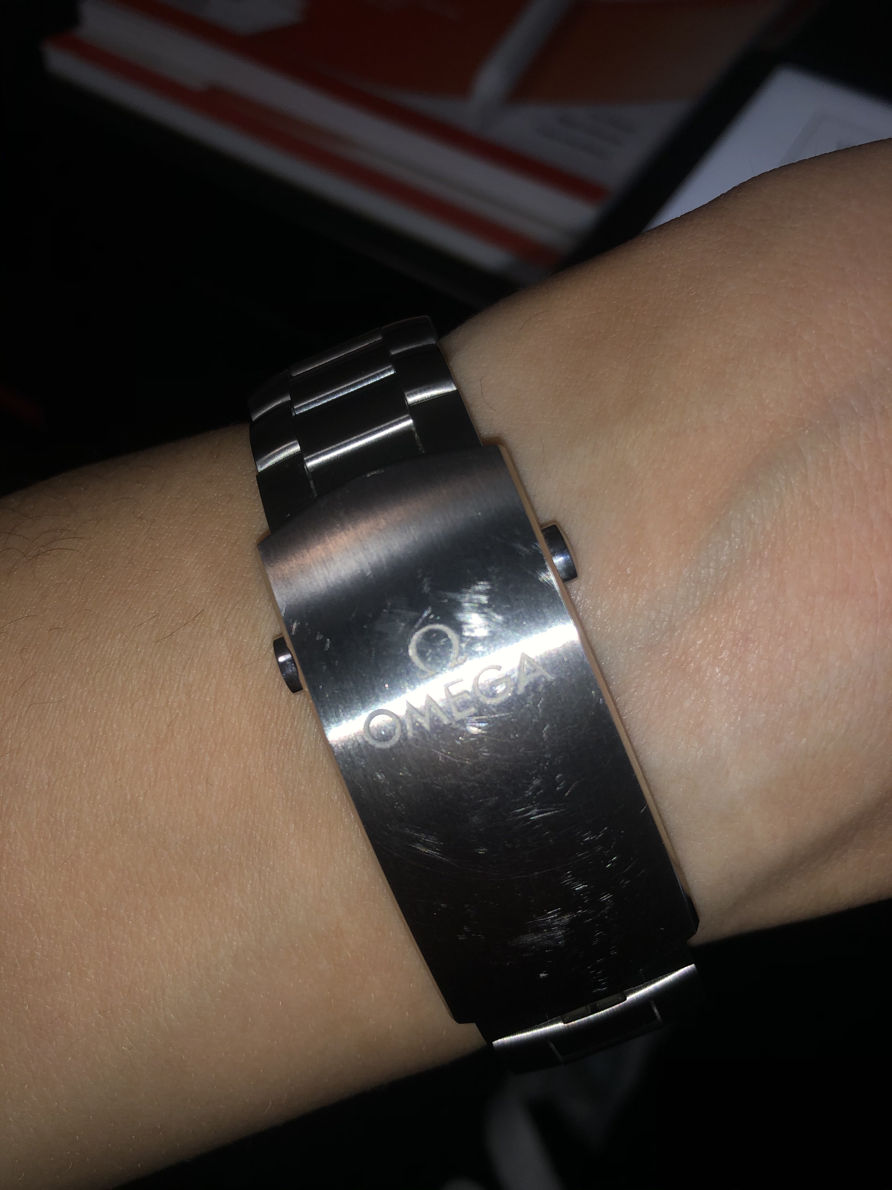

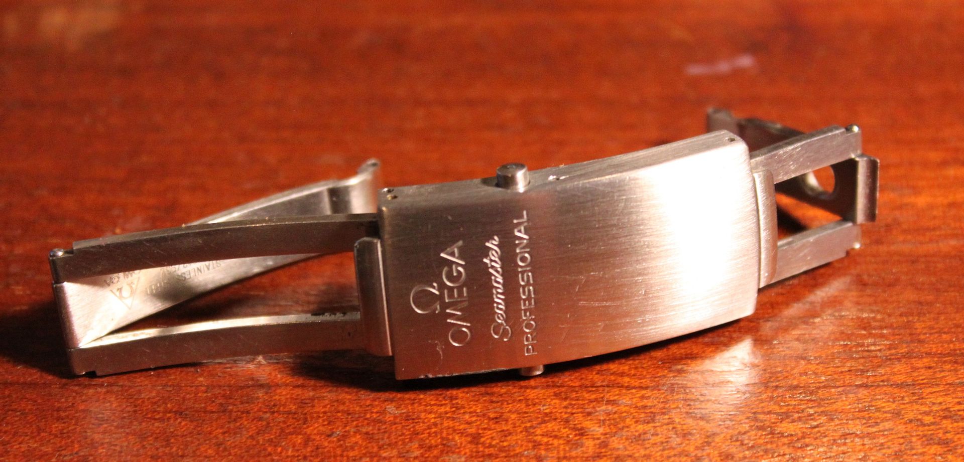

Hi guys,
as everyone knows I recently purchased a PO. The clasp has a lot of scratches and I would like to remove then. There is anyone that knows a safe procedure to do.
Thx in Advance

I’d use a fine sandpaper with a very hard backing (wood) so as not to cut into the logo, and sand with the long direction of the clasp.

Oh no, desk diving marks! Just use scotch bright and go with the brushing. Just a few passes should be enough, just be sure to brush in straight lines.

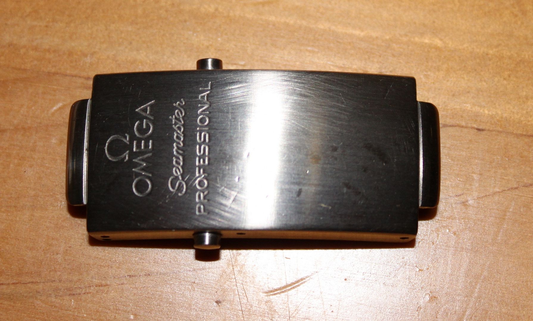

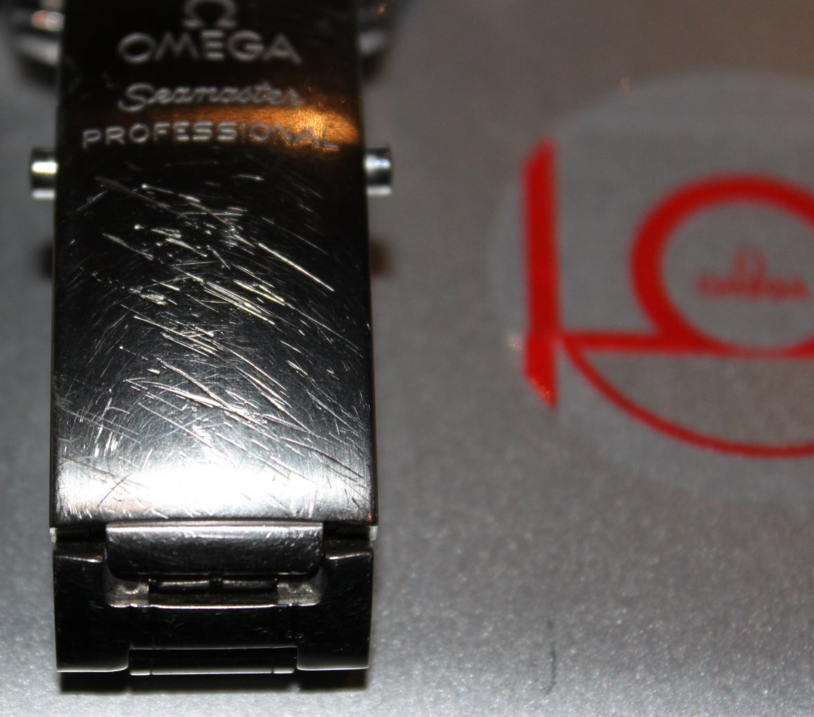

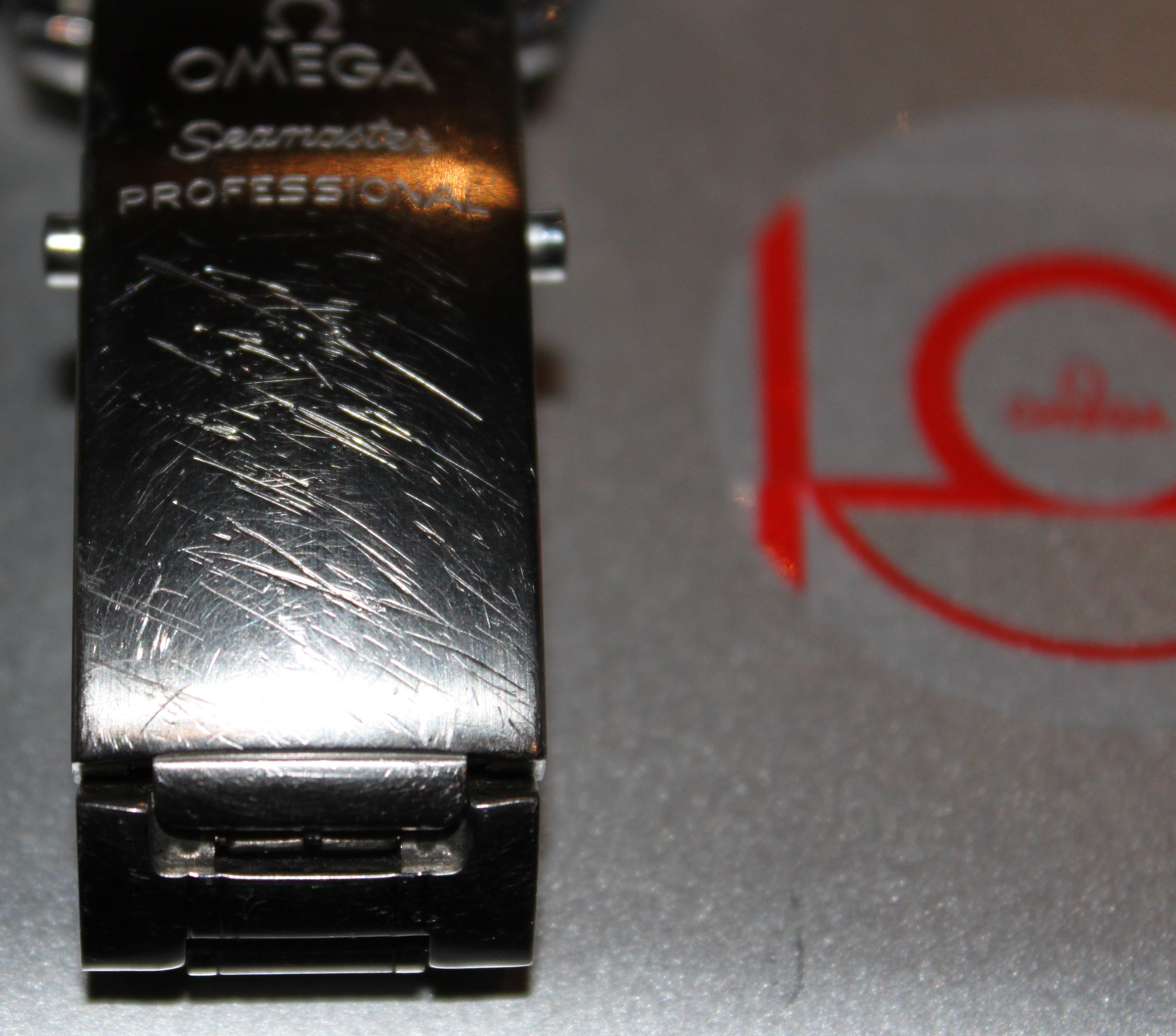

I bought a Seamaster 2262.50 for my wife and when it arrived the clap literally looked like it had been in a train wreck. It was actually a bicycle accident. The following pics tell the story and all that I used. Initial pic looks a lot lot better than it actually was, but you can see some deep marks there. I did mask off the engraving with insulation tape for the real tough work, and made sure I was using straight strokes to keep the grain aligned. For the record, I did not use the Green Scotch Brite, too fine. Stick with the brown. (EDIT: Looking at your pic, perhaps a finer grain would be suited better) It's not perfect but a darn sight better and with a bit of use, you would never ever know.

I did a hack job during Covid, decided to go DIY since I just didn’t like the polish. Looks fine enough until the sun hits it.

No just get the brushing done right. This was my plan from the start, figured if I screw it up I can always get it fixed so why not try it for free first.

I've used the scotch brite pad many times. I'm amazed at how well it does with so little effort.

It's my opinion that the B is closer to Omega factory finish than A, but nothing wrong with using A. I just ordered a C because some scratches are too deep for B to remove.
I also use B to touch up bracelet links... very carefully!
