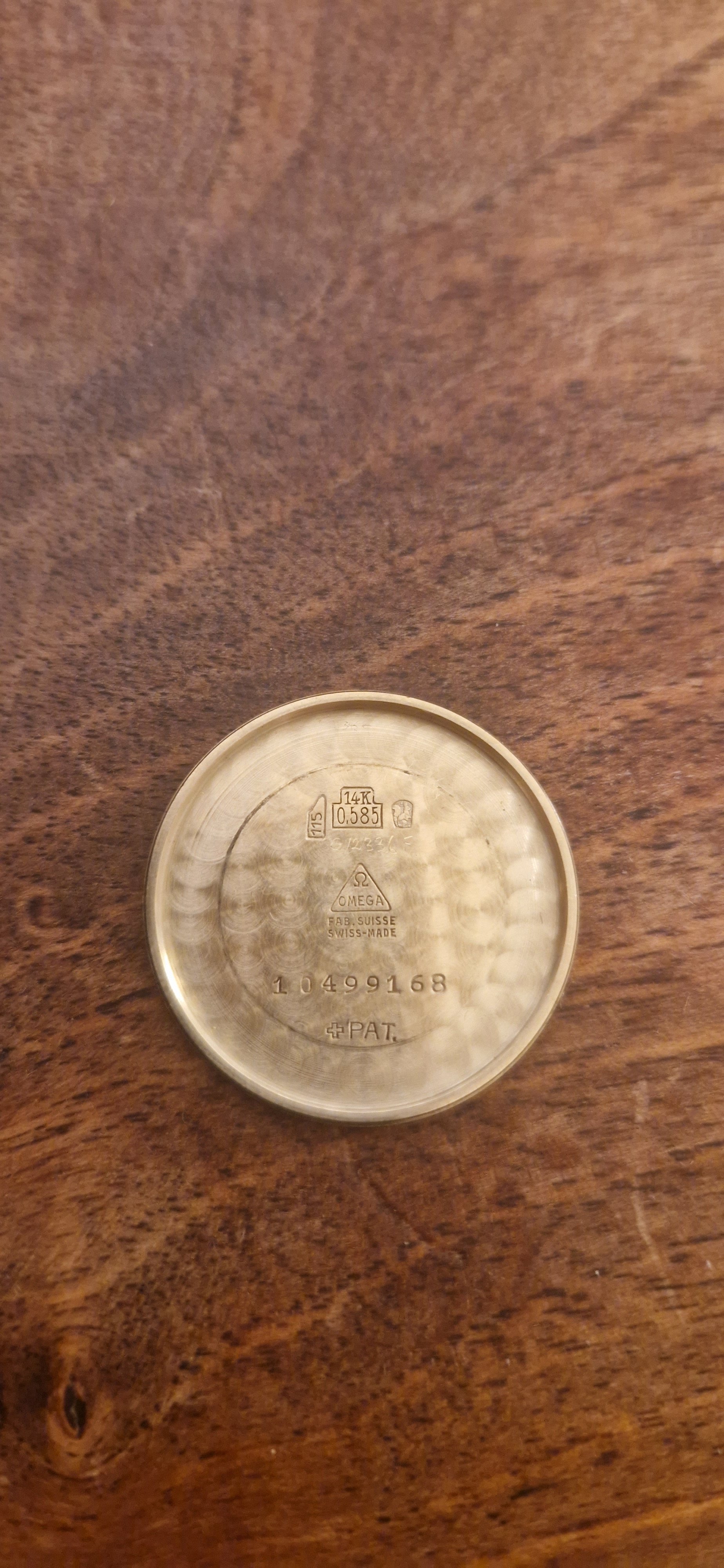

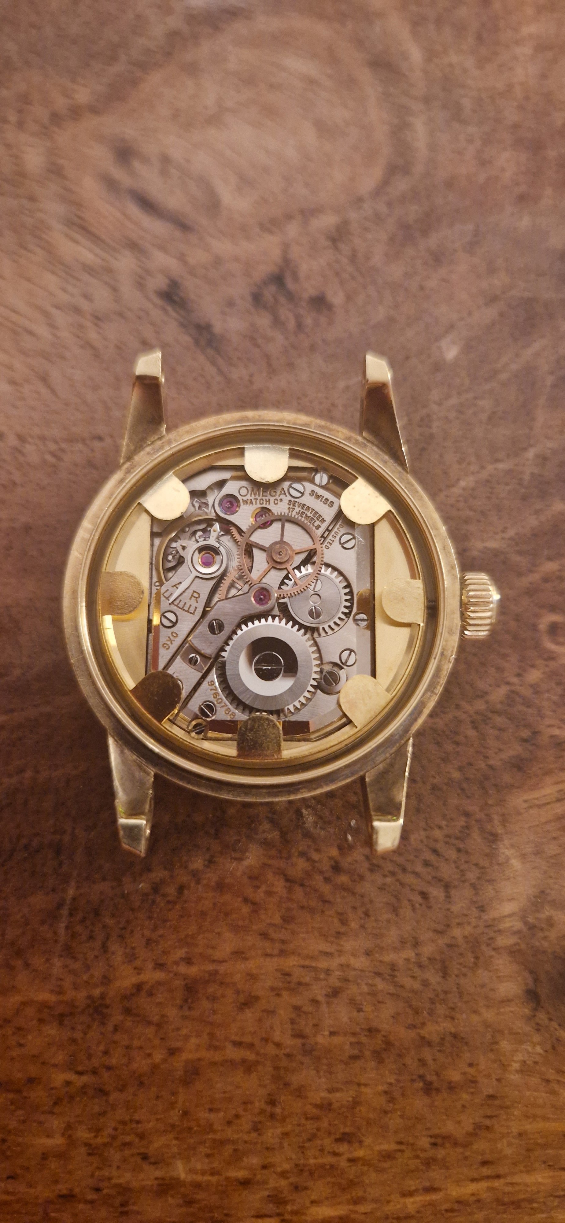

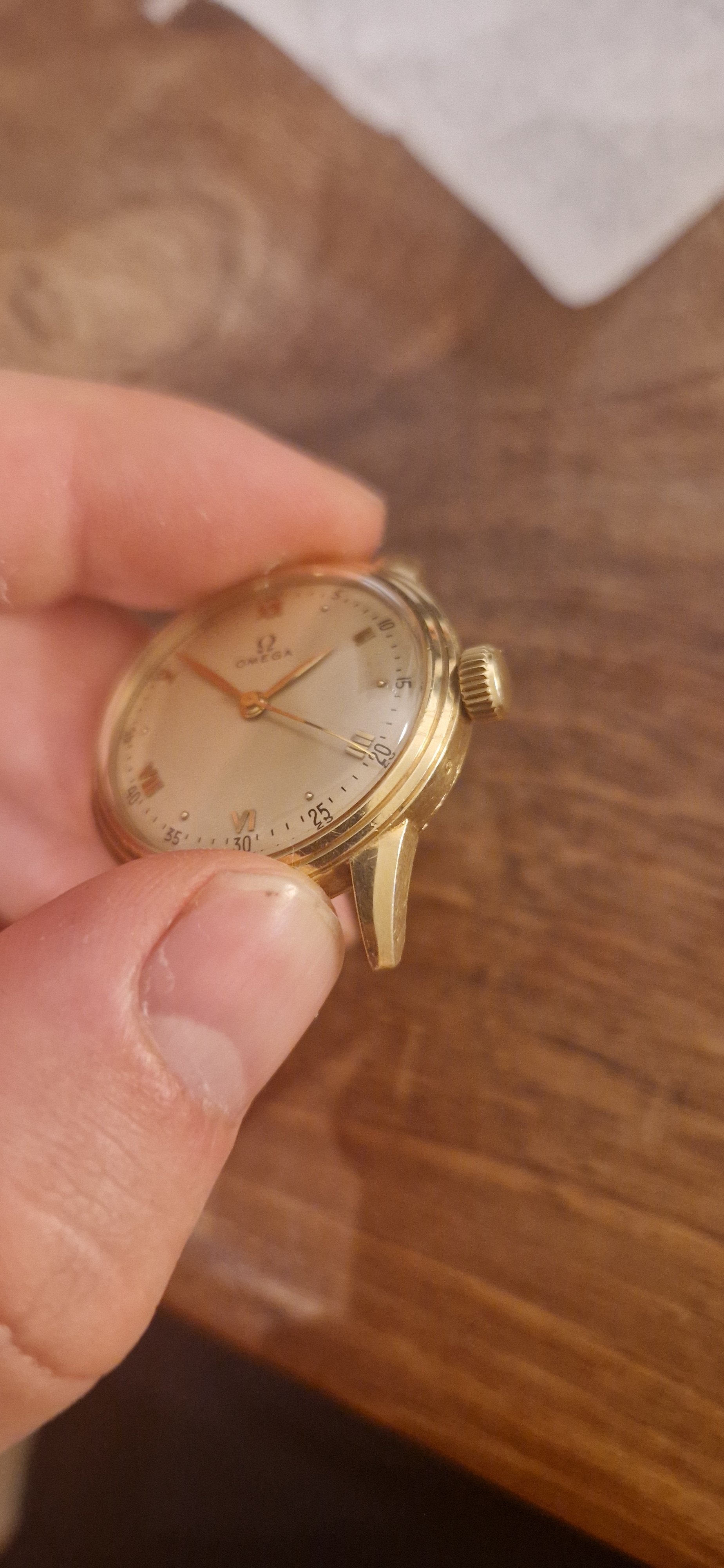

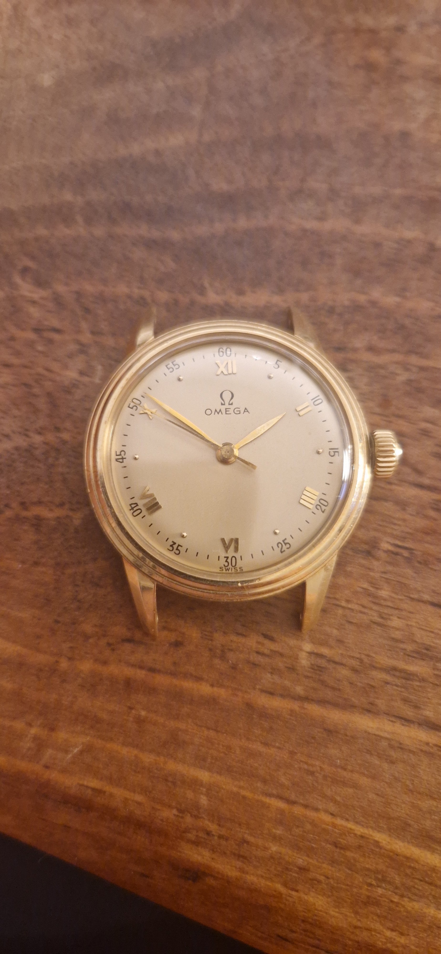

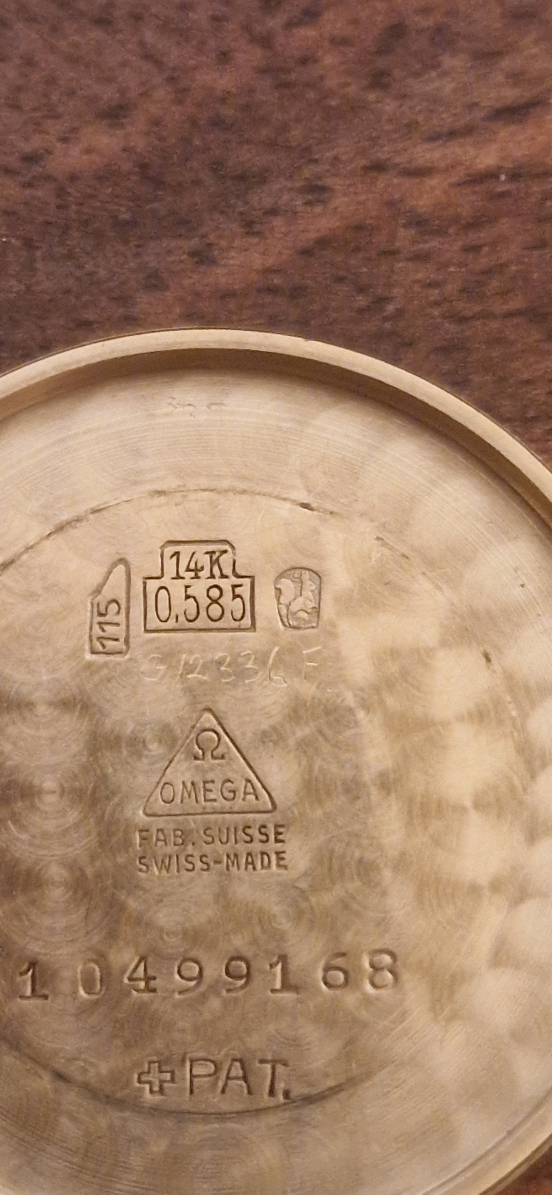

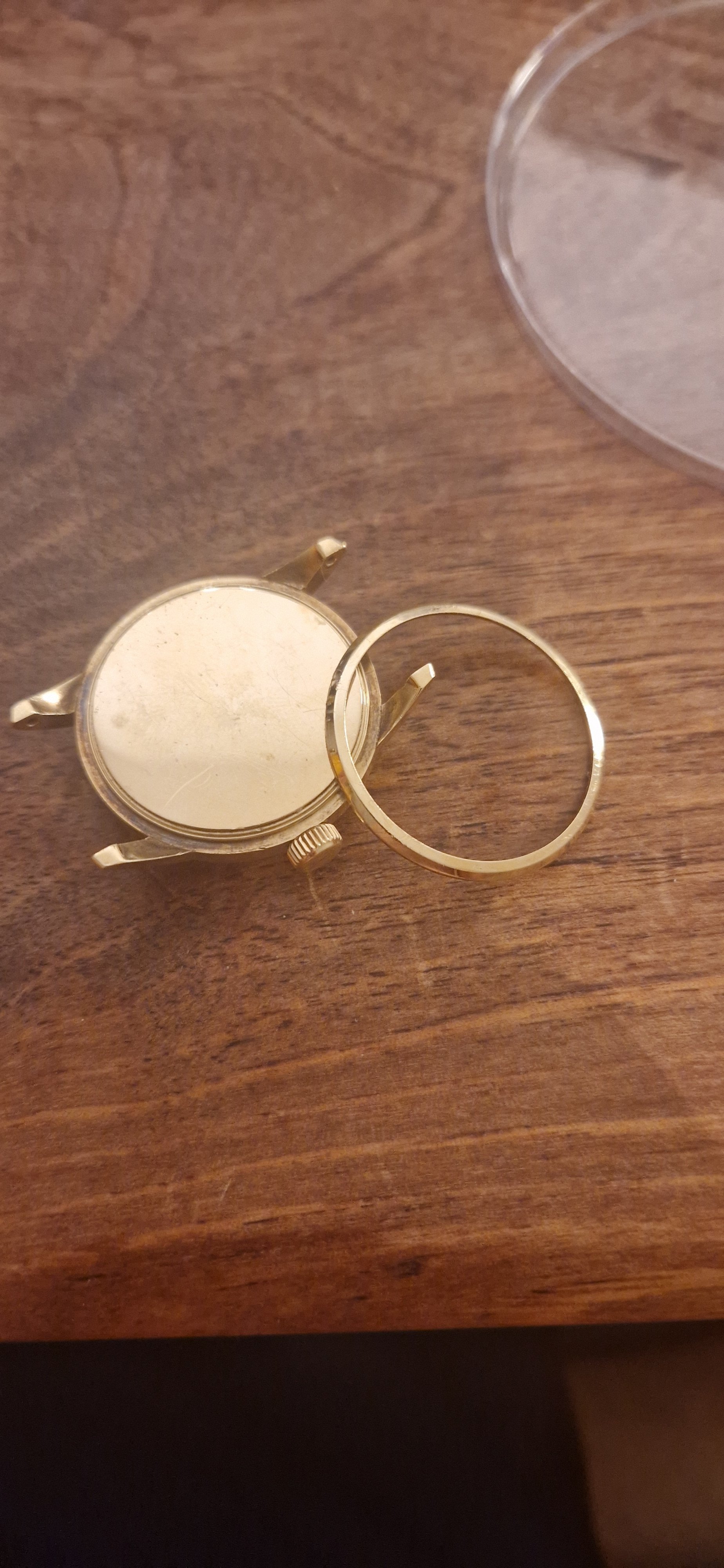

I got an interesting watch. The case looks like a reference 2300 but the case back is closed with a bezel as can be seen on the photos. The material is 14k gold.
I think it was delivered to the usa because of the three letter marking.
The movement is an r 17.8sc but finished like a chronometer. Like the 30t2rg it has some parts polished and the pallet fork has beautiful anglage!
Do you think it was a chronometer but not marked as such for lowering export costs to the usa (marked as unadjusted) or do you think it has this finish just for aesthetical reasons?

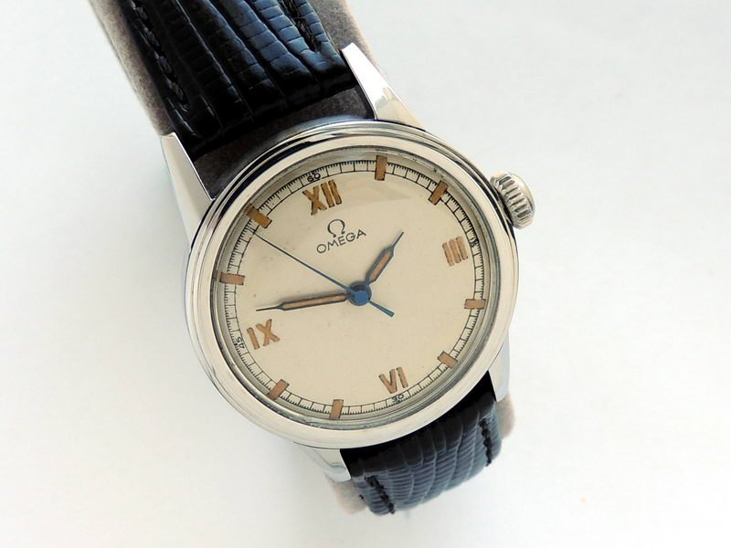

Nice watch indeed ! Is the crown original ? large size crown for that vintage watch ..??
149
239
I find the crown very big as well. I don't know if it is original. But i have seen ck2300 with similarly sized crowns.

I don't believe the r17.8 family were ever chronometer grade, i think you just have a clean looking movement. Import costs would have higher as the gold case is Swiss, rather than the grade of movement.

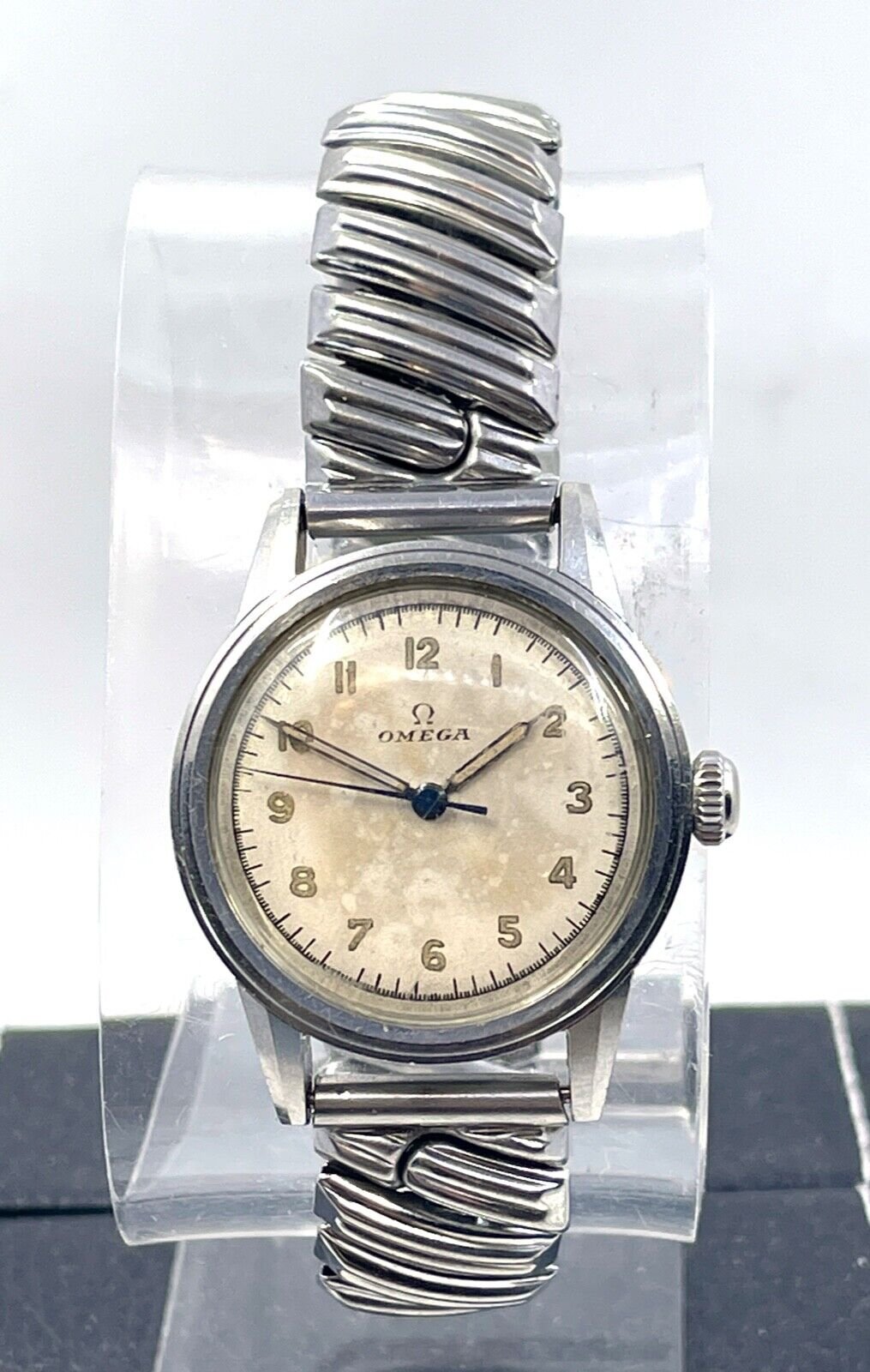

I have to object. It has definitely been produced in chronometer grade. At least the r17.8 without central second.
You can find an example with extract from the archives in this thread:
https://omegaforums.net/threads/omega-chronometre-2144-rare-petite-w-extract.155923/

My movement is not only clean. It has polished inner part of the ratchet wheel, polished teeth of ratchet wheel and crown wheel, anglaged pallet fork, differently shaped upper balance cap jewel setting.

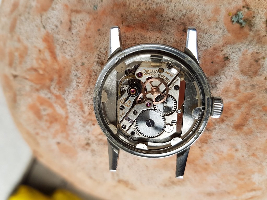

Please compare those photos:
3,653
7,770
hard to assess because we don´t have any "Chronometre" markings neither on the movement nor on the dial.
Only the Omega archive could shed some light on this "problem" (in case the archive process will be activated again).
As I also wrote in the T17 thread I think there might be some sort of "silent" chronometres which means they show the full finish which is known from other chronometres, i.e. polished teeth of ratchet and crown wheel, pallet fork with anglage, etc. as you pointed out correctly.
All I found were sold to the US (OXG marking) and had a higher jewel count of 17 which was the threshold for higher import duties/taxes.
So the jewel count was not any problem. I don´t know if "declared = marked" chronometres were subject to higher taxes in those days. This would explain why they were not marked as such. Just a theory I can´t proof (yet).

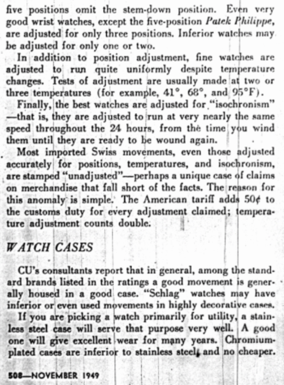

Here is some information on your theory.
This an excerpt from the November 1949 issue of Consumer Reports magazine. This is only a few years (and a World War) after this watch was made.
It discusses the practice of marking movements as “unadjusted” even if fully adjusted in all positions and isochronism to save on US customs duties.

This is great - thanks a lot! It some sort of "confirms" my thoughts...

Thanks a lot. It fits the 14k case.

The article states that:
"Watches adjusted for 5 positions omit the stem down position."
This is incorrect - they omit the crown/stem right position. Hopefully if people are relying on the rest of that article, the information is of better quality.
