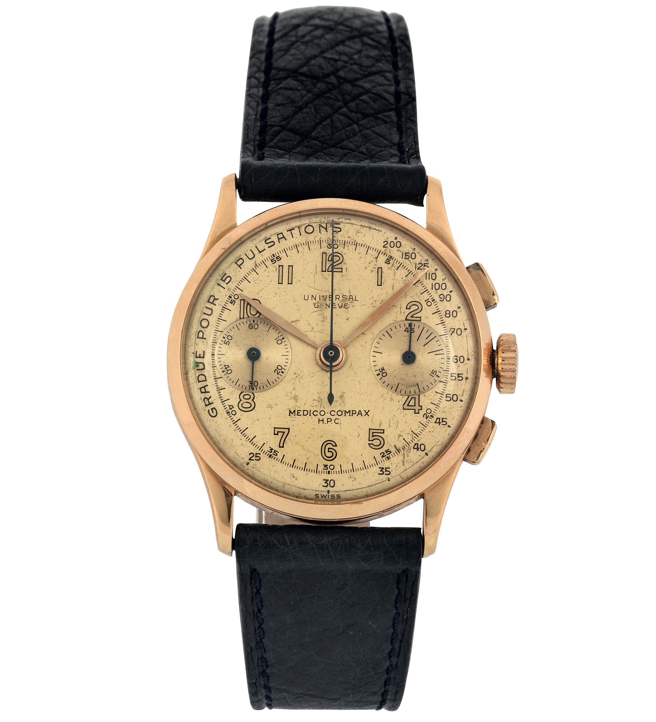

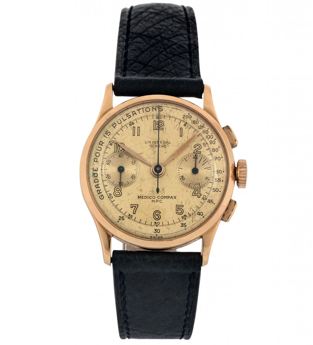

Medico Compax with HPC dial sold at auction over the weekend. The movement does not appear to have a serial number.
6,911
10,772
Sold for EUR 2800 excl fees (30%)

The point of interest for me was another watch with an HPC dial but with standard movement (i.e. without the markings we would expect to see on a chronometre).
It does seem odd that we have this dial designation, used over several years (it might be interesting to narrow down the period over which it was used), that seems to have meant very little and about which we know next to nothing.

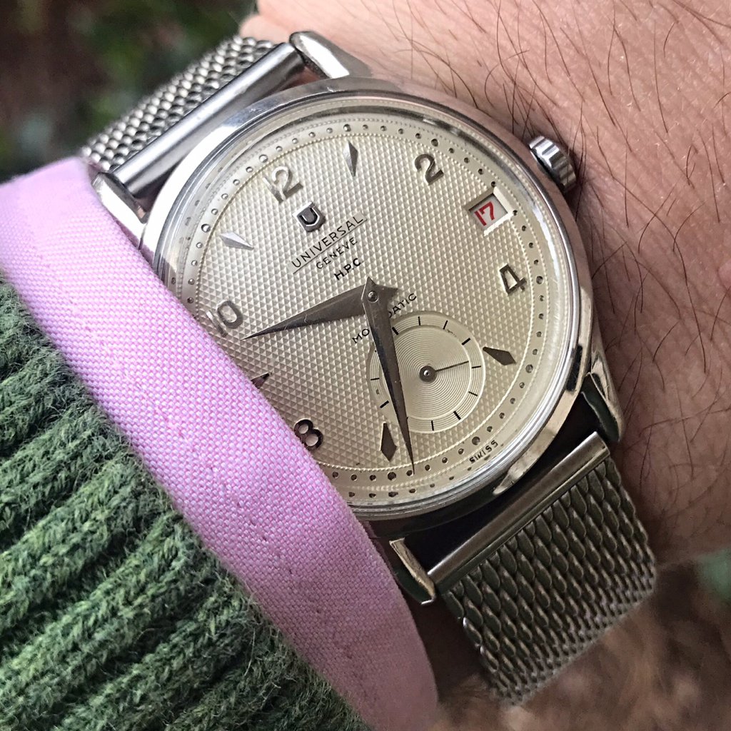

Whilst looking into this further, I came across a view on an Italian vintage watch forum that the H.P.C watches used some higher quality parts compared to the standard movements, although no evidence was provided for this. This theory does seem to make some sense though and would explain why these dials are fairly scarce but they are not fully fledged chronometres with serialised movements.
The HPC dials do seem to be less common for time only watches compared with chronographs. Here's another that I came across (credit to @erikclabaugh , who I believe was the owner at the time that this picture was posted). Does anyone else own a time only watch with HPC dial?

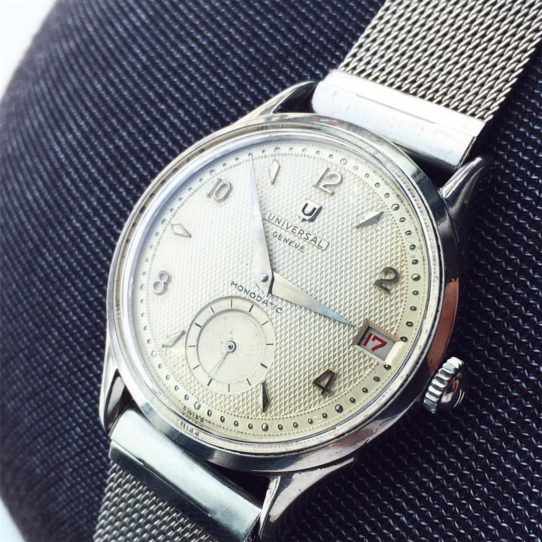

I think most, if not all, of the watches we've seen with HPC dials have had standard equivalents. I own an HPC dialled S20217/4 Polerouter, which apart from the dial designation, appears identical to the standard model.
And here's the same model as above without the HPC dial (hard to tell whether the case is identical).

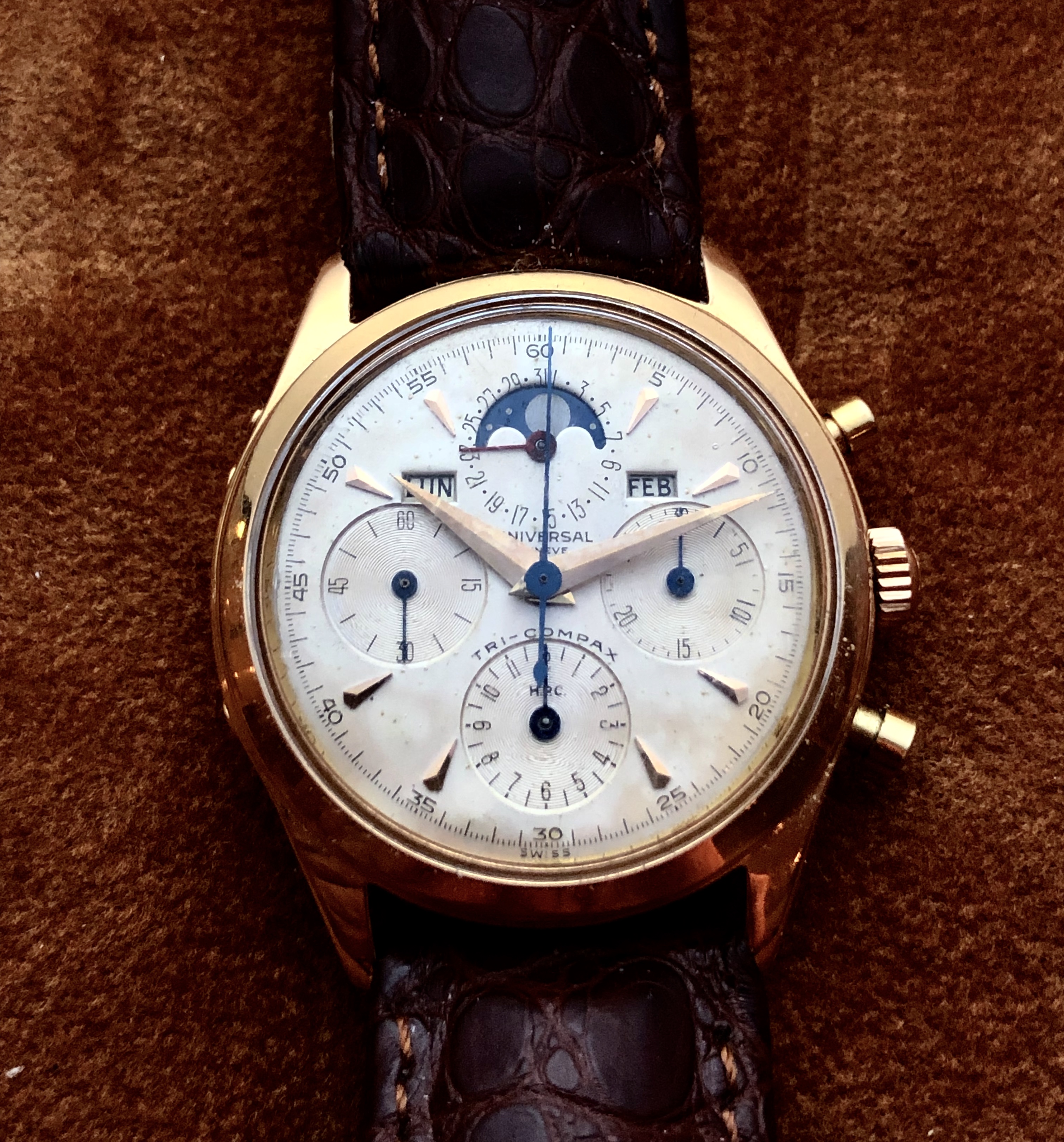

Got a tri compax with HPC on the dial, the seller didn’t charge any extra for it
499
1,526
Nice Tri-Comoax. Congrats.
Can I ask if you got it from Menta watches?
Thanks
