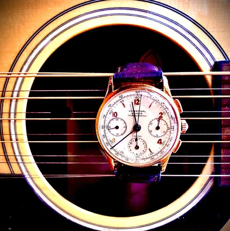

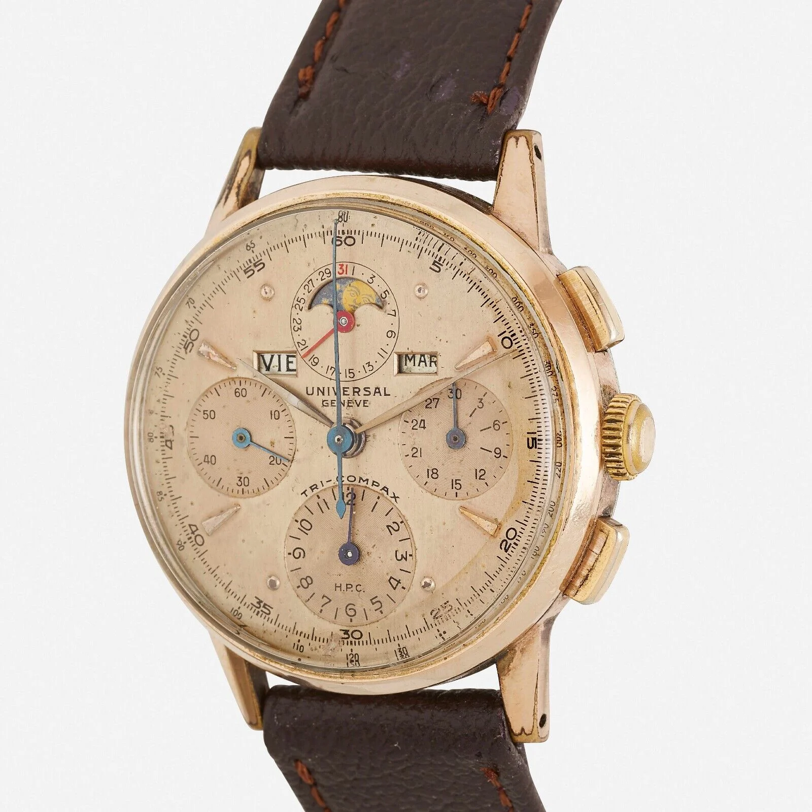

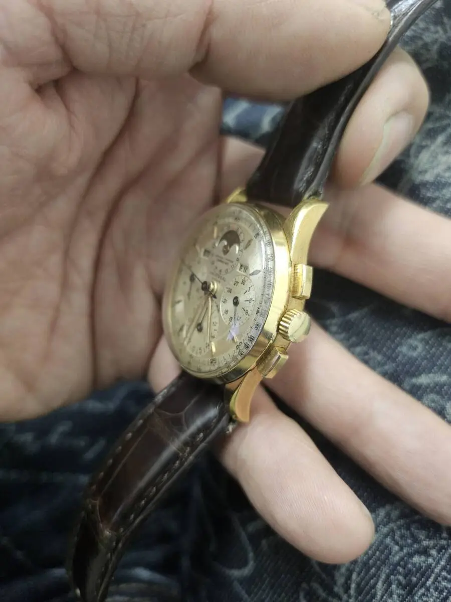

Repainted Dial.
seems probable the original dial had HPC on it? Interesting to know the case serial, to check if it fits the pattern.
42
25
Very interesting thread that took me down a half dozen related and unrelated worm holes. In my very novice opinion, it does seem significantly more likely HPC is the retailer rather than “High Precision <C word of your choice>”
If HPC was added by the retailer it seems very odd that would show up in official UG ads, but then again maybe that is a fitting amount of peculiarity for UG. If it was added at the factory it does seem odd that no Sala reference images contain HPC. A fair amount of examples are not chronographs which would cut down the likelihood of appearing in Sala I suppose.
One area to explore that may help put this “beyond reasonable doubt” (and please do let me know if it already is via another thread or medium), do we know what other brands, if any, Henrique Pfeffer retailed? Do we know what year the shop closed? In particular was it before or after the fall of UG? I suspect with that information there may be other evidence to collect.
Why is this probable ? It's repainted.
HPC is such an obscure designation to put on a dial, my thinking is that perhaps more likely it is replacing what was already there, rather than adding something that was not there......but it's just a guess.

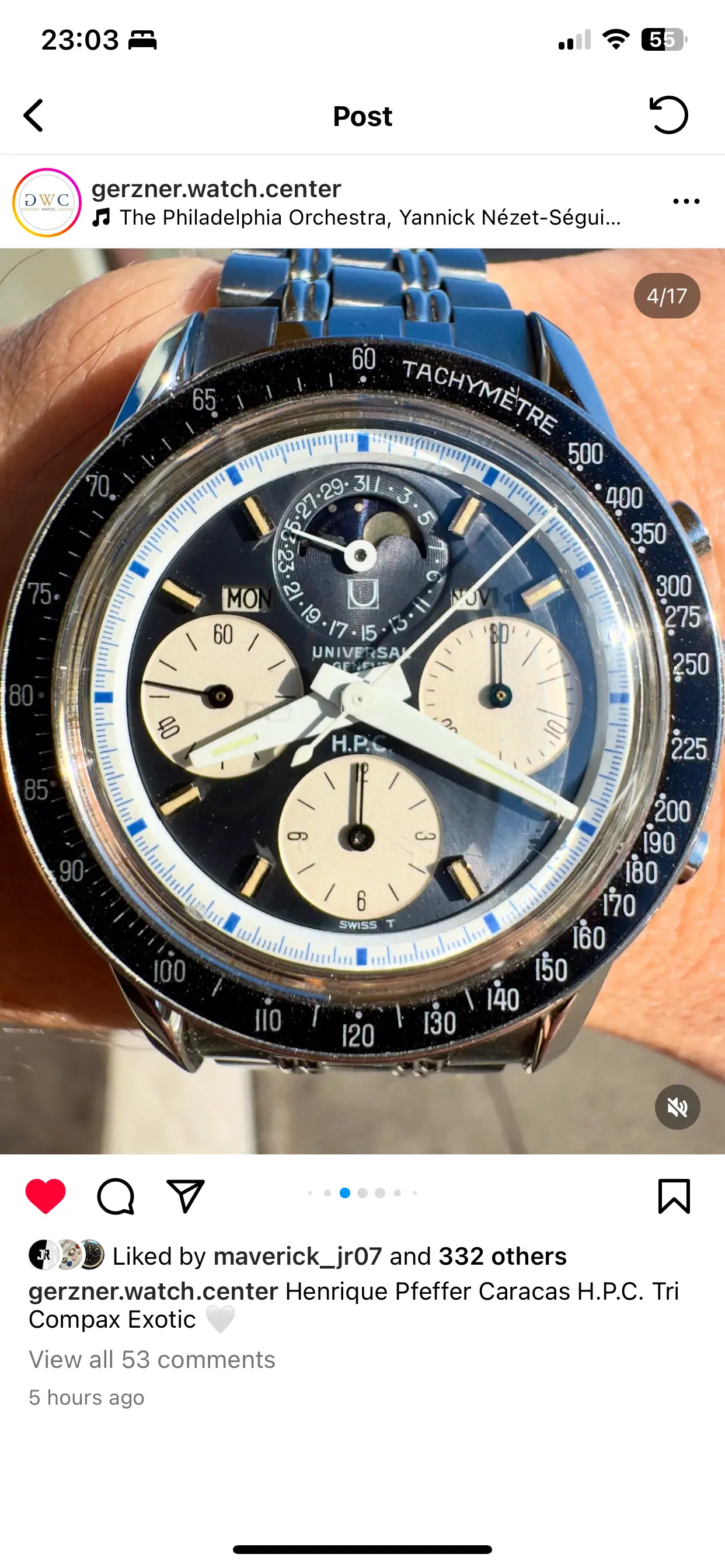

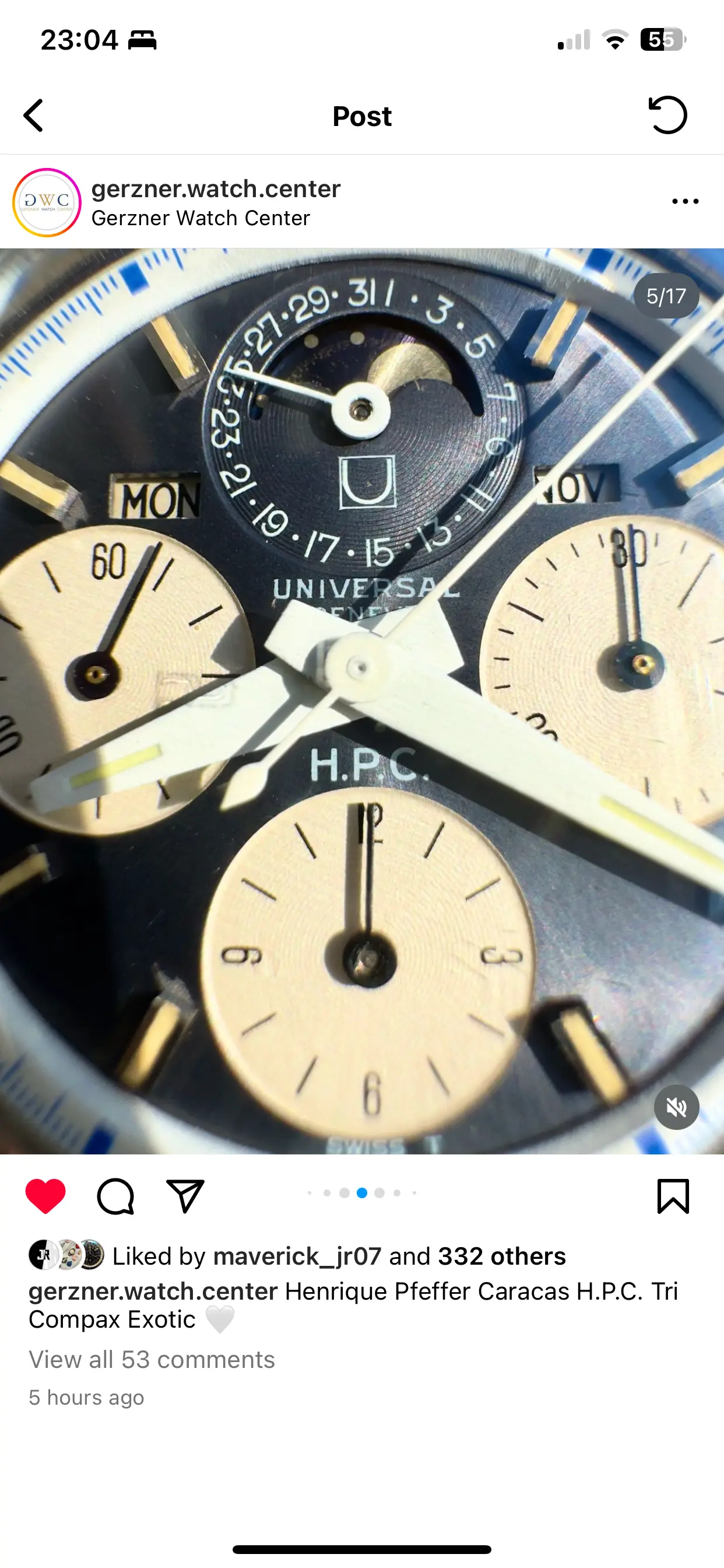

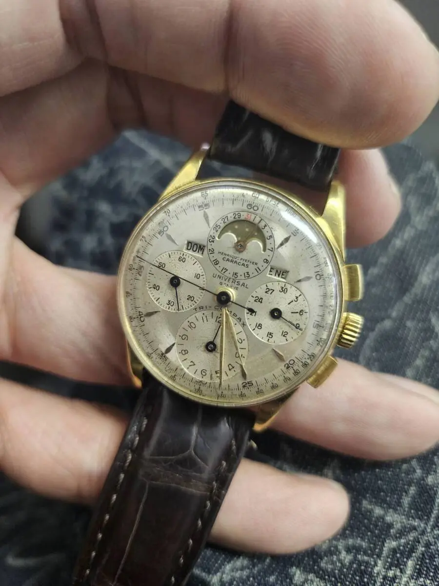

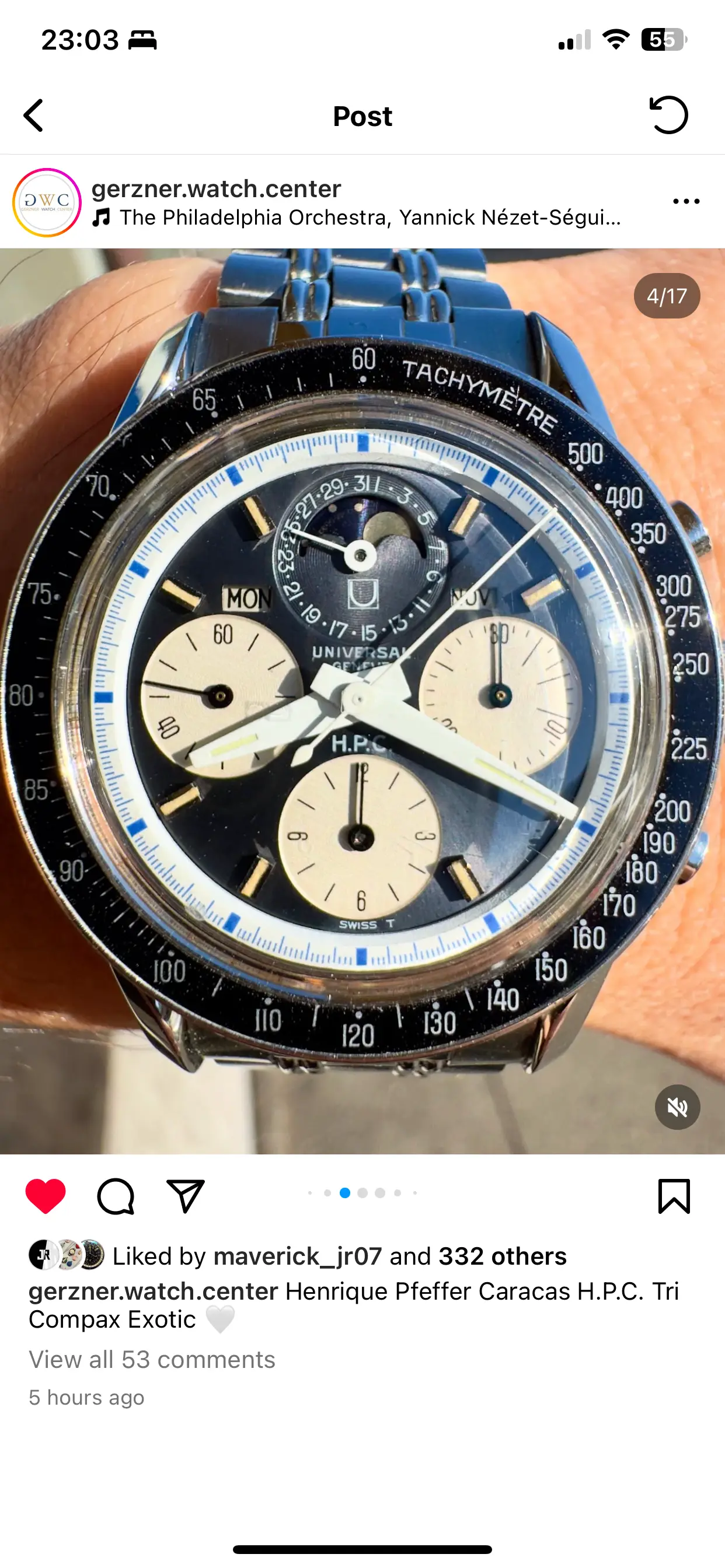

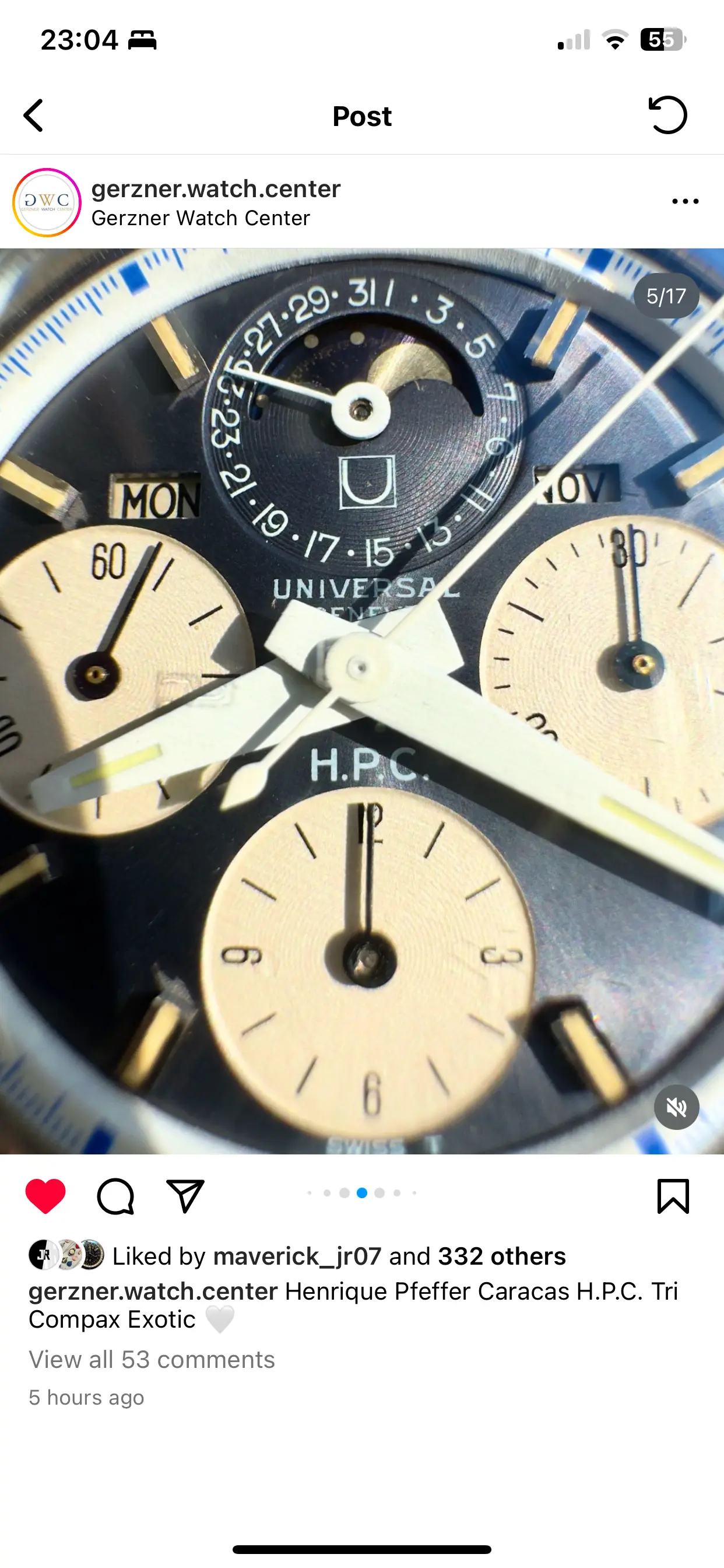

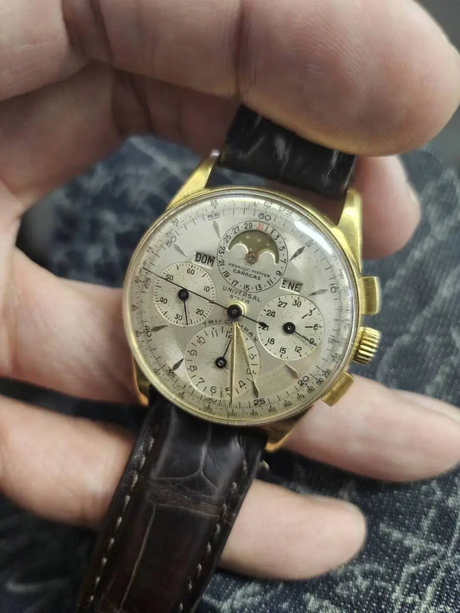

HPC Tri-Compax with Henrique Pfeffer Caracas signed papers
Debate over?
I think we're 99.99% there.........
And I think it's only right this exotic Tri HPC should be donated to me for coming up with the theory 😀

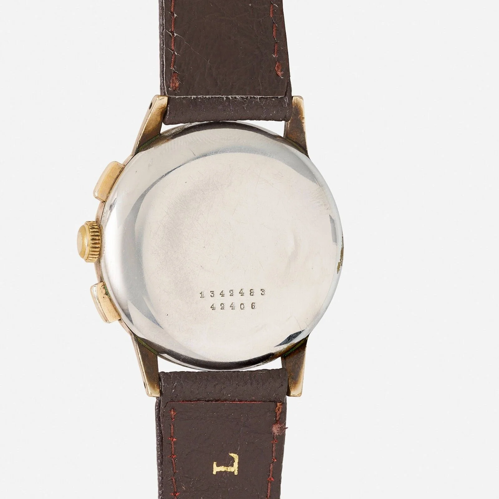

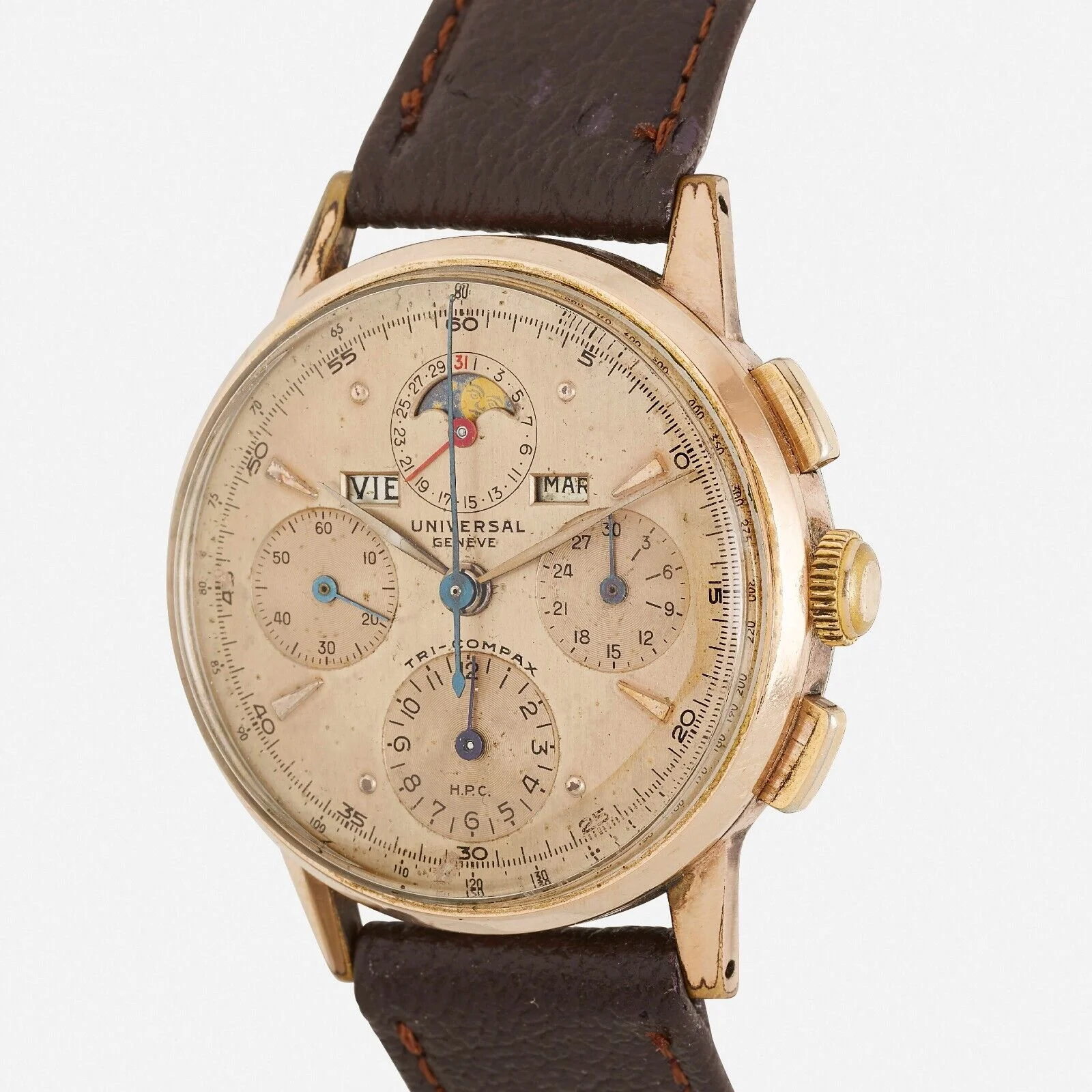

Another HPC which fits the serial pattern, and featuring a Spanish day disc.......
75
133
Here's another example for the record. Also fits the serial pattern and has Spanish day/month discs. Cool watch

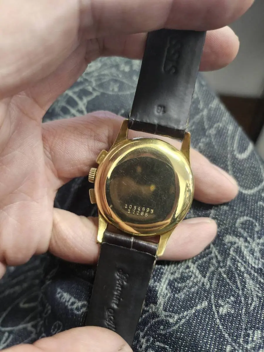

Don’t forget this one….I think both examples speak for themselves.
6,911
10,772
Thats a clear redial. How could I like that 😬::facepalm1::

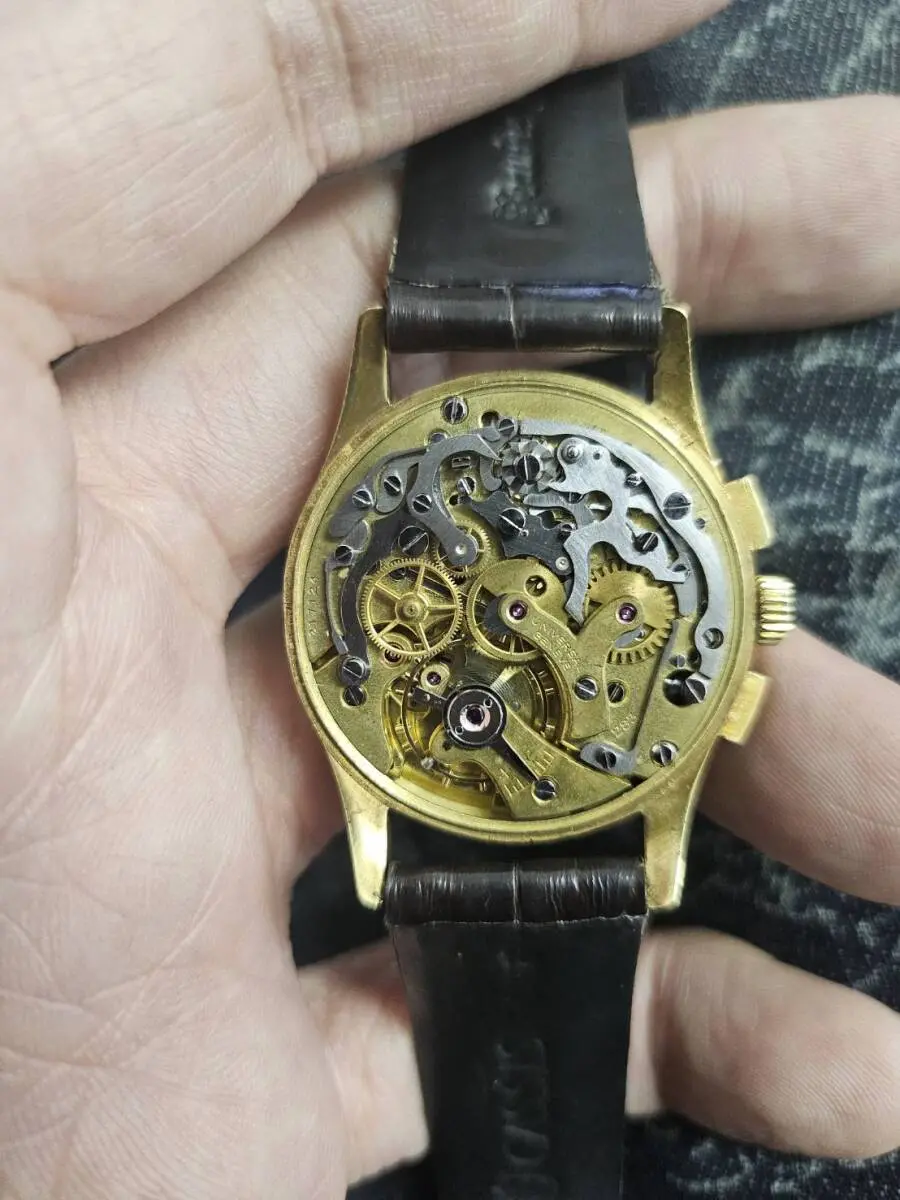

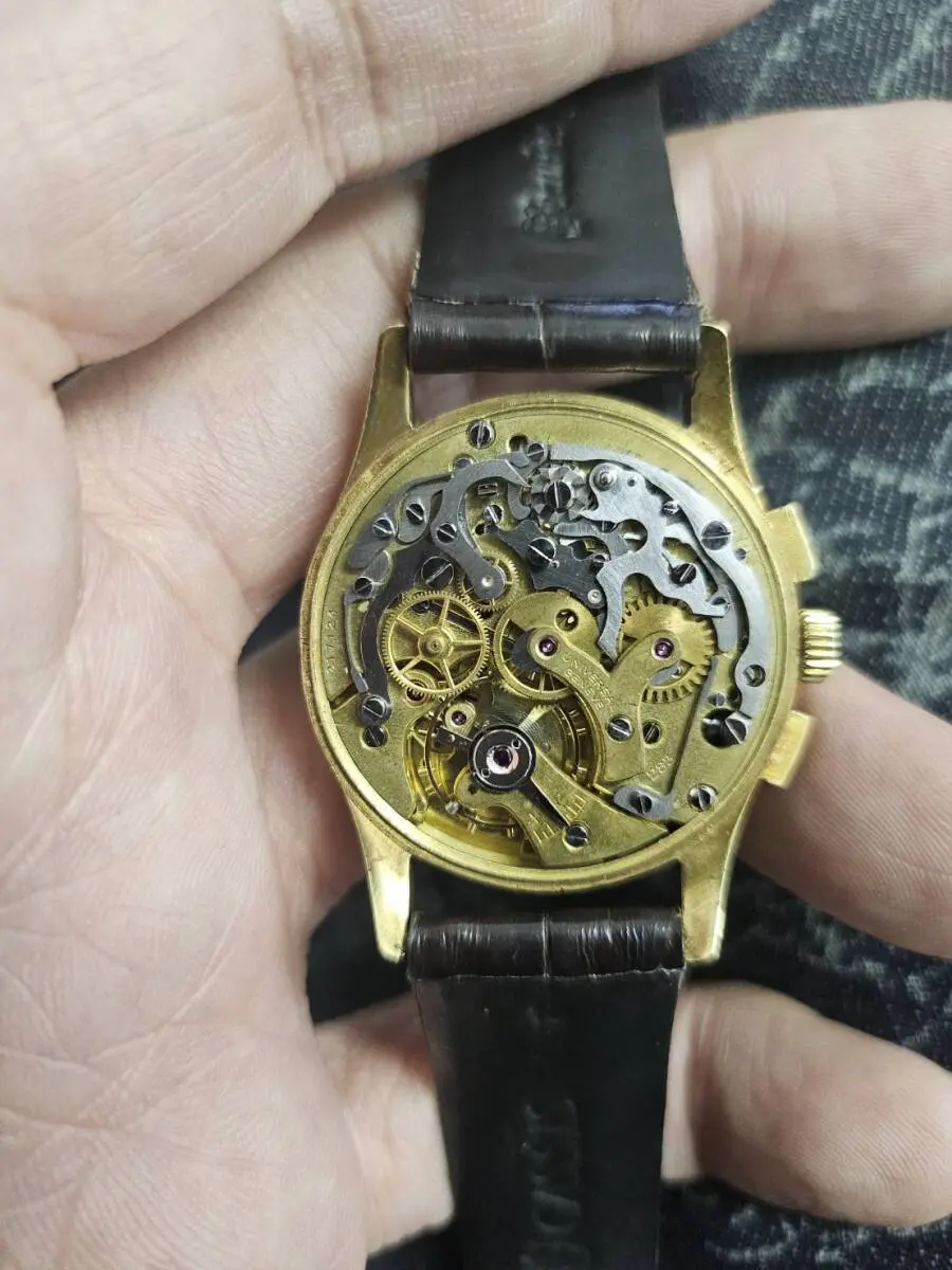

The other one is a redial as well IMO.......but if you wanted more info, have a look at the movement, which I'm guessing is stock
6,911
10,772
Dont think so
