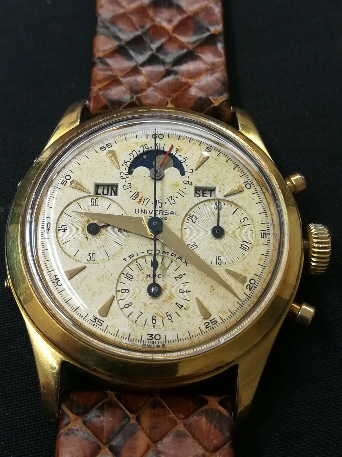

Nice Tri-Comoax. Congrats.
Can I ask if you got it from Menta watches?
Thanks
Thanks, I got it from a danish auction house called Brun-Rasmussen

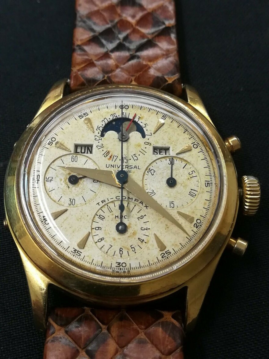

Got a tri compax with HPC on the dial, the seller didn’t charge any extra for it
Congrats!

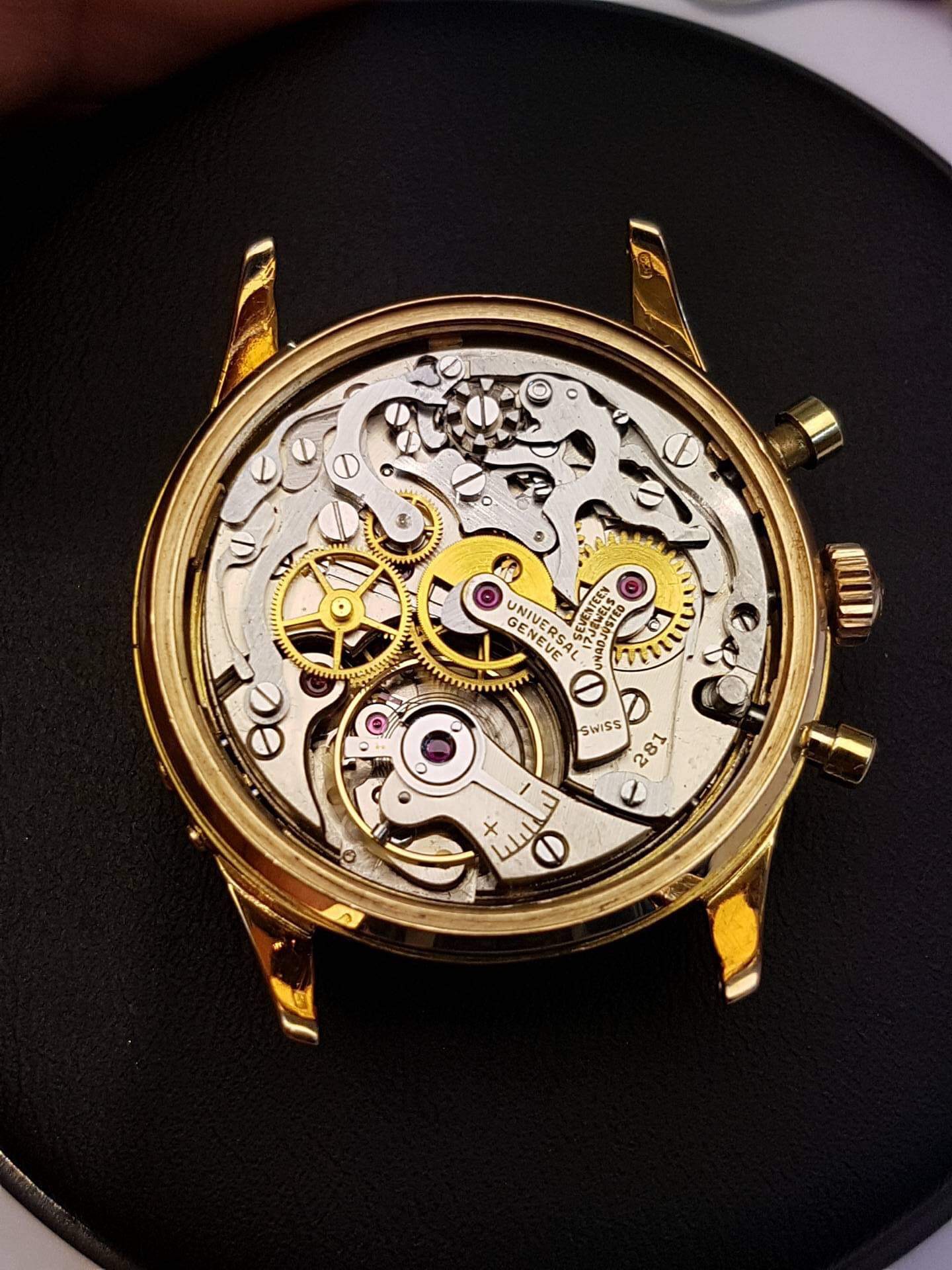

Would u mind sharing movement pic ?

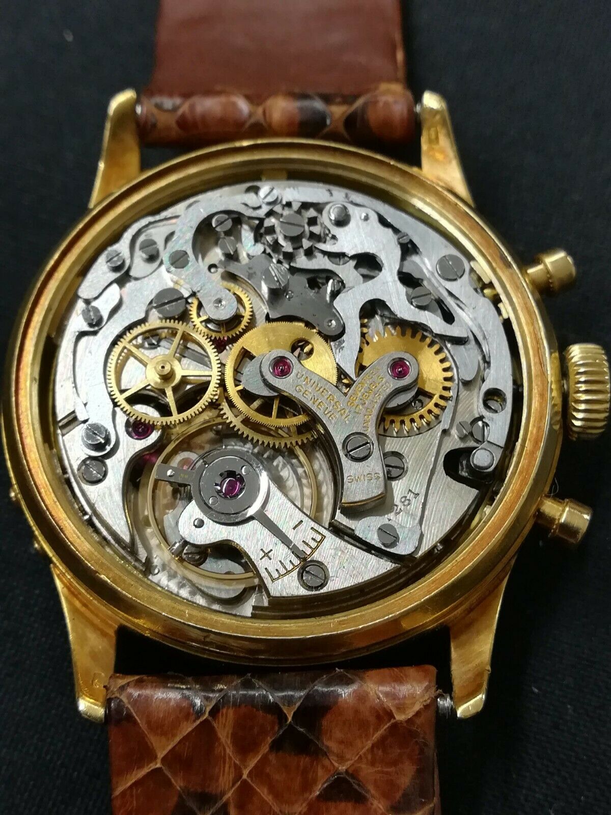

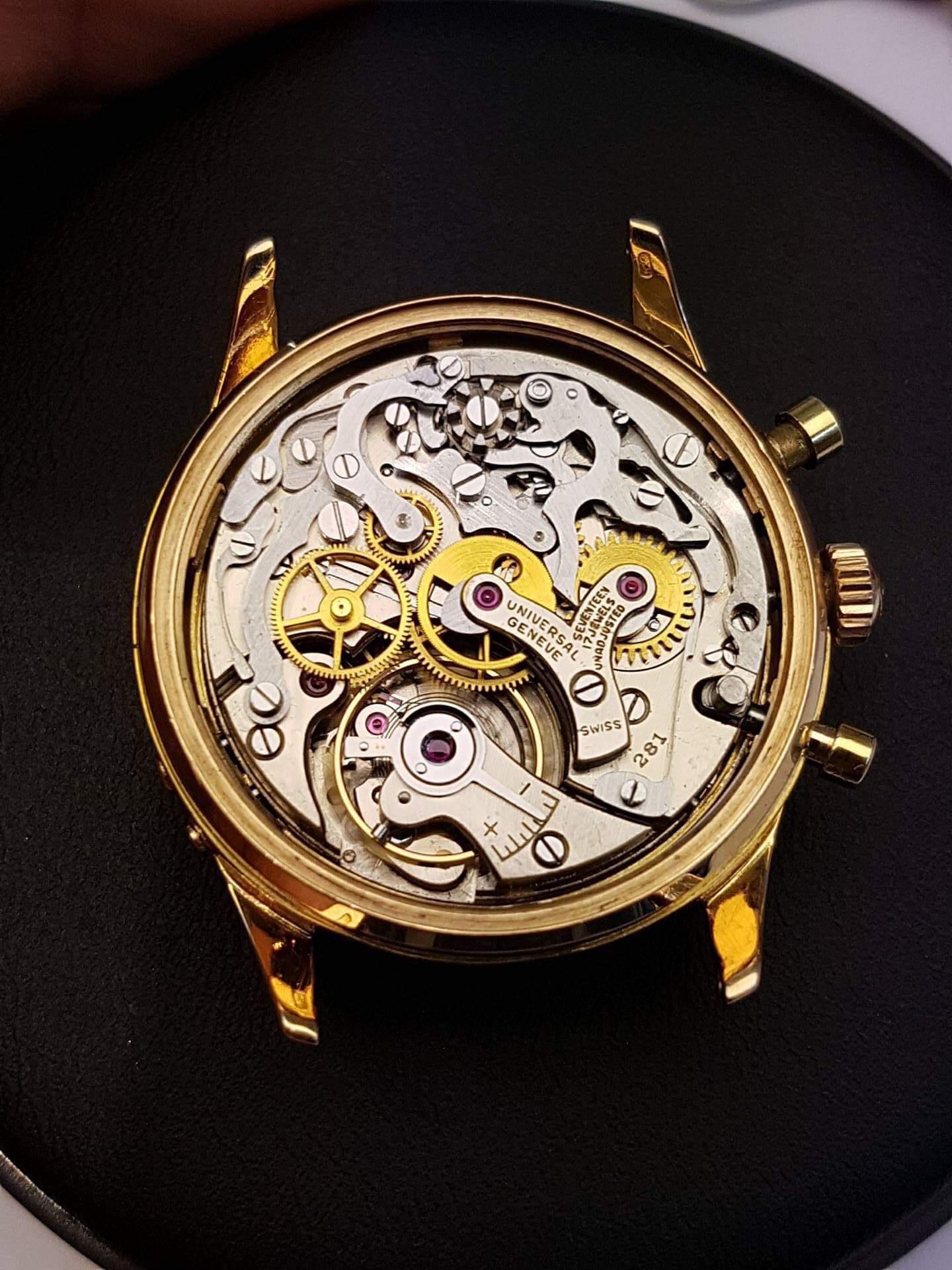

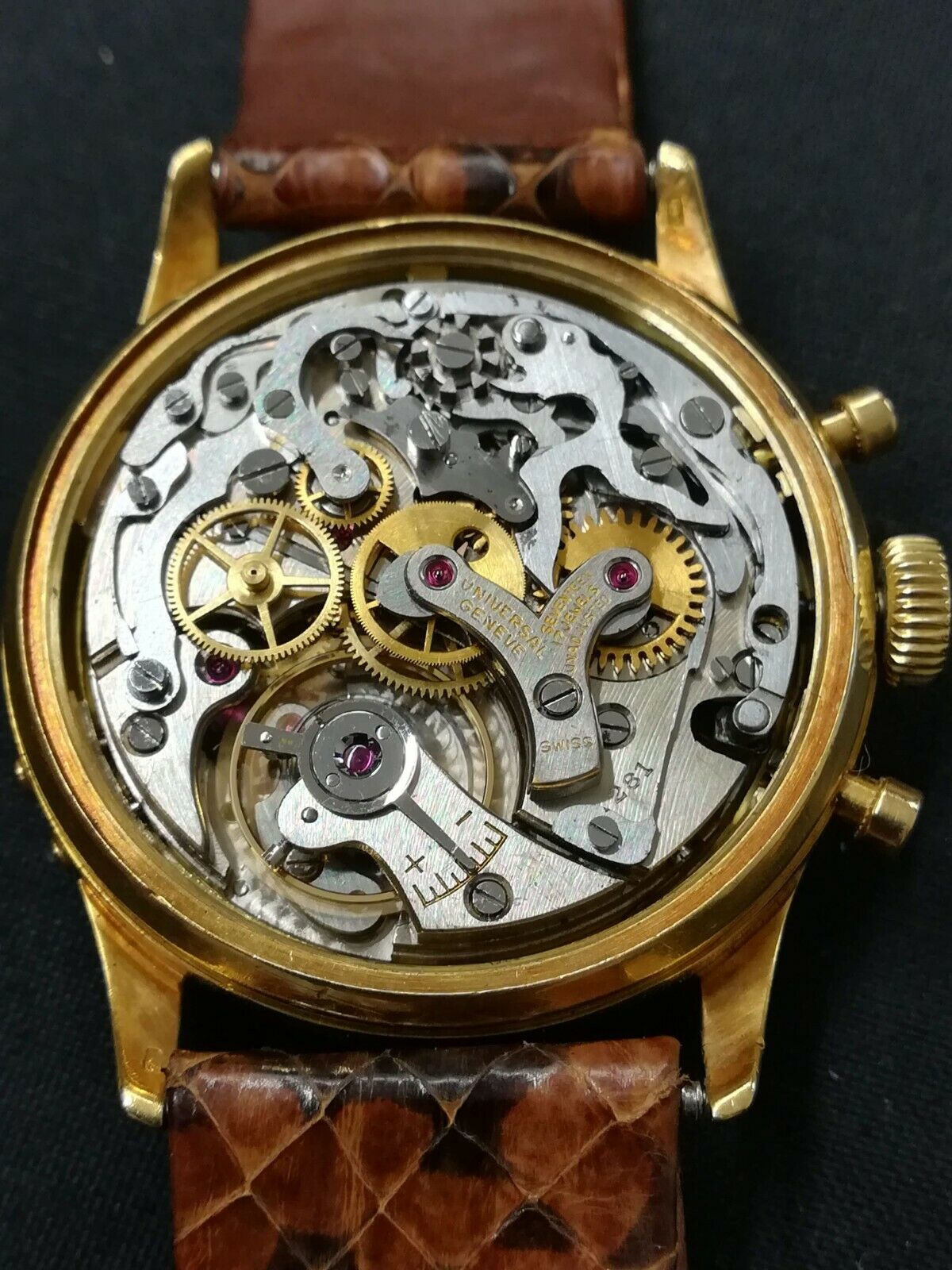

Both front and back 😀
So not a numbered movement and inscribed "Unadjusted". The opposite of what might be considered as the marks of a chronometre.
