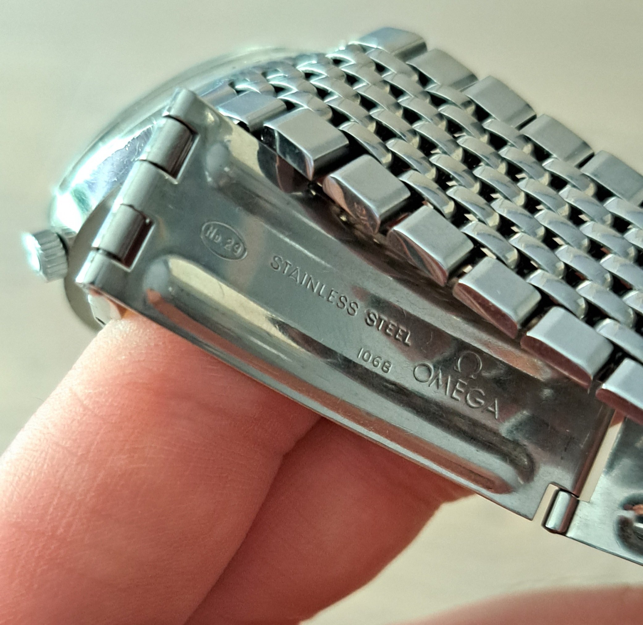

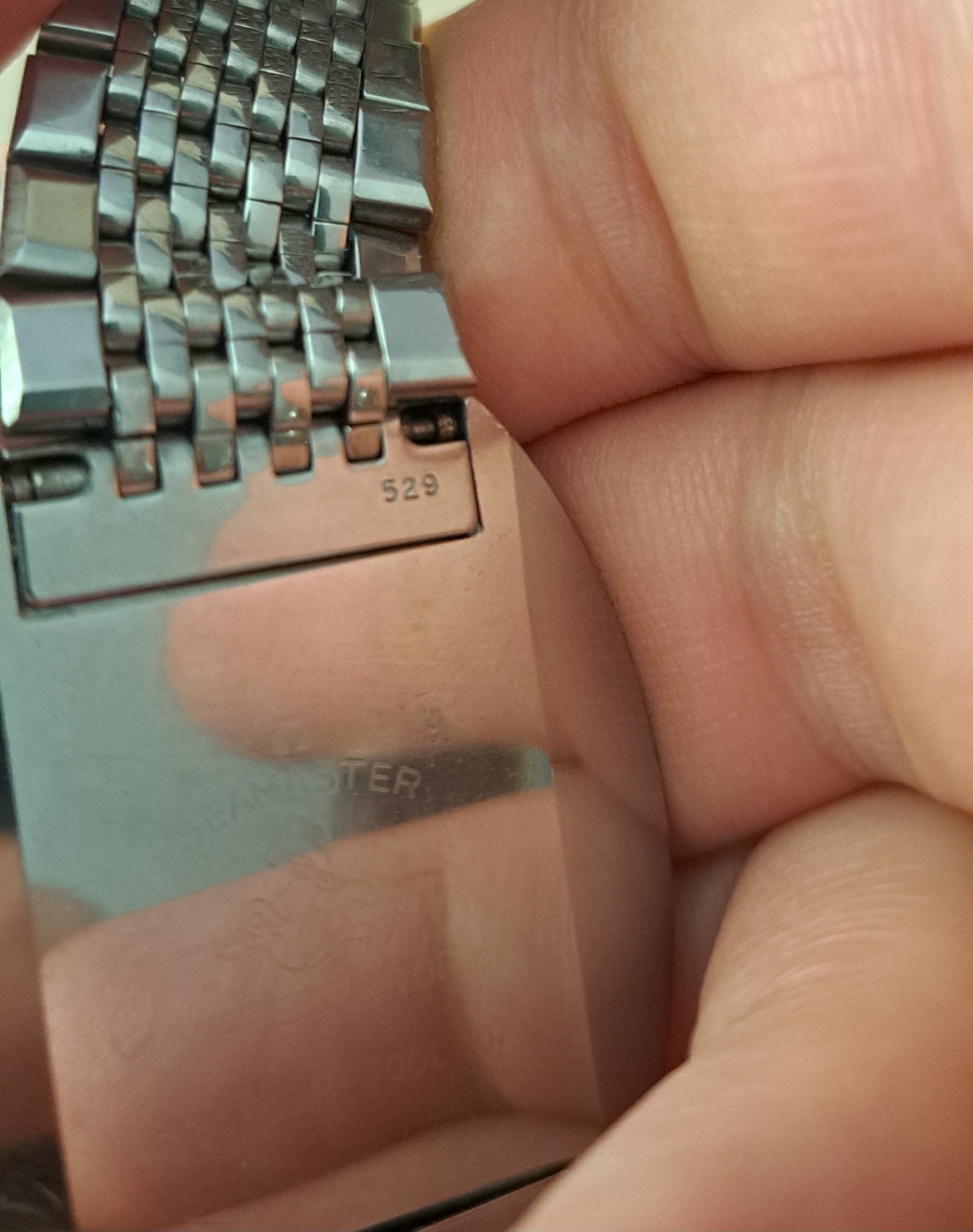

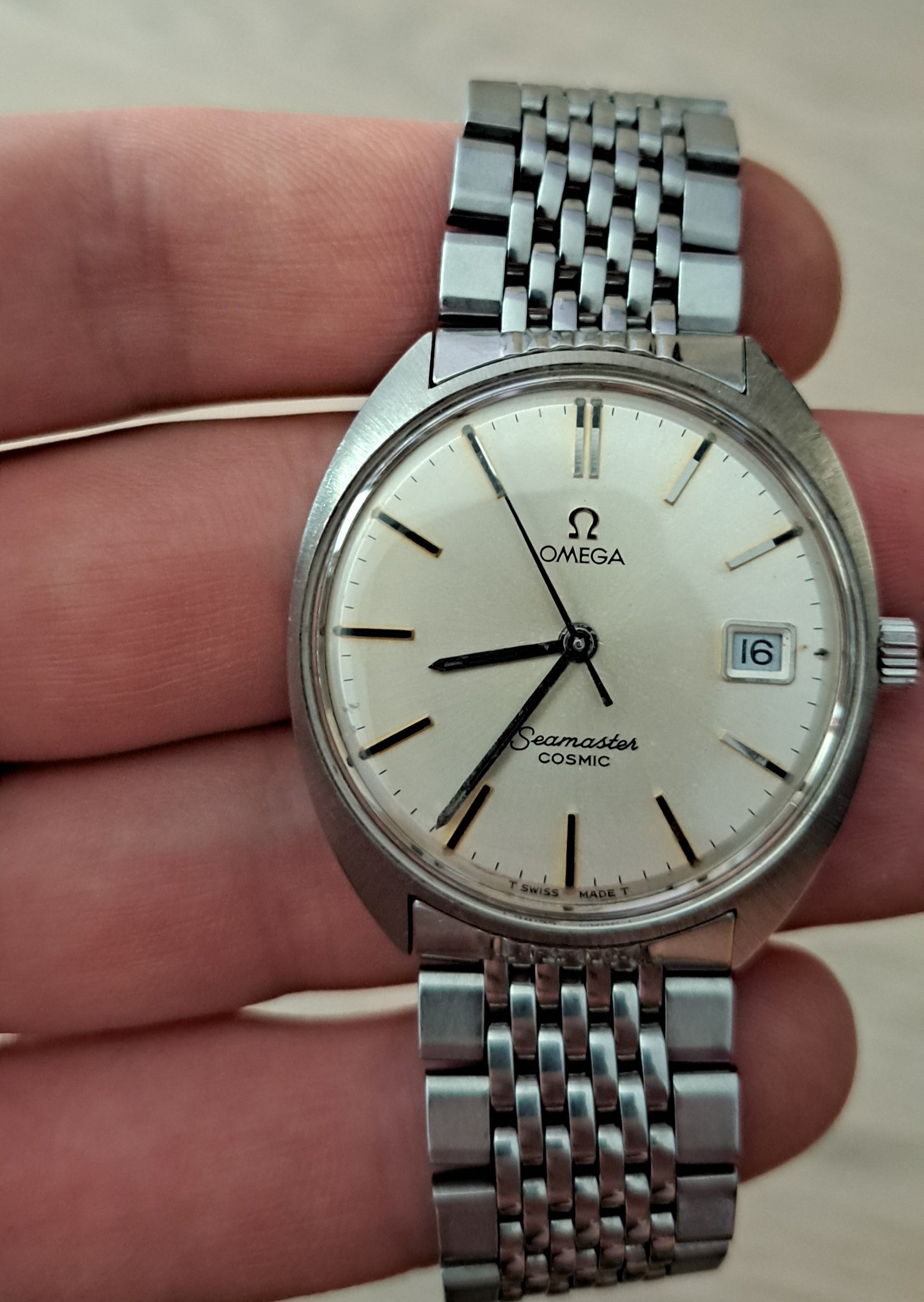

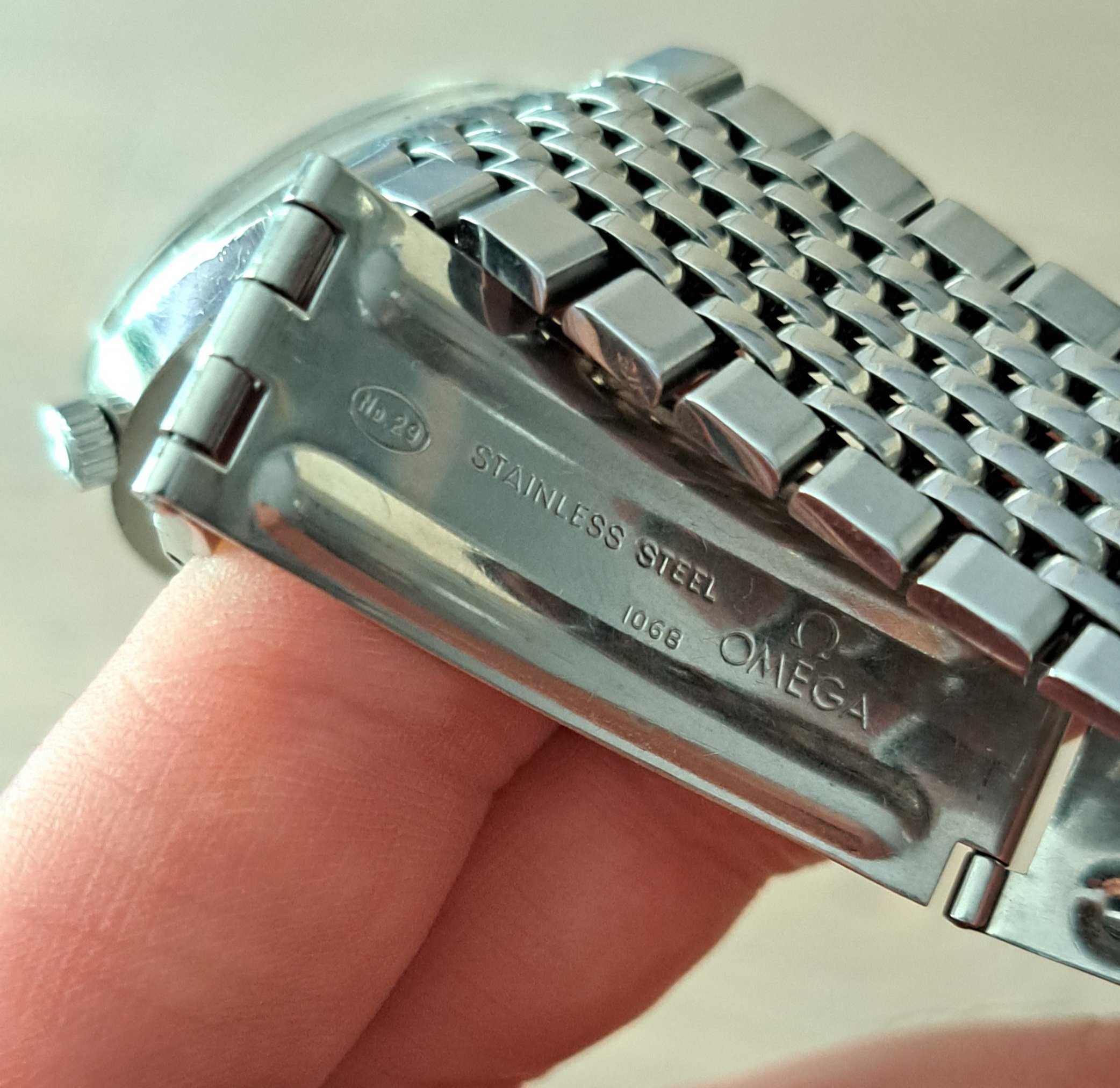

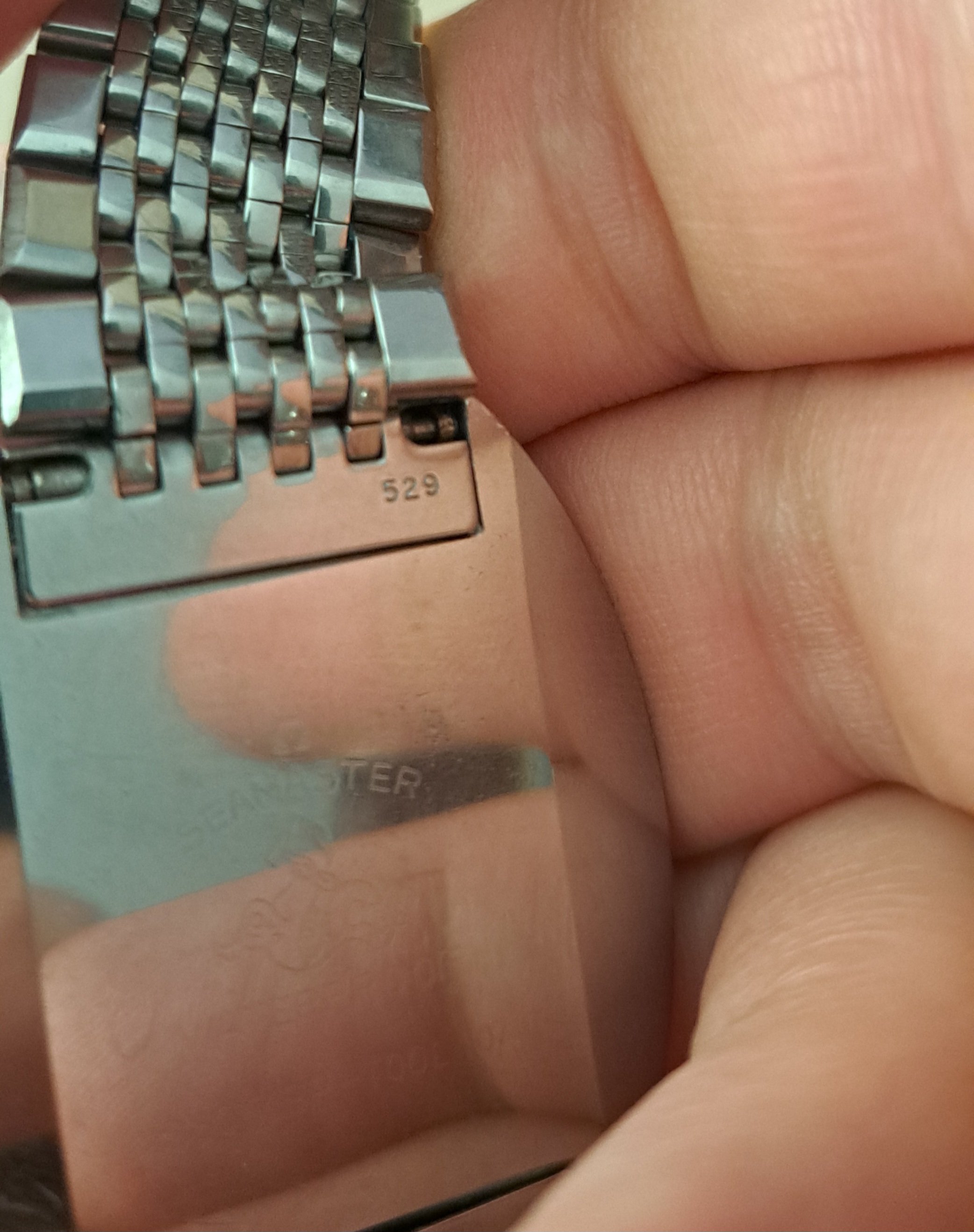

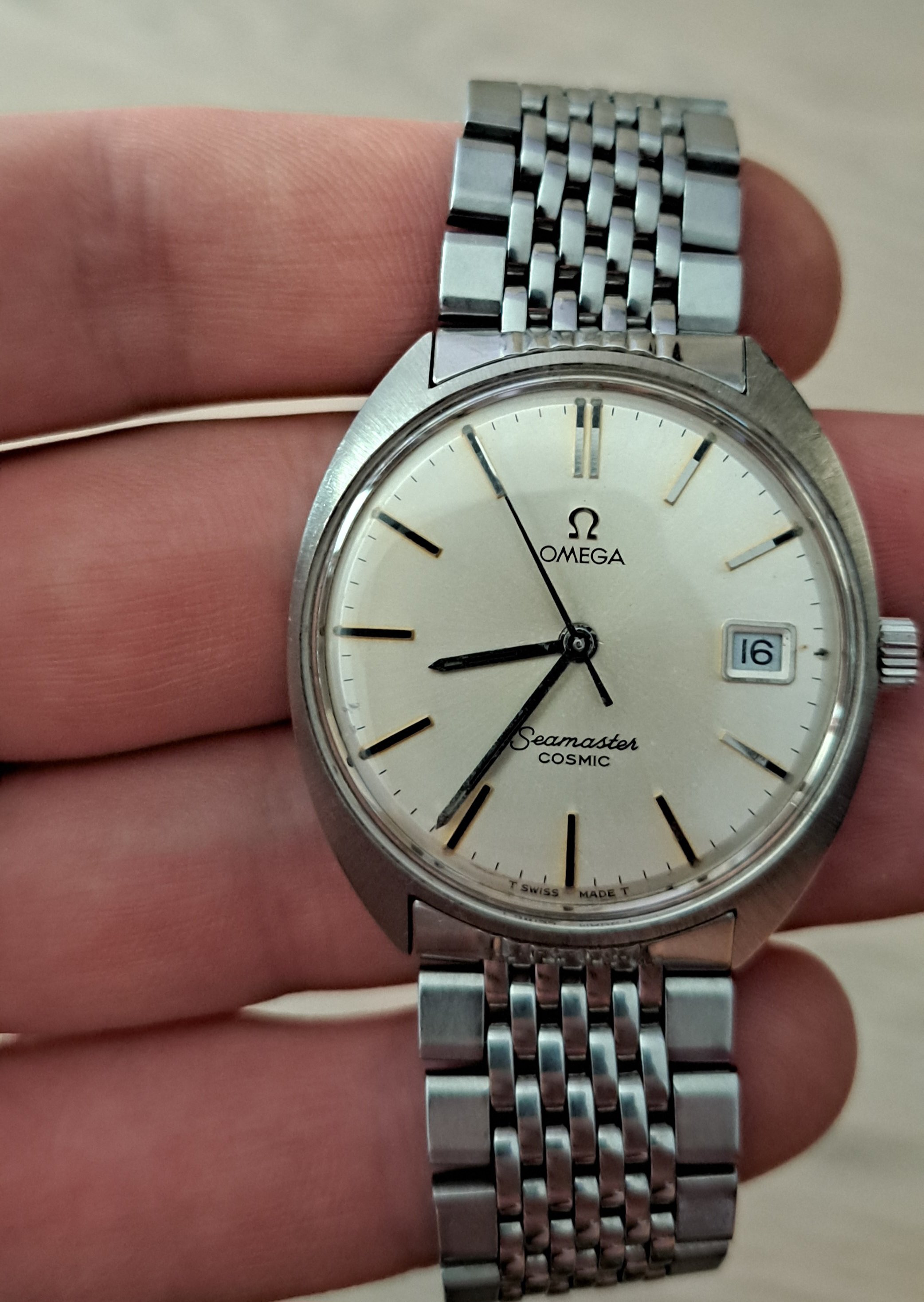

I checked my Omega Cosmic ref 136.0017 and everything is correct, the bracelet has the number 1068 and the endlinks are 529 😀

Hello guys
thanks for the compilation, great job, very useful 😀
What about references like 2536-3 (bull's eye) or 2800-3 P? Is it possible to check which endlinks will fit such case?

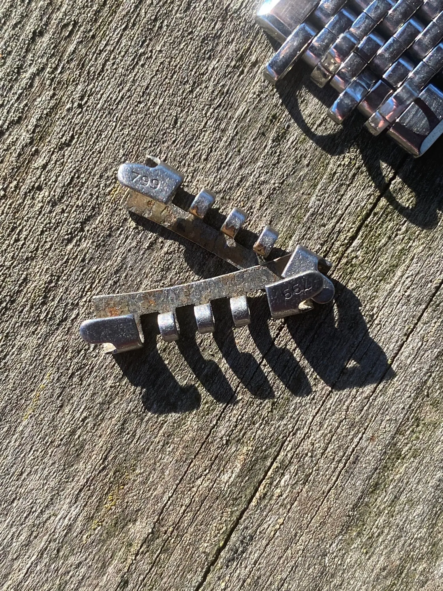

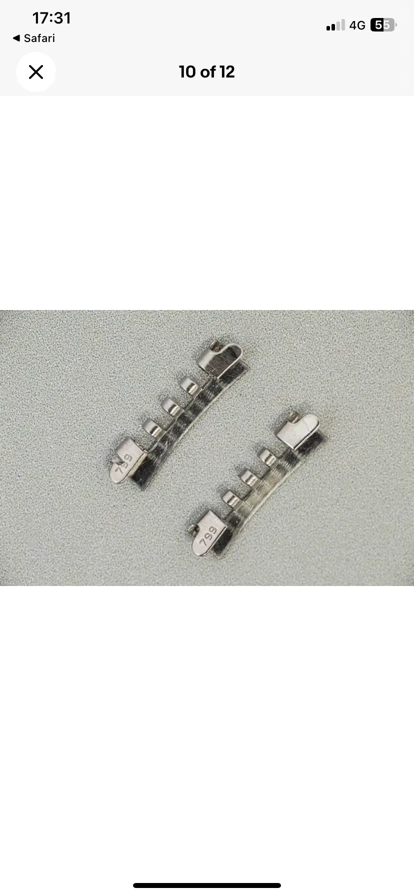

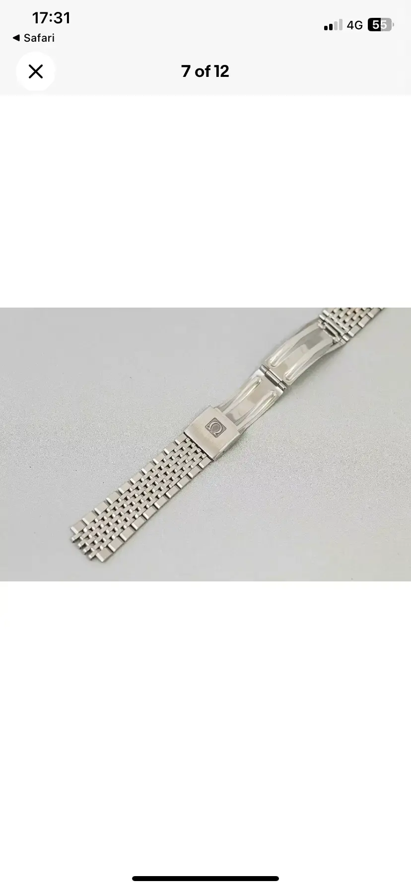

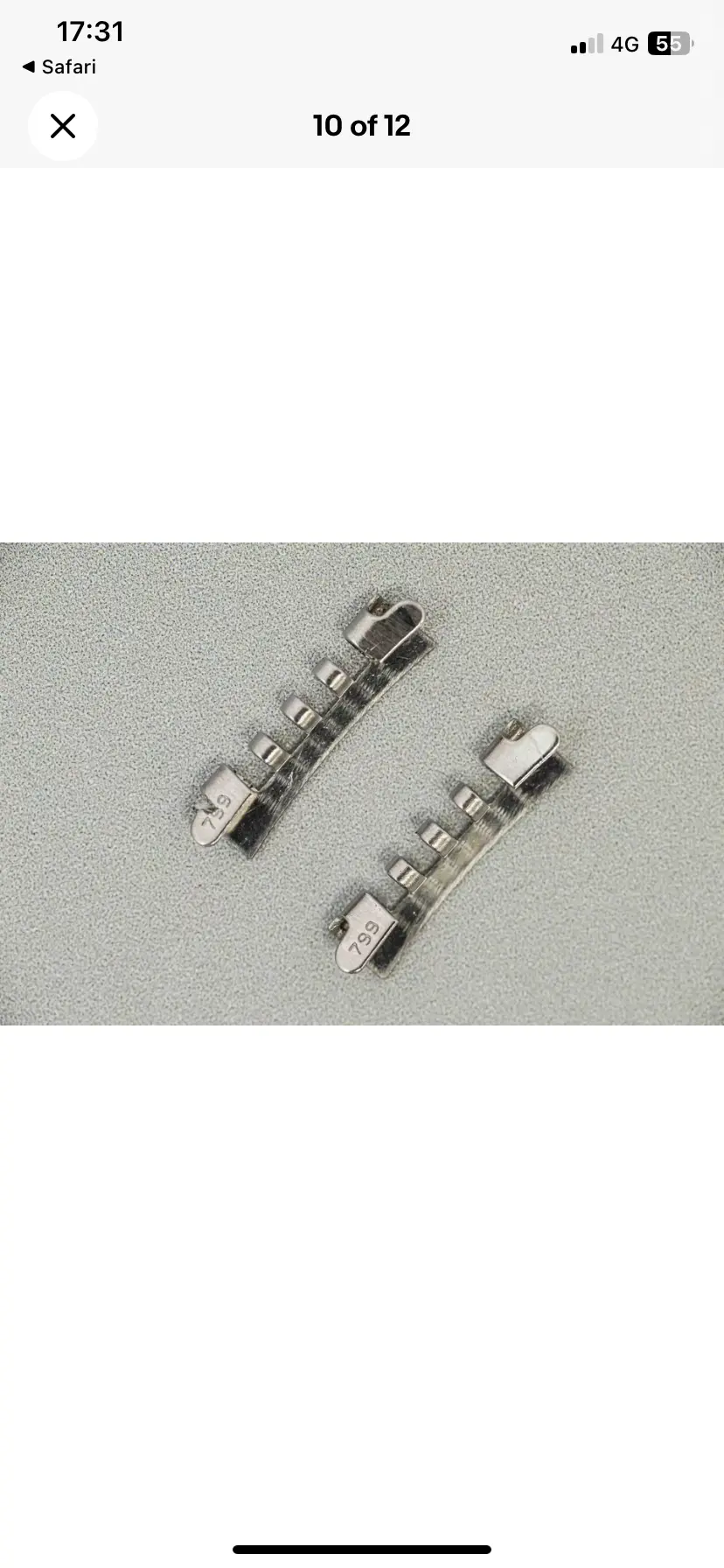

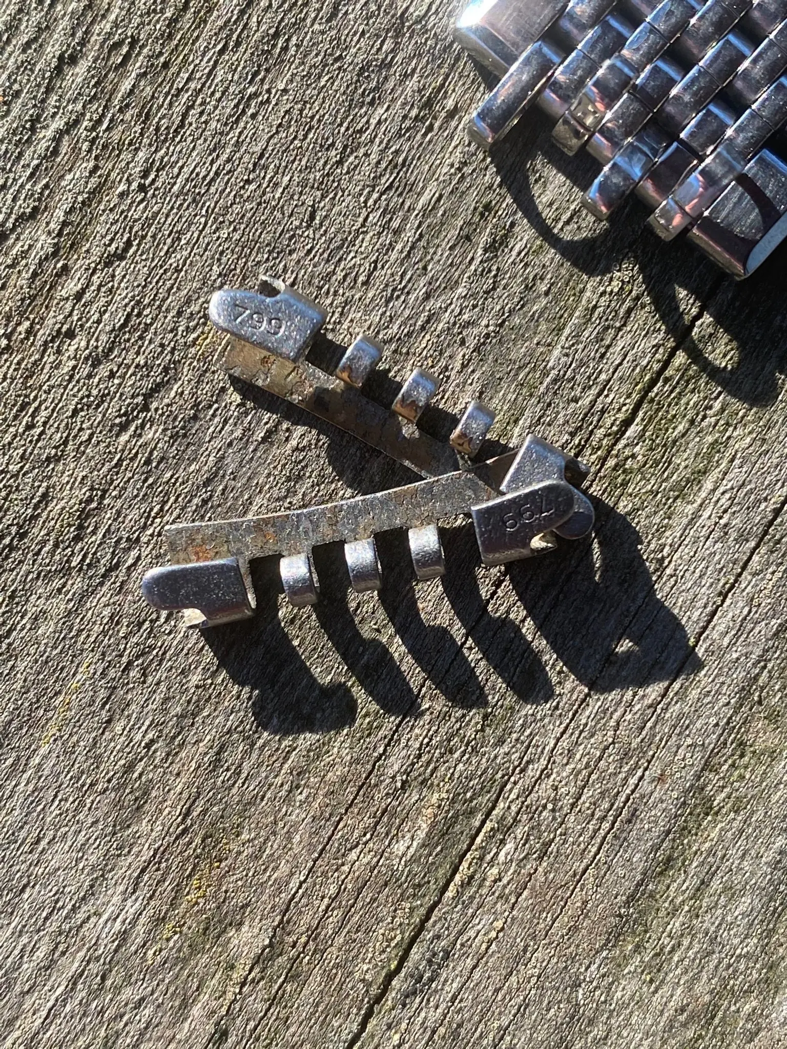

I found a 1037 bracelet with 799 endlinks. Does anyone have an idea of case match for those?
Does 799 not show up at all in the list?
1,722
7,399
Not as far as I could see.

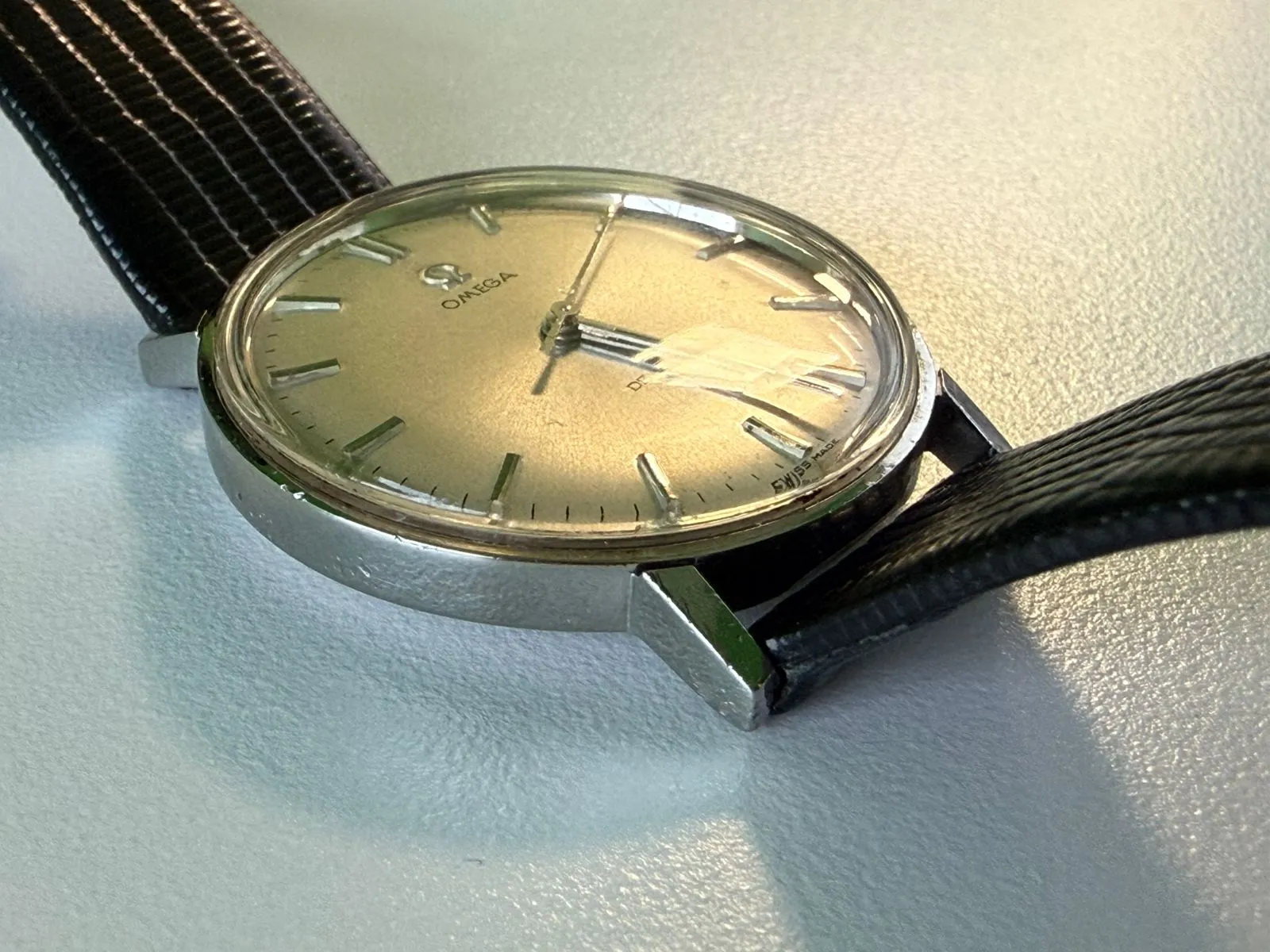

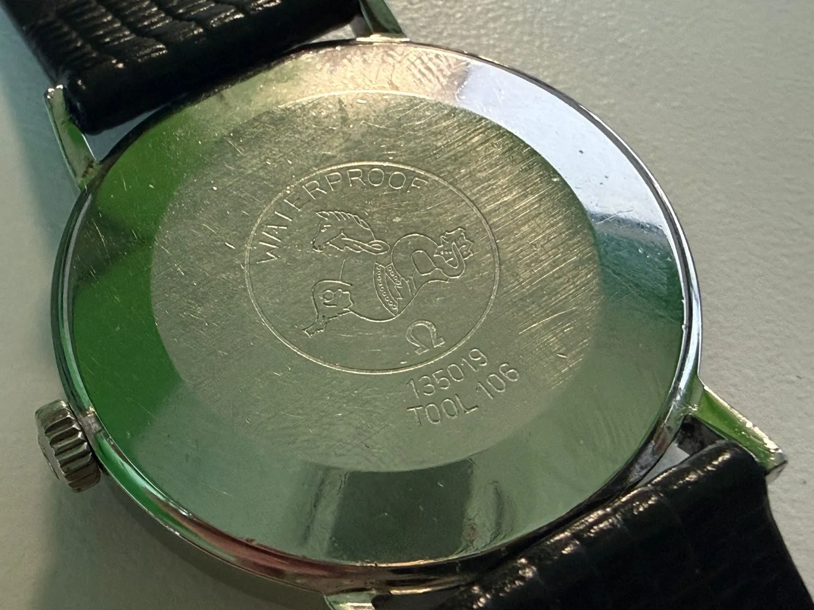

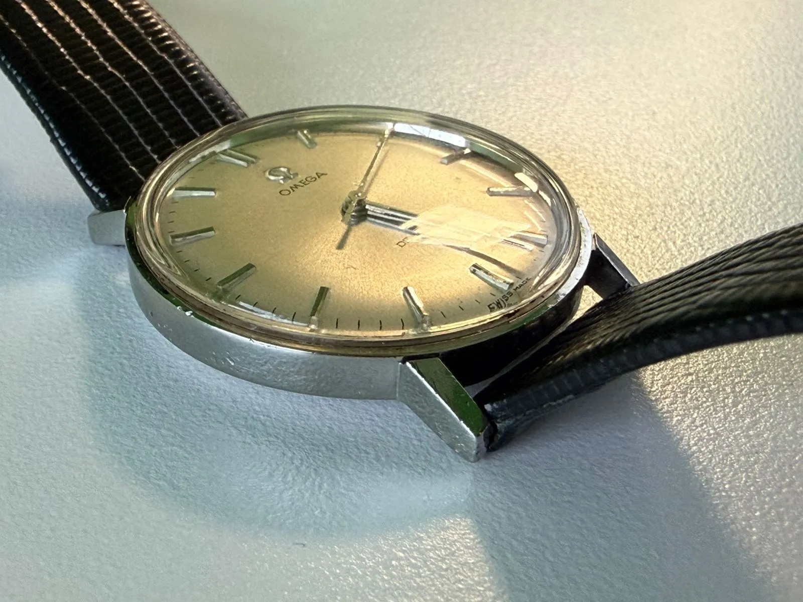

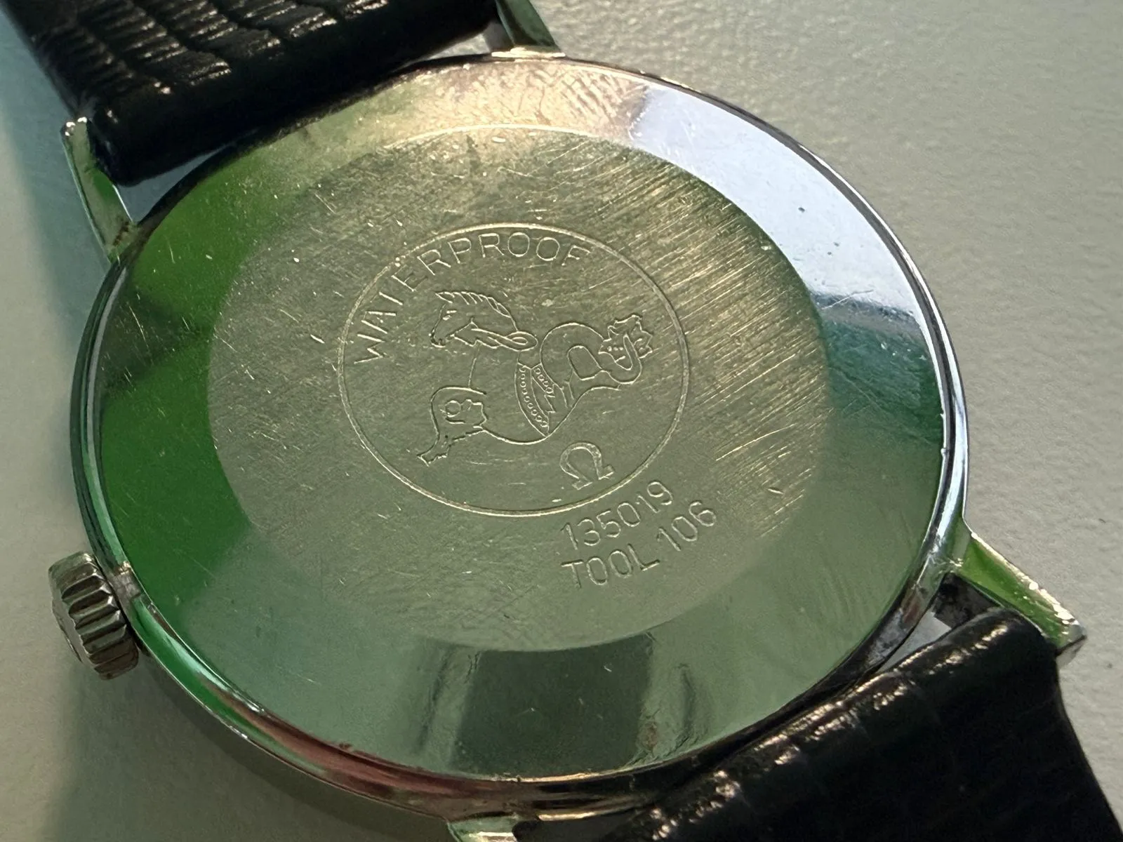

Hello ! I'm looking for a bracelet for my deville I got in an aution. I would love to have a BoR, but other steel bracelet would do the trick. I rather prefer to asking becasue I don't have my ref number listed. (135.019)
13,571
23,557
I’m not sure the 135.019 came with a bracelet. As it was an entry level mode I have a feeling it only came in a strap.
If you really want it on a bracelet you could try a 7 row beads of rice with 570 Endlinks but I don’t know if it will definitely work.
I really really want a bracelet. Will check if I can find one and try it out. Thanks a lot!
