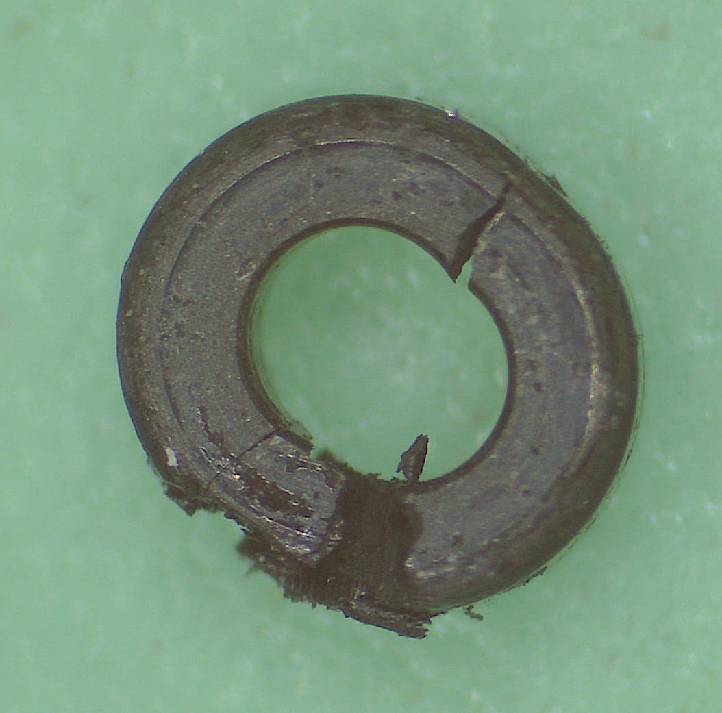

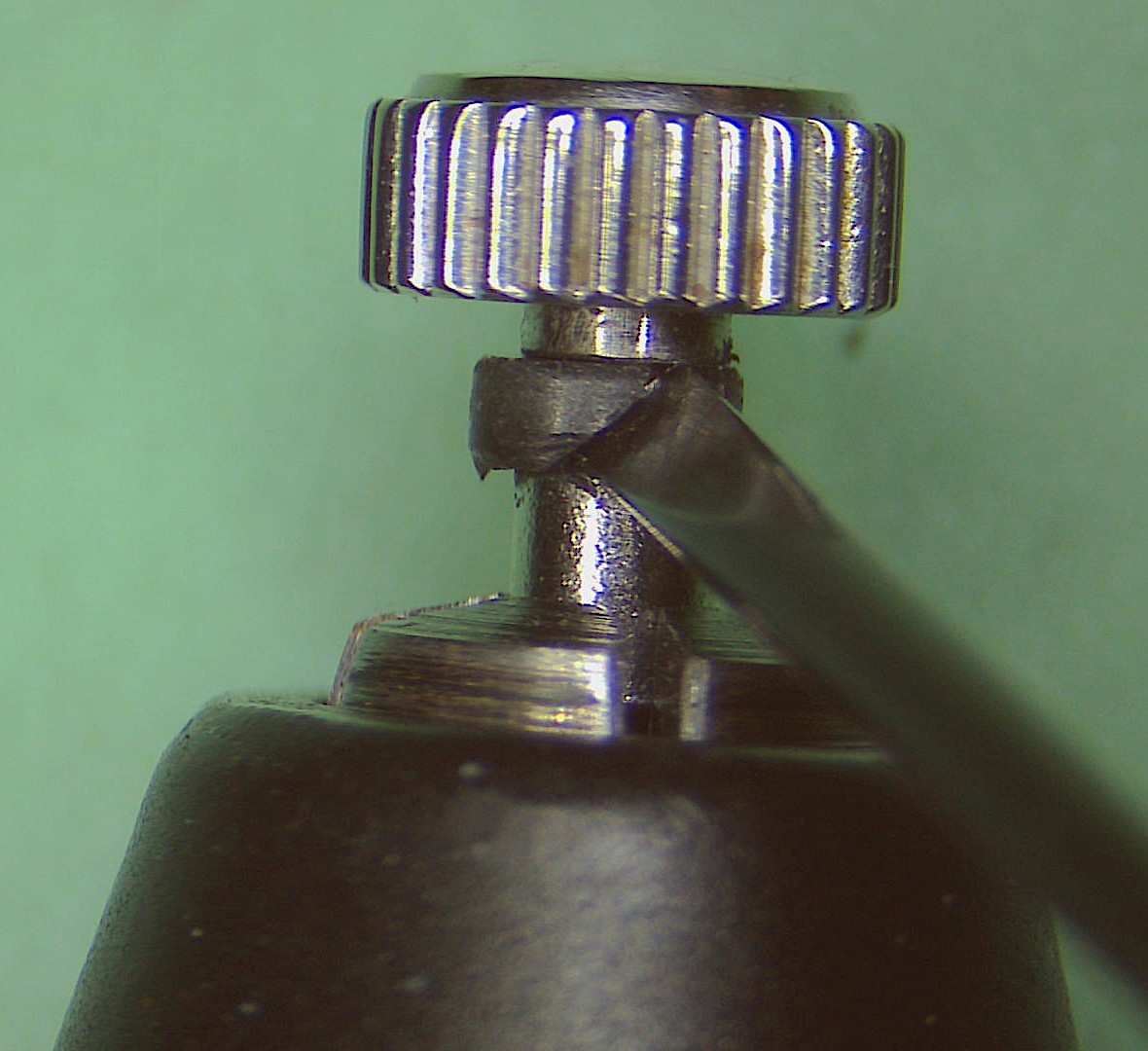

Just came across an example of why you should change seals/gaskets before they fail to do their work.
If they are still serviceable, you can stretch them off. If they are past redemption, they have to be chipped off.
And this is what they look like, a solid hard brittle rubber ring, not a nice flexible squishy thing that it should be.
Yes, and sometimes they can be extremely hard and brittle...
