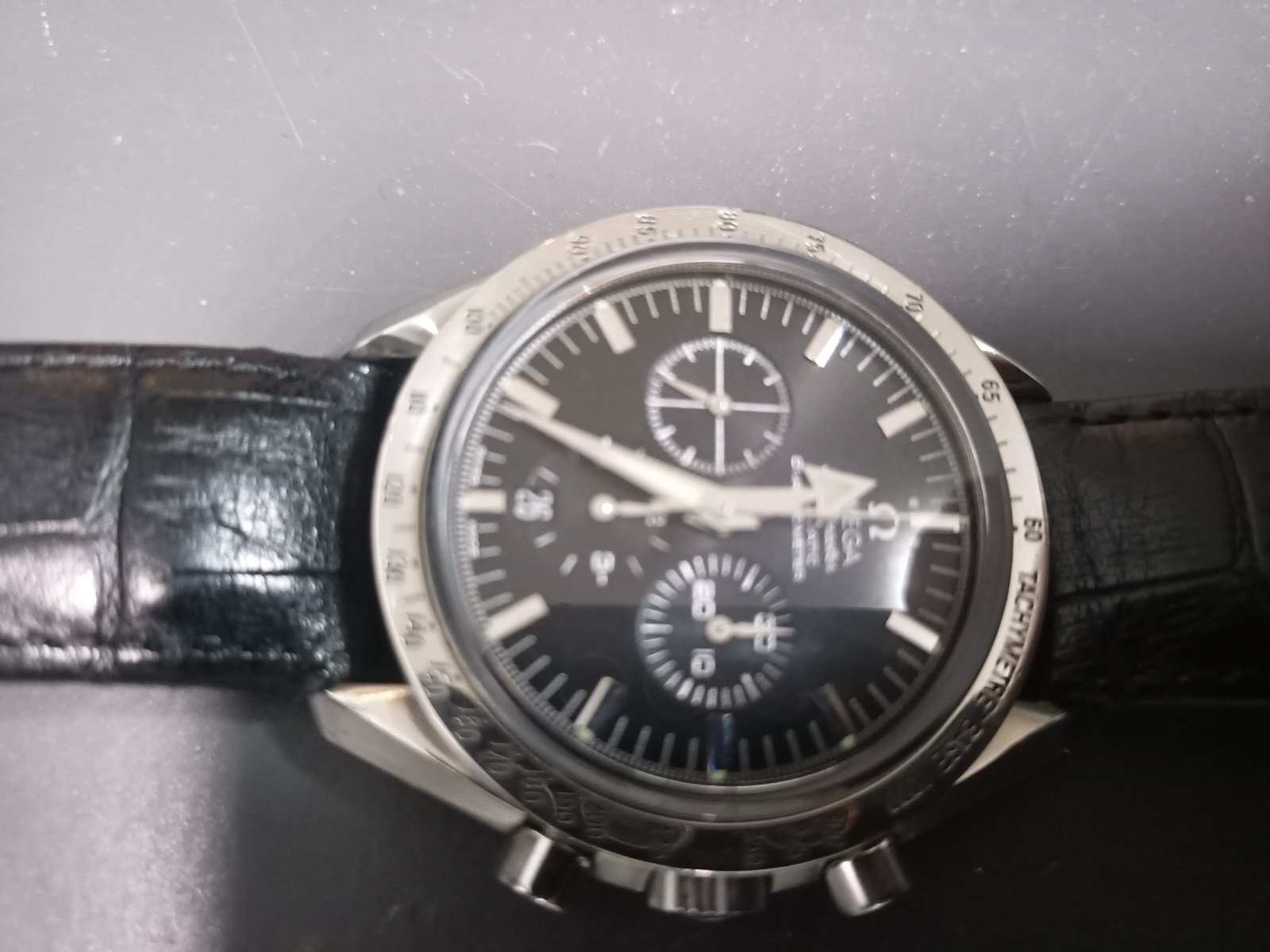

Hi Can anyone please give me the approximate date of manufacture for a Speedmaster Broad Arrow 385 150 11 with a 7 digit serial (800 xxxx). I've been told by the seller circa 2011 but need confirmation. Thanks a lot

It’s earlier than that by at least 4 years as it’s pre coax but you’ll need to provide the first 4 digits of the serial for a better answer. I suspect the serial starts 78 but they stayed in the 78s for years. At a guess it’s from circa 2005-6

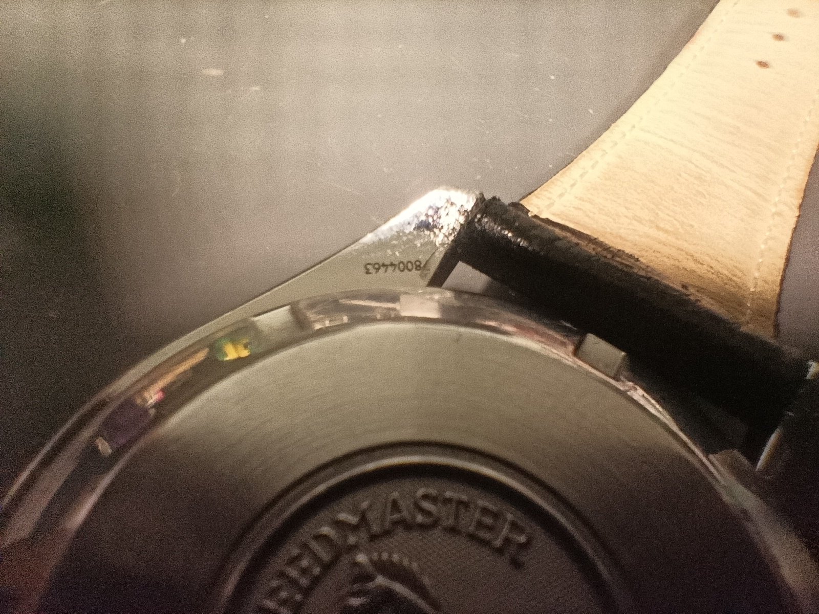

Thanks. The serial is 8004463. The movement is 3033. How do you distinguish that it's pre coax?

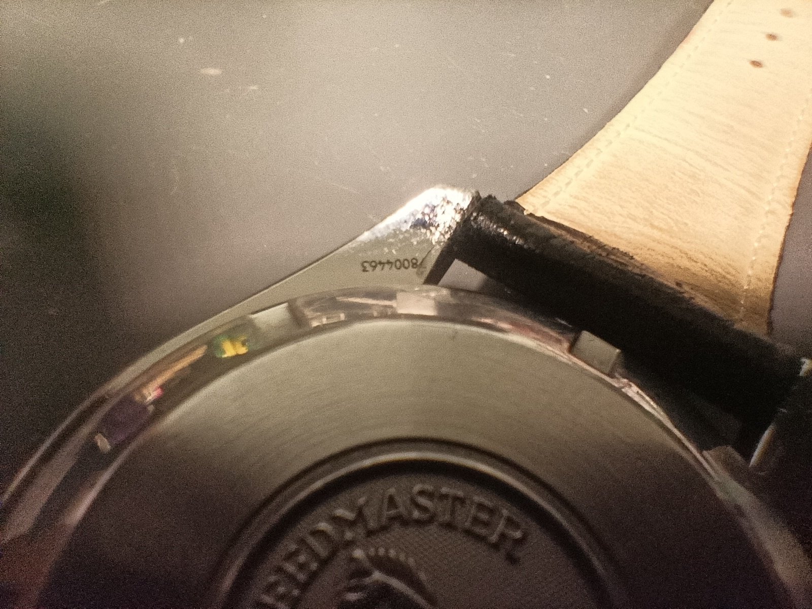

Here's a picture. The first digit is scraped off by the previous metal bracelet. It should be 78004463. If it's from 2006 then I've been duped.

Because the 3303 was never a coaxial movement, it was renamed the 3313 when upgraded and the text on the case back changed to reflect this. The Broad Arrow models were introduced using the 3303 movement in 2002 and the movement was upgraded to the 3313 around 2006-7, logically your watch was made between those dates. I’d suggest at the earlier end based on the serial number. Perhaps the watch papers are dated 2011. These were not quick sellers as they cost more originally than the Moonwatch. Is the date of manufacture important to you?
The correct PIC code for that model is formatted as 3851.50.51 on the strap or if sold on the bracelet 3851.50.00. That might help you search for more info.

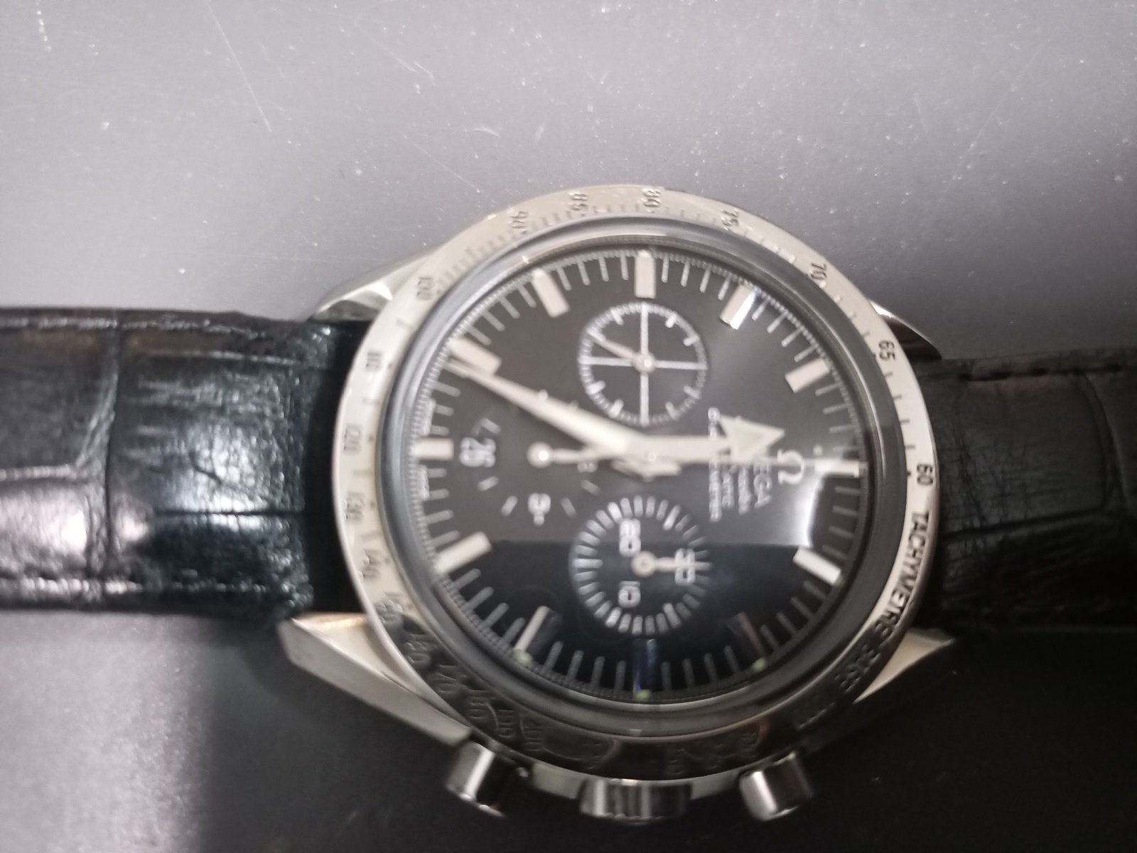

It's in french but I'm sure you see the errors : the correct ref is 38515011. I haven't the service history but with Watch Accuracy Meter I get an offset of -11 secs.

Ok so he was incorrect about the date but very vague in any case since the range is 2011-2023. Sounds like he just wasn’t sure. Nowhere does he mention the movement that I can see but in any case that model only came with the 3303. That said, if it’s not running well then you have a reason there to discuss a return of course but I’d suggest doing your research before buying next time.
You seem sure it’s not the 3551.50 he suggests. The 3851 and 3551 look pretty much the same so maybe he’s right?
