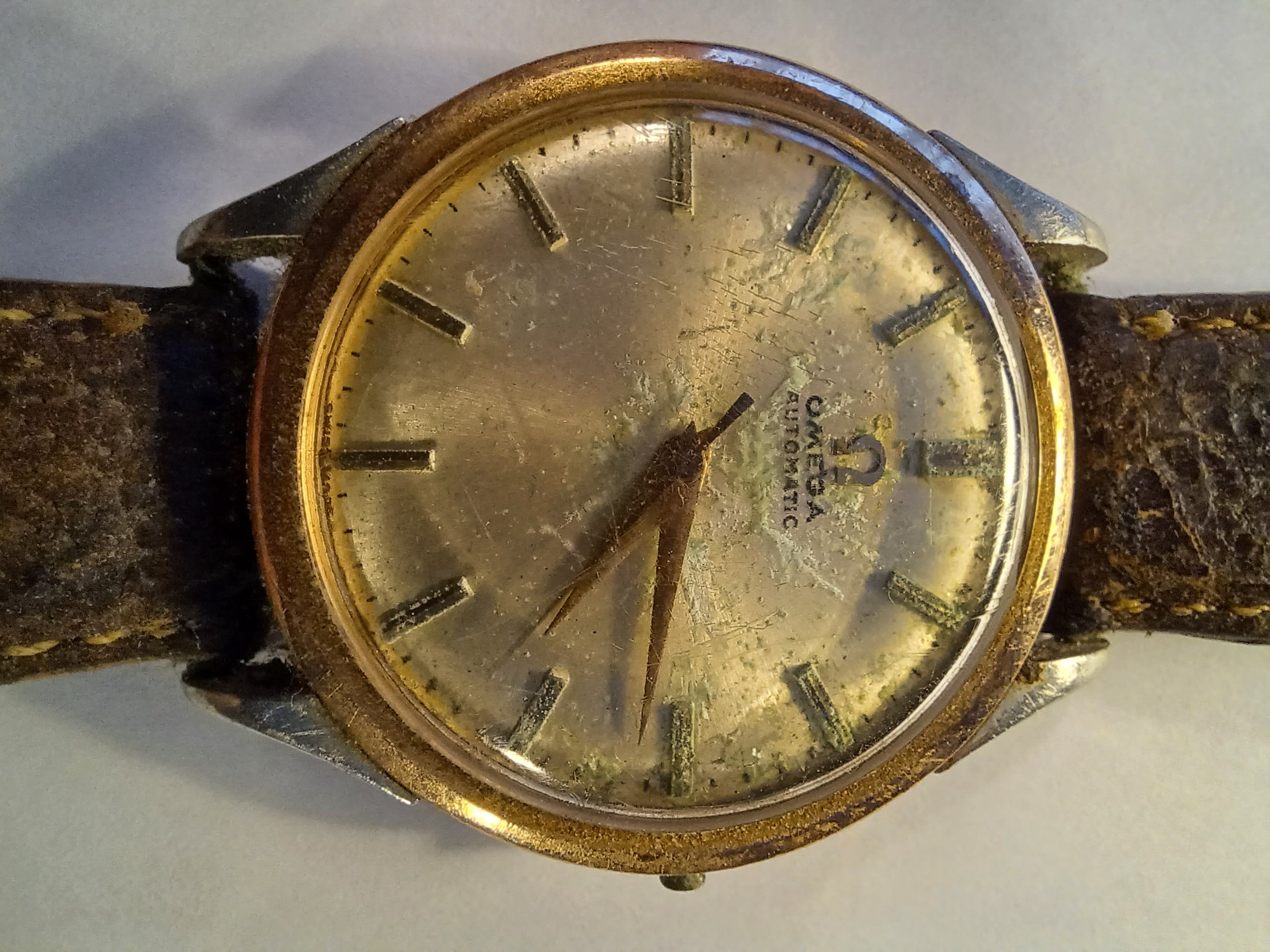

My uncle died in 1980, and I found his old 50s or 60s Omega watch only recently. Sadly, it is in a deplorable state. I gave it to the local jewellers to restore, but they decided as it is missing a stem and crown in addition to requiring a considerable amount of work, it would not be viable to spend time working on it.
This was very disappointing, as I had set my heart on being able to wear it.
The watch has perhaps only sentimental value, but that itself is reason enough I think to post this query here.
I will be retaking the watch from the jewellers tomorrow. In the meantime, I attach a photo or two that I took of it. I will add more of the inside when I can.

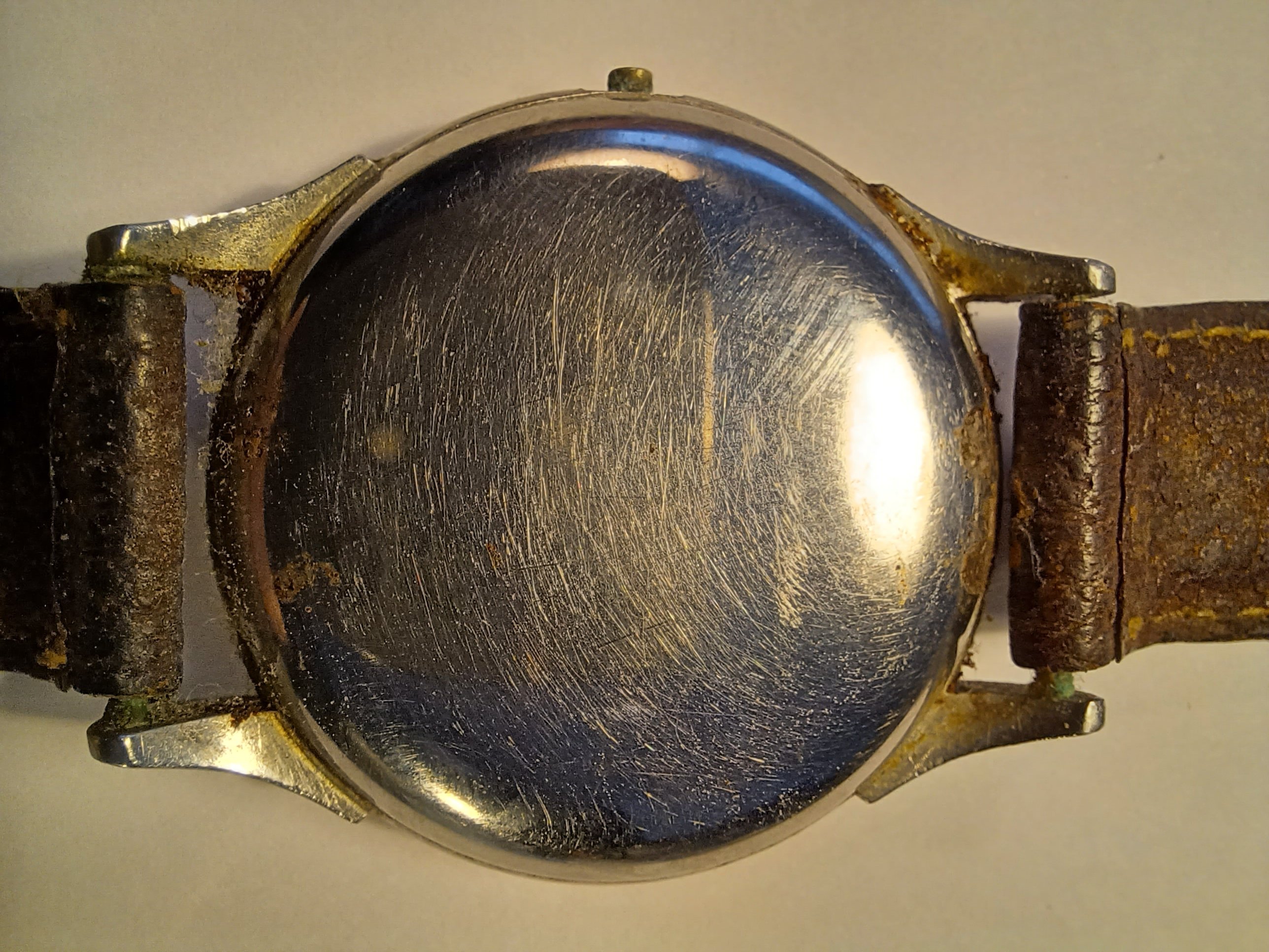

Having read some posts here it seems that the inside back cover will have idendentifying information as to the model which I hope will enable me to source a correct replacement crown and stem.
Any comments will be much appreciated.
Many thanks.
V.

Unfortunately, the watch has seen water ingress. Some of what you are seeing may be loose debris but some of it may be deposited on the dial. It's hard to tell until a watchmaker opens it up and does some careful work on the dial. The dial will never be great, but it might be acceptable if you're not picky. The elephant in the room is the state of the movement. How badly is it corroded?
4,507
11,075
Stem and crown are the least of your worries.
The jewelry store was correct, it's not worth fixing. You would be able to buy a similar / nice example for half the repair costs.
I'm guessing you have no intention of selling it so it's sentimental.
The movement could be really bad. Next step is to have someone open it up and get an estimate. Snaps some pics of it and post here.

The jewellers had opened the watch while I was there, prior to their later assessment. On initial inspection, as far as I can recall, the movement seemed to be fine. Apparently, the water ingress did not appear to be extensive, or to have adversely affected the mechanism.

My opinion,
Case looks like it covered in wrist cheese. Remove the strap and go over the case with a toothbrush and nothing else (no soap etc.)
If the bristles are soft. Trim them down so they're a bit stiffer to remove the heavier areas.
Bezel looks gold filed, but buy a jewelers rouge cloth and go over the case.
Dial is shot. Best suggestion is to get it refinished and if you find a place. Ask if they can polish the indexes
New crystal (or polish), replace the hands (not original). New stem and crown (new crowns gold plated as apposed to older gold filled/capped)
All in all. Could be looking at about $400 on or about
Take picture of movement and get case reference number on inside caseback
