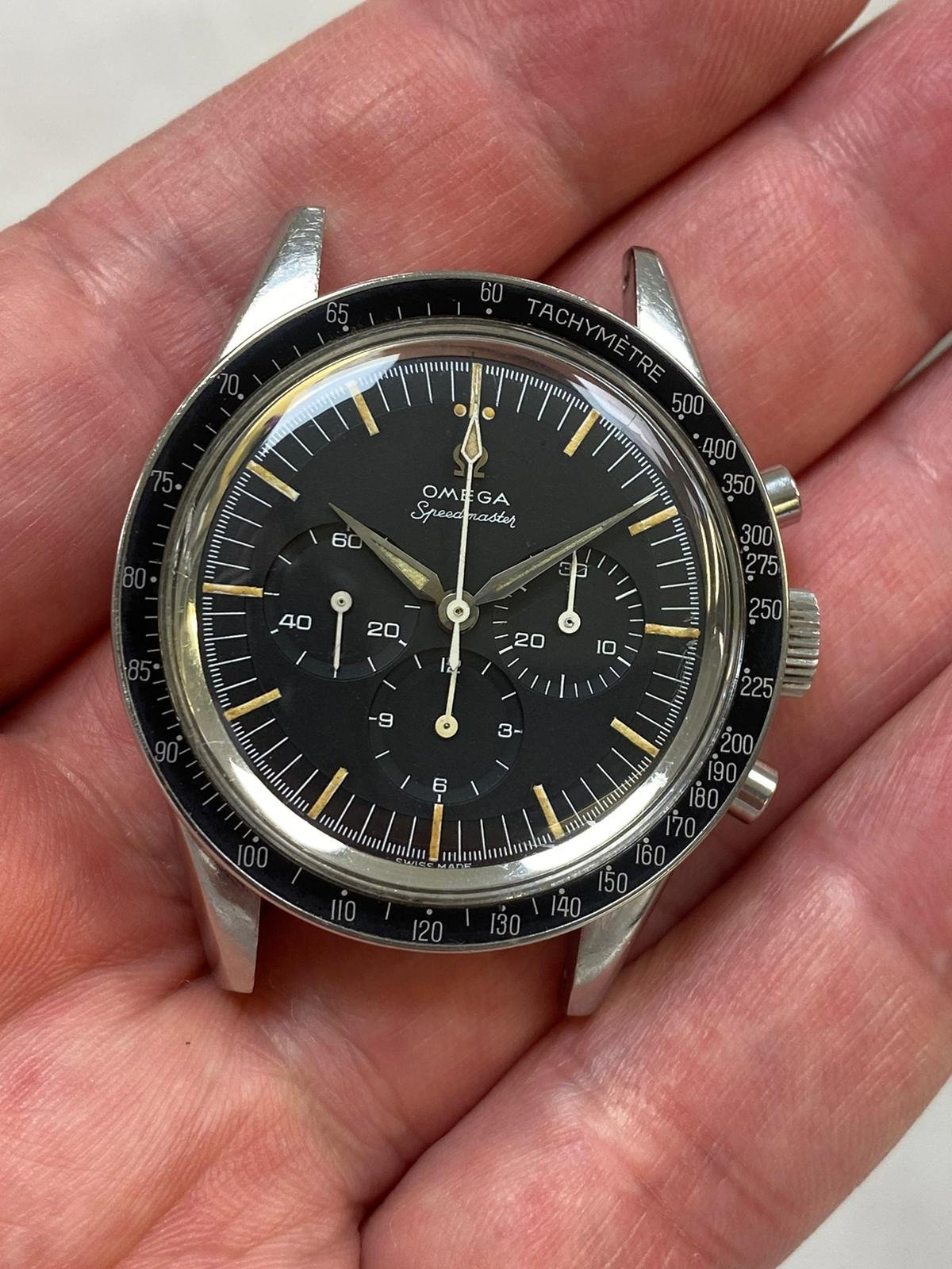

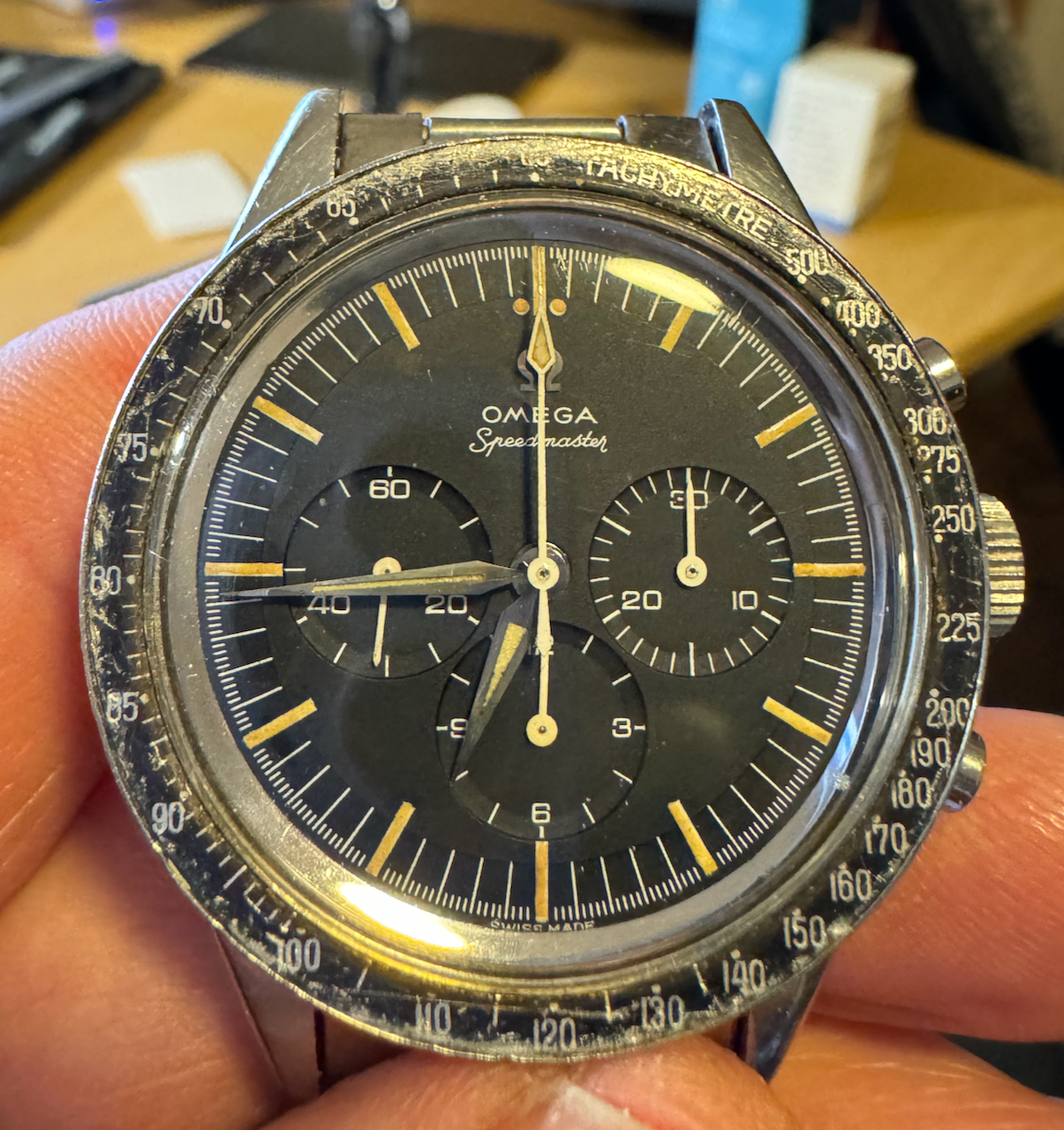

Thought I had a decent knowledge of vintage Speedys, from what I have read all DON bezel has a height of 1.85 mm. I have bought this 2998-5
Yes, you might have seen it before here att OF 😉 Anyway, I do not find the original bezel attractive so I have sourced a better one that comes from a 105.012 or 145.012. I did not think it would be any issues at all replacing the original one with the new one... They both have the same inner and outer diameter, give or take 2/100 of a millimeter, but the height of the old insert is 1.85 mm and the height of the new one is 2.1 mm. According to my watchmaker that is not uncommon so what he suggests is to lathe it down to 1.85 mm.

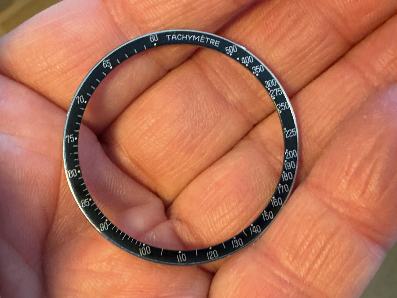

Can we see some photos of the replacement bezel that is 2.1mm thick? Which part of the bezel has this extra thickness? Which side will he turn down?
332
1,943
Here is a picture of the bezel that I took when I received it. The bezel and the watch is with the watchmaker so I cannot take a photo of it from the side showing its height. Well, I do not know for sure which side of that will be turned down, I have to ask him but I sure hope it is the side facing down towards the case.
@mac_omega, I should have taken a closer look at the picture, now I clearly see what you mean and I understand the construction of the bezel.
332
1,943
Got an answer from the watchmaker, it is as I thought, the bottom of the bezel will be adjusted

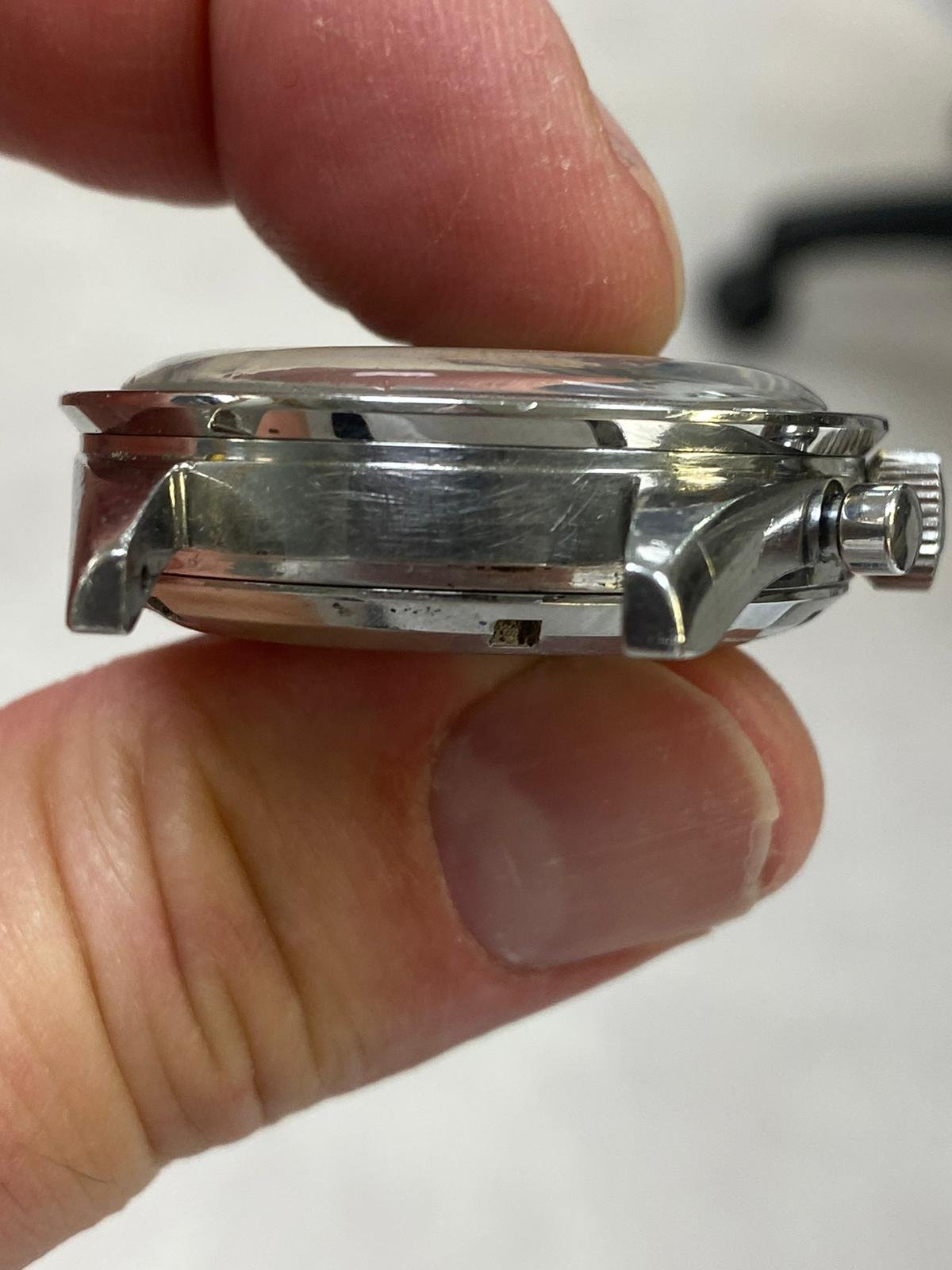

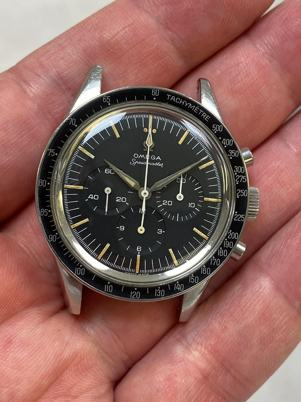

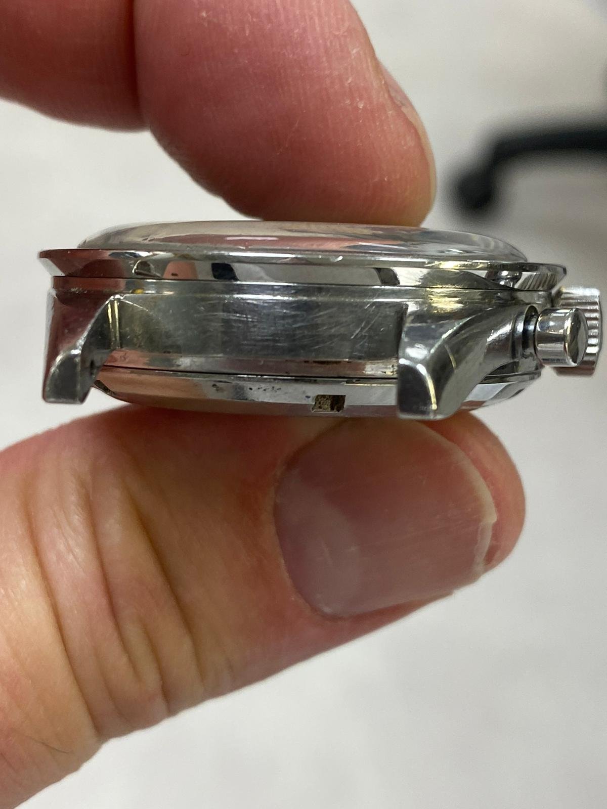

Got two pictures from the watchmaker today that made me very happy 😀
The watch is still with the watchmaker, I have asked him to service it for me
144
153
Very nice DON bezel and the watch that goes with it isn’t too shabby either 😉 Looks great - enjoy it!
