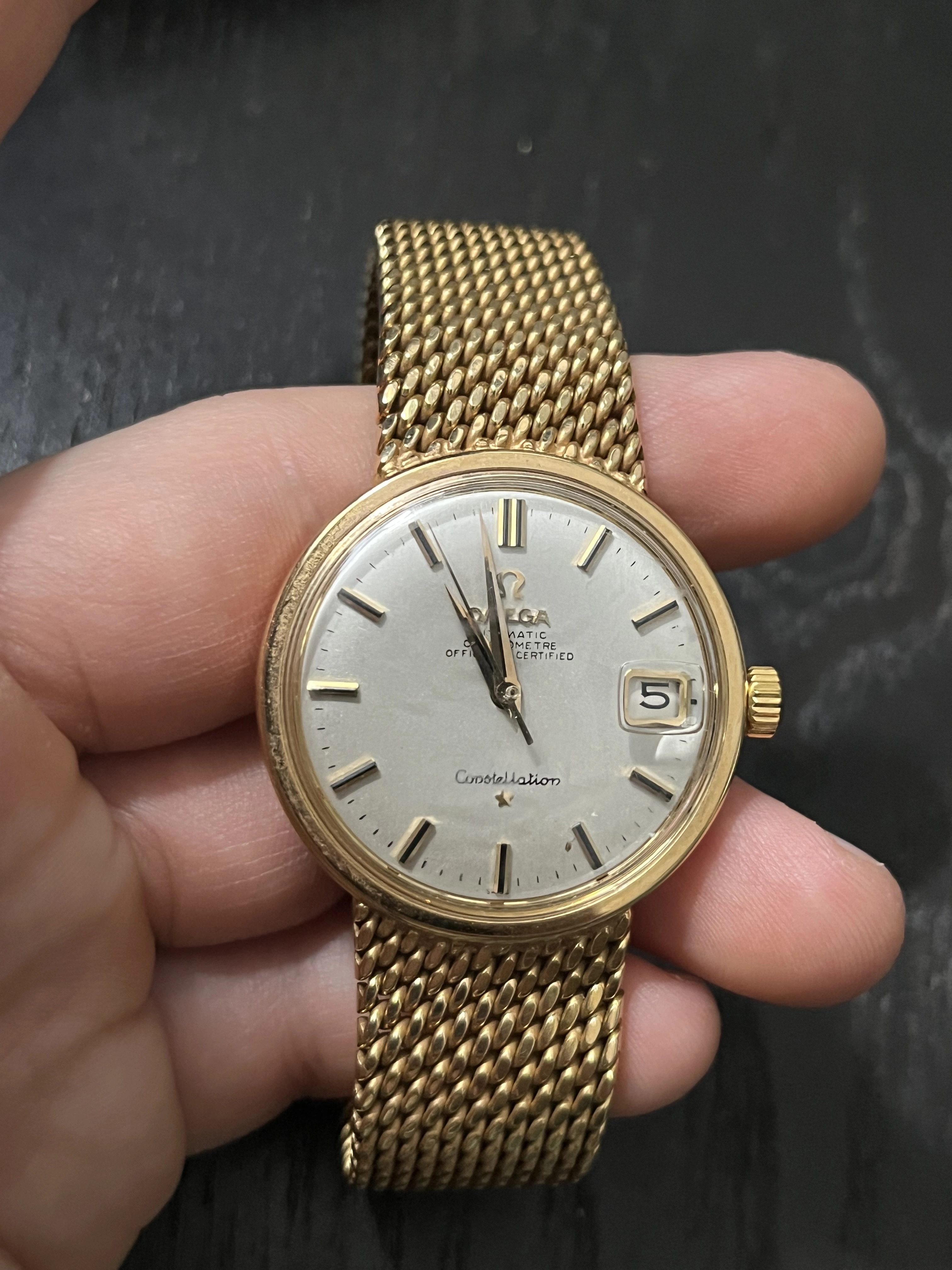

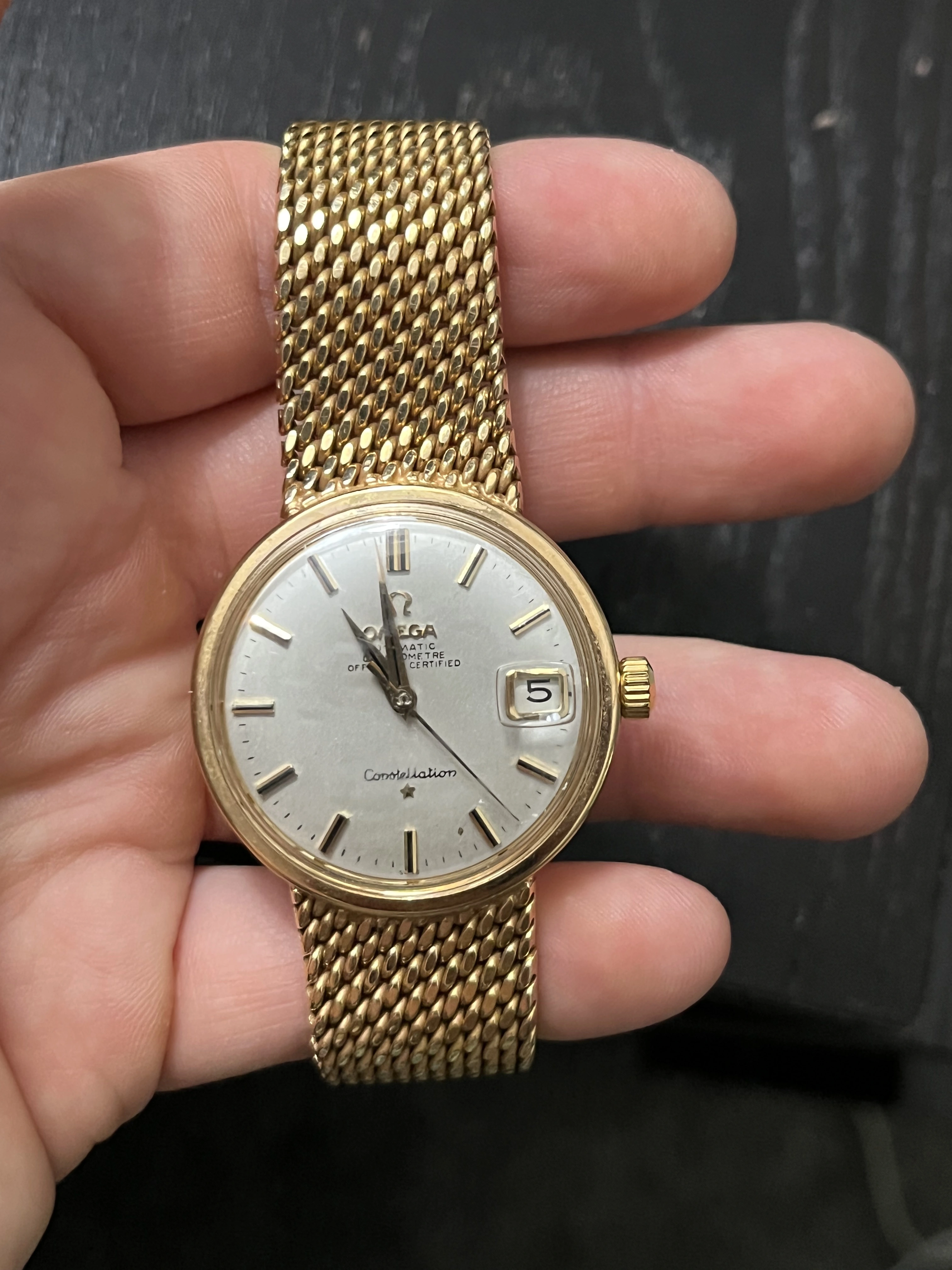

Hi everyone. Thank you in advance for the help. Can anyone assist with identifying this watch? The bracelet is integrated.

Is it the jpeg artifacts, or does that look like a painted dial? The text just doesn't look right to me.
Otherwise, looks a lot like this one: https://omegaforums.net/threads/constellation-with-integrated-bracelet.49068/
I share your concern about the text, as well as inconsistency of minute markers particularly between 5 and 7. Depending on cal and SN and reference the older "chronometre" spelling may be incorrect. I think the minute markers should extend to match outer edge of hour markers. But I reserve further judgement until we see photos without hands blocking text.

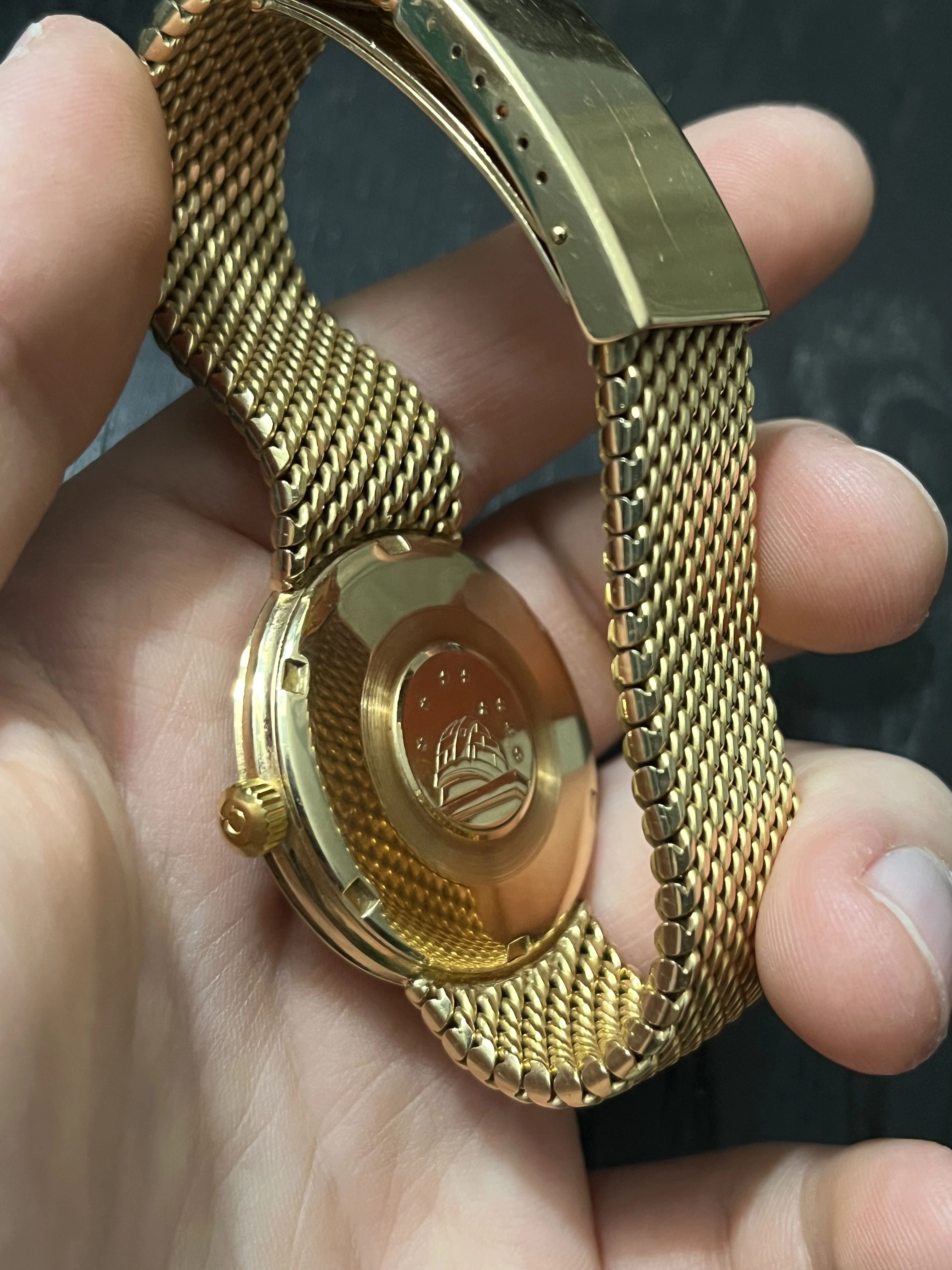

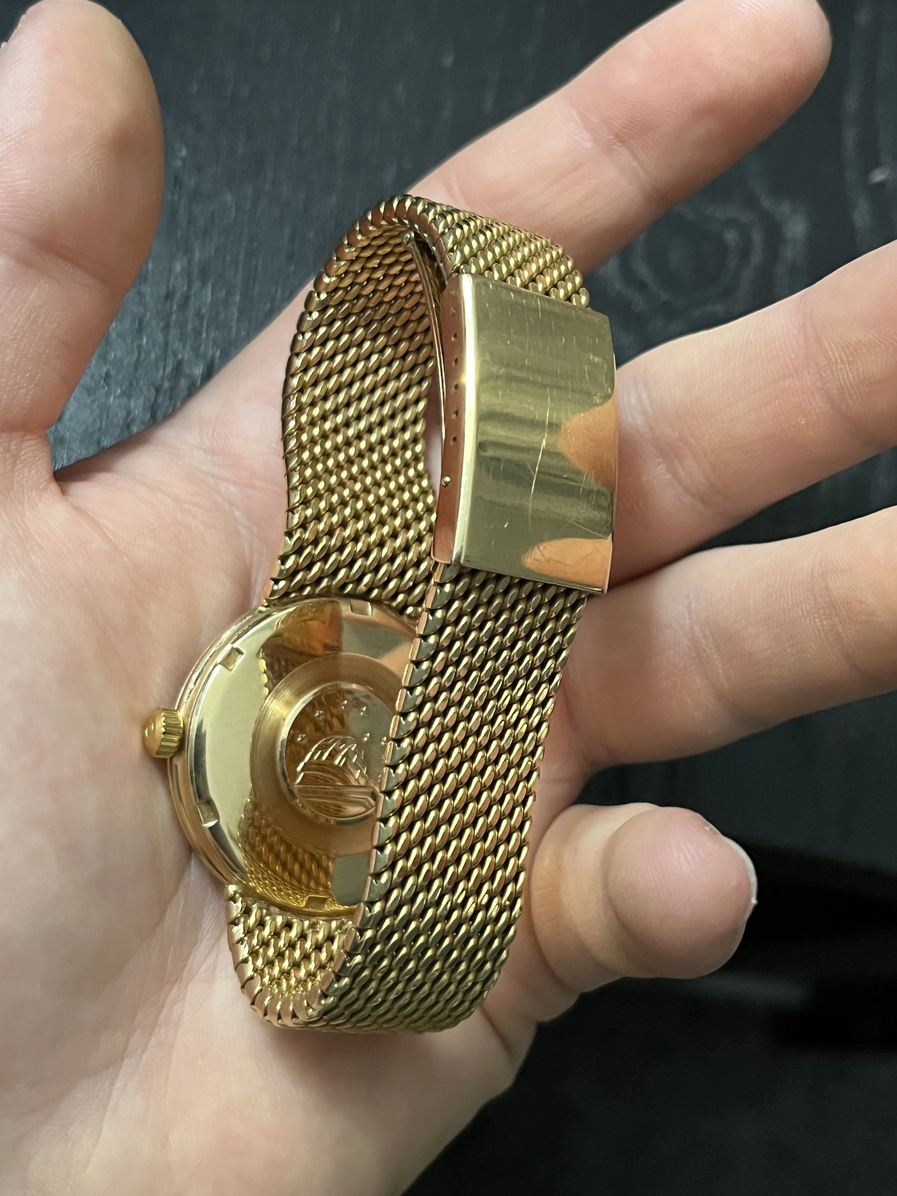

There is no doubt that the watch dial has been repainted I’m afraid but this was a common procedure if there was water damage or moisture ingress to the dial.
I have some concerns about the watch in general.
The medallion doesn't look quite right, especially the observatory.
The bracelet clasp is not of the quality expected. (it would normally be solid gold and have the Omega symbol and the gold level hallmarks)
There doesn't appear to be a cut out for the crown in the mid case (the current crown is a replacement)
However, this could be a locally cased watch, which might explain the medallion and the midcase and the clasp could have been replaced at some point.
As above, the best way to get to know more about your watch is to have someone competent open the caseback and take good clear photos of the inner case back and movement.
If you can show us those then we can give you better info about your watch.

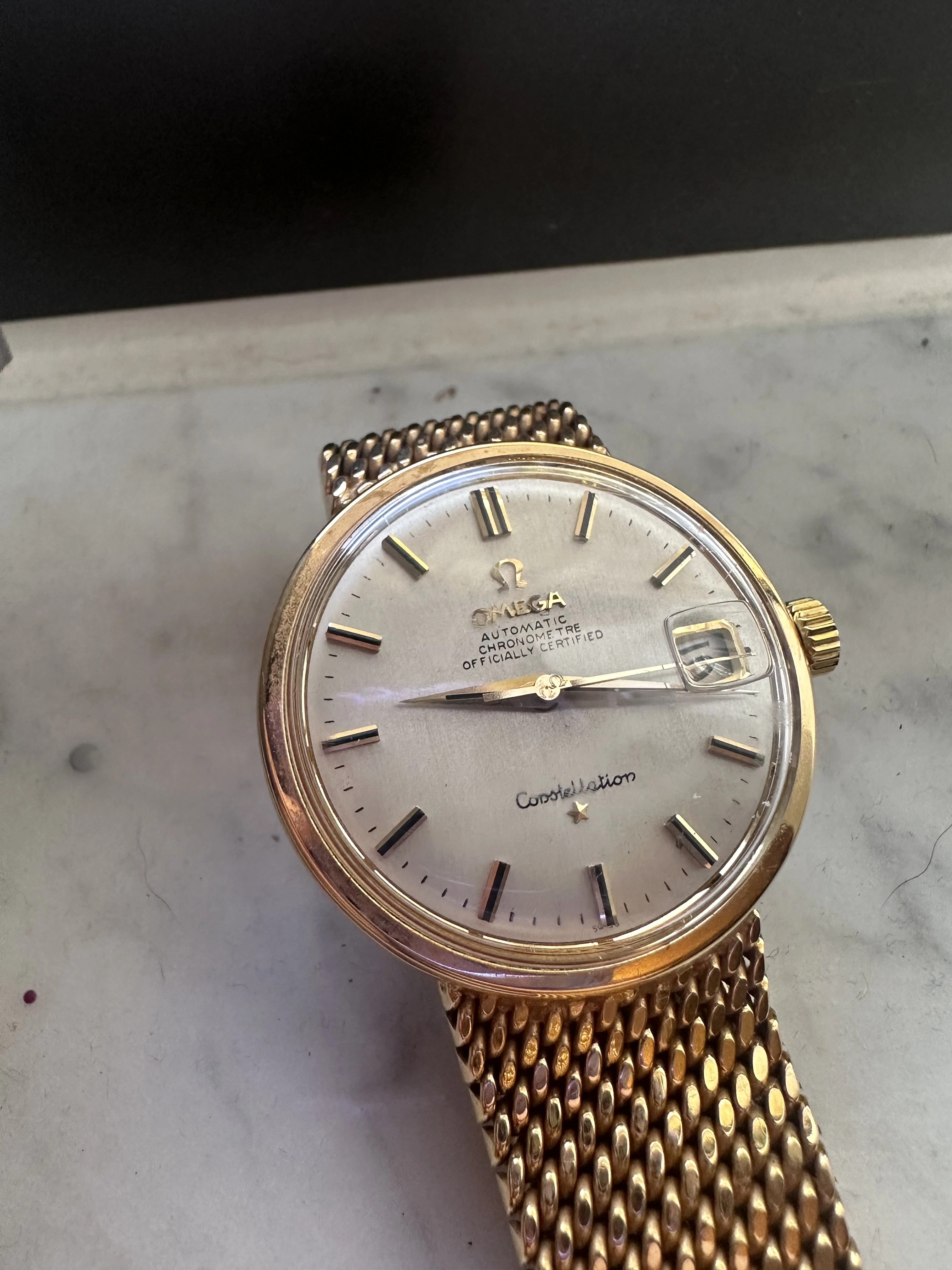

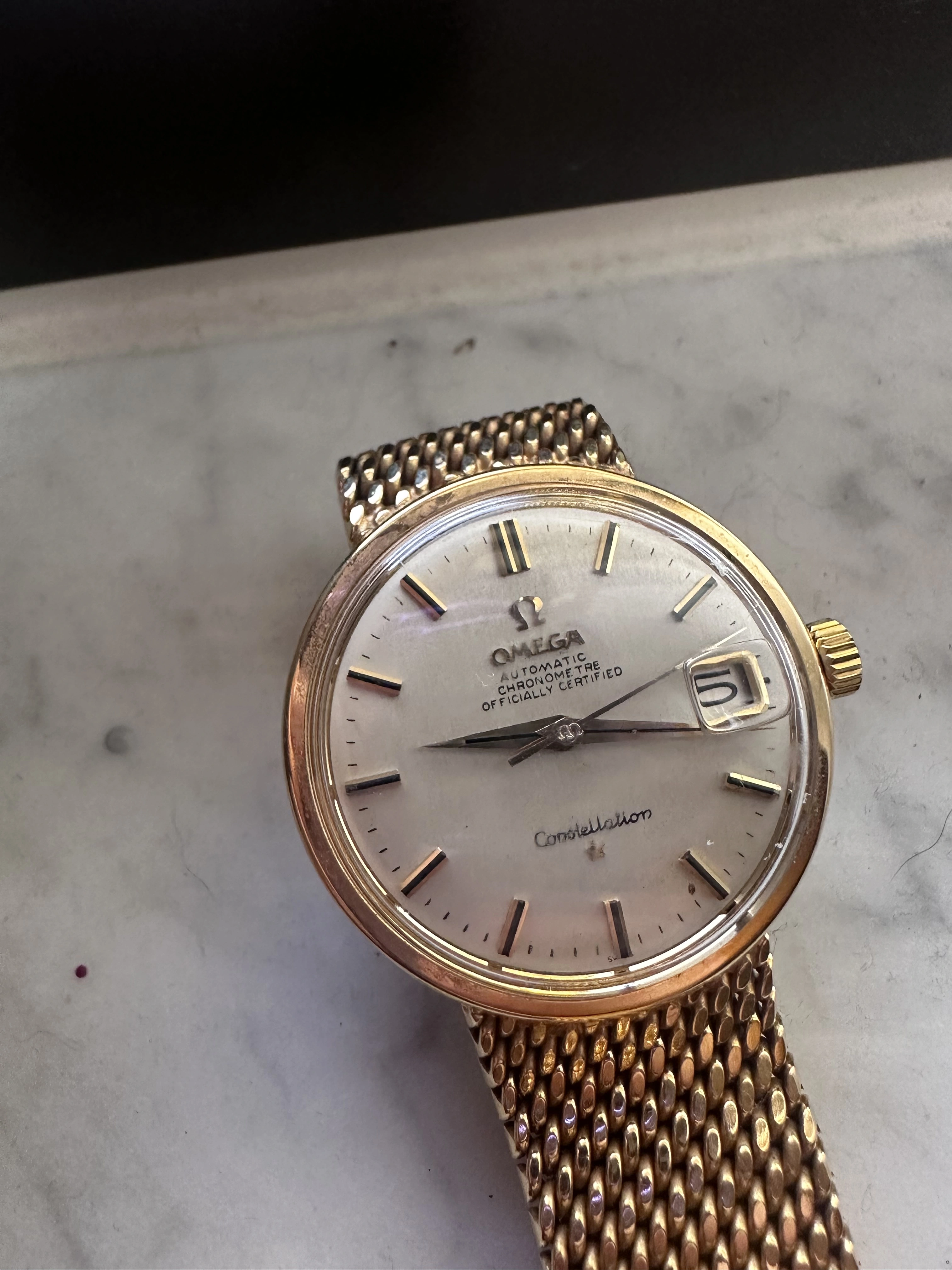

Hi all. Happy New Years. Thank you all for the response. Here are some better photos. I will do my best of getting someone to remove the back. I’m not too familiar with watches and definitely will contact an expert.

Hello! Yes, I own the watch. Just trying to get an accurate value of the watch. After doing some research, I believe the watch is not original. From my understanding, integrated bracelets were not produced directly from Omega (for this model). Let me know if I’m wrong.
Thank you for the response. Yeah, one of the first things I’ve noticed was that the clasp was not original.
3,686
8,015
As per @Peemacgee suggestion have it opened by watchmaker which will reveal ref number and case maker info and gold hallmark inside Caseback, and Omega SN and movement cal.
Gold watches were often cased locally to avoid import tax on gold. Post photos when available
