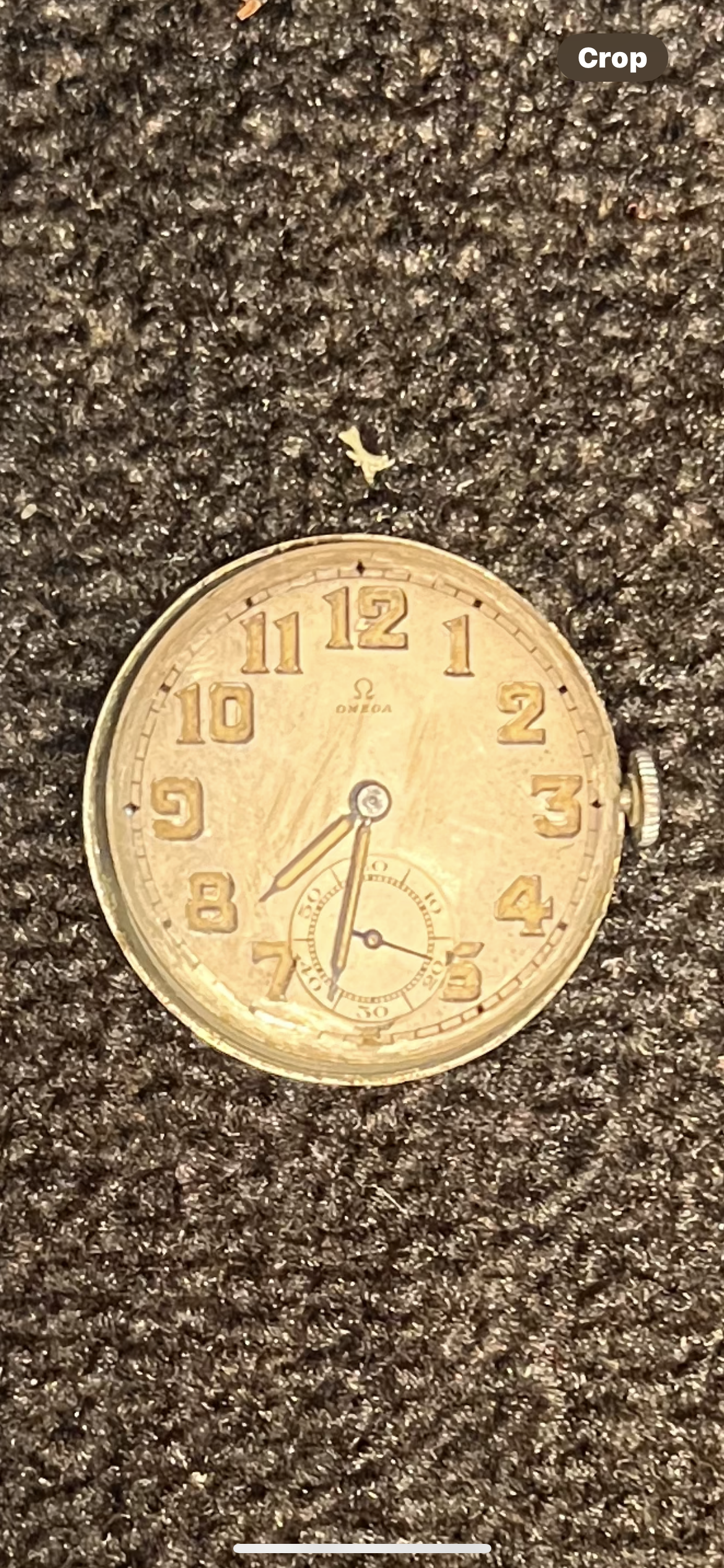

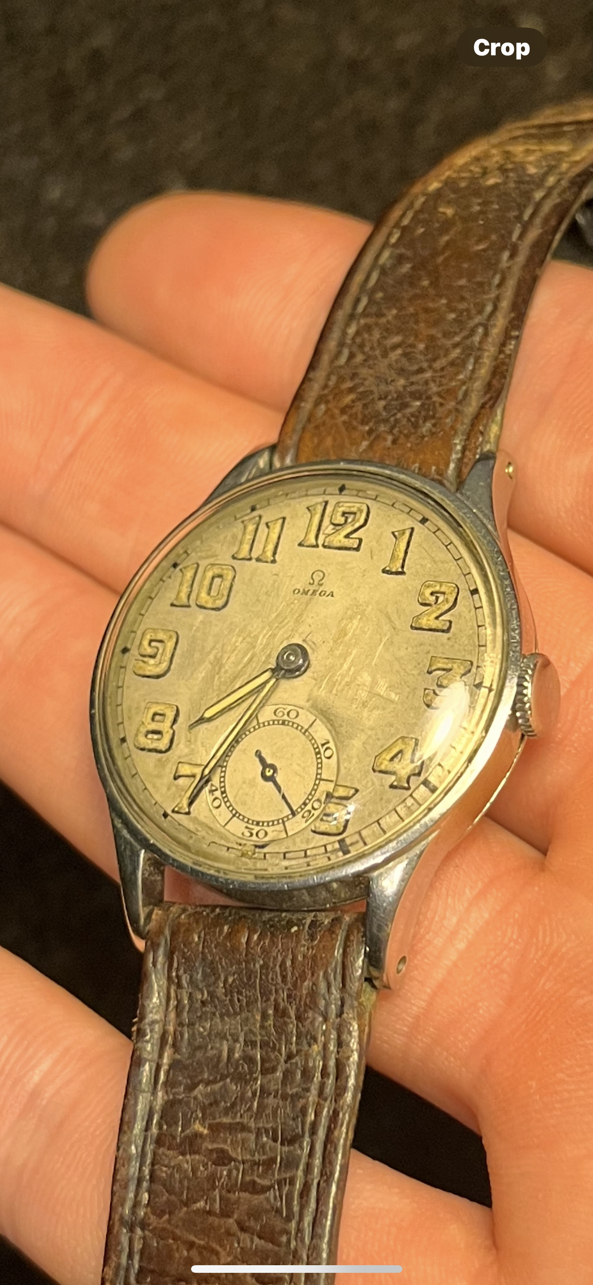

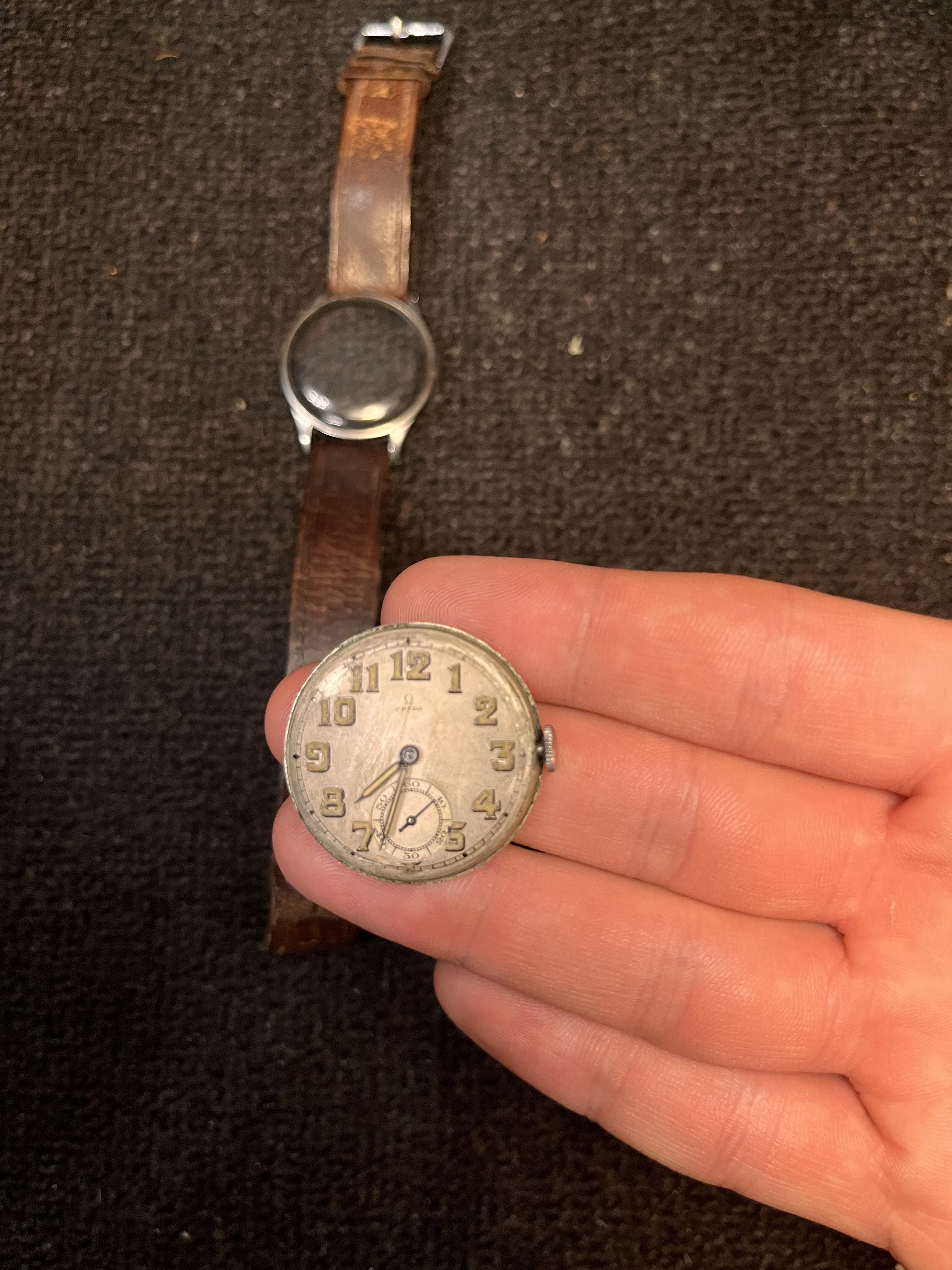

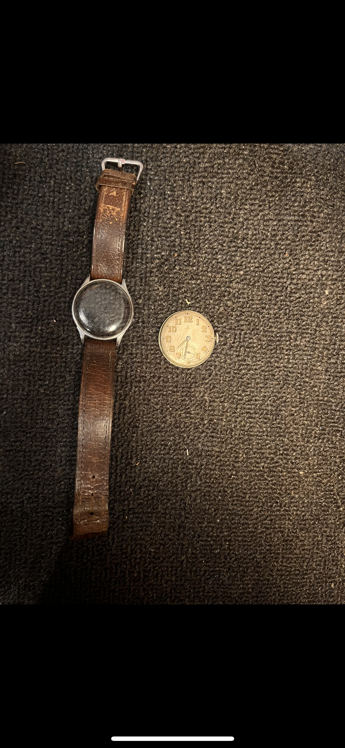

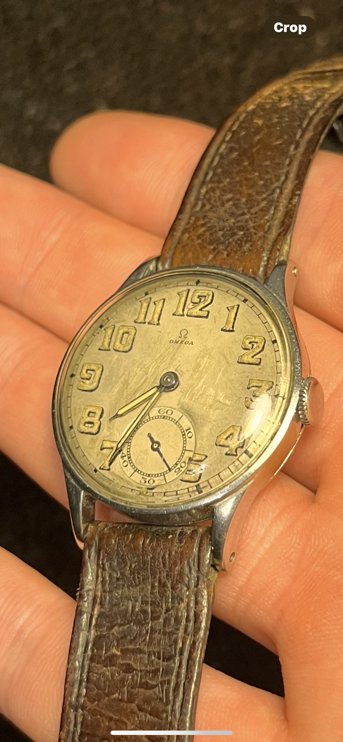

Can anyone help identify this watch
Me and my mum are currently looking through old family stuff and came across this, can anyone help identify what model the watch is??

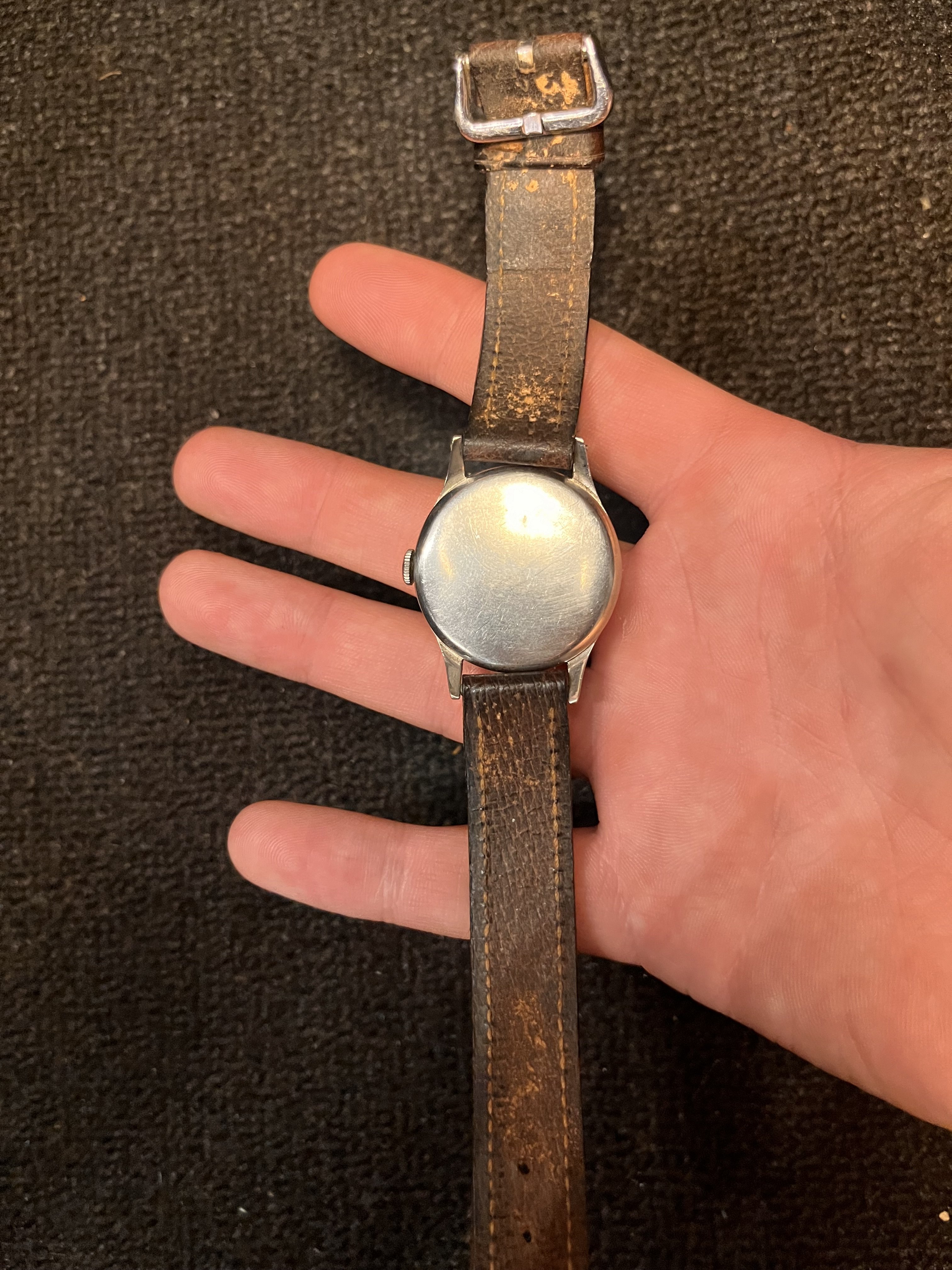

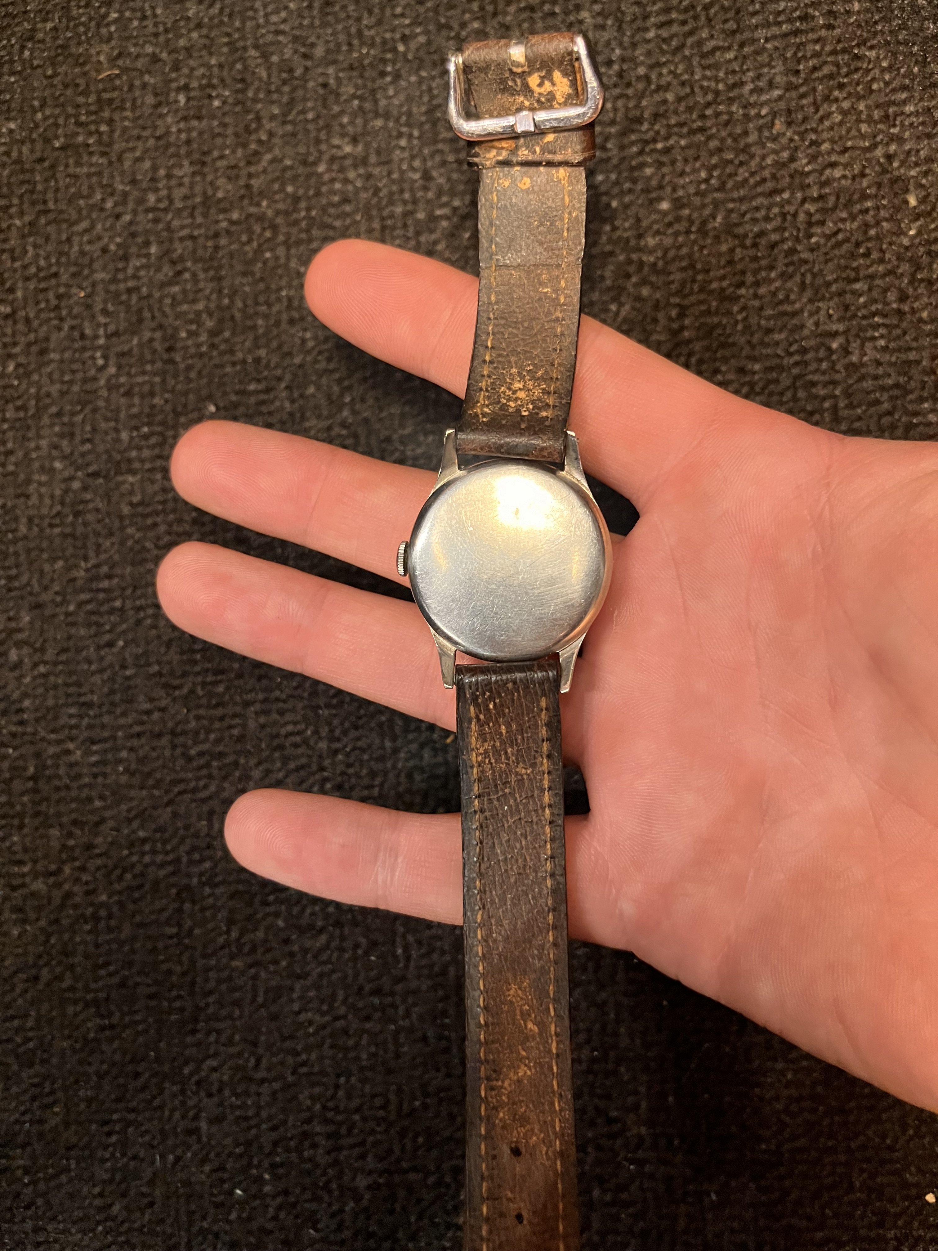

Not all models have names. This style of case. Movement sits in a cup in the case back
depending on size. Maybe a 23.x or 26.5 caliber. You would need to remove the movement from the back and check under the balance wheel by the edge. If you’re not sure. Find a watch maker to do it and take some pictures

that lume is likely to be radium, probably best to avoid having any contact with it. Put it in a an appropriate container and let a professional sort it out for you, if that's what you decide to do.
