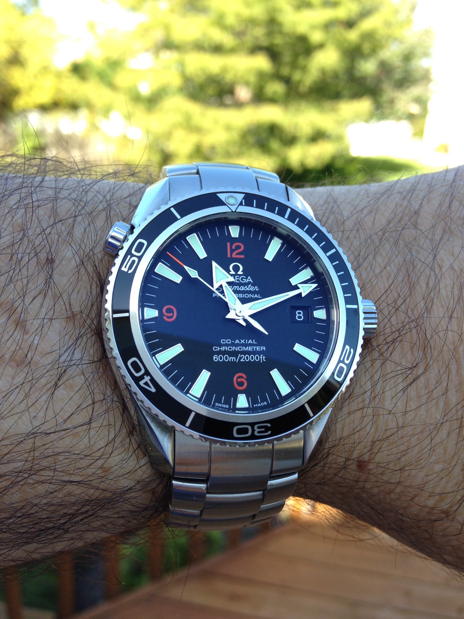

Brand new Planet Ocean XL! 2500D baby! My first NEW Omega.

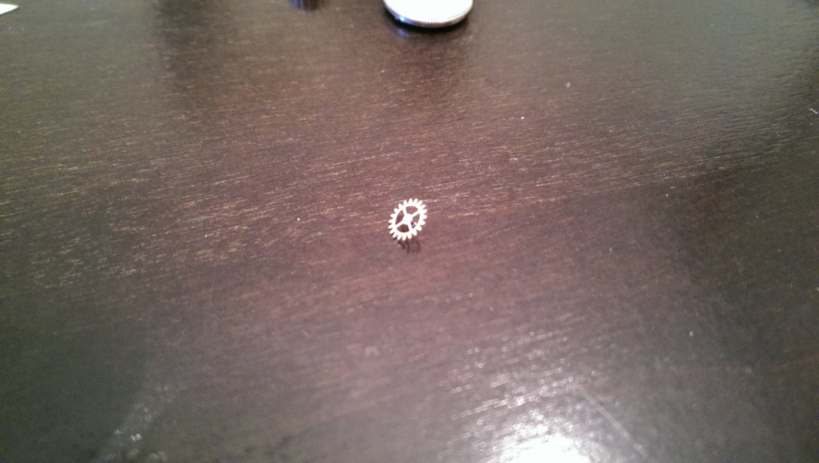

tiny escape wheel is hard to capture with a phone camera, so in the absence of a macro lens, here's the best shots I could get :
Do the teeth look like the style in the shot I attached in person?

The teeth don''t strike me as being more rounded on one side than the other at first sight. Hard to tell without a magnifying glass. I'll keep you posted.. In the meantime here's another picture taken with another camera.
Well the rounded teeth look more subtle without magnification. So this wheel you show has 20 teeth on the wheel, which matches what a 2500C intermediate escape wheel has. I know because all 20 of those teeth have to be oiled individually, as well as 10 teeth on the co-axial wheel, all done under a microscope at 50X magnification...
I can't post an image out of the tech guide here (don't want more letters from the Omega legal department thanks) but I did pull that image up and counted the number of teeth on the wheel - there are 55 teeth. There's just no way that's a D intermediate escape wheel...
Again I can only conclude this is a 2500C, no matter what they told you.
