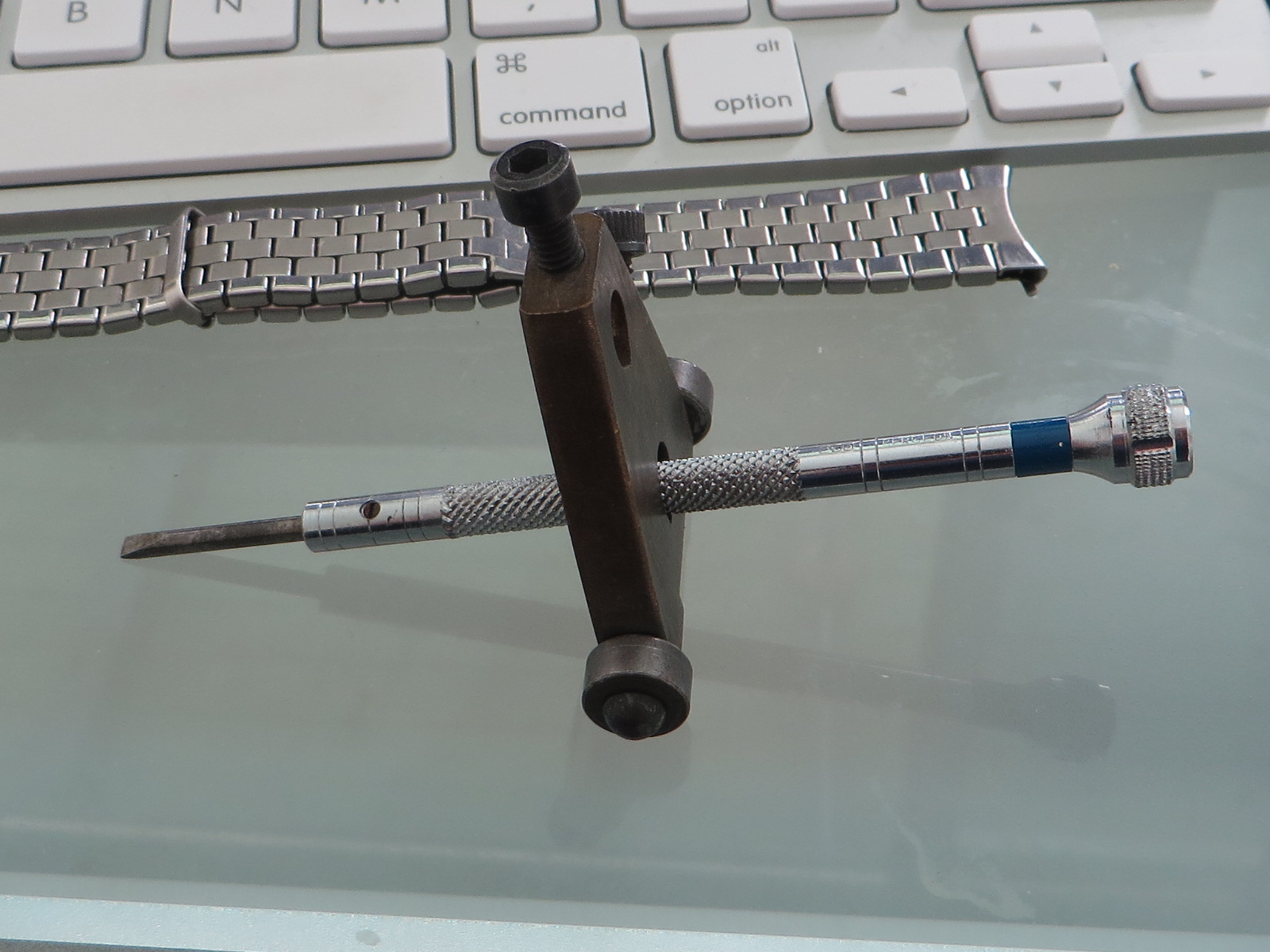

I recently bought a VOH screwdriver (30.00769, 1.80 mm) in order to replace the ratchet wheel screw on a Longines caliber 12.68N. The 1.80 mm dimension of the blade seems to be the right size for the screw, but the blade is too thick to fit inside the slot. This mistake, on my part, has led to a few questions.
1. Based on the information above, is the screwdriver that I bought designed for wristwatch movements?
2. For a given blade width (e.g. 1.80 mm), are there many different blade thicknesses available?
3. How would I go about selecting the correct screwdriver or blade?
4. Is reducing the thickness of the blade on my screwdriver a viable and advisable option?
Thanks in advance for any assistance.

From my limited knowledge blade thickness corresponds roughly to blade width.
There a variety of devices specifically made to hold a screwdriver to sharpen them.

I sort of assumed that the thickness and width corresponded, so that if I chose the correct width, the thickness would not be a problem. I am open to sharpening the blade, though I wonder if purchasing a smaller screwdriver or blade would make more sense. I suppose that could depend on the exact difference in thickness between the blade and the screw slot.

In my experience, it's pretty common to custom grind/sharpen the tip to get the desired thickness and shape ... maybe even expected. So an oversized tip would be a good thing. I wouldn't want to use a narrower blade, it's ideal to have the full width.

Blades do not come fitted to the wide array of slots that are out there on screw heads. The thickness of the slots these screws head are not standardized, so it's very common that you have to dress the blade of your screwdriver to make it fit properly.
You want the blade to almost, but not quite, touch the bottom of the slot in the screw head. If you let it touch, the possibility that the blade will cam out of the slot and cause damage will be greatly increased.

Thanks for the response. I knew that the full width was ideal, but I had no idea that it was common to custom grind.

Thanks for the response. Naively, I assumed that the thickness of the slots was essentially standardized.
I really appreciate the advice with regard to the ideal blade depth within the slot.

Oh if only, but that would make life too easy! Several watchmakers I know have a few sets of screwdrivers on their bench, each being dressed appropriately for different movements.

Yes - differences in brands, but also differences in eras - vintage watches tend to use thinner and deeper slots than many modern watches do.

Nope. This would seem to be something to create grip between the blade and the screw slot, but if the blade is properly dressed to fit the slot, it wouldn’t be needed.
