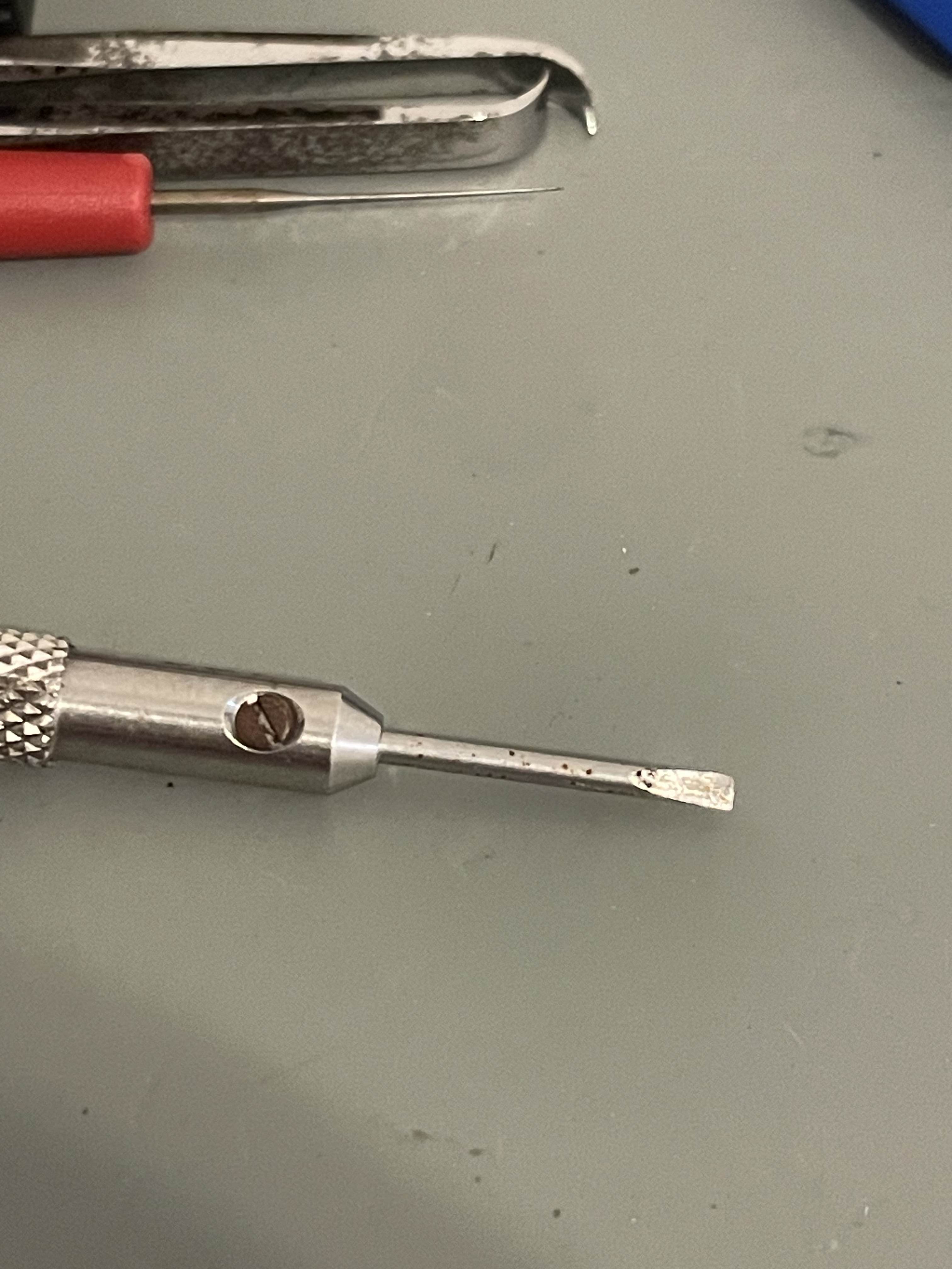

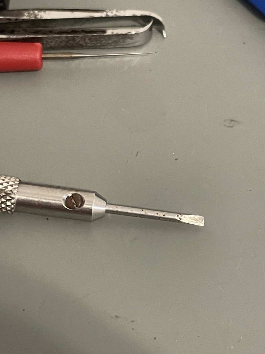

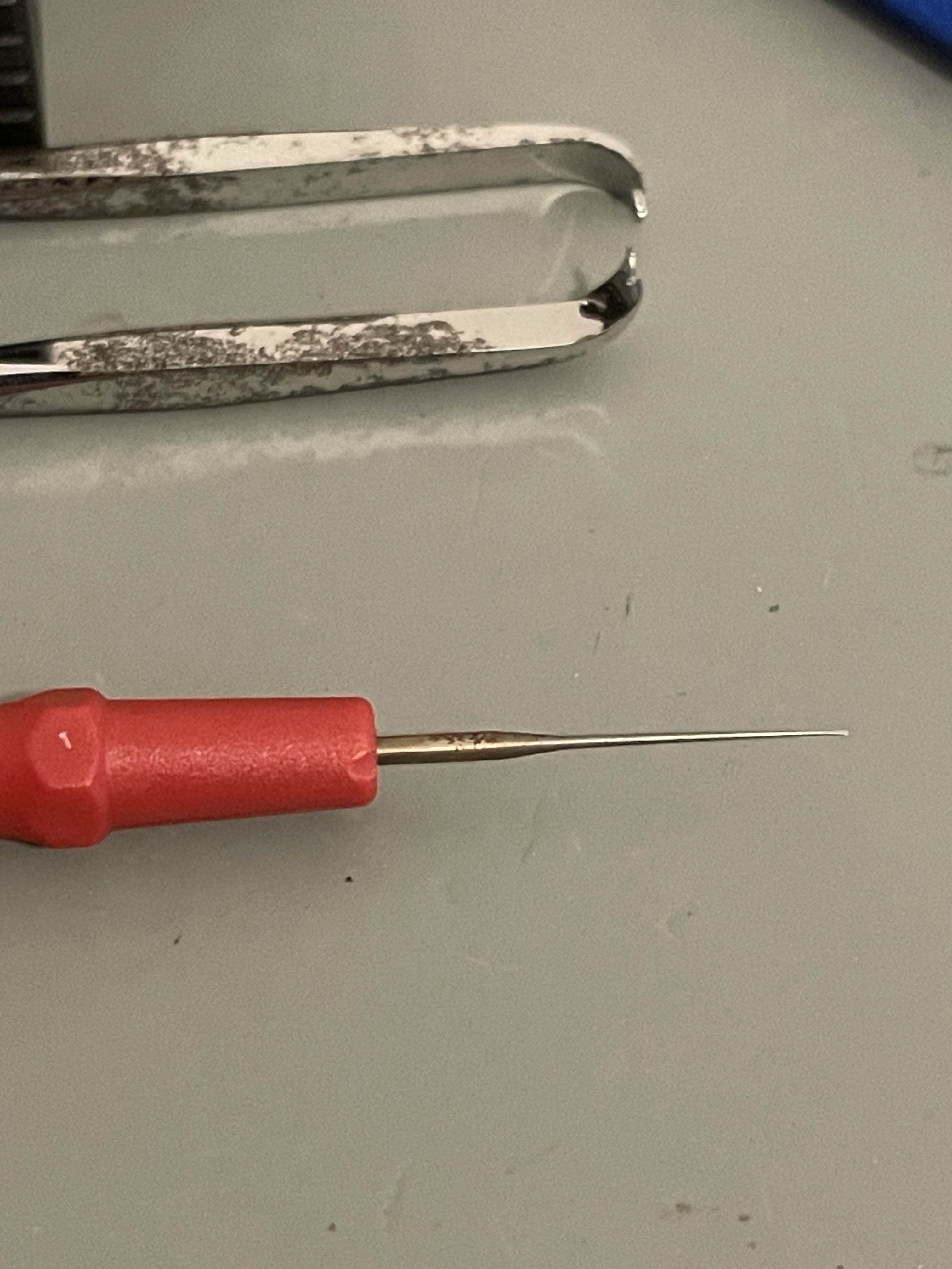

Hi , i the past few months i am learning watchmaking and on some tools i wend the extra mile and bought the more expensive bergeon tools .
i bought all of my tools online on cousins uk .
sadly i am extremely disappointed with the quality of the bergeon tools and i wanted to know if you had similar experience .
all of my bergeon tools are 1-2 months old and gaining rust , i have added some photos .

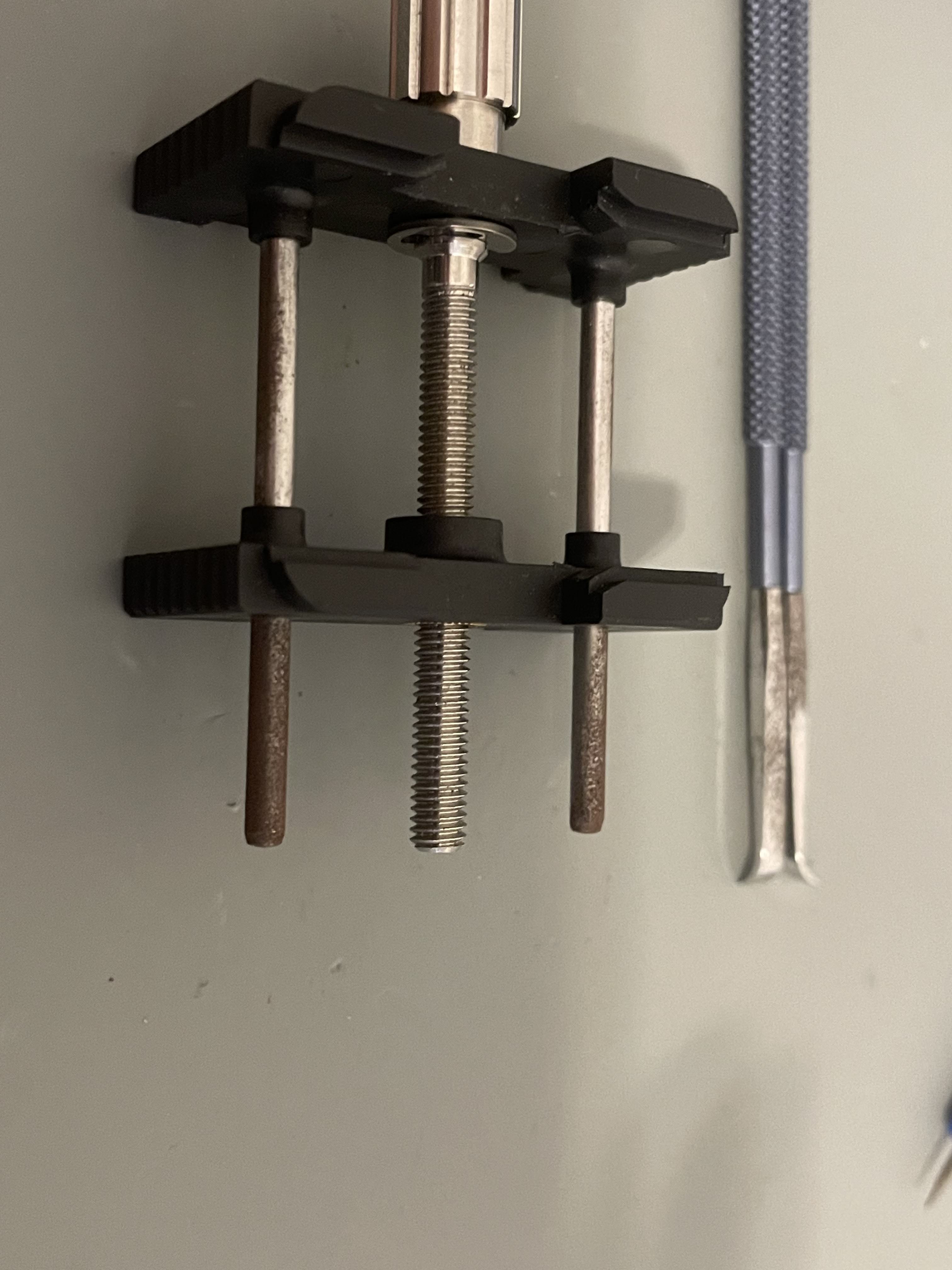

I did buff out the rust on the movement holder because after it gained a little it stopped opening and closing freely but a week later it is very rusty again .

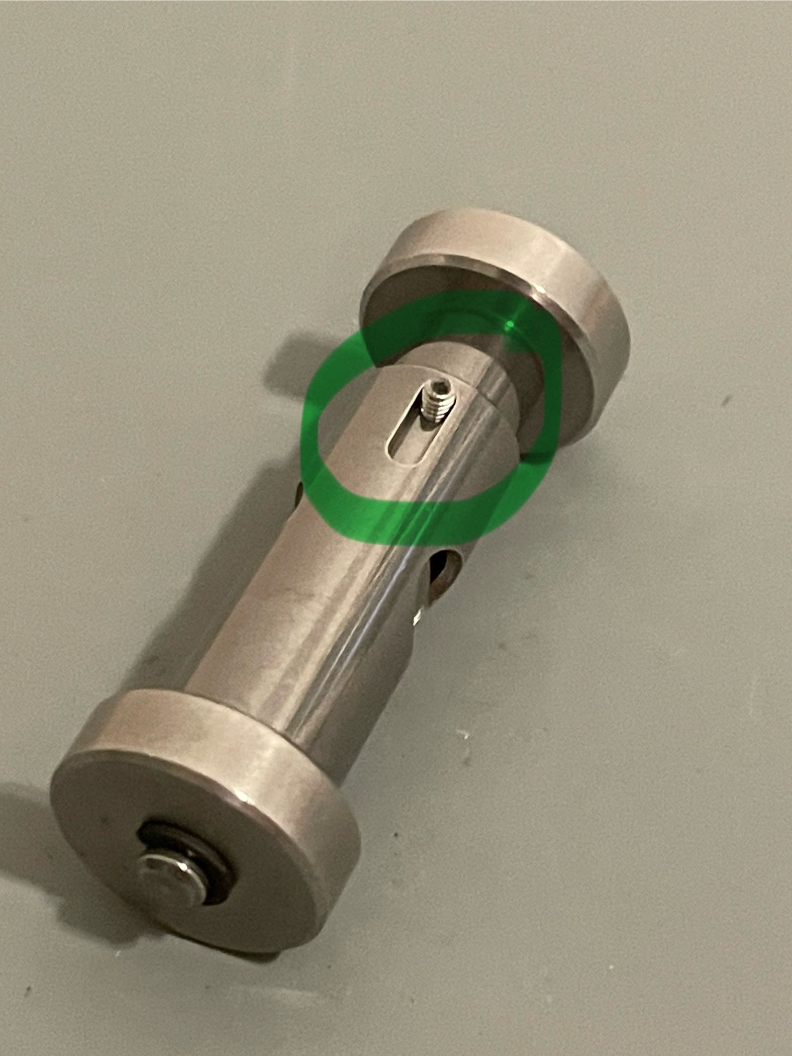

the screwdriver sharpener holder has a small screw that holds the pieces together and its very loose , if you want to use it facing down it is quickly grinding against the stone .

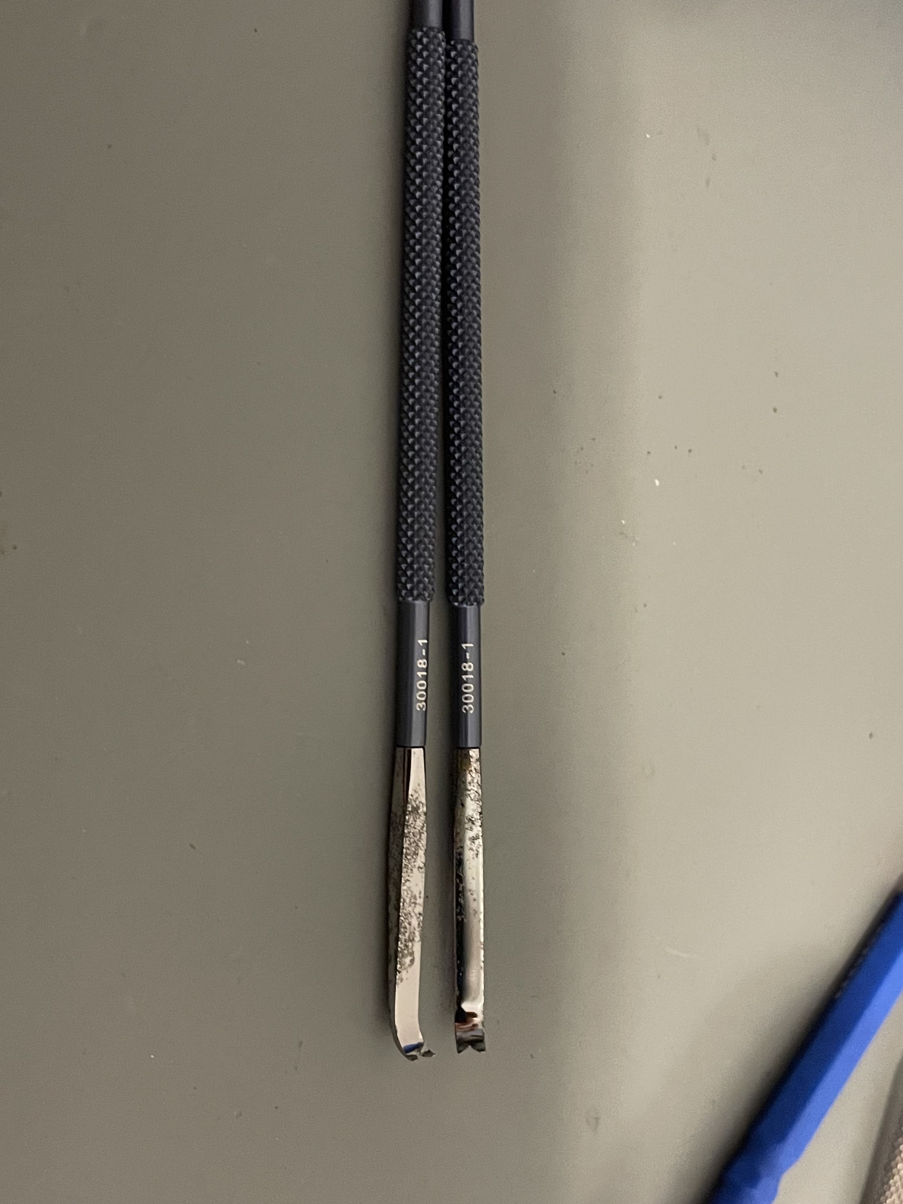

the hand removal tool was very expensive , somewhat around 150 dollars and it has gained rust quickly , i thought to myself that those kind of tools can last you a lifetime if you take good care of them but in my situation it looks like i have only a few months left and that is with a positive attitude .
I would like to hear your opinions on this matter ( i haven’t contacted cousins yet )

What are they made of? Carbon steel will rust pretty easily depending on environment. Stainless can corrode or oxidize if the wrong liquid or substance gets on it and in extreme conditions. Very small, microscopic pieces of embedded tool steel left over from manufacturing, finishing, honing, etc. of stainless tools and items can show corrosion. Passivation is a process often used to prevent this type of surface defect.

Carbon steel rusts. Store your tools in a container with some silica gel things is my advice.
