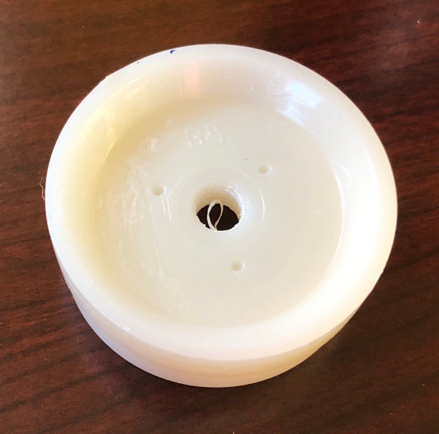

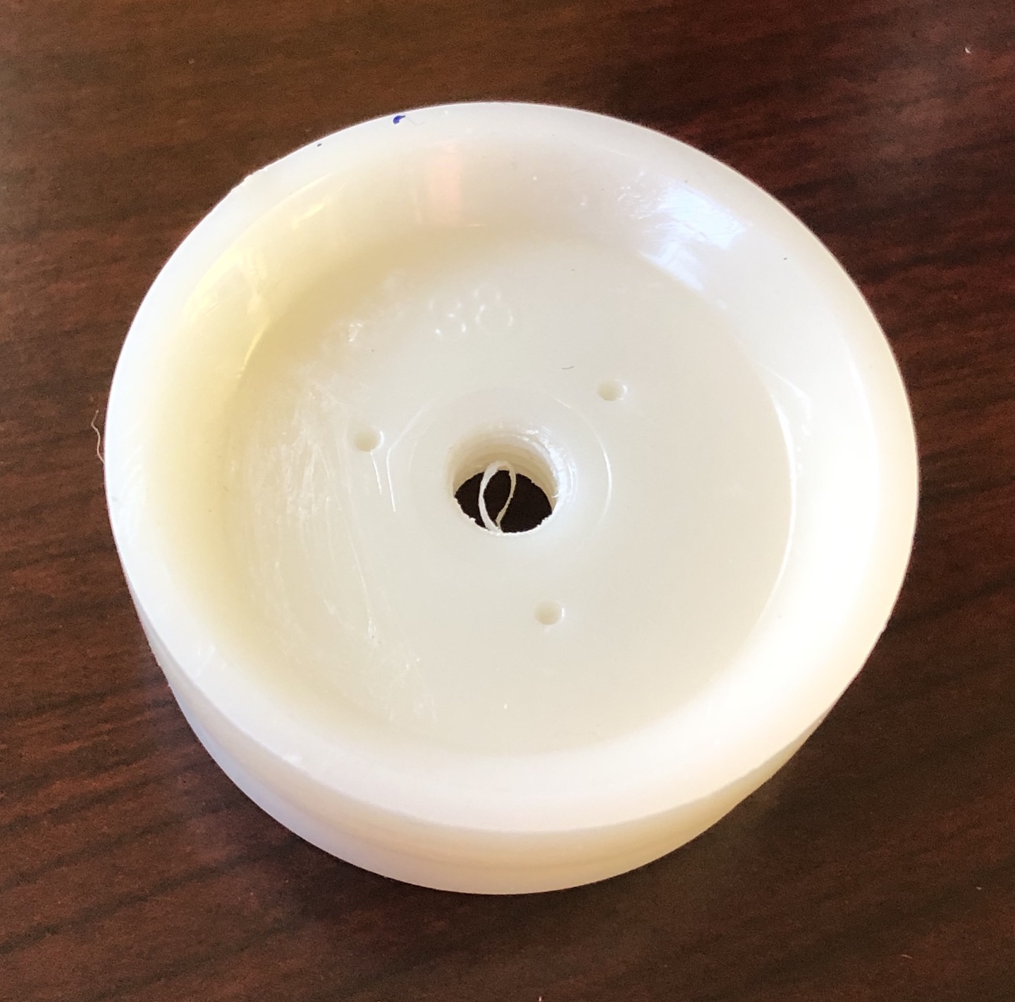

Perhaps partially answering my question #1 above, it just hit me that I might be able to use one of these bezel press dies to rest the watch on instead of resting on the crystal. That way the pressure would be on the bezel. Of course, it will only work if I have just the right size.
