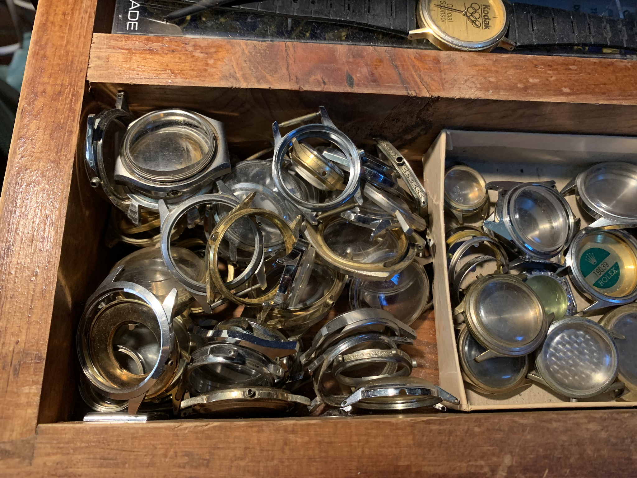

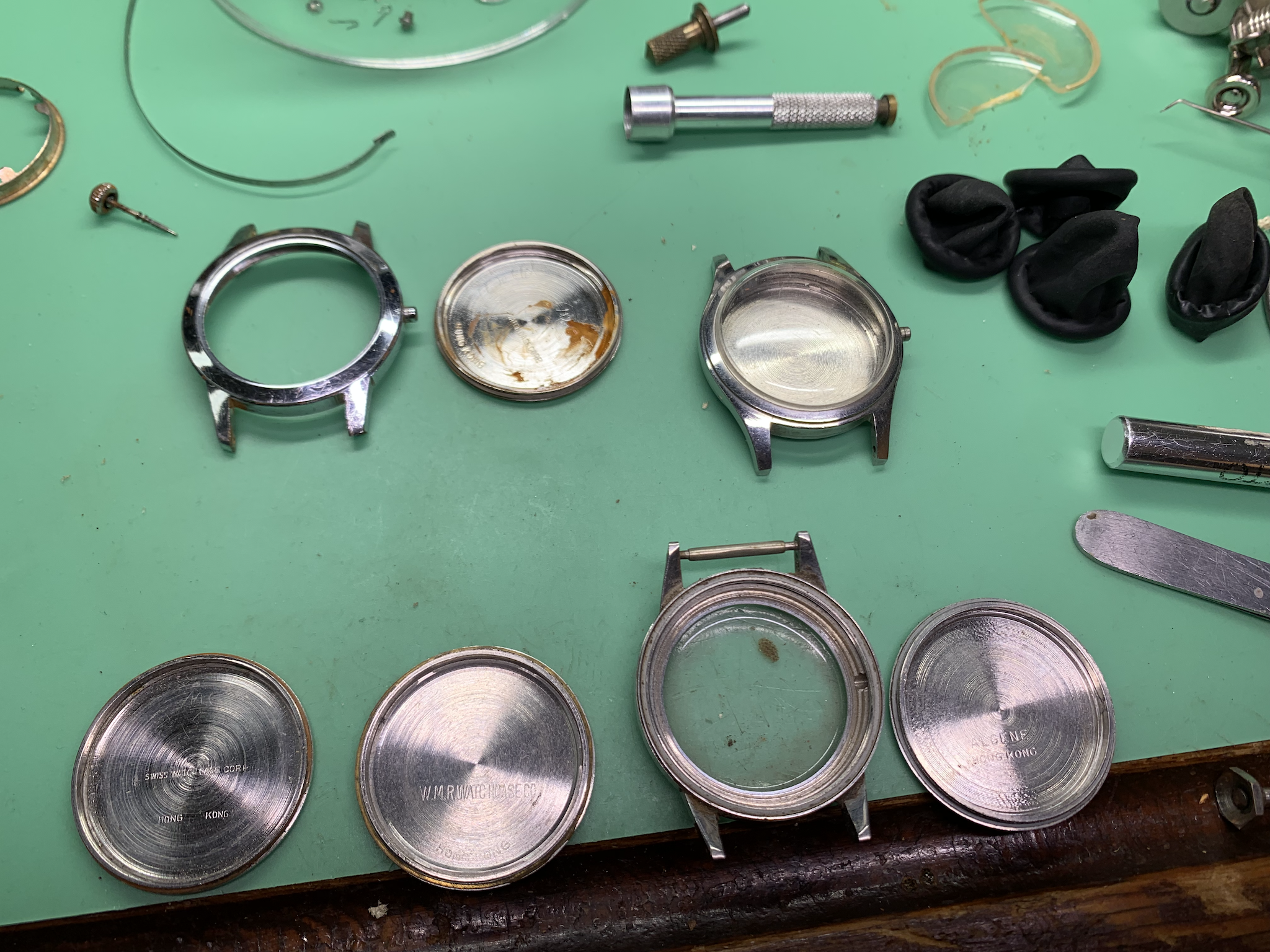

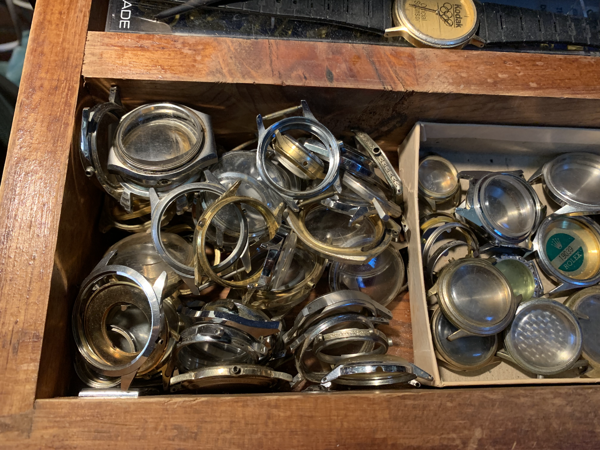

I have a few case parts. Not as many as some here. I have had these for decades. Somehow all the backs got mixed up. One of the curious is that there were a bunch of backs engraved Hong Kong.
Where I could fit a back to a case I did. The first photograph in this thread show some possible candidates for similar watches. The A Schild movements are a fairly common 11.5L which is around 25.6MM which is really close to a 25.4 inch. 12L being the 'French inch.'
There are a lot of movements that will fit into these cases. Every now and then I find something that matches. I think these are pretty much how I got them. Probably from NAWCC Mart auctions where no one bit, or I had to take the lot to get the part needed. I have picked through this fairly often in the last 6 months.
The first photo I was going to use in the other thread. I figured it deserved a thread of it's own. As it shows some of the similar case backs to El Rusto. Of course there is not an identical case, and I have the best of the scrap cases set aside for the Santa Claus Walkmann.

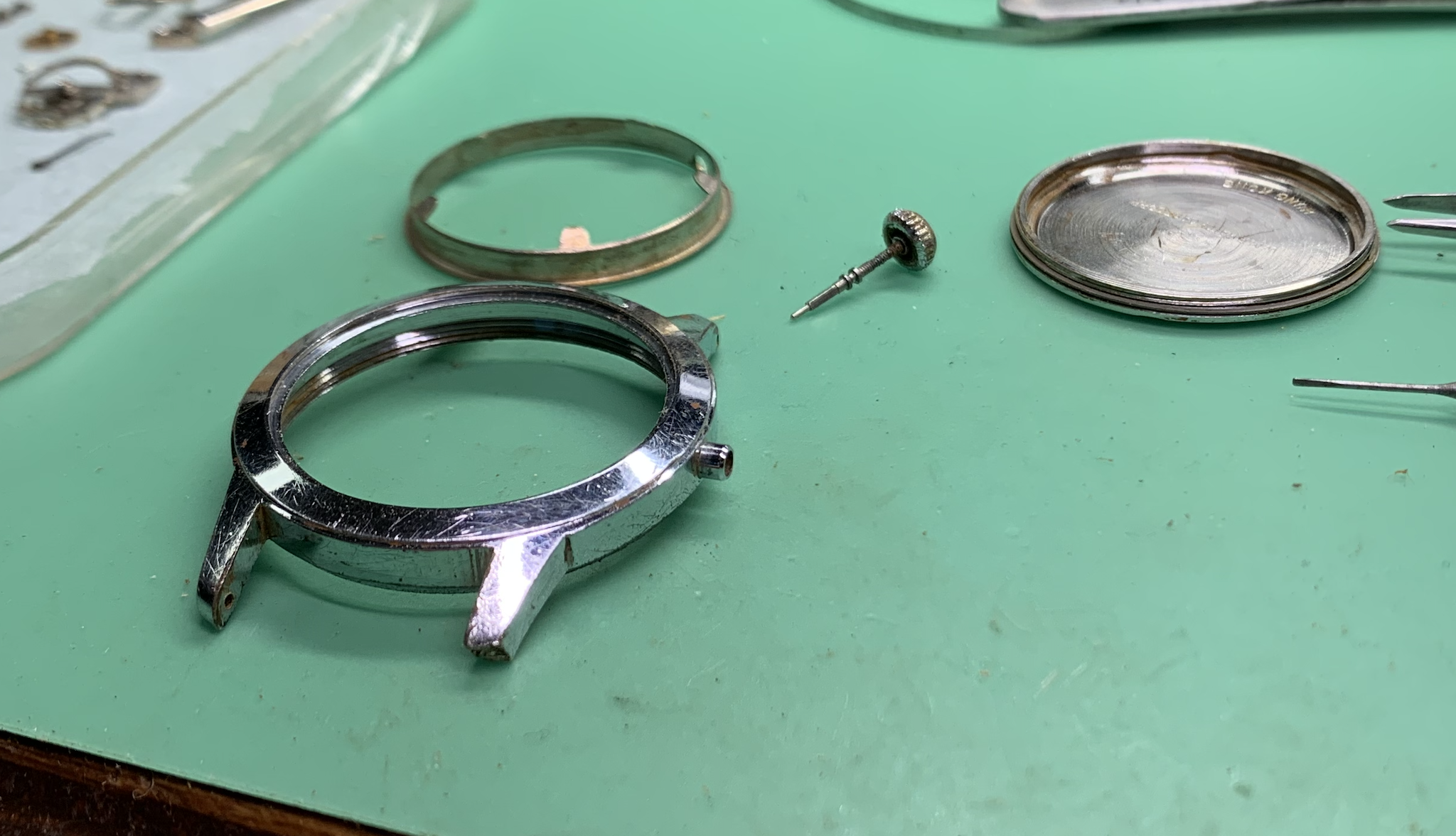

I should start re-assembling El rusto. (to keep parts from getting lost.) I did get as far as getting the mainspring winder out. Then started removing more of the rust from the case parts.
Here is the result (above.) The case really cleaned up nice. Too bad I missed the missing lug tip. Does seem to be made from some sort of white metal, so I probably could grind it down. The case might have been a bit over polished. The only tools I used to clean this was a basswood stick (softer than pegwood.) and a fiber brush to clean the snapped of lug and the stem threads. The stem and the movement ring were soaked for a couple of hours in the Evap-O-Rust. The case was not.
I am curious as to why the prevalence of HK cases. The Wakmann is going into a French signed case
(which is the one it fit best.) From the style of these cases I would date them to the late 1950s through the mid 1960s.
This watch (El Rusto) was serviced at least twice. There are also some large dents and scratches on the case back. These look much newer than the broken lug which was covered in so much rust as to not be immediately noticeable.
