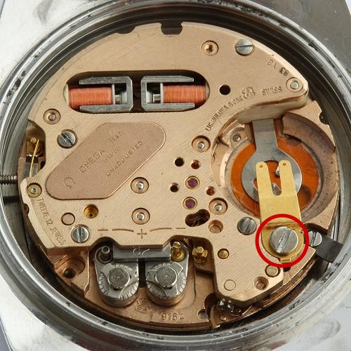

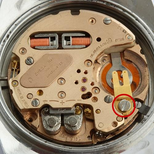

Thank you for all of this excellent information @Archer! I have no desires to dabble in watchmaking, but do need to swap a battery on an F300 now and then. I am guilty of using an improperly sized screwdriver on the screw marked in the photo below (not my photo). Thankfully, I have avoided damaging the screw significantly so far, but would like to have the correct tool. What is the proper size of screw driver for this?
30,325
78,262
I don't work on these, so I have no idea what the screw head diameter is, but you should be able to measure it.
