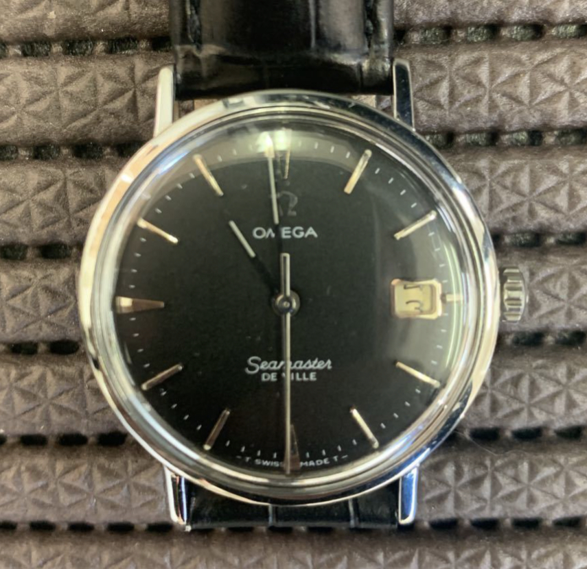

Hello,
I would like to have your opinion on this seamaster deville, especially on the dial.
This is a seamaster deville cal.610. To me every part is original except the Crystal without the omega logo stamped on the center.
I don鈥檛 see any alarming sign regarding the dial, minute markers are consistent, writing is smooth and there are tritium plots but I might be wrong.
Thanks

Do you have a focussed straight on picture?
I'm sceptic about this erea how this 6 marker is positioned and the positions of the minute markers

Well, there are a number of issues:
- White printing on a black dial (printing should be gilt silver)
- Serifs seem to be missing from the script, but it's hard to tell bc of how blurry the shots are.
- Matte black paint (black dials ought to be gloss if no patina/deterioration)
- Minute markers are not consistent (they ought to be farther out, aligned with the hour ends of the hour indices)
- Early faceted cardinal indices aren't found with "T Swiss Made T" markings (Should be Swiss made only)
- Case looks like it might be for an automatic De Ville, but you can only go so far with depth perception. Do you have a side-shot of the case?
- The profile of the second hand is soft, and the profile of the hour and minute hands seems off, suggesting that the handset is probably a service or aftermarket replacement.
- The case is extremely soft, suggesting that it has been aggressively polished in the past.
In my opinion, it's not worth $200.

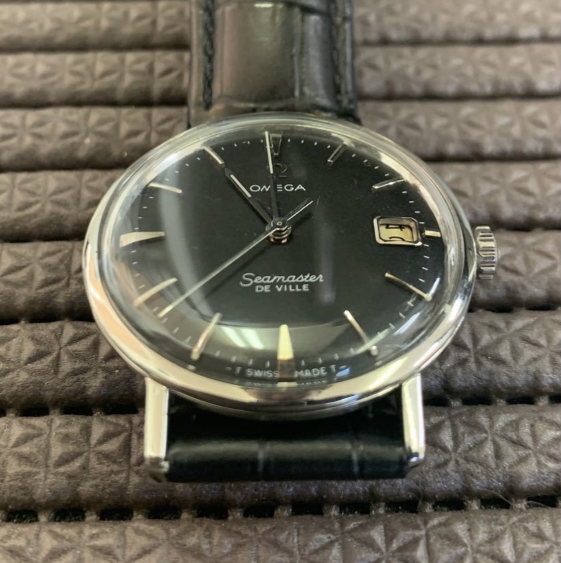

I do have a straight picture, here it is

Thanks for your input ! I am not familiar with the Seamaster DeVille line

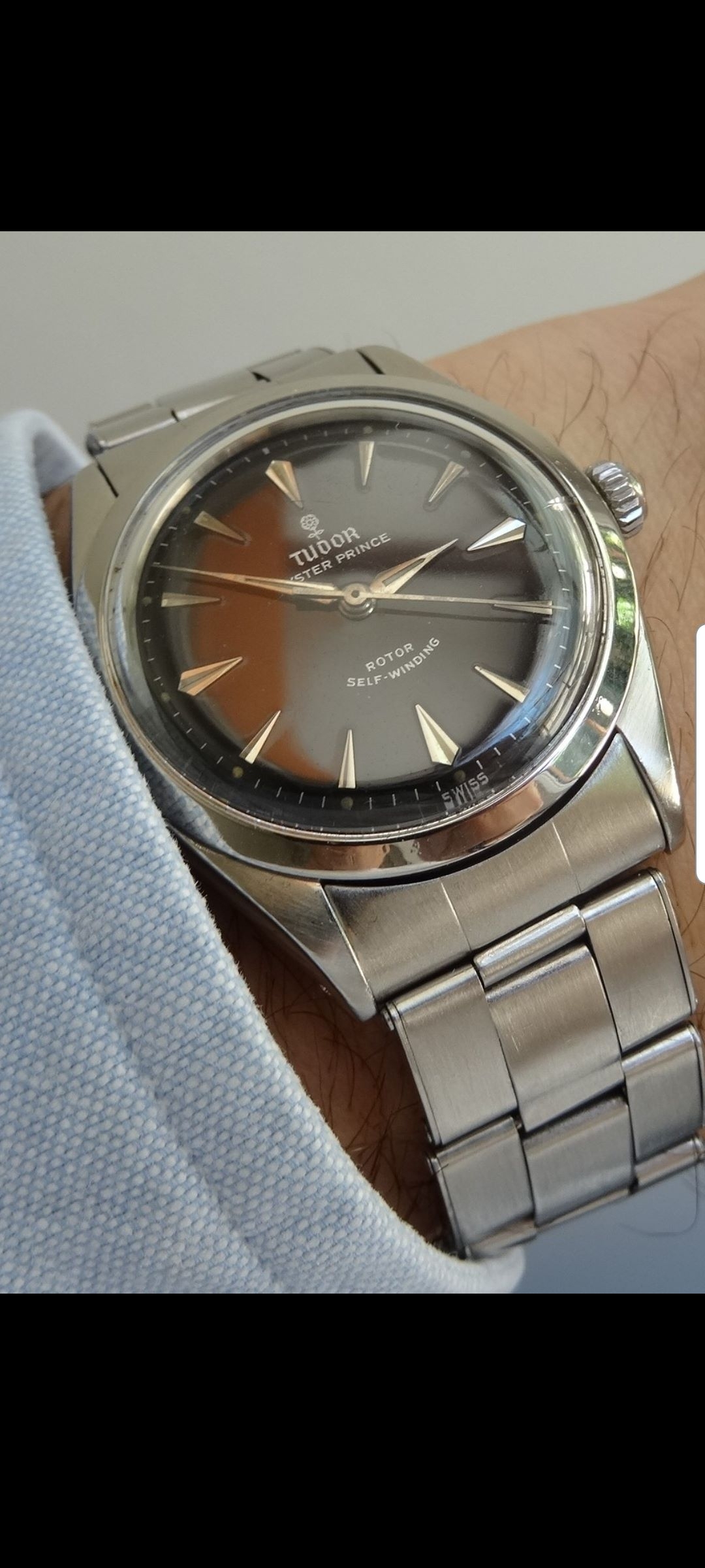

I'm looking at a vintage Tudor Prince Oysterdate now as an alternative (albeit a more expensive one).
Something like this?

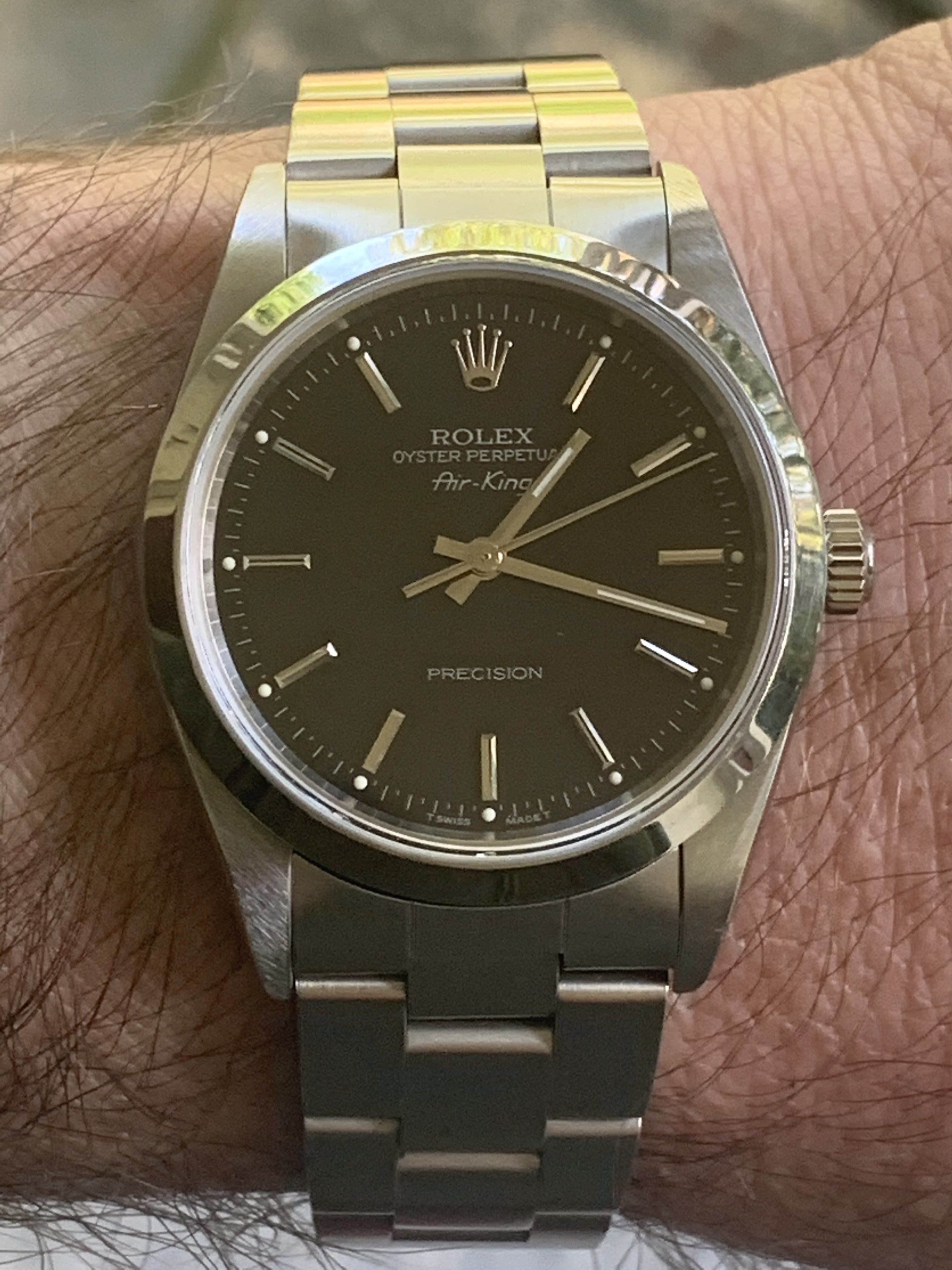

Tudor prince would be a great alternative, and they aren鈥檛 crazy priced compared to a black dialed Seamaster- but avoid dealers who jack up the price. Another one is the older Rolex Airkings which came commonly with black dials. Just watch for fakes and Frankens on the Tudor- lots of scary ones out there. The 5500- and 14000 airkings seem to be reliably original as I don鈥檛 think there is much market for fakes on those.

Some food for thought-
Don Draper also wore an Airking, although they used a much later model than would have been apporiate for the era- I don鈥檛 think it was a mistake considering how attentive they were to details- more like product placement.
