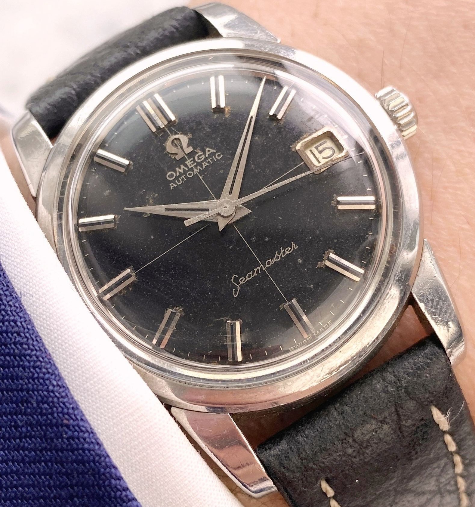

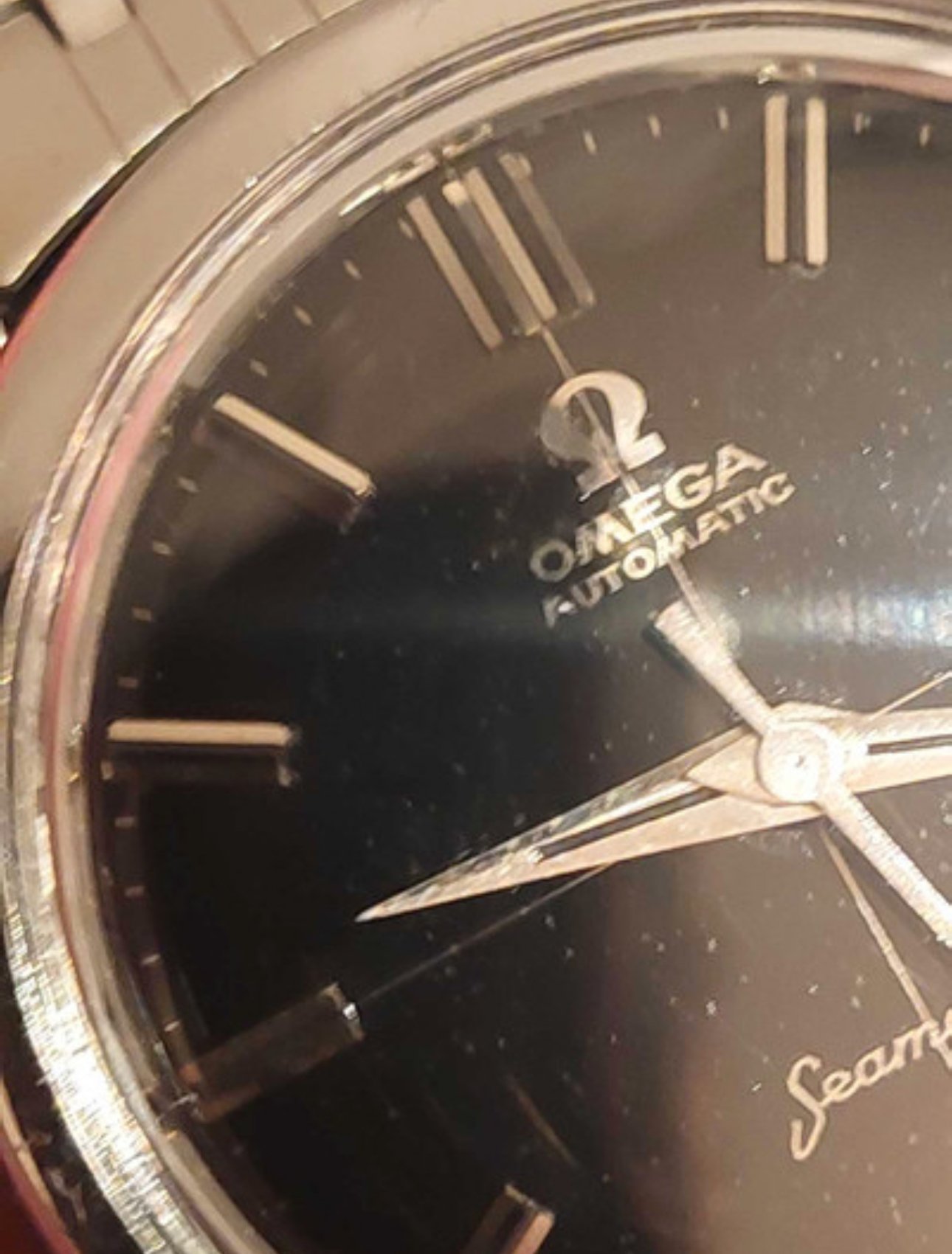

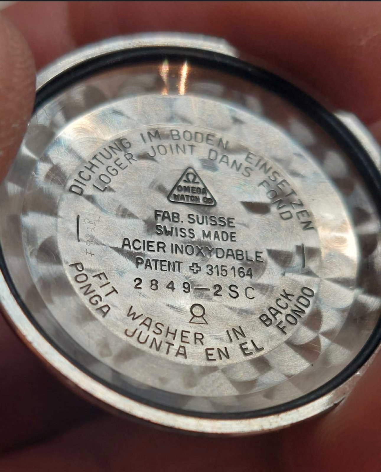

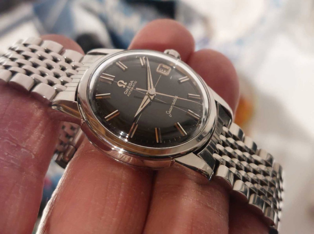

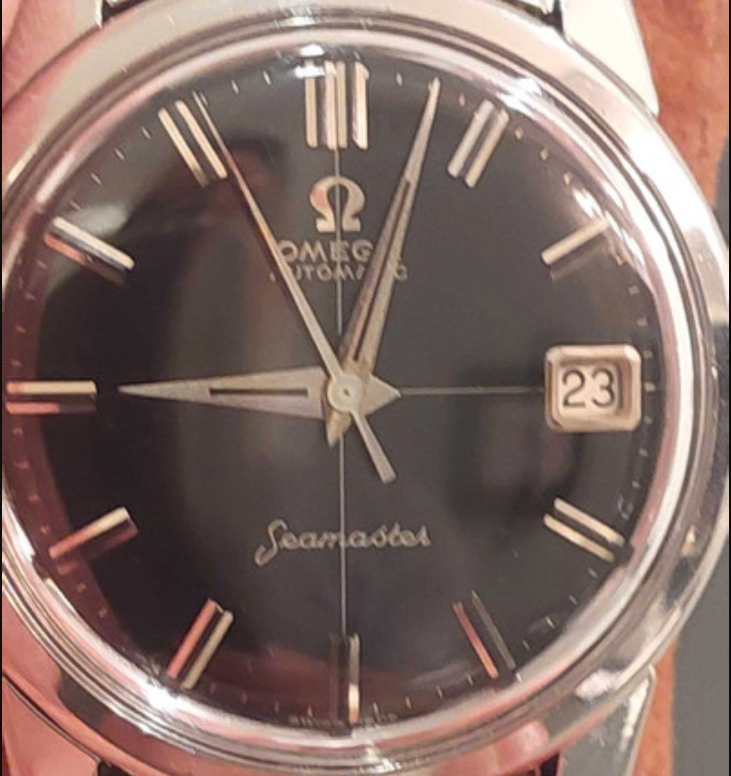

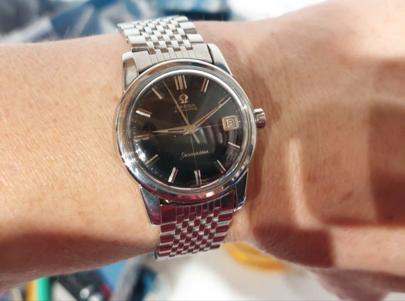

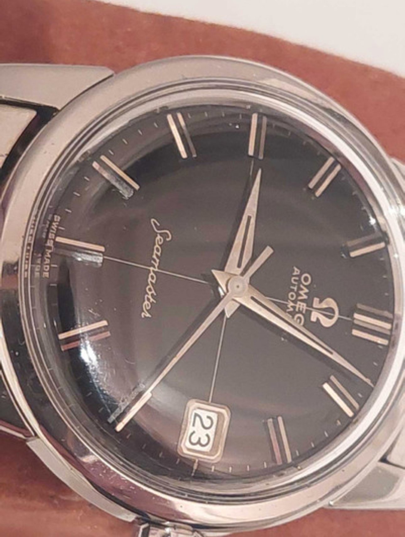

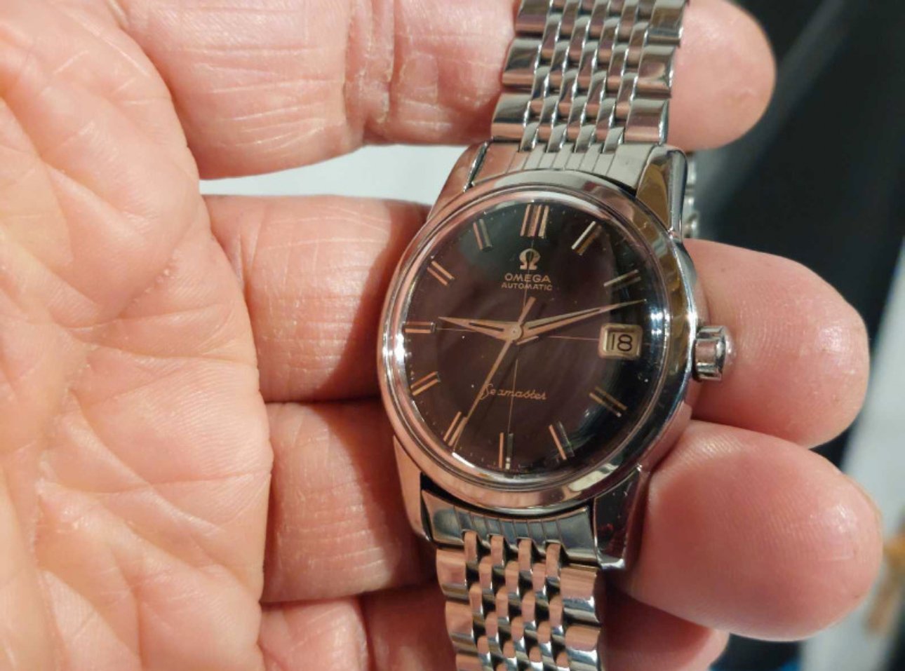

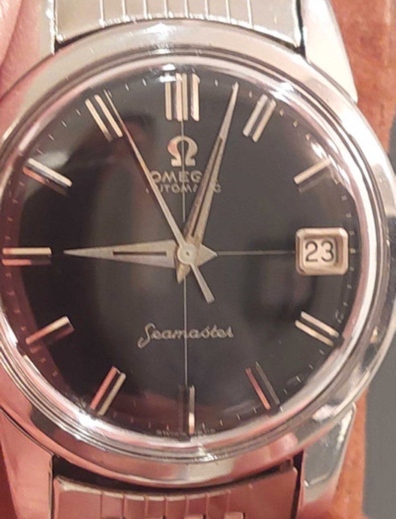

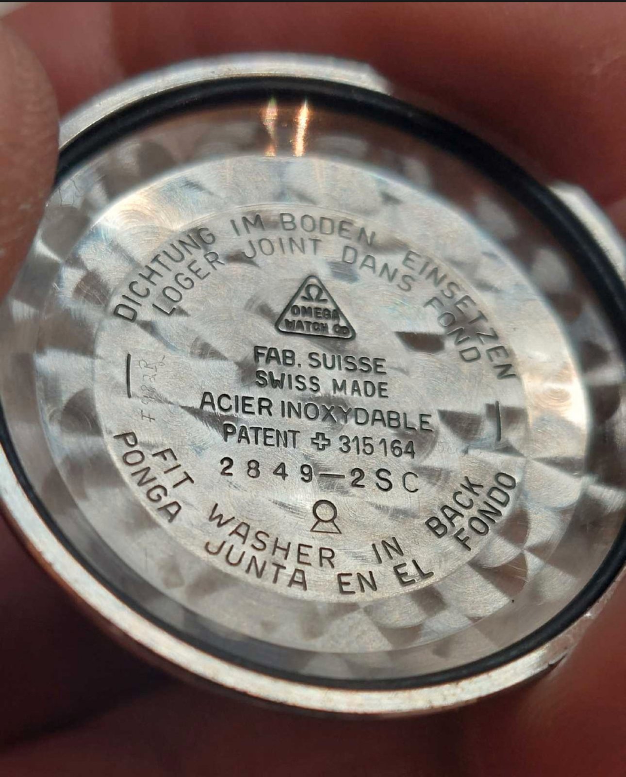

Hi everyone. I’ve been offered a 2849 Seamaster black dial cross hair for $1250 without service history. Its head only as the bracelet is confirmed to be aftermarket. These are the best photos the seller was able to provide me with 😵‍💫. I tried comparing the text to other examples but I found it difficult to come to a conclusion on the dial. What I understand is these came with slightly different fonts and text, depending on earlier or later examples. The most confusing thing is the Seamaster text. What say you all? Thanks in advance

I’d say it looks good when compared with your example

The pictures are too bad to say for sure on the dial, but one thing is for sure - those black insert markers didn’t originally come on a black dial SM. And that’s definitely not a good sign for dial originality.

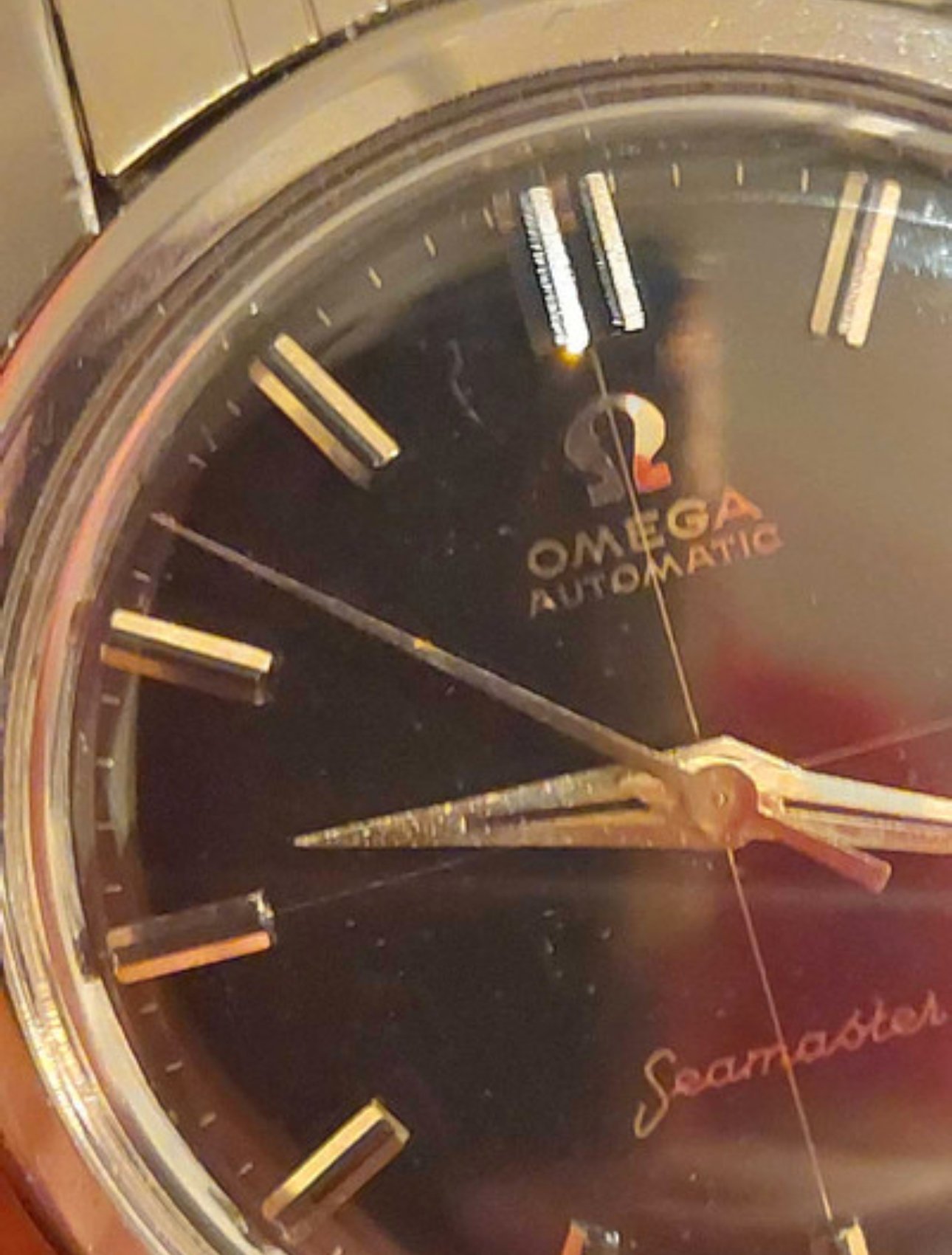

Looks good to me.
You can see the reflectivity of the "printing" in the second photo an indication of a proper gilt dial.
Onyx inserts are not unheard of on some deluxe special order dials, so I think you're good there too.
Case looks a bit soft in some (many) of the photos.
Better photos would help.

For me 1250 USD it's a high price for this watch but i am not an expert..

Looks good to me.

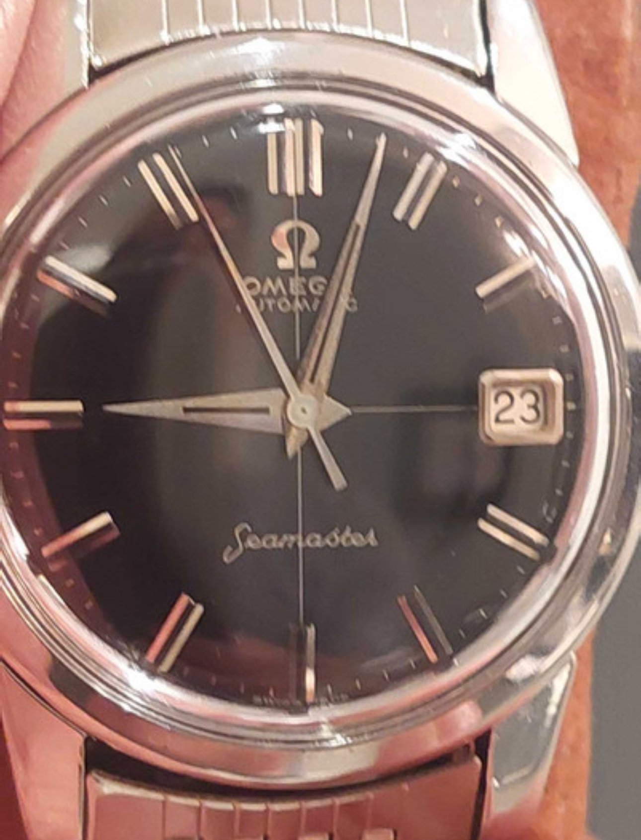

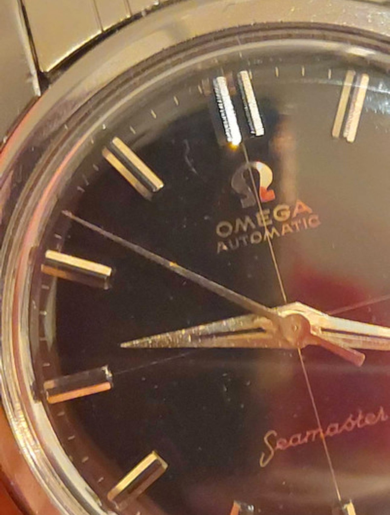

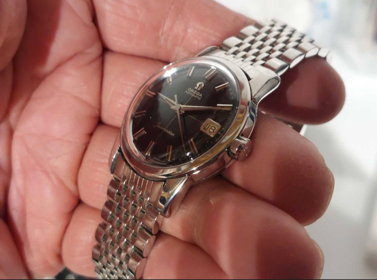

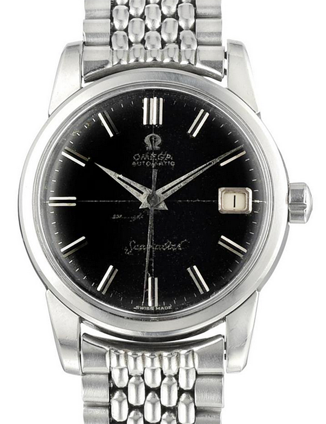

Do you have examples you can share of original black dials with original black insert markers?
13,489
31,802

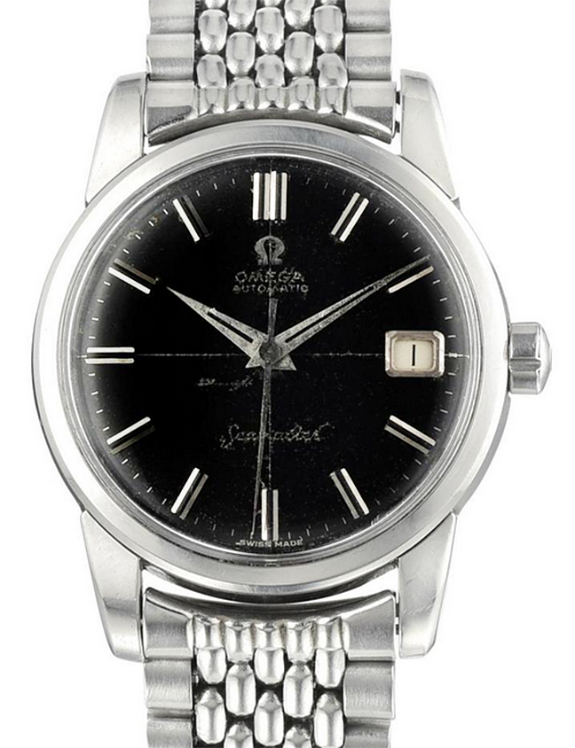

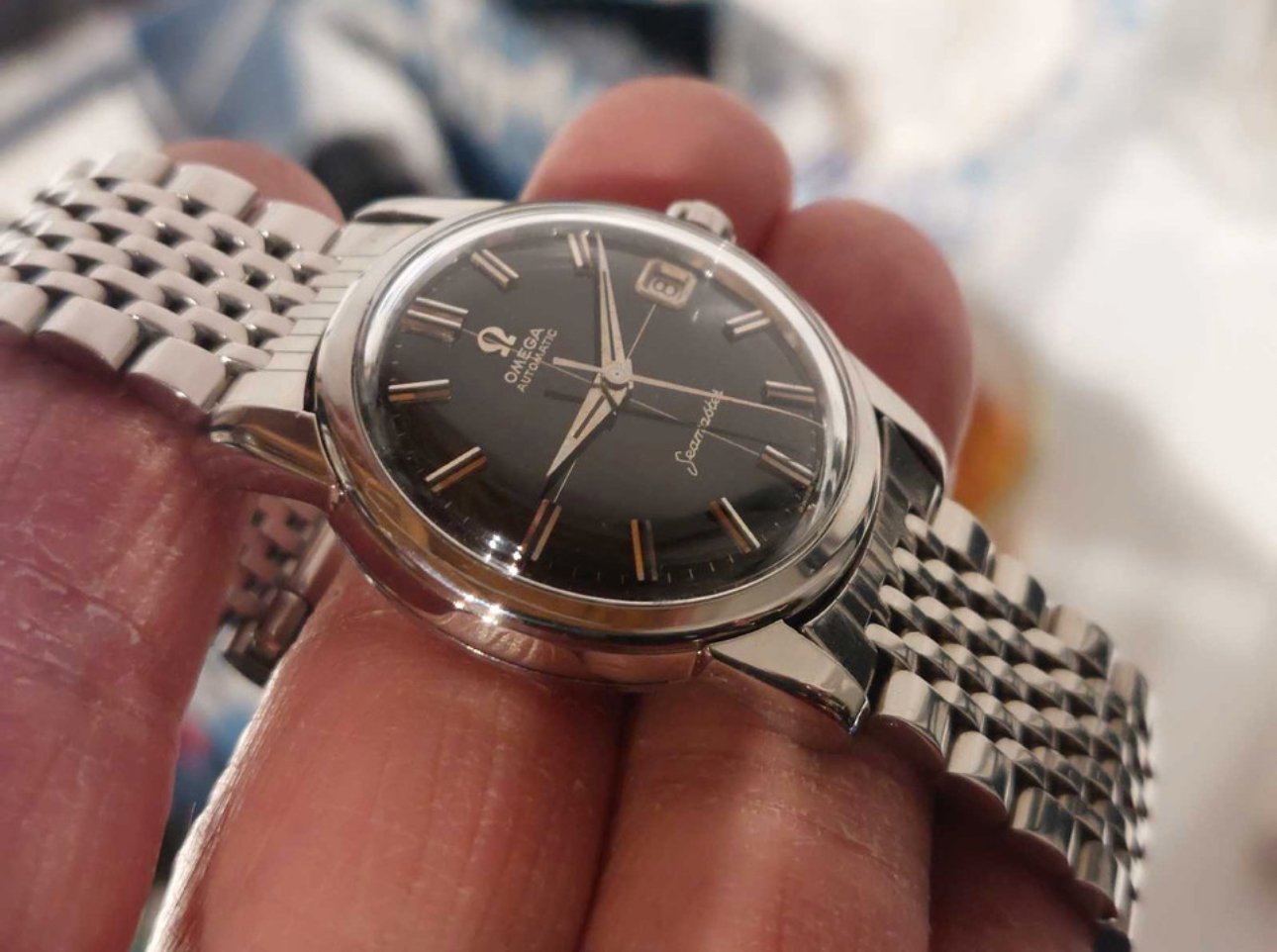

A quick Google turned up these in addition to the ones I've seen in person or had in hand.

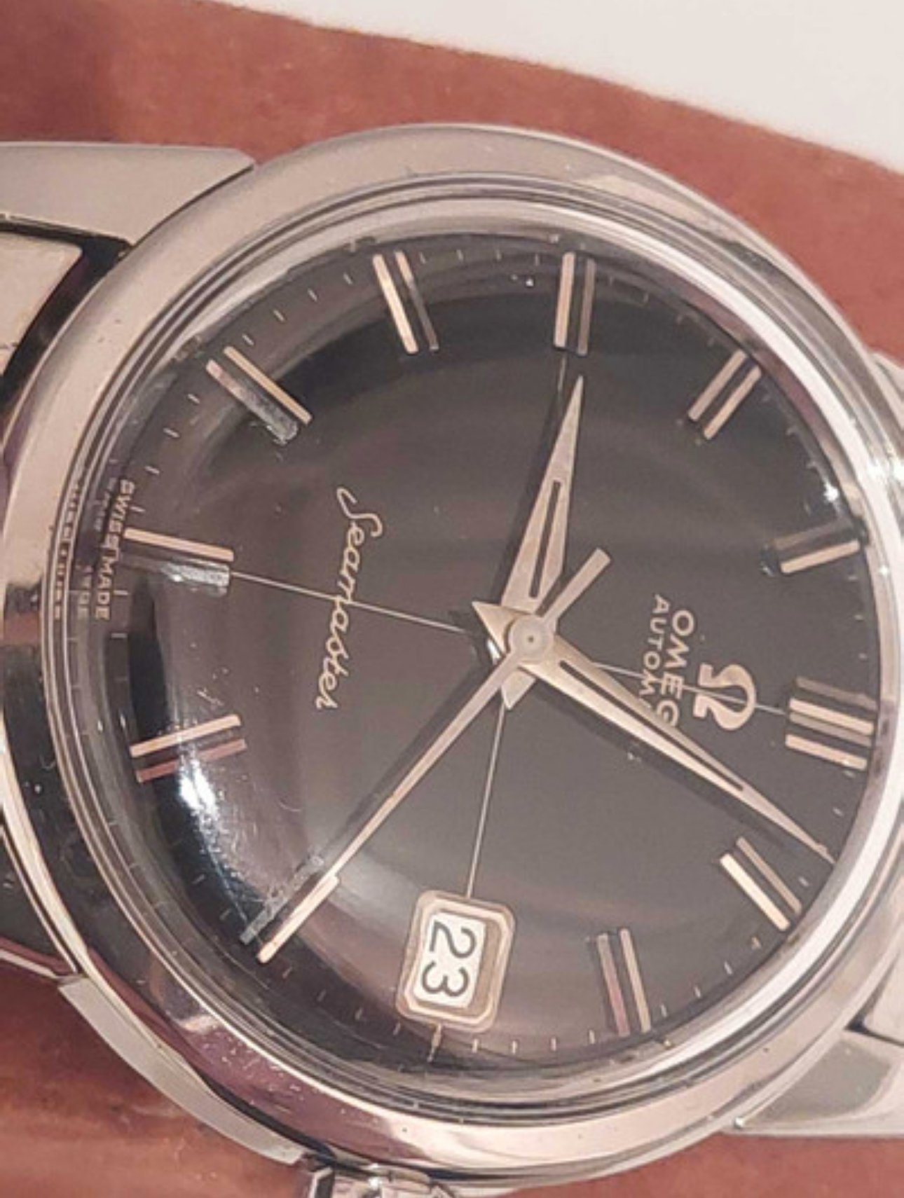

I'd emphasize this quite a bit. IMO the charm of the 2846/8/9 case has been polished away from this example.
Interesting, I stand corrected. I wonder if these were part of a single batch as they’re all the exact same dial variant.
