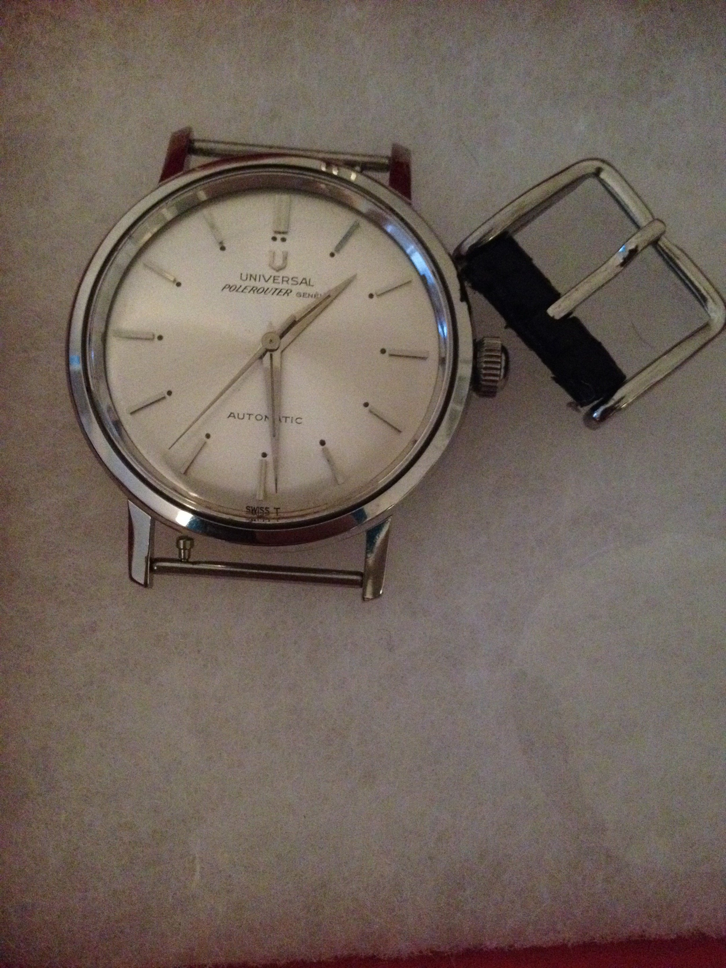

It's best to use fingers or something in rubber to close and align the back first before tightening, in order to avoid stripping the thread.
The reason asked about inside pictures was because sometimes the dial's sagging was caused by the bad rubber bumpers, but also by the back's retention spring gone missing. I do not see that spring ring in your pictures. Did you leave it out or it did not come with the watch?
Sorry for delayed reply and thanks so much for the advice... I did set the back with my fingers first, it was dumb but it was the orientation of the seahorse that I wasn't happy with and it ultimately wound up exactly where it was. Really dumb of me but will force me to get a better case wrench.
As for the ring, I didn't leave anything out... So if a retention spring ring is supposed to be there, it didn't come with the watch. I did see case clamps though. Would it have all 3 (rubber bumpers, clamps and spring ring)?
I know my 176.007 is missing the movement retention spring ring and think I finally found 1 so I can start wearing that once I get it, but for contrast, without it that movement flops around terribly, however that isn't the "case" (couldn't resist) with the Sparkly.
Thx again for the advice!
The clamps just hold the movement to the spacer ring. This spacer ring actually just doesn't do anything since it doesn't reach anything by itself. It requires the rubber bumpers to hold the movement/spacer ring combination between the sides of the case. The spring ring is then required to hold this combination towards the crystal when you close the back. This floating design seemed like a nice idea, but over time the rubbers got deteriorated and the ring often got lost with no service replacement available.
It's because it doesn't have the rubber bumpers to "float" the movement, but it would become obvious when something is missing, unlike the other watch. I also like the 176.007. Any pictures?

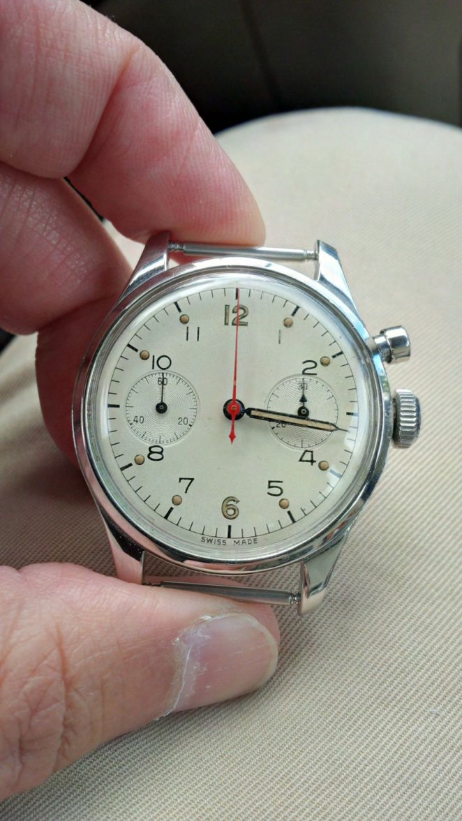

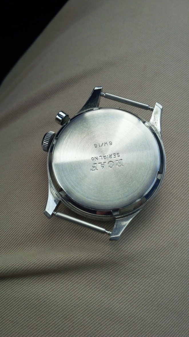

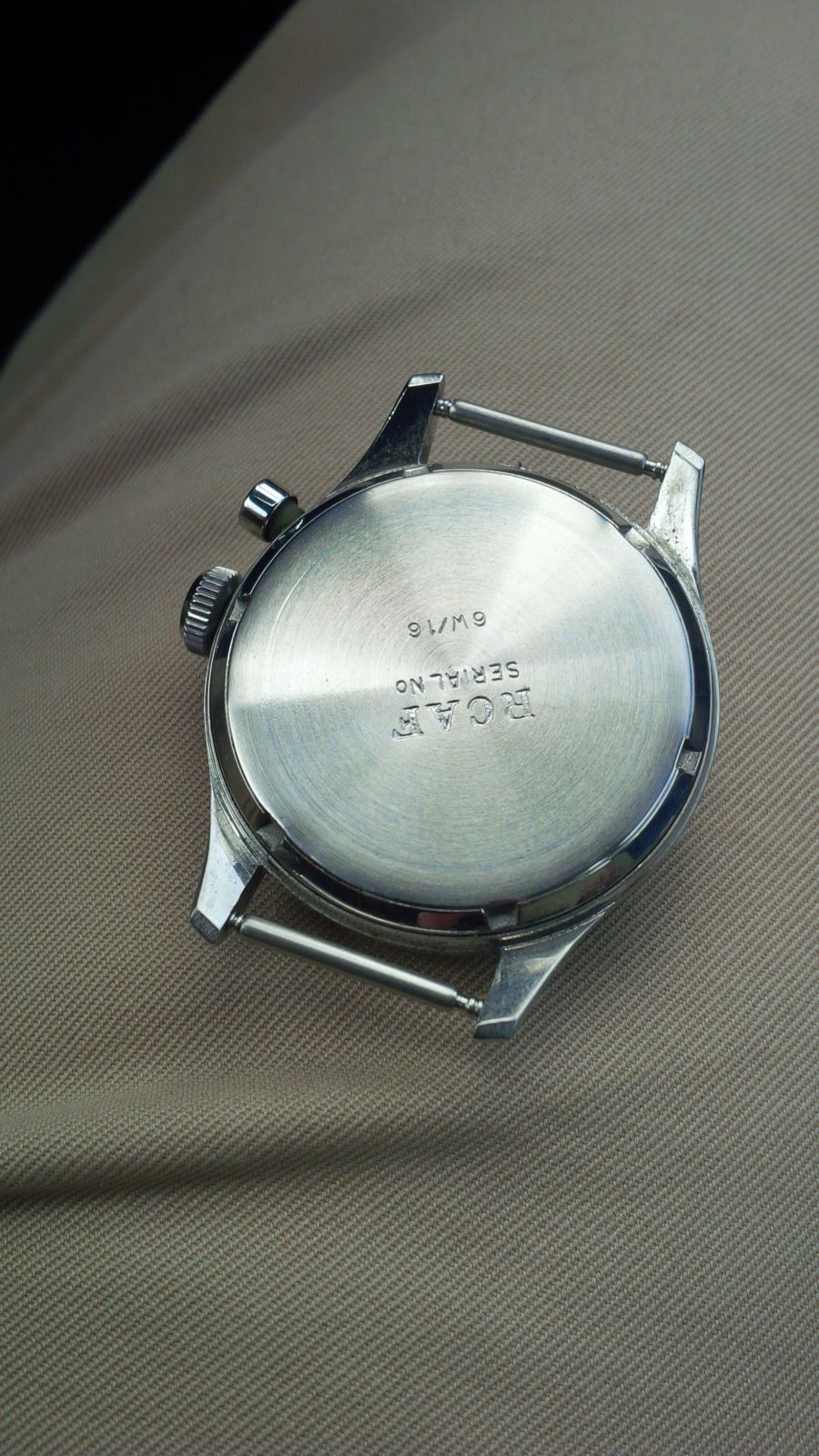

A wonderfully Rare RCAF Wittnauer.
Buster
This is just a questio

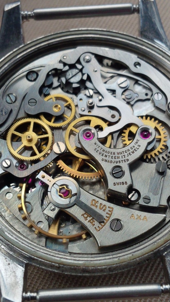

This is just a question because I don't know the answer. If this was for the RCAF why is the a US import stamp AXA on it? Did it have to be sent through the US?

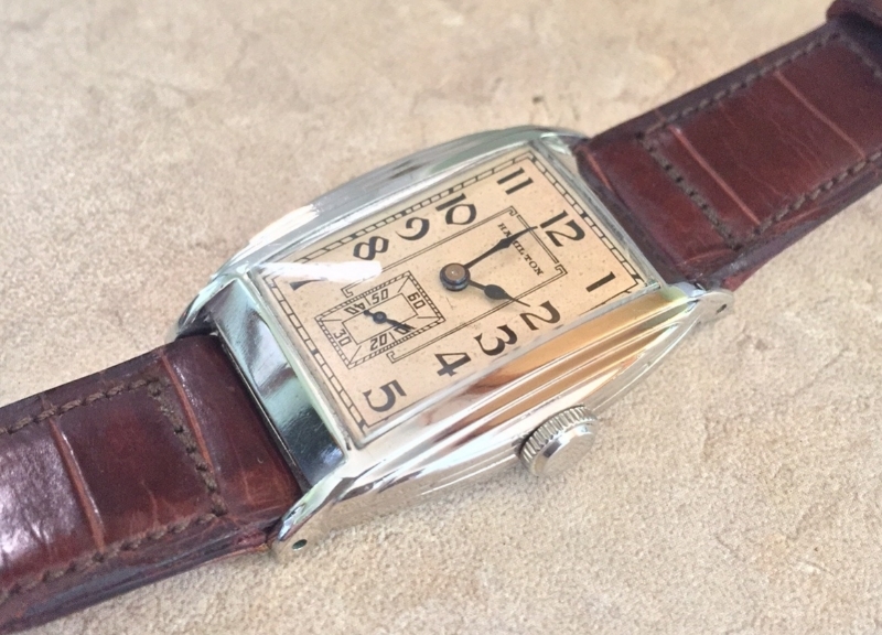

From a good friend I am taking in a beautiful white Hamilton Drake with enamel-print dial in partial trade for my US Army civilian version ref. 2179, which he has admired for a long time, and which he intends to wear as an everyday watch in rotation with a few others...
My understanding is that AXA is the Swiss import stamping for Wittnauer (this making sense that the movement would have been made in Switzerland then imported to the US), and with Wittnauer being a USA company, all parts would have been imported through there first before being 'on sold' to Canada.

Thank you, I figured it must be something like that, just wasn't sure. I don't do my best thinking before the 4th or 5th coffee.

I always stand to be corrected, but that is my understanding of the chain of supply. I was very please to see AXA on this Wittnauer V175 movement, denoting the Swiss import marking. If it were 'made up' most wouldn't have had an AXA part to put on.
From memory a number of movement companies used to stamp them 'unadjusted' to get around import/ tax laws.

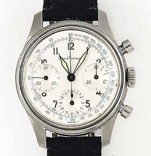

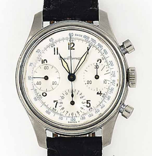

This is going to be interesting. Bought a Girard Perregaux V72 on the basis of one terrible picture. The inking on the subdials looks a little suspect, but will have to wait a couple of weeks to see it in the flesh
1,783
4,132
The Alligator strap was confiscated and destroyed at customs but they were nice enough to send me the watch and buckle!
I've scoured pix of the case and movement... Some seem to have the additional ring, others a rubber ring and most look like the inside of mine. I'll keep my eye out for a retention spring/ring on the 'bay.

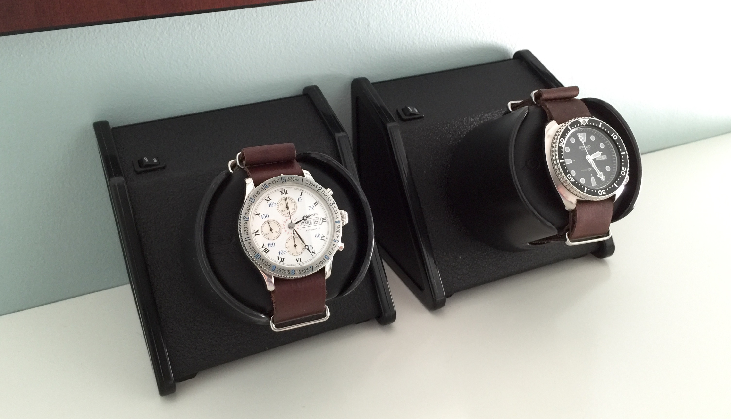

I just purchased 2 Orbita watch winders...27 minutes ago. Before I purchased them, I tested the advertised 8 minute wind interval for both winders via Speedy Gonzales...8:03 and 8:07 respectively...not too shabby. 👍

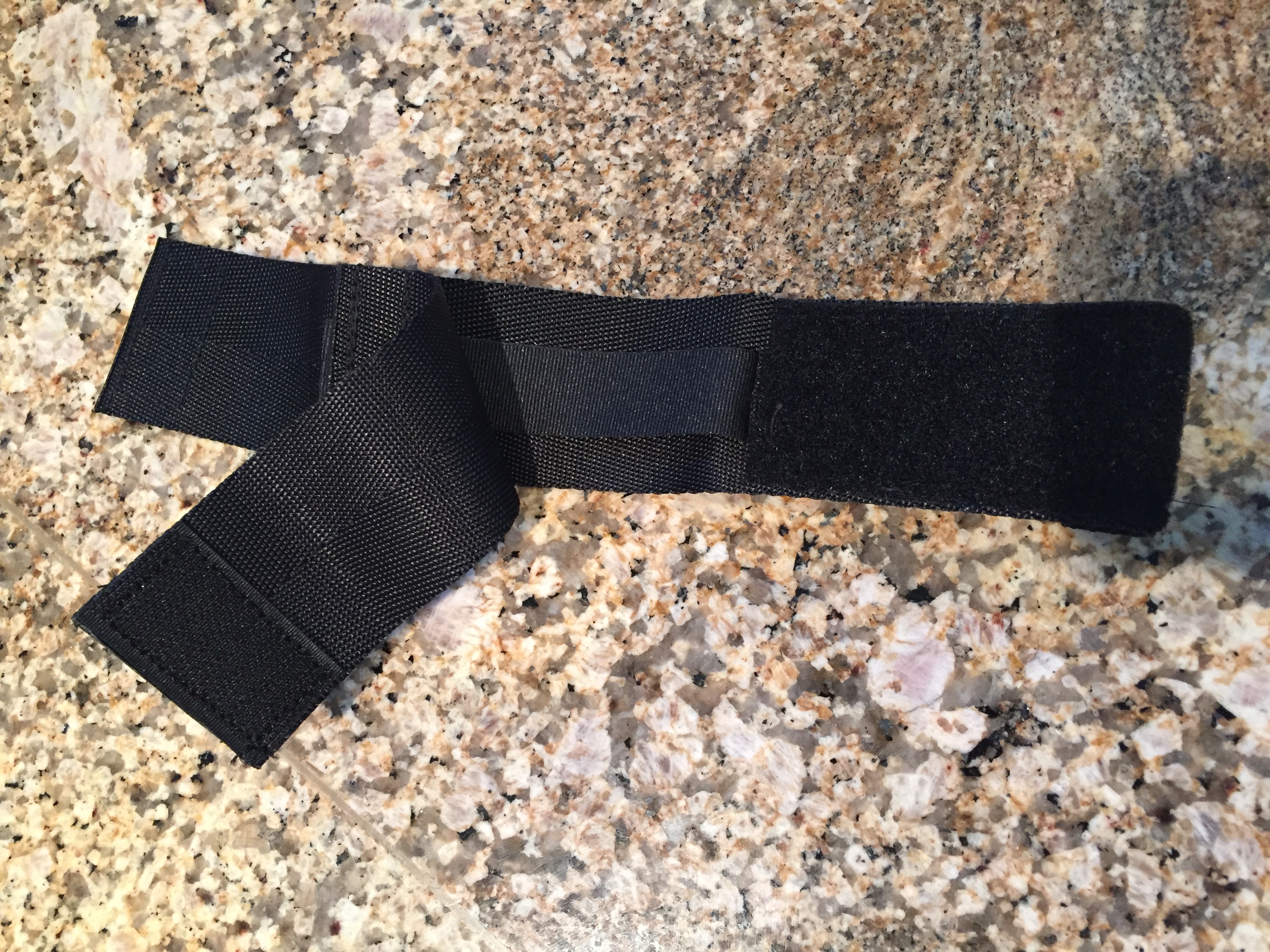

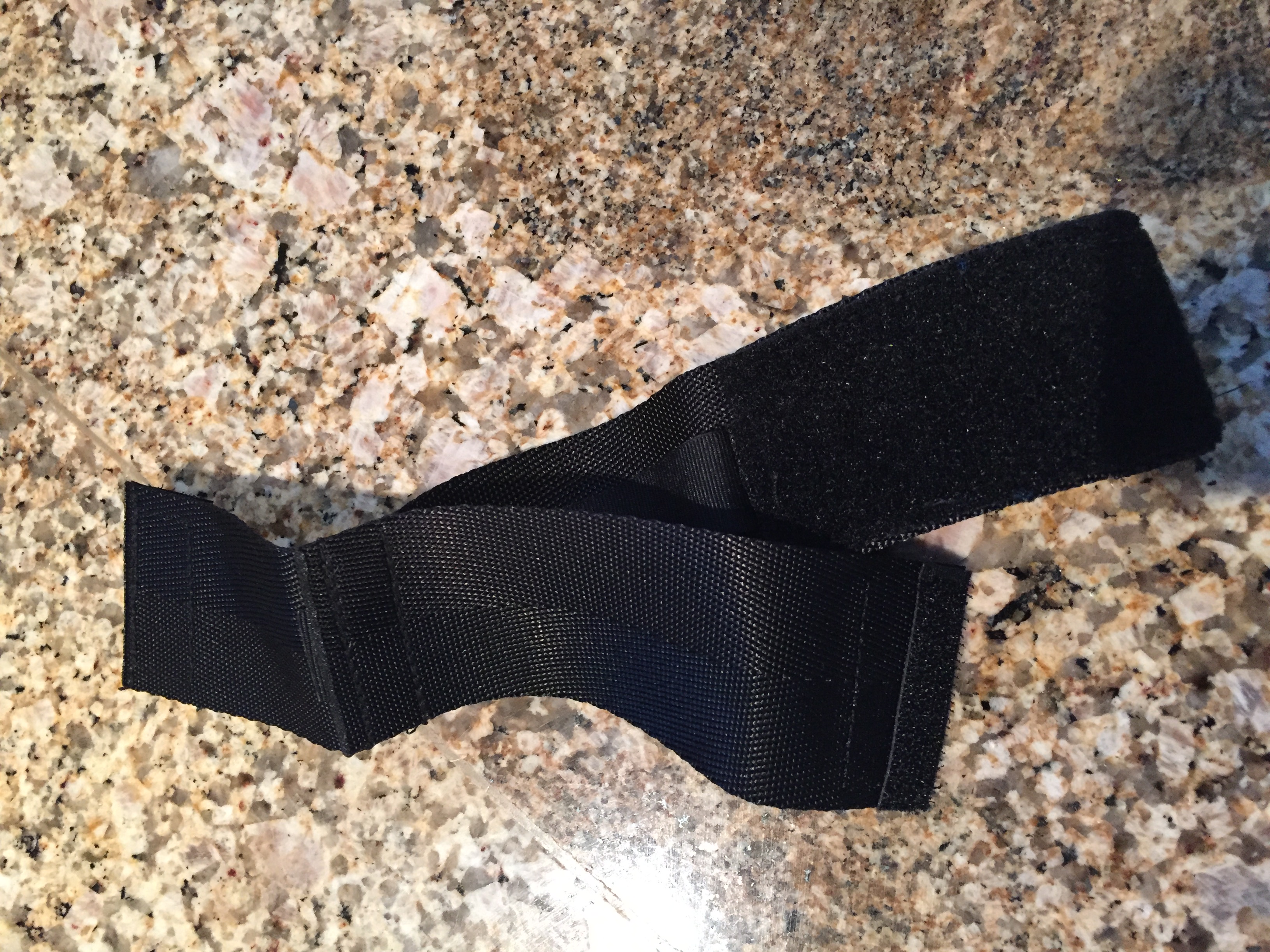

I saw this Rothco strap, and thought to get one for protect my Speedy or other watch. 👍
It fits tight, my wrist is big. 😵‍💫
Cool beans...Rothco straps rock. 👍

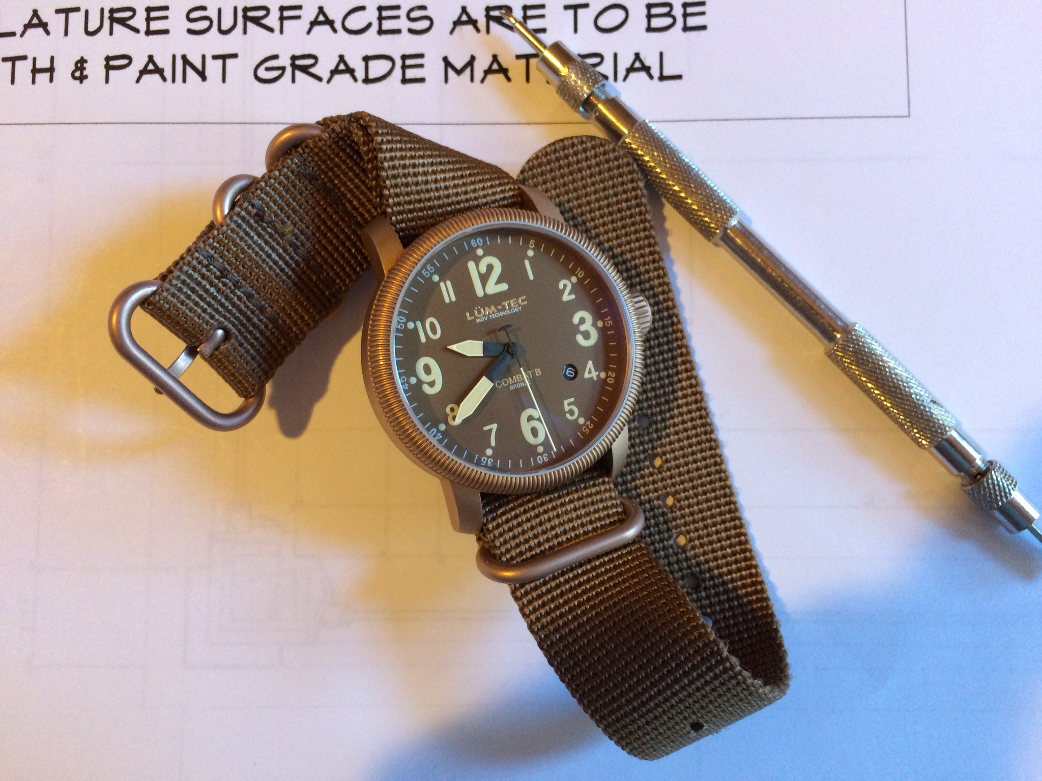

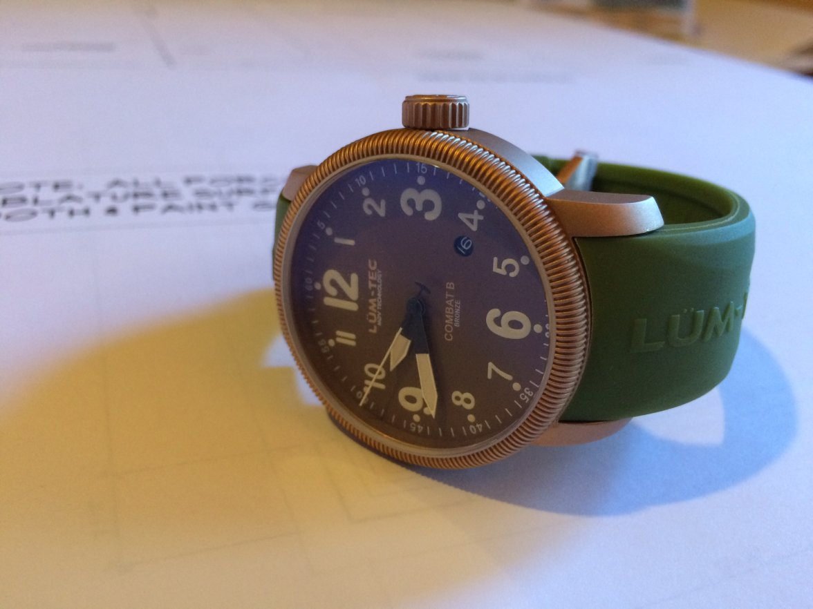

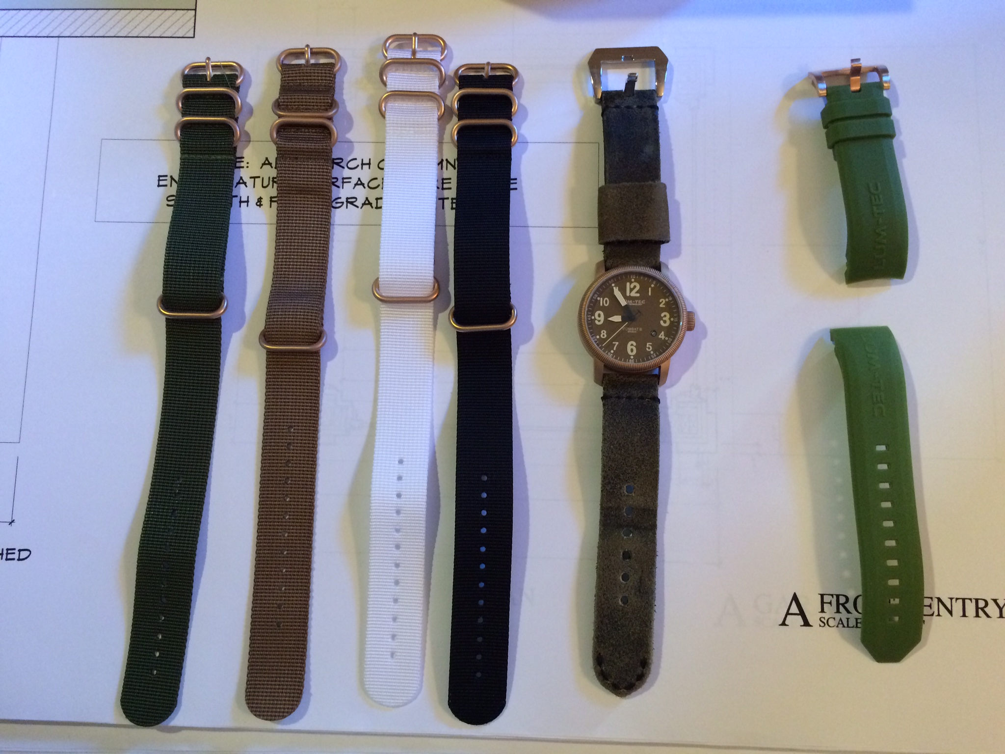

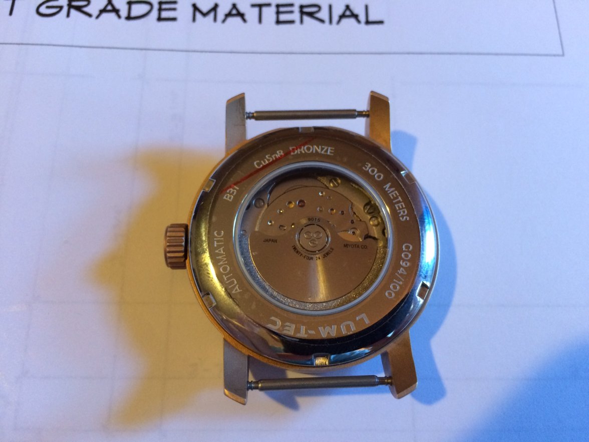

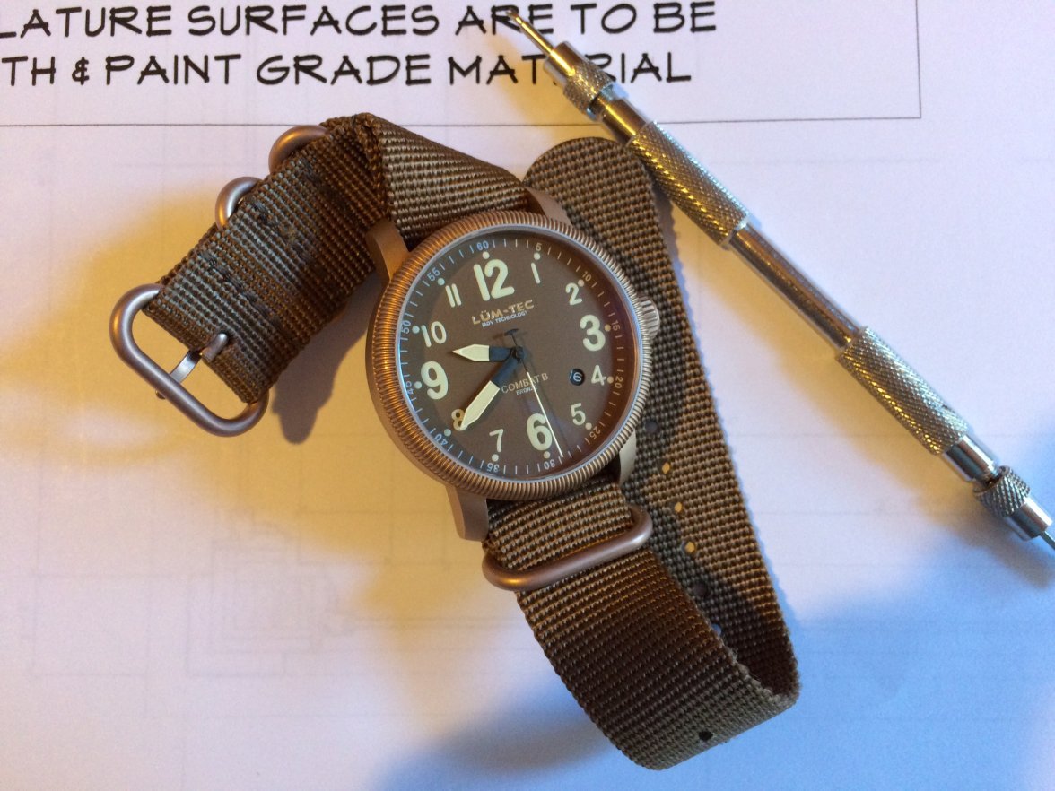

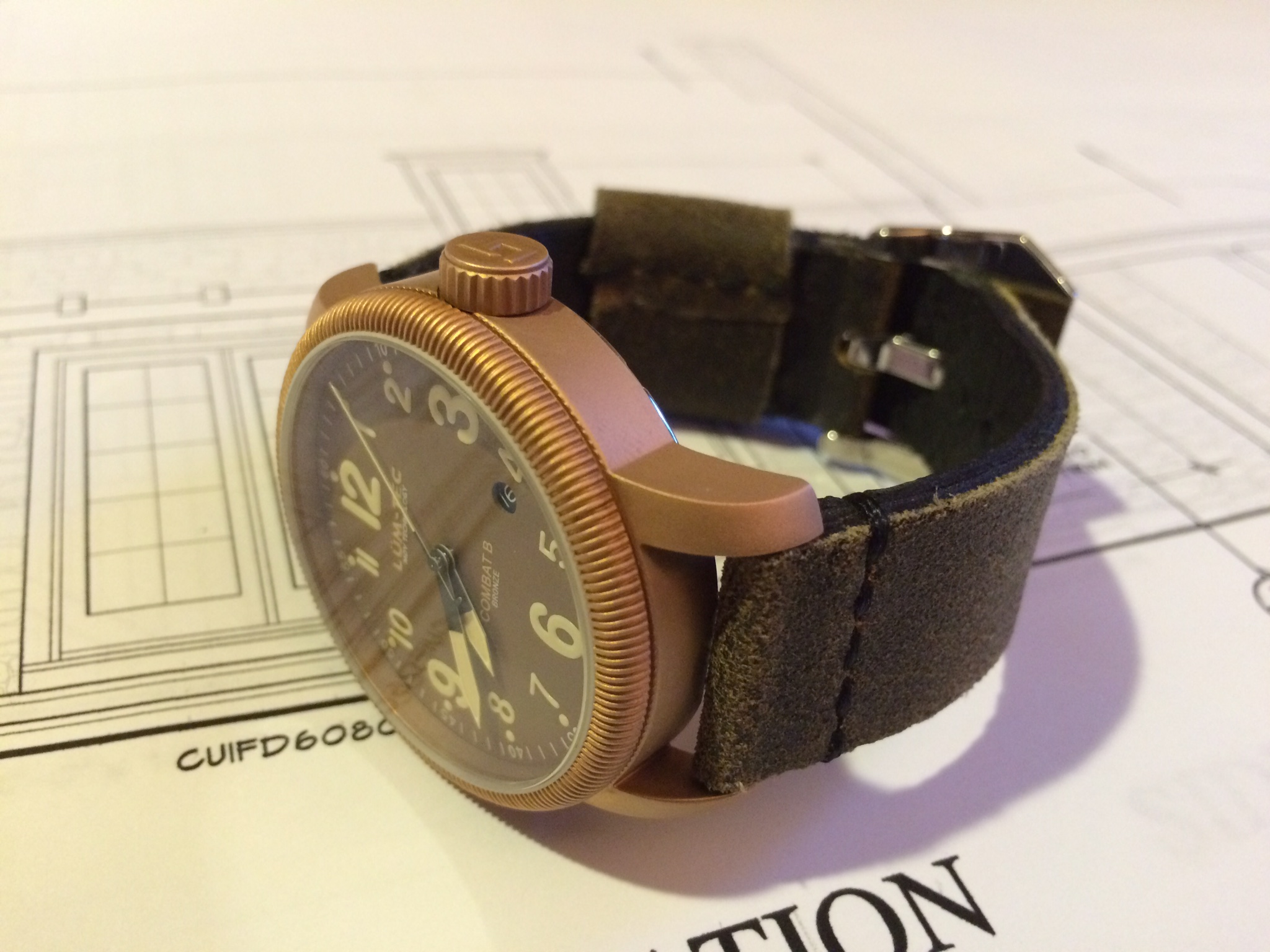

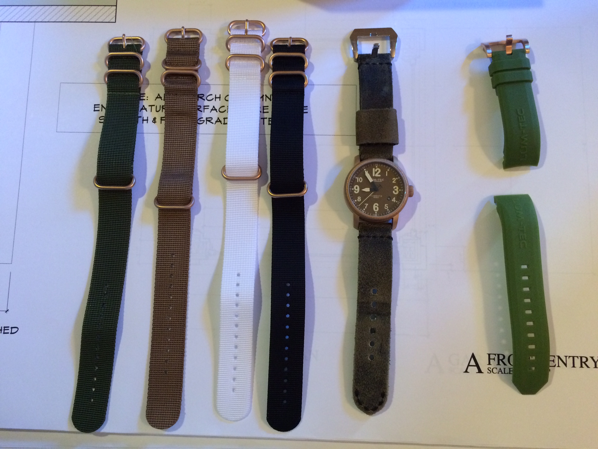

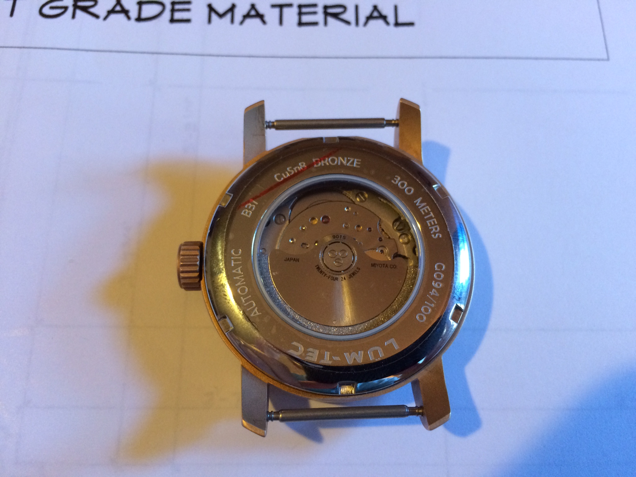

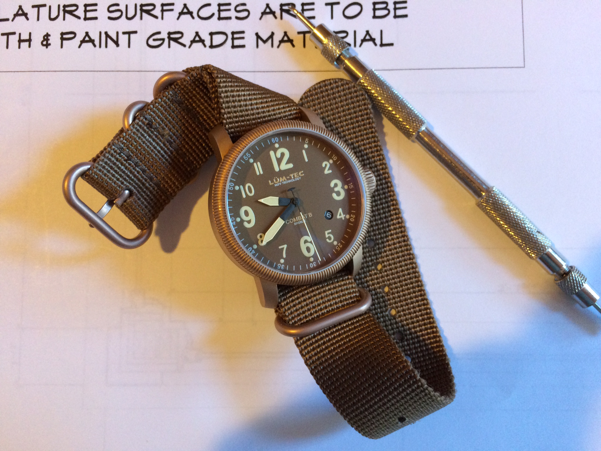

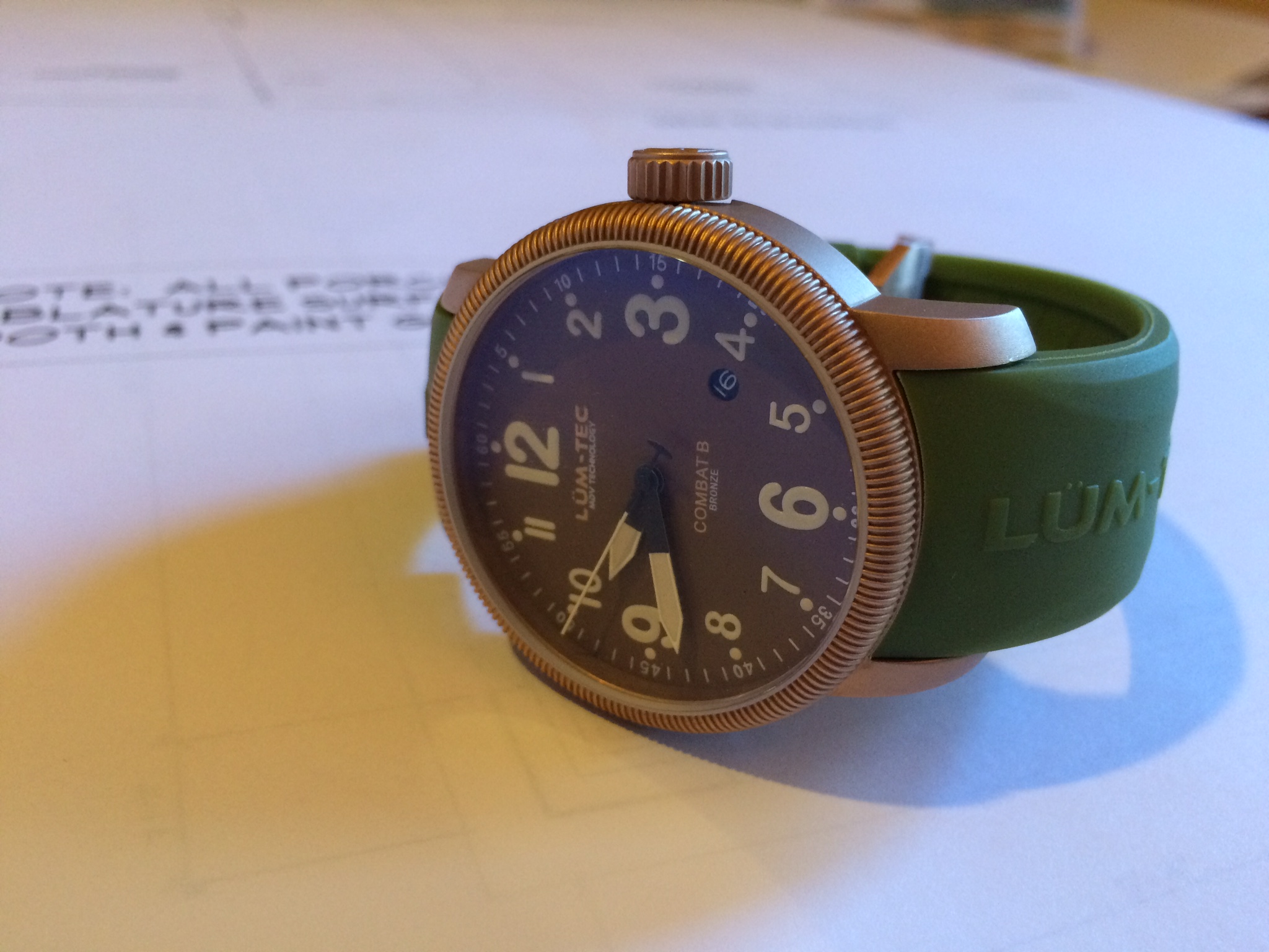

Just got a Lum Tec B31 Bronze.
It's not Swiss, but I don't give a f🤬k, I think it's cool, and it's made here in Ohio.
It comes in a wood box with 4 NATO straps, and a green rubber strap, all with matching hardware. Limited to 100 pieces. Exhibition back.
