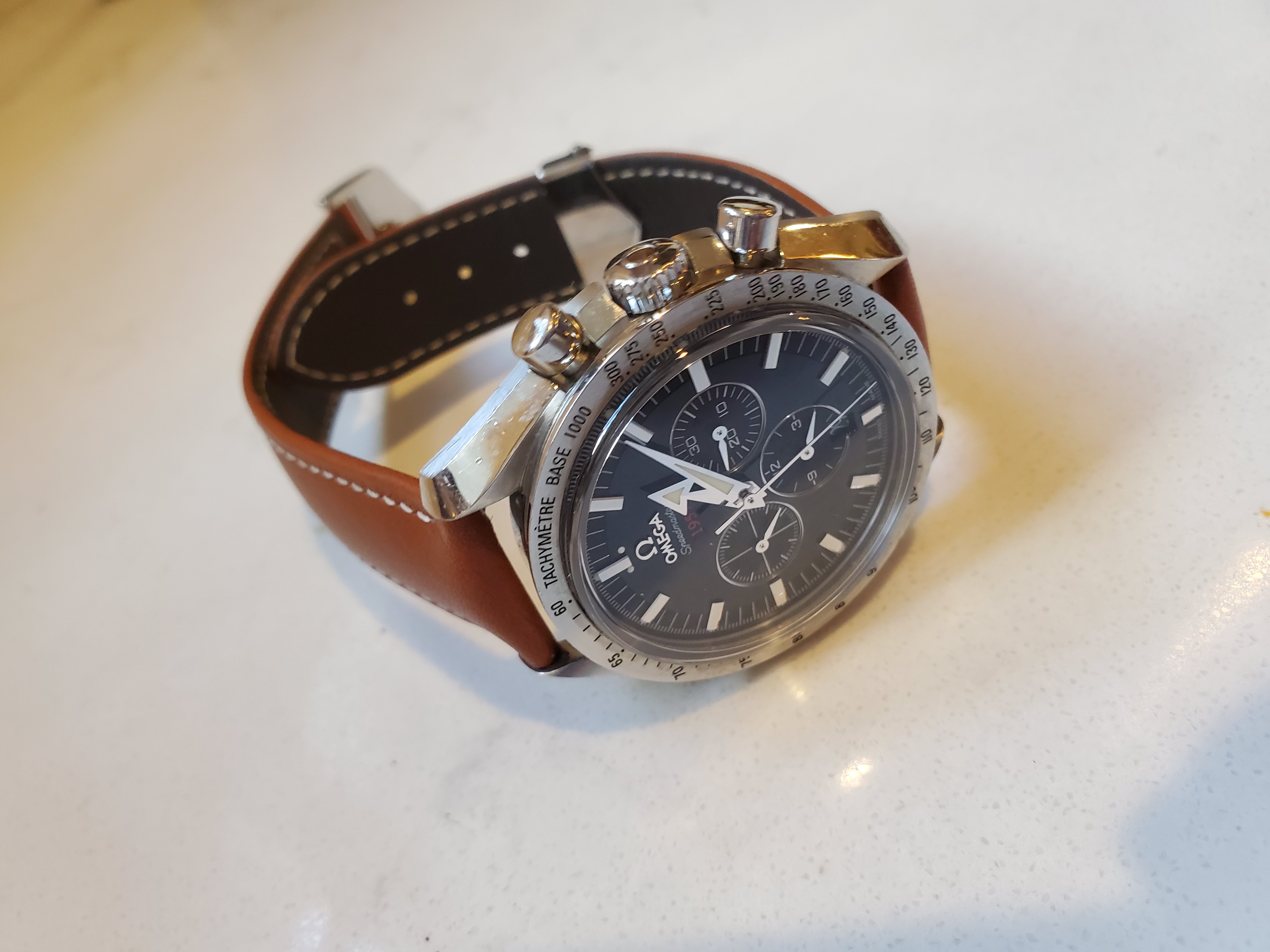

Here's the brown calf leather Hirsch Voyager on the Speedmaster 1957. First strap change went pretty easy. Happy with results, looks and feels like a different watch!
