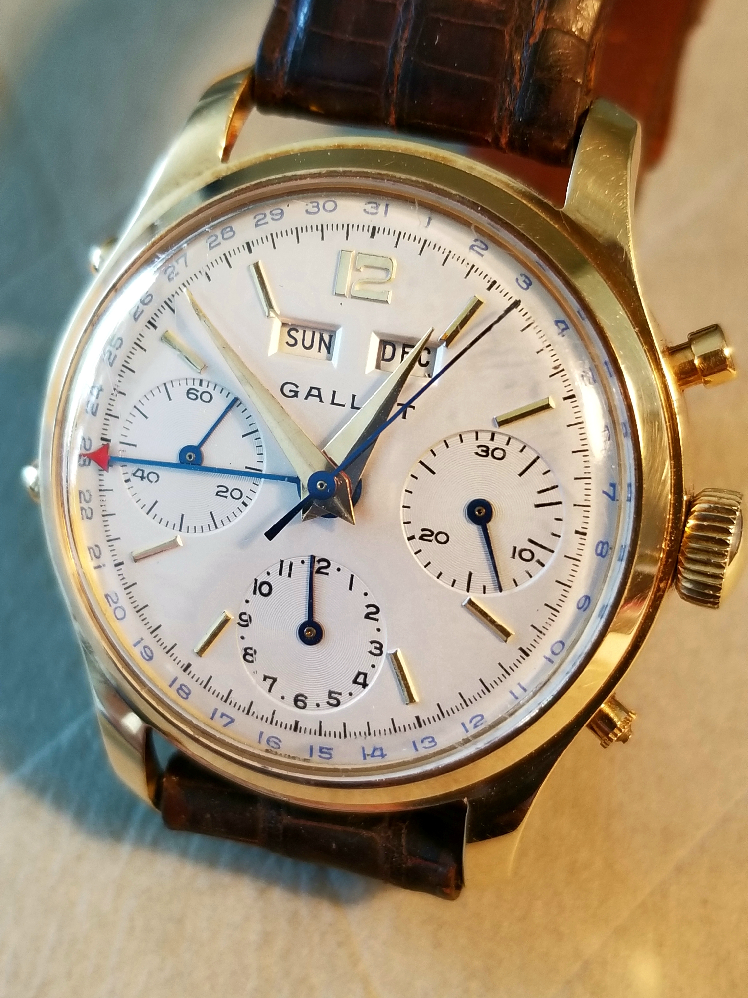

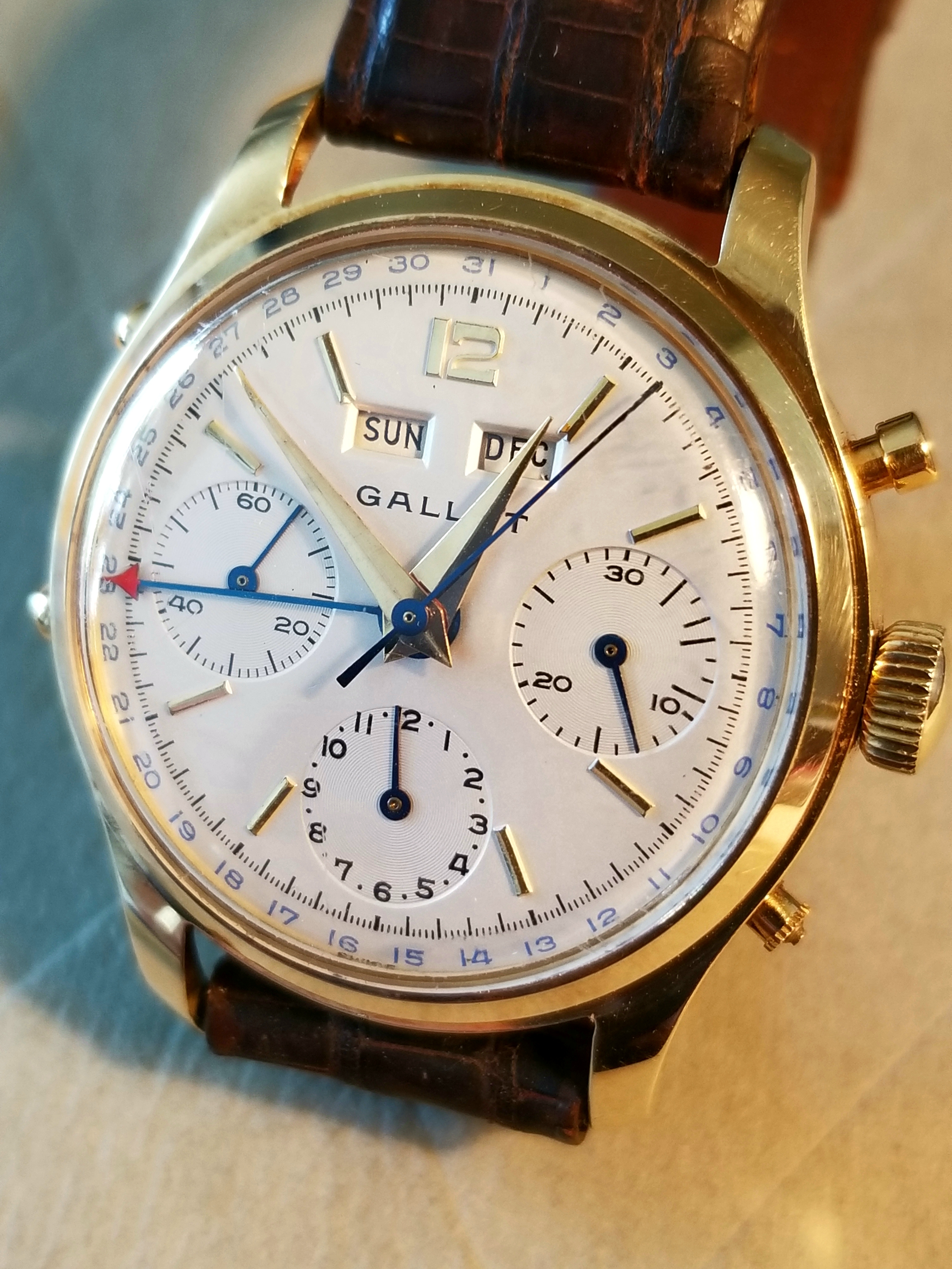

Situation is one missing pusher cap that is proving impossible to find. It's also gold (plated, filled, Colored?) From a sixties 14K chronograph.
Suggested solution is to replace both pusher tubes and caps with same diameter thread as the case but larger, more common size caps.
Are threaded pusher caps from different manufacturers interchangeable, assuming they are European threaded and same diameter (eg a 2.3mm original for a 2.3mm diameter threaded hole?) Will it screw in without stripping the hole?
Were these somewhat standardized or was it mostly unique to a brand or reference?
I'm hoping to find replacements for my watchmaker to install.
Feeling a little desperate.
Thanks.

There are several sizes but a watchmaker can probably find pushers to fit. However, it’s not just the diameter and threads, but also the way the pusher actuates the mechanism, it need to push far enough but not too far, etc. so your watchmaker may need to do some fiddling. It’s best to use someone experienced and patient. On one occasion my watchmaker needed to modify replacement pushers using a lathe.

Thanks, Dan.
You may have guessed that this is for my Gallet. Larry called me 2 days ago to day he couldn't find a pusher cap, after repeatedly assuring me he had a cap and it was no problem.
I am looking forward to getting it back, which he promised to do with a refund.

Oh no, I didn't realize that. So unfortunate, since most likely the availability of parts was one of the main reasons you sent the watch there to begin with.

The only reason was because they said they had a pusher.
Just want to move on at this point.

Outsourcing was the name of the game back during the 20th century. Regardless of the watch brand, most hairspings were supplied by Nivarox. Singer made most dials, and so on. Despite all the claims of "in-house" manufacturing, this is still going on today. If the pusher is the standard 4mm diameter cap with 2.4mm threads, vintage examples in good condition should be easy to find. Gold versions are more rare as these were produced in lower quantities.

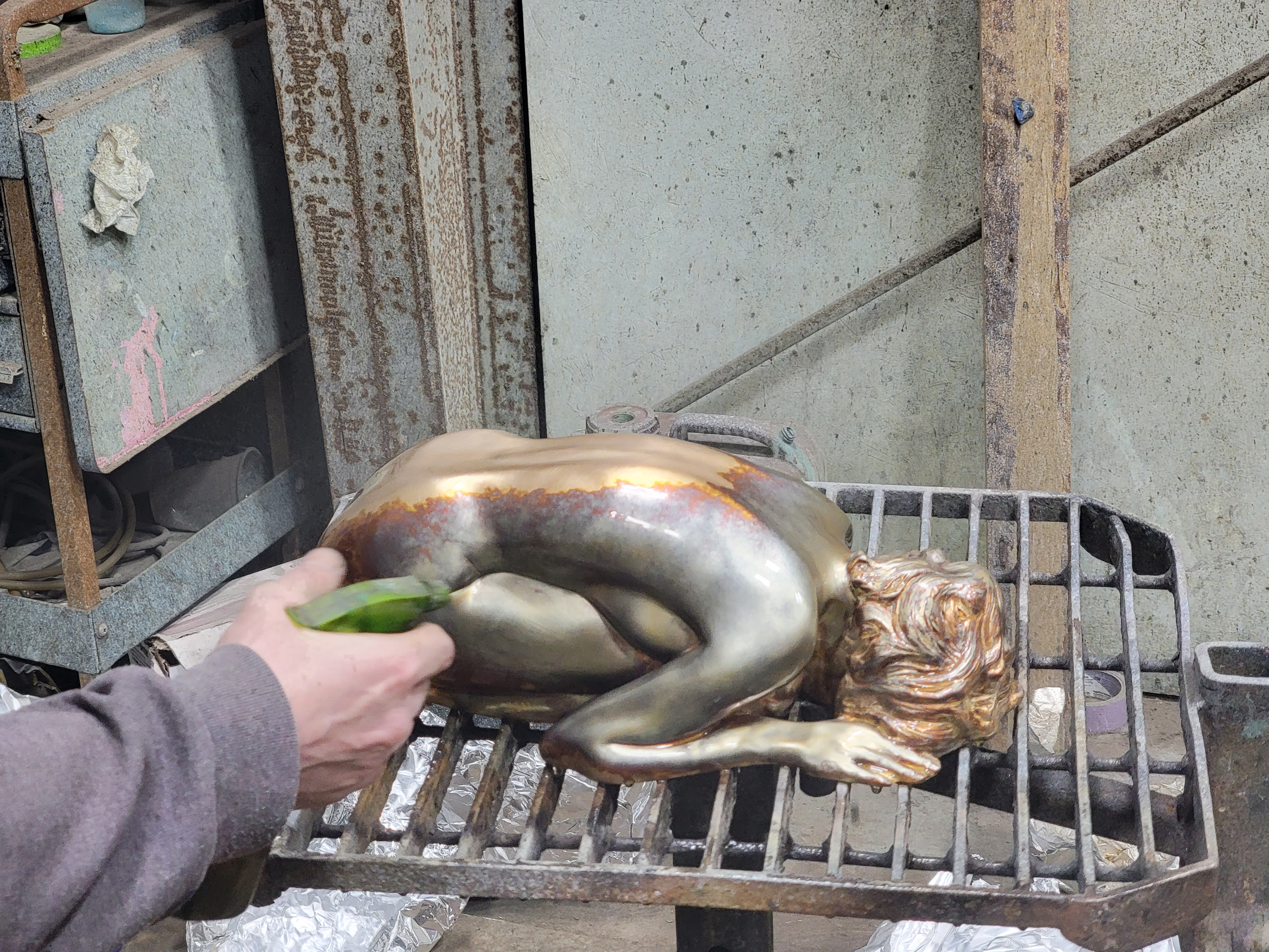

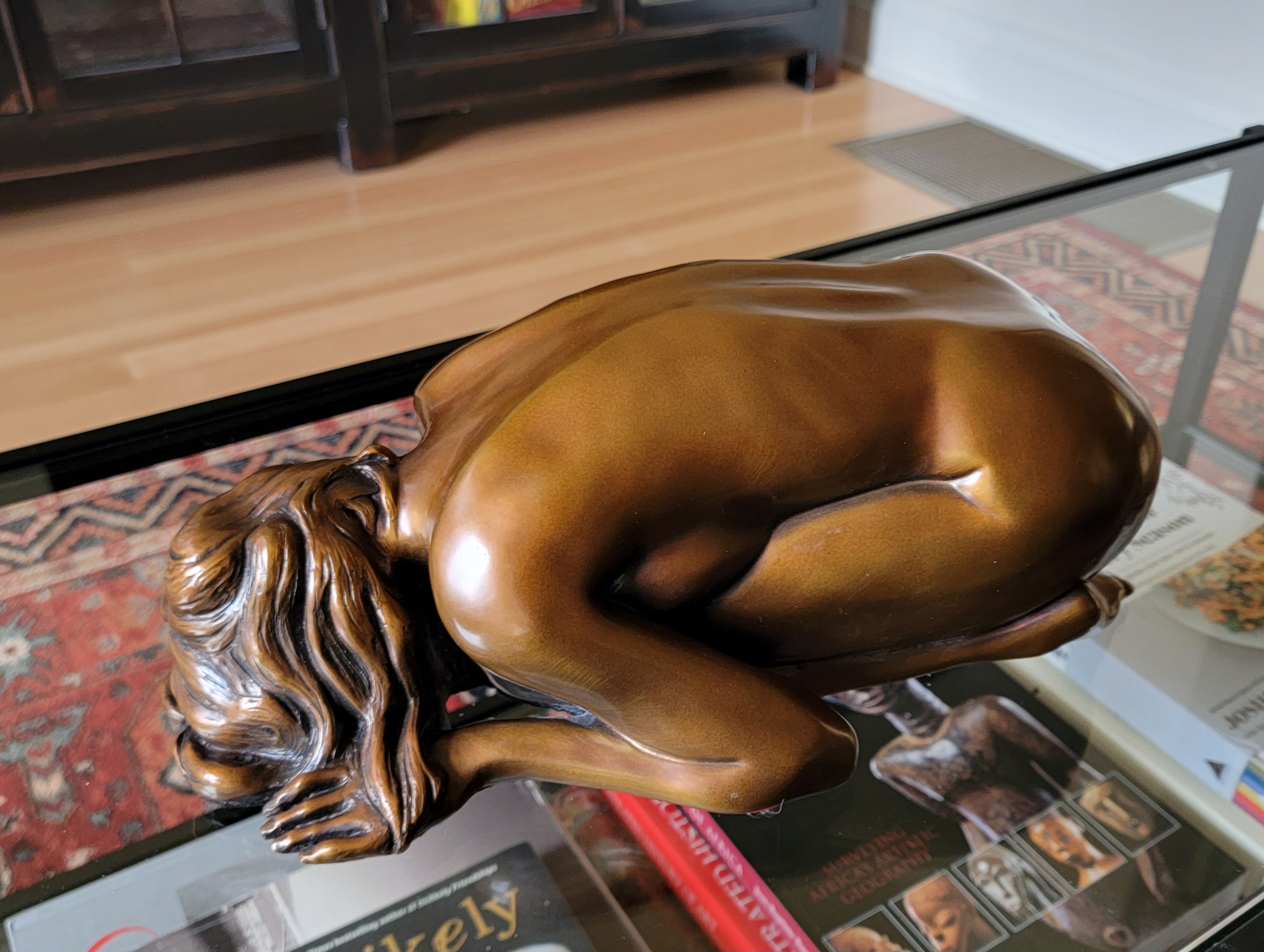

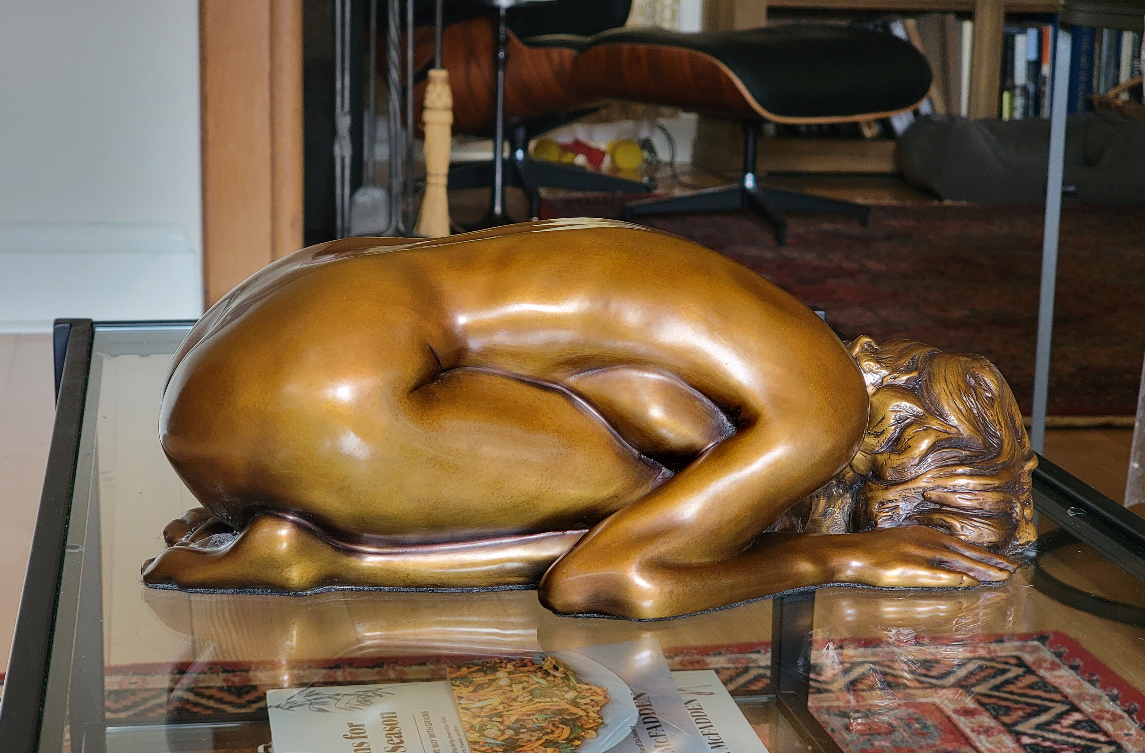

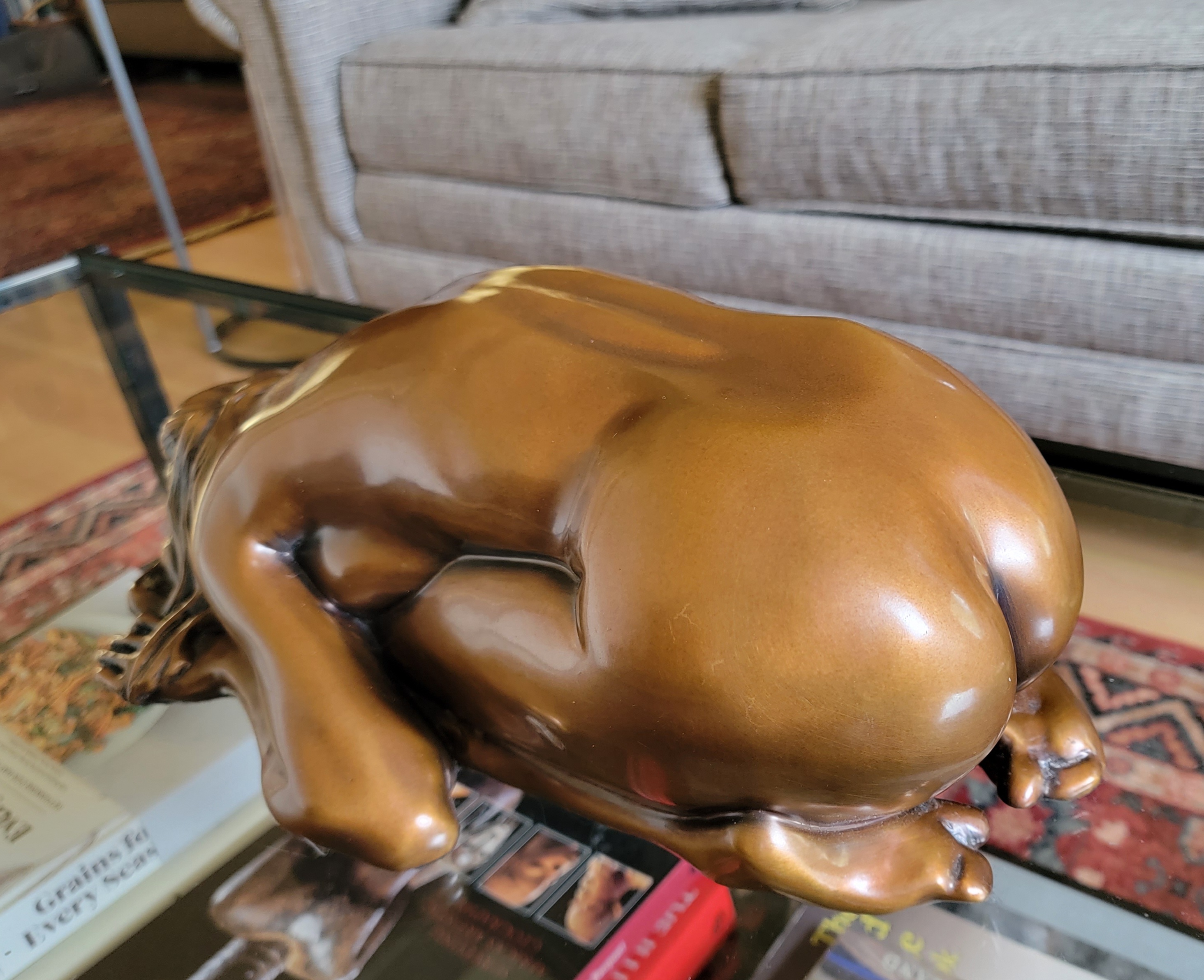

Footnote: My lost wax casting in bronze (actually, my sculpture, a foundry did the casting)

You may find screwed pushers that fit but usually the biggest problem in my experience is the screw that fit into the cap and pushes against the chrono lever. No standard here... This screw must allow the correct travel to allow activating the mechanism, and also fit between the case and the movement. And fit the cap. And fit the tube.
Reminds me of the watch collection I keep under my mattress
8
6
She is gorgeous! Beautiful patina!

What diameter pusher cap do you need?

2.2mm.
(The service center measured it. The watch is being returned to me in the mail and I haven't verified the measurement but 2.2 mm should be close.)

I have never seen 2.2mm diameter pusher caps. It must be 3mm as this was the smallest Swiss chronograph pusher from the 20th century. Extremely rare and even rarer in gold.

Beautiful watch by the way.

Yep, i got mesmerized. "How hard can it be to find a pusher?"
Roland at RGM watches in PA has offered to take a shot at it. I'm hopeful.
