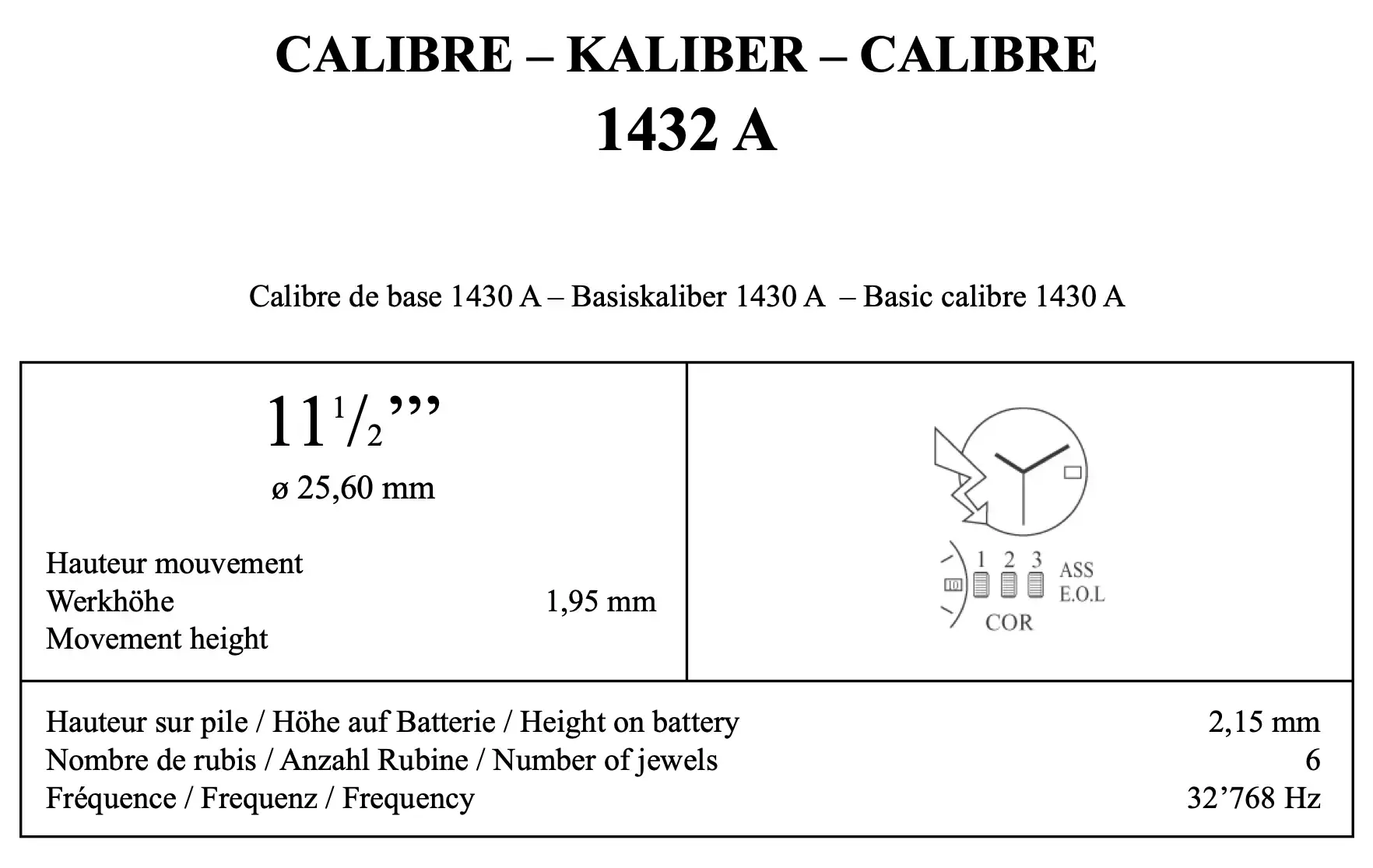

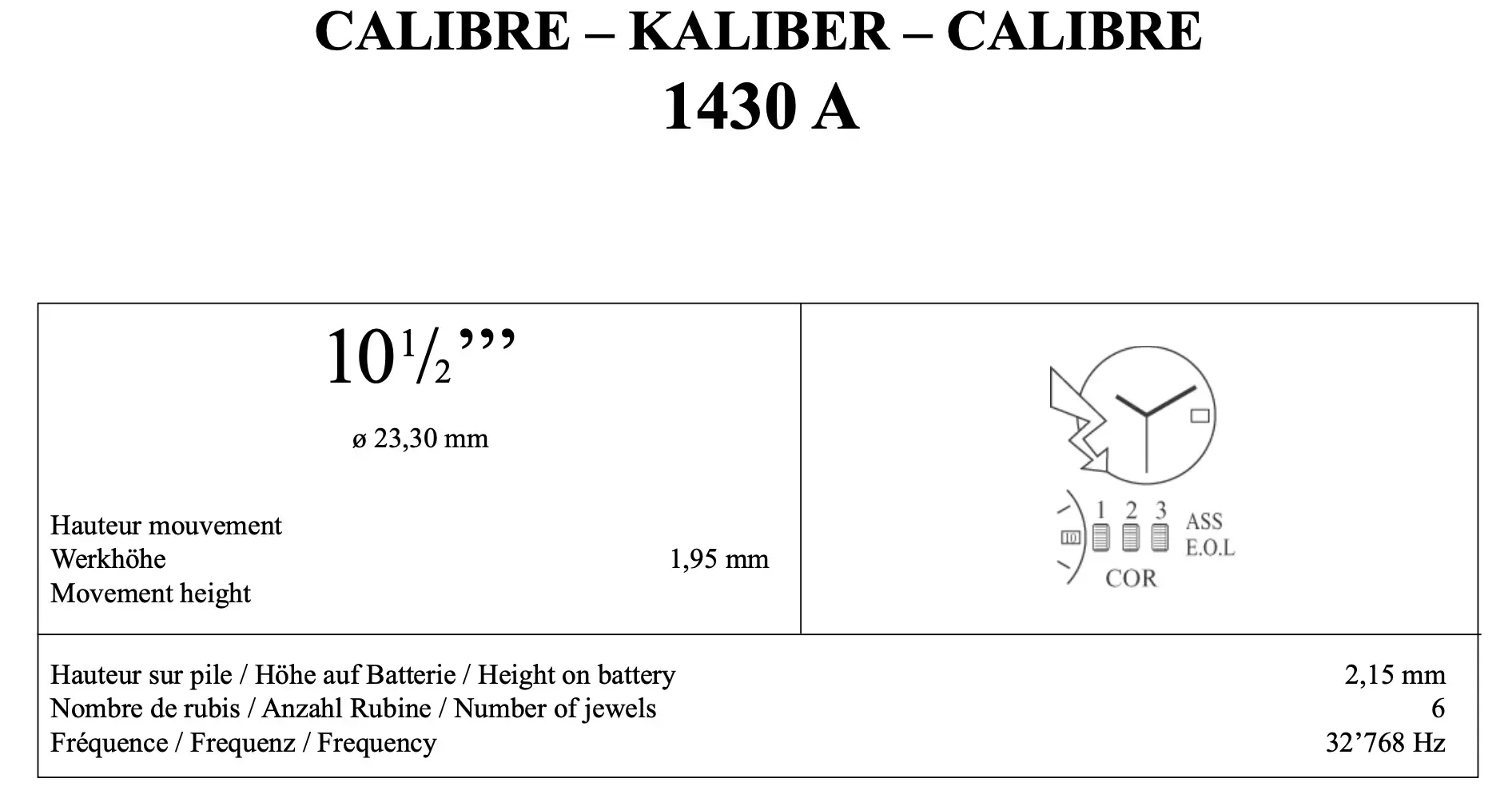

Sorry for the double post but I got my caliber numbers wrong. I have an older Omega Seamaster from the mid-1980’s that has a 1430 caliber and I’d like to replace it with a 1432 caliber with the identical dial. Are the 1430 and 1432 interchangeable? Thanks!
4
Thanks Jim! That’s super helpful and I’ll make sure to look for a 1430 replacement.
