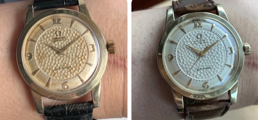

I’d like to transplant the innards (movement, dial, etc) of a 2577 Seamaster I have into another case of the same ref. Both are cal 354s.
One case is of the earlier variant without the beveled lugs, one the later with them. For comparison:

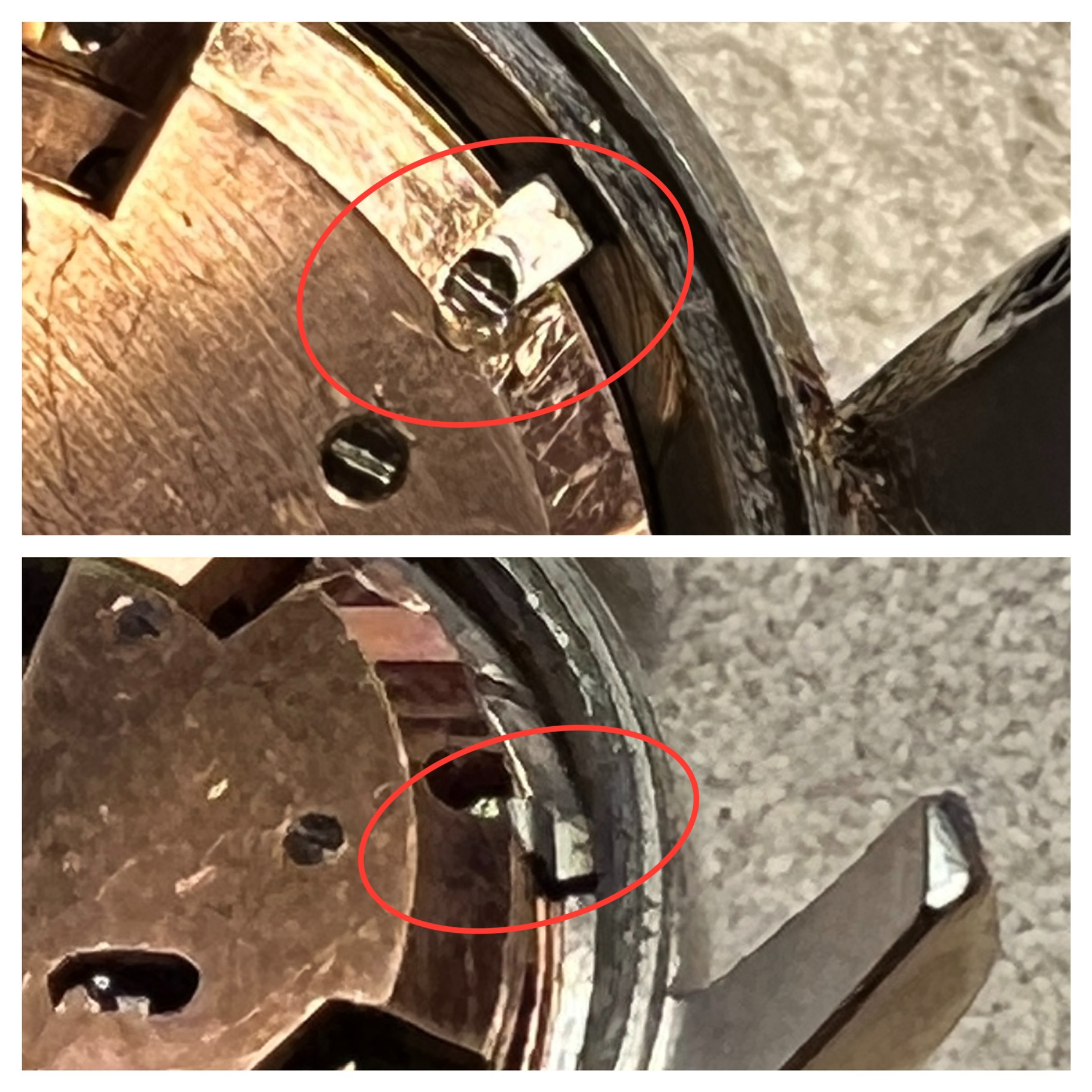

I spotted a difference in the shape of the movement holder plate, too. One is shaped like an S, one seems to be straight(er), not sure if that’s correct though:
(apologies for the bad lighting but I hope the difference is clear)
Question is: Were the cases interchangeable regardless of the shape of the lugs? I know there was a point in the serials of 2852s when they switched from one set of movement holder plates to another, so while I haven’t heard of it for the 2577s I couldn’t rule it out.

They should interchange.
Comparing a -8, early lug to a -10, beveled lug they both use a stepped retainer. I think the one in your first photo may be bodged.
The dial aperture is the same, 27.8mm.
BTW, this is a in hand observation, I took a movement from a -10 and placed it in the -8. Yes, I have way too many spare parts.

Iin theory, yes. I have swapped 2627 cases where one was a disaster and other was... less of a disaster? 😁
The watchmaker has the final word, but it's worth asking about.

The second point of fastening into the case, is a notch in the middle case, where that little pin in the mainplate should fit in. Have a look, if both are at the same place. By memory around 1-2 o'clock in the middle case.
The pin and screwed retainer position is in the the same location across the 3xx series of movements.

Thanks again gents, very happy with the result and the transplant went without a hitch:

Wow! So awesome to see a golf-dial.
Haven’t seen them expect in the book “From Seamaster to Seamaster”. They must be fairly rare?
3,595
13,551
You can find a handful of examples here if you search through the forum, but yeah, definitely a rather uncommon dial variant. My guess would be that there are fewer examples than of hobnails.
