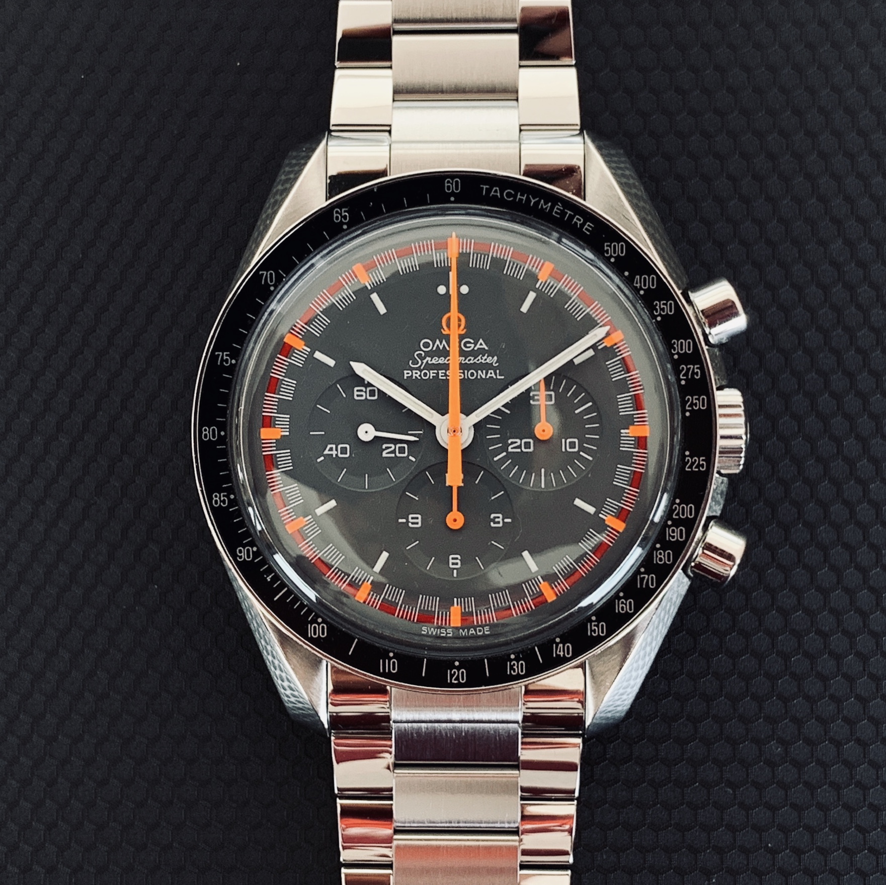

I've been wearing my Apollo 11 bracelet on some of my modern Speedies, but it also fits great on my 1990 Speedy Pro.
Did you make any modifications to the end links to fit it to the Speedy? What spring bar size diameter are you using?
No modifications required. I am pretty sure I used 19mm x 1.8mm spring bars for this watch. On my Snoopy, I had to use 1.5mm diameter spring bars due to the slightly different case thickness.
