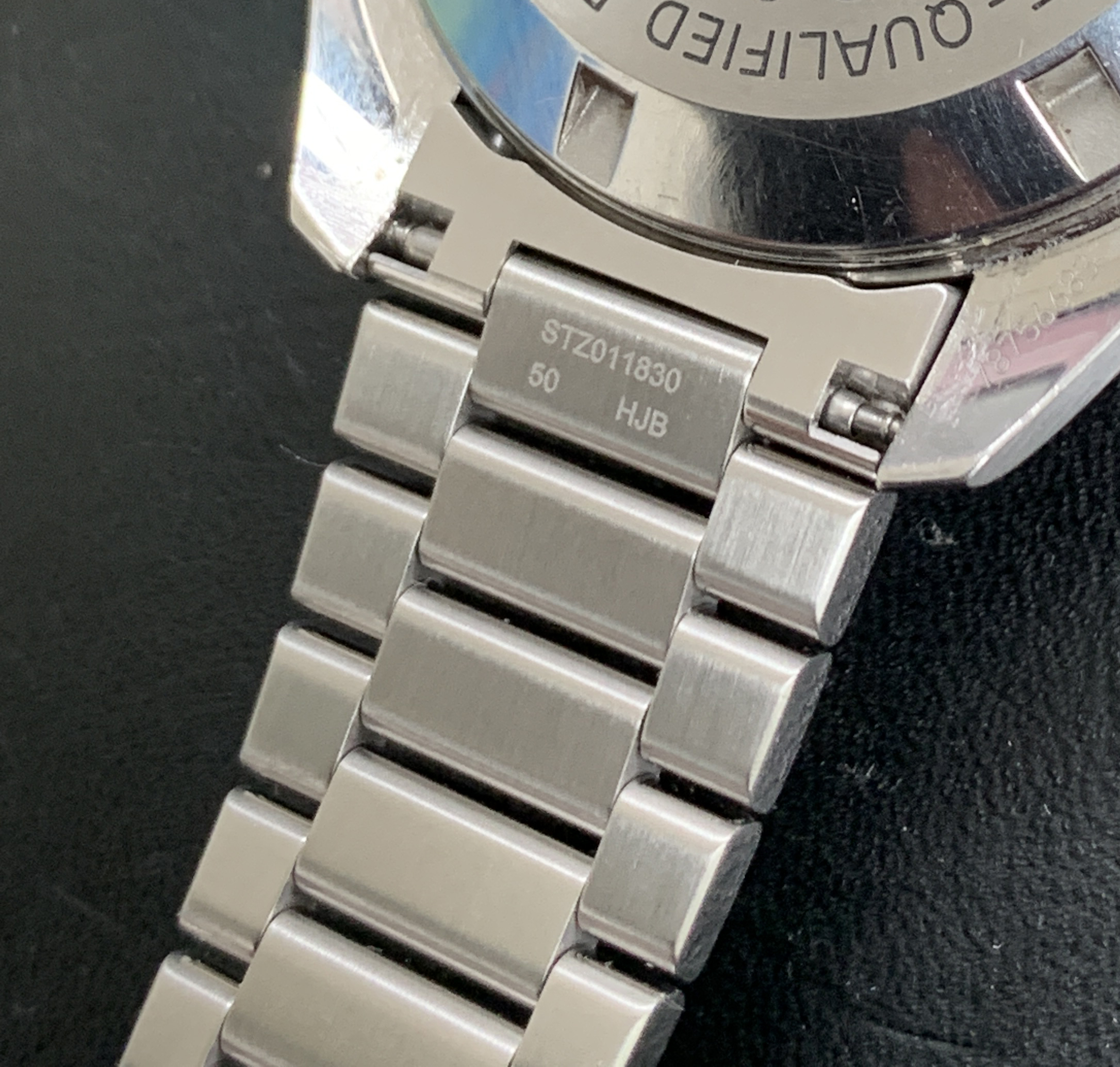

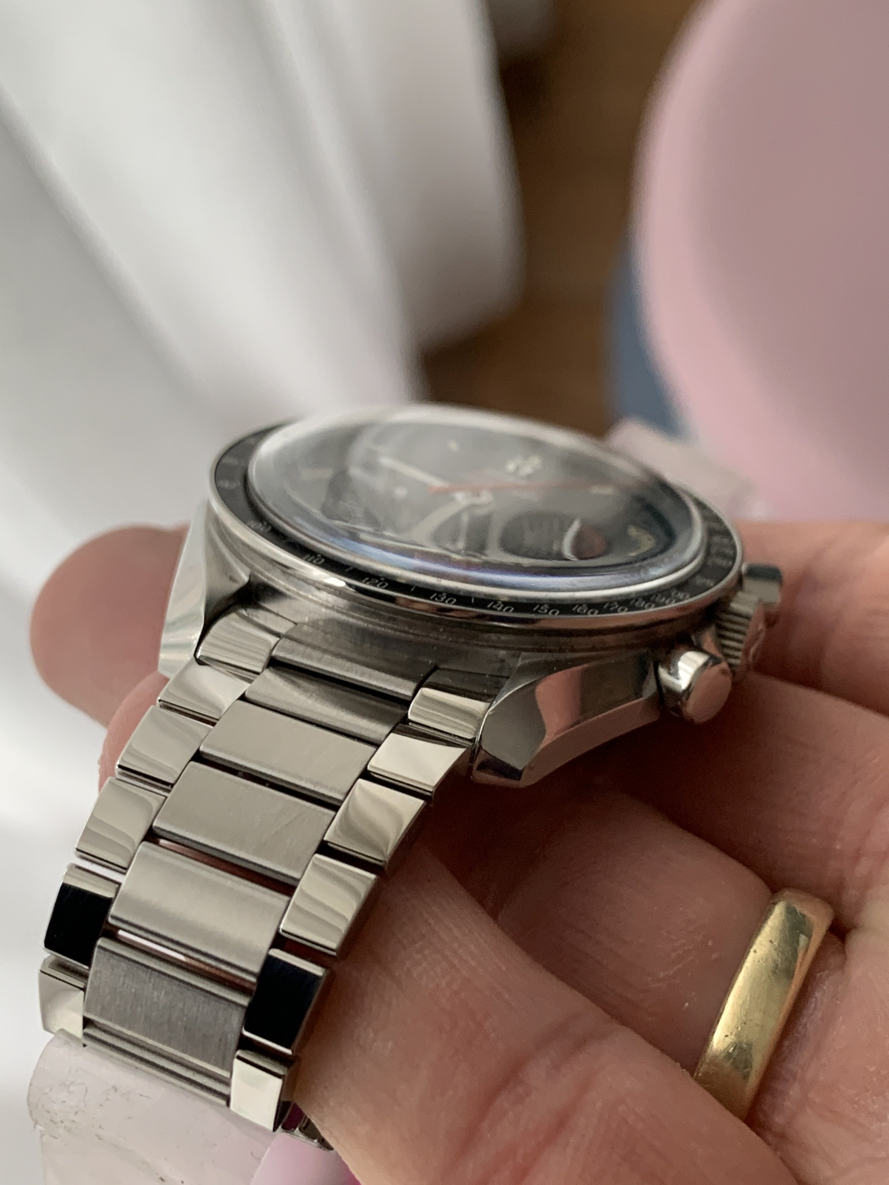

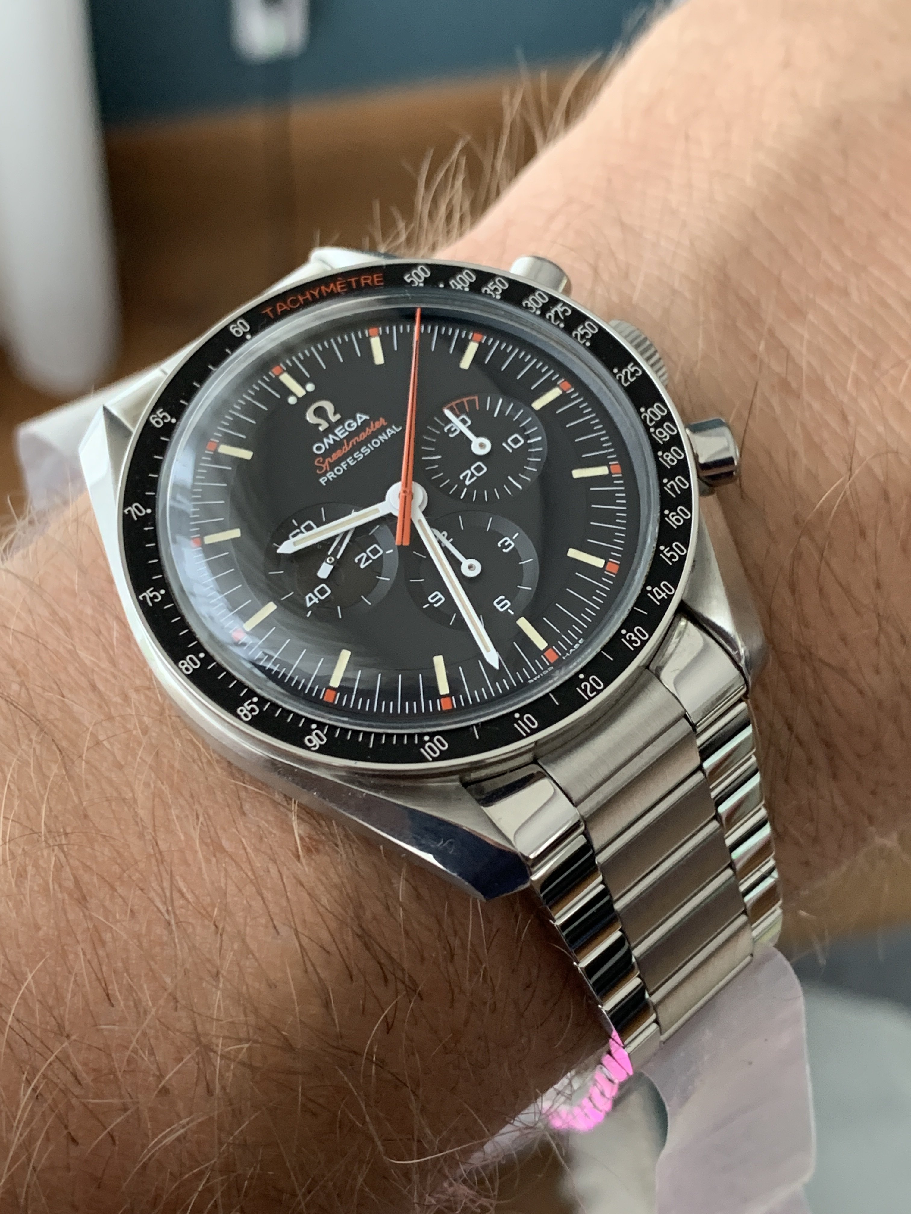

Hi guys, just to be sure: I've put the Apollo 11 50th bracelet on my regular 2017 Moonwatch and the Speedy Tuesday Ultraman with a regular 19mm spring bar. This spring bar was the thickest one I could find that fit through the tunnel of the end link. And no problem fitting it to these two watches. The end links sit very low, because the lip rests on the case edge.
So the trick is to remove some of this lip so the end links tilts/rotates upwards so it sits higher between the lugs?
Because I don't get this "thin springbar" part, because it fits instantly with a regular springbar (lets say 1.8mm?).

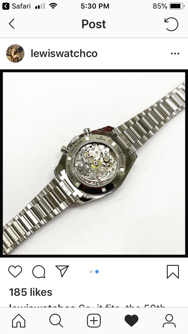

LWC claims he doesn't modify the end links and he likes how it sits lower just like the original flat end links. While others claim that lip has been filed....
Yes I need to clean the watches ;-)
That's the issue and that basically means it in fact does not "fit"

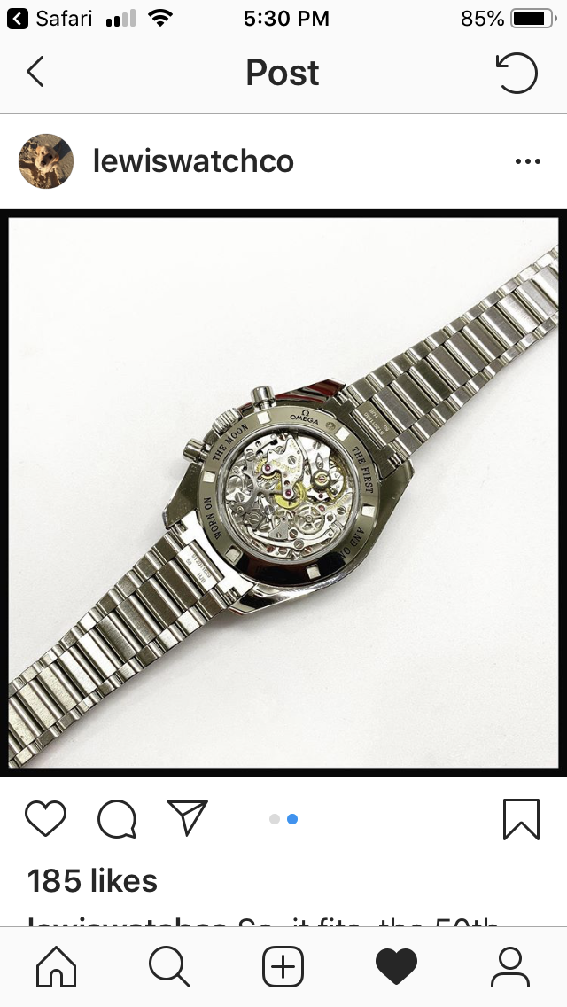

I've never heard this claim from him however in a past IG post he had multiple 50ths for sale that were ready or sale because he just finished "modifying" them.
I won't post others property but you can go onto his public IG and look 9 rows down for the answer to this claim.

Well that was my point. I just used a regular springbar that just fitted through the end link and the springbar was in place instantly. No thin springbars needed. A perfect fit? No! But it's a firm fit though. So that's why I didn't get this ongoing discussion with thin springbars. Ok, with older Speedmasters (lets say up to late nineties) you indeed need a thinner springbar because the lug holes are slightly lower. That's why for example 812 end links (1479 bracelet) will not fit a modern Moonwatch case unless you file the "side flaps".
Sorry, I was being unclear. I meant he claims he doesn't remove or adjust the lip (what else can you adjust on that end link...).
I guess we are allowed to link? https://www.instagram.com/p/B5FzddiHdGo/?utm_source=ig_web_copy_link
He states he doesn't remove the lip. And people who bought it from him state he did remove some of it. So I guess it's a big secret ;-)

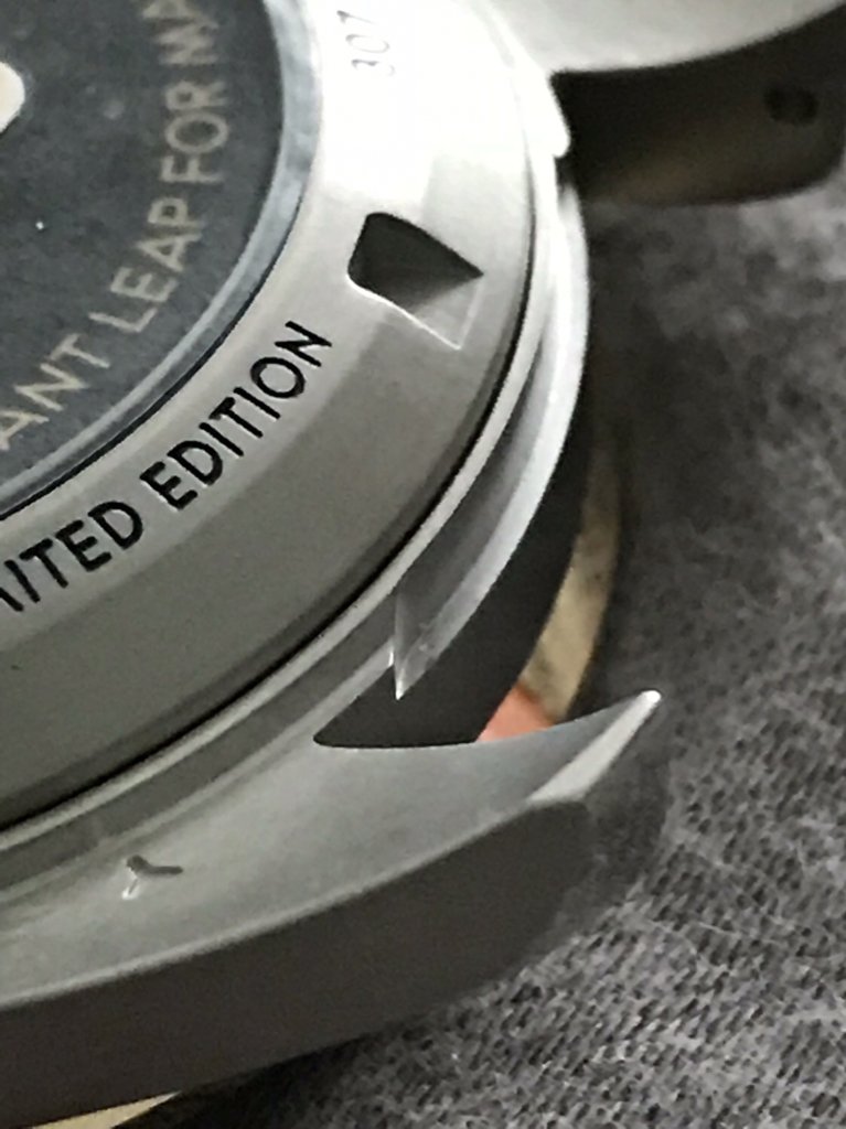

You could elongate the bar holes which would allow the lip to push against the case keeping the bars tight and the endlink in the right place. Not sure what would happen to the angle of the endlink. Would it teeter or would it stay snugly in place...... this would require a small endmill and a milling machine to do properly.
I only throw this idea out there because that's literally the only other thing that can be done to the endlink (I think haha) I have a modern speedy infront of me right now, without a bracelet on it and I have the 50th endlink off its bracelet mocked up to the case (with no spring bar in) The holes line up enough to do what you did with yours but the springbar hole on the endlink is off center with the holes in the case.

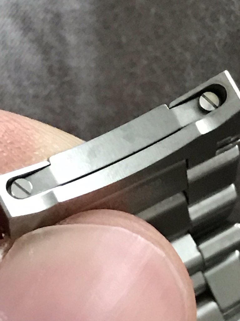

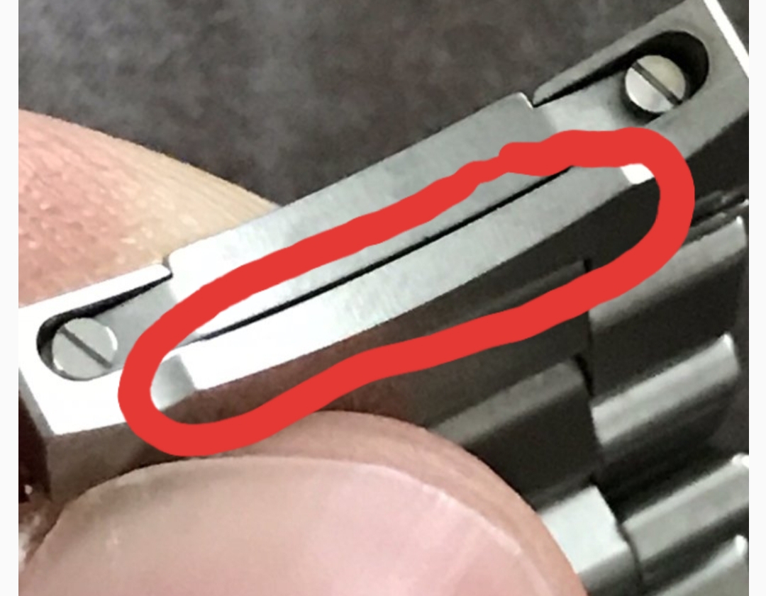

What if it was much simpler than we鈥檝e all assumed? I remember seeing these pics a while ago but couldn鈥檛 find them again till today. From these photos there is an insert in the end link that can be removed with two flat head screws. Maybe only this part needs to be modified? Reading LWC Instagram posts he says he modifies the end link but not the external lip. I鈥檓 almost certain this is what he鈥檚 doing, you can see how the end link fits much more flush on this Speedy that he鈥檚 demoing on. First photo is the bracelet end link, second is the actual case of the Apollo 50th, third photo is some hybrid that he鈥檚 built with white dial.
1,023
1,019
Those hold the inner piece to the outer piece. In other words the screws hold the brushed middle into the polished outer..... if that makes sense. The lip is still attached even if you remove this.
I circled the problematic lip in red
