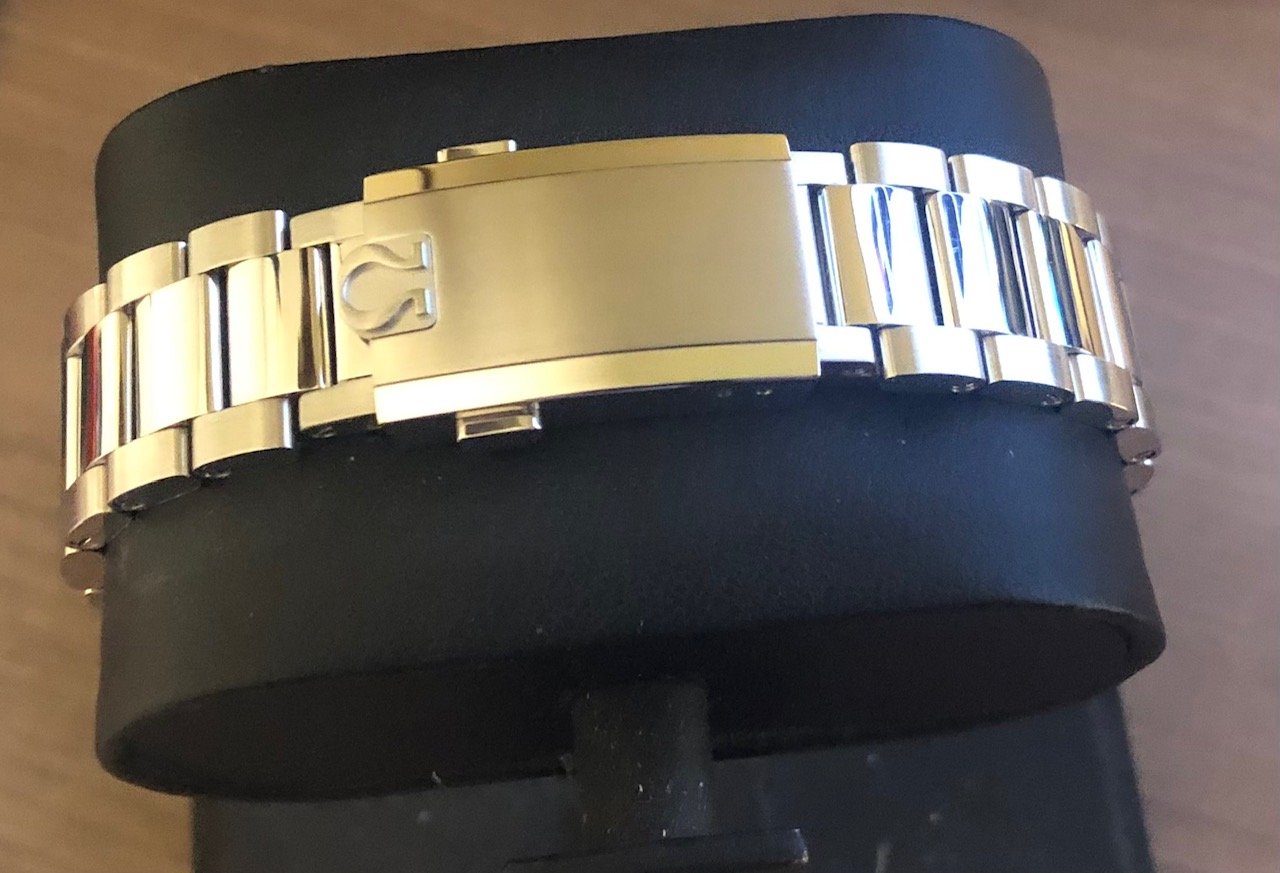

So I finally bought the Apollo 11 bracelet to install on my 38mm Aqua Terra bracelet. As I suspected, it fits with no alterations required.
I do not like butterfly clasps like the one standard to the AT and I also need at least one micro-adjust hole to so I can make the bracelet larger if I need to. The Apollo 11 bracelet accomplishes that. I'm also planning to drill a third micro-adjust hole to give me further flexibility. I don't know why Omega doesn't make this with three micro-adjust holes--there's clearly enough room to do it without inhibiting the clasp action.
I polished the center links of the Apollo 11 links and brushed the side links the match the AT. I'm going to leave the clasp as is because I think it looks just fine and I'd prefer to have the center portion brushed since that area of the bracelet takes a lot of abuse and scratching.
This was not a cheap alteration, as the Apollo 11 bracelet costs ~$700. However, this AT has replaced my Rolex Batman (which I sold) so paying this amount to make the watch perfect for me was not an issue. While I think you can buy just the clasp, I needed the links that connect to the clasp in order to make it work so I needed to purchase the entire bracelet.

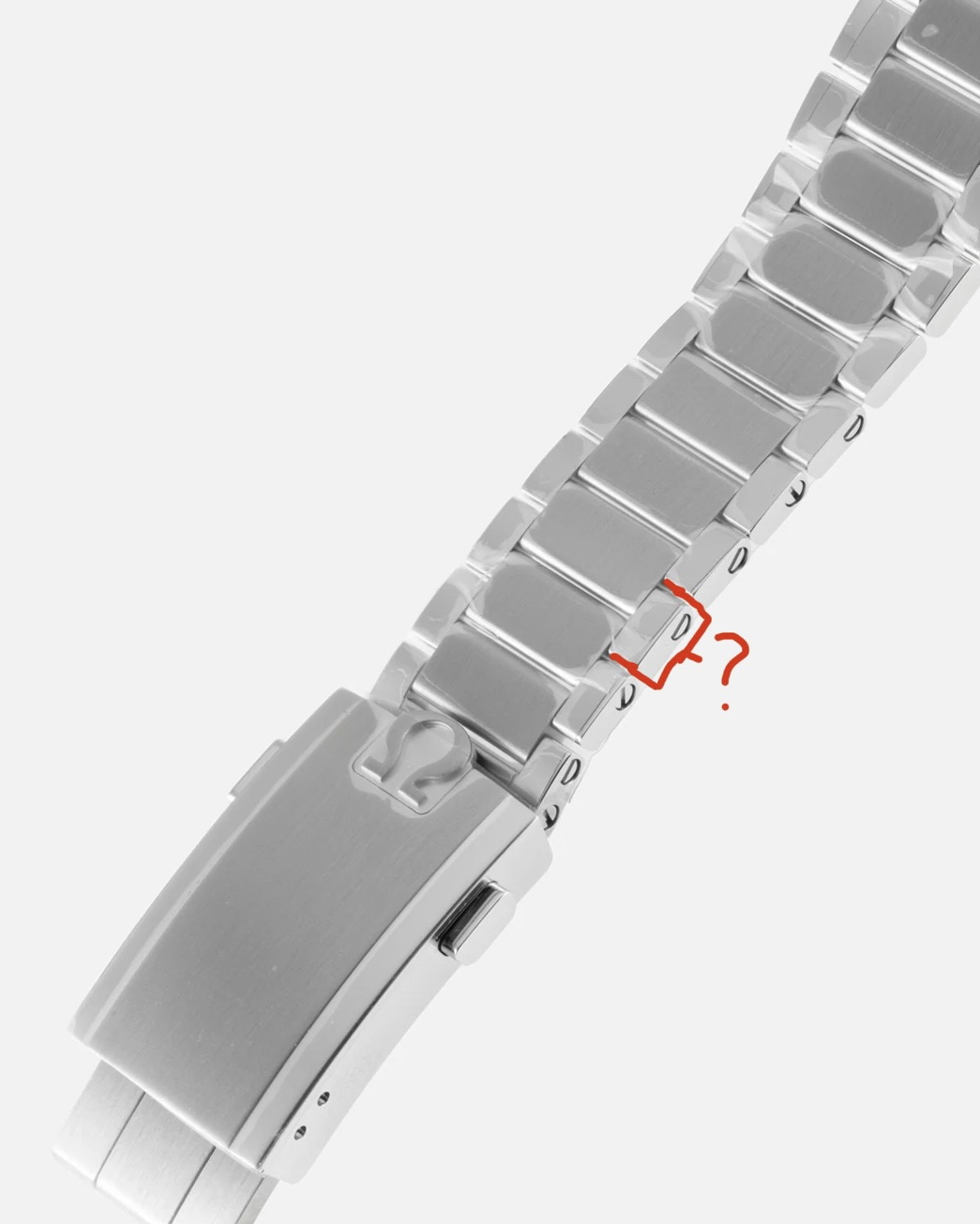

Can anyone who has this bracelet pls let me know how much length each of the sizeable links adds to the bracelet?
I’m looking for the measurement in the picture:
5,631
5,814
That is surprisingly hard to measure. Best I could do laying it flat and pulling to take out the slack, between 39mm and 40mm for seven links.
around .236" or 6mm per link

Thanks gents! Really appreciate it. I’ve ordered from the Omega service centre and will be getting them to size prior to sending.
In the event I have miscalculated how many links to remove and need to do some sizing myself. If anyone has a specific screwdriver recommendation (size, brand, link, etc) that works well for this bracelet please do share.
I believe a Bergeron 30081 is correct but dont quote me on that
5,631
5,814
1.5mm. The slot is pretty wide so you'll want a fat blade to match.
Or, if it's not right, take it to your local jeweler, who will likely do the job for free.
Regardless, take into account wrist size change over the course of the day.
