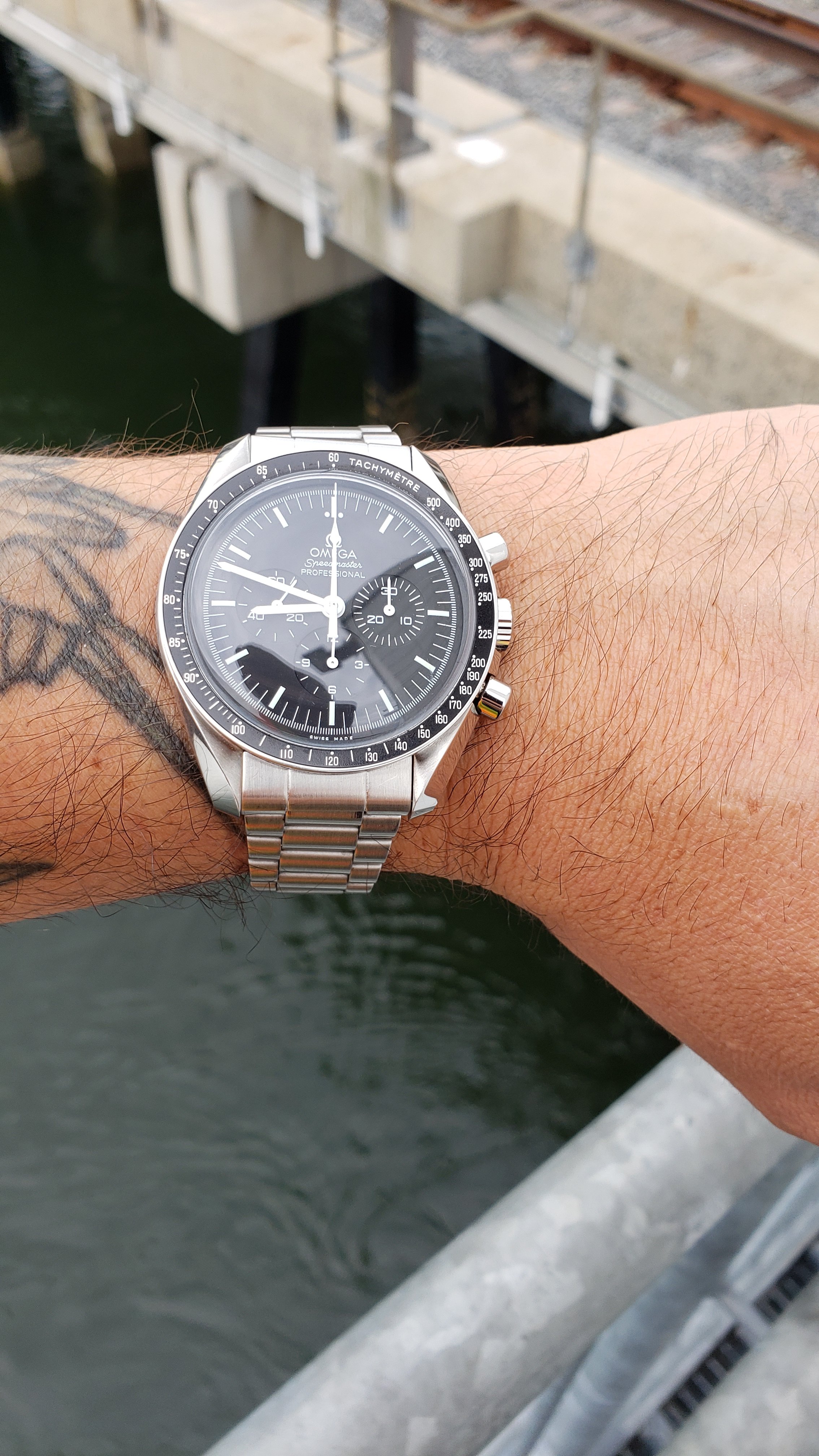

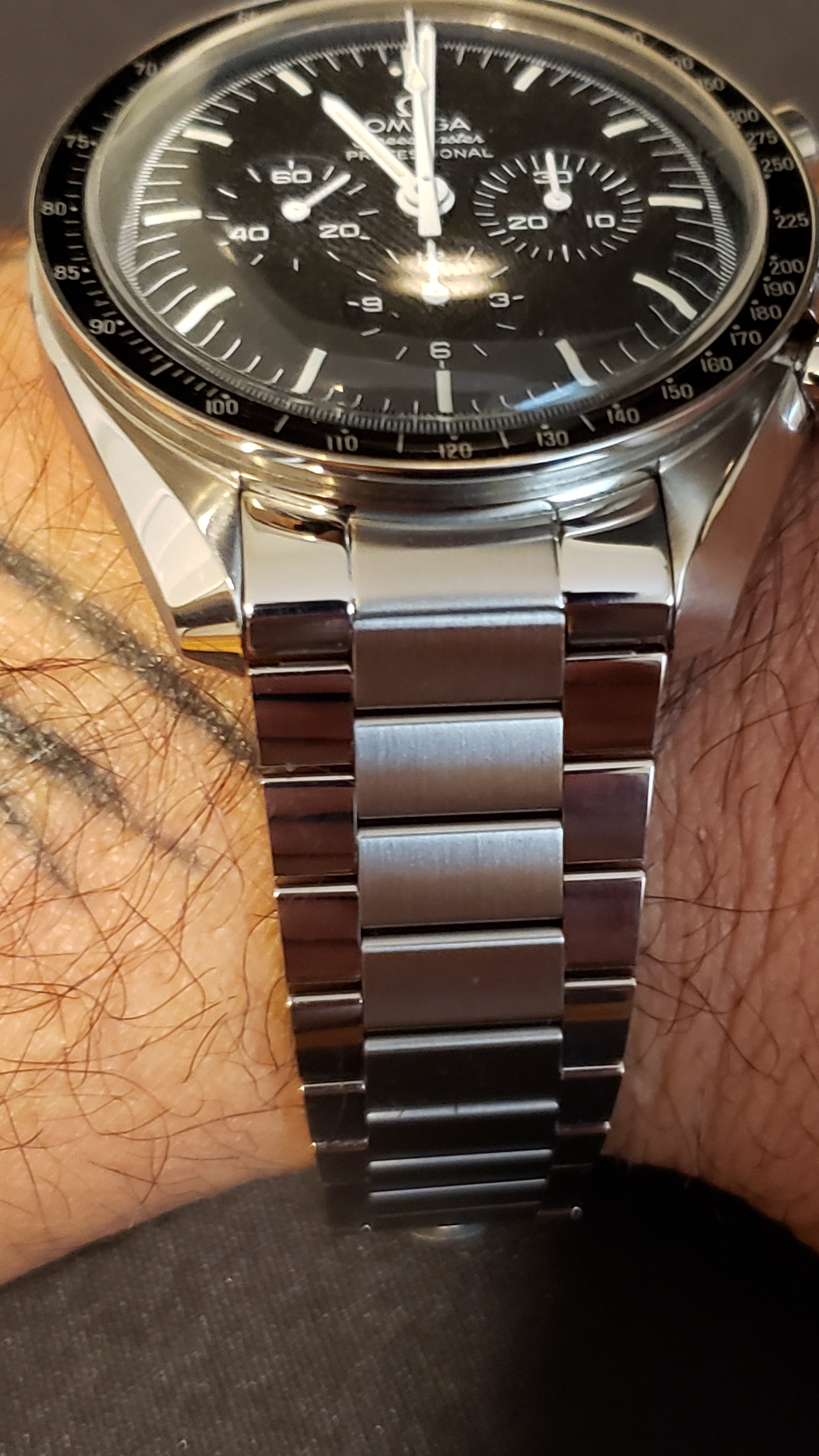

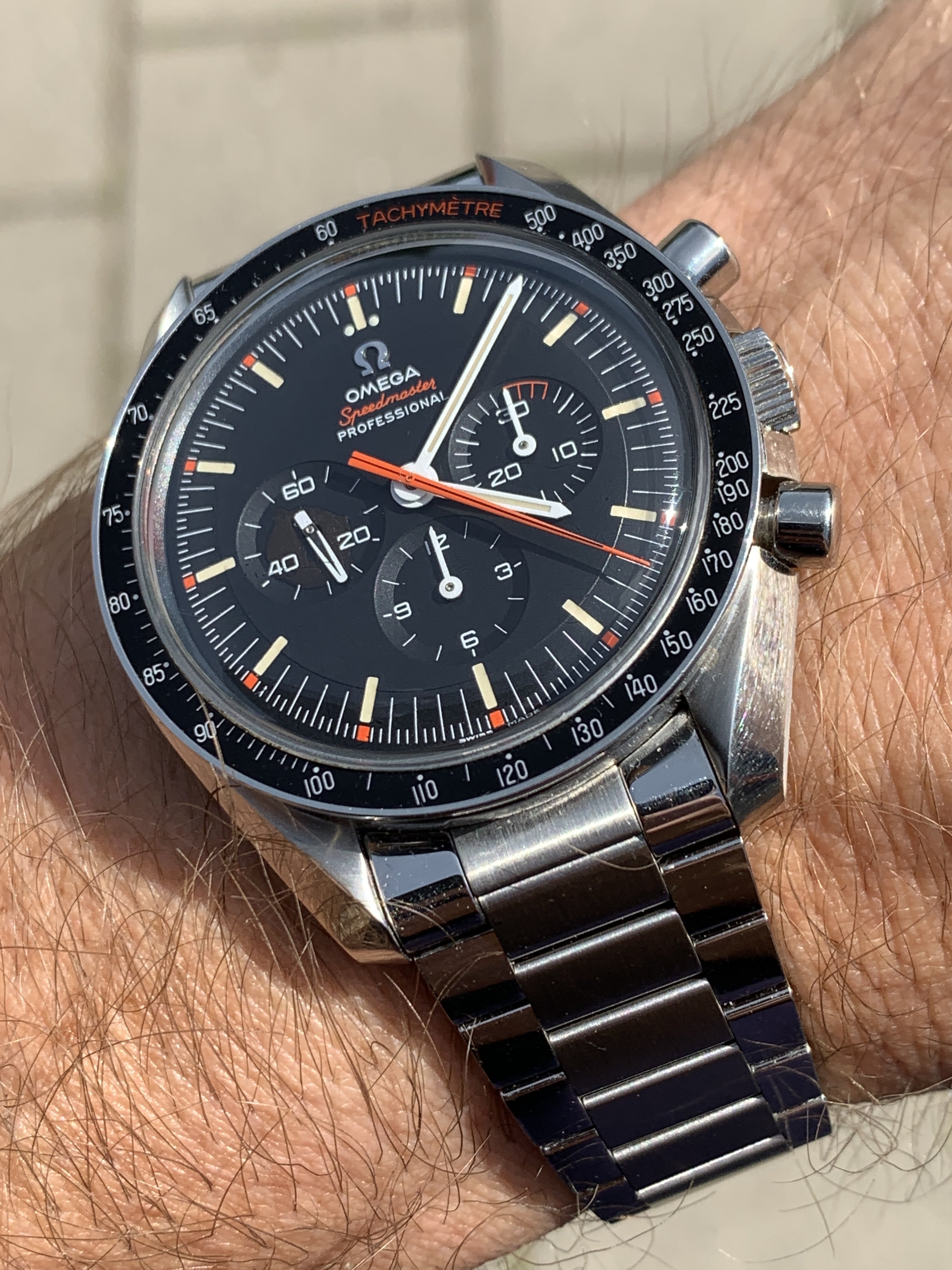

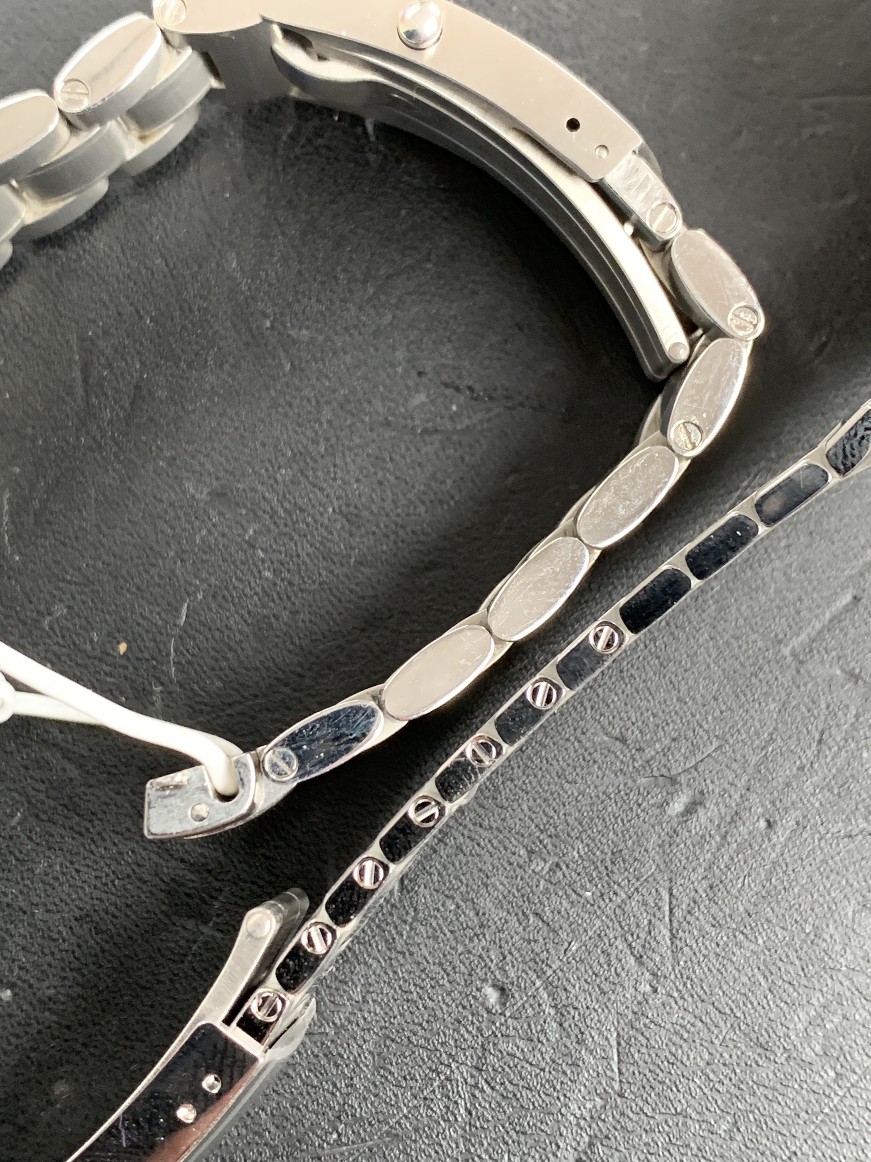

I've put the Apollo 11 50th bracelet on my regular 2017 Moonwatch and the Speedy Tuesday Ultraman with a regular 19mm spring bar.
Those are 20mm lugs, and I'd be really careful wearing that on 19mm spring bars....

Those hold the inner piece to the outer piece. In other words the screws hold the brushed middle into the polished outer..... if that makes sense. The lip is still attached even if you remove this.
I circled the problematic lip in red
Are you sure that’s the problem and not the protrusion caused by that piece screwed in? If you look carefully at the LWC watch I posted you can see that the lip is still there, it hasn’t been removed, yet the end link looks like it fits flush.

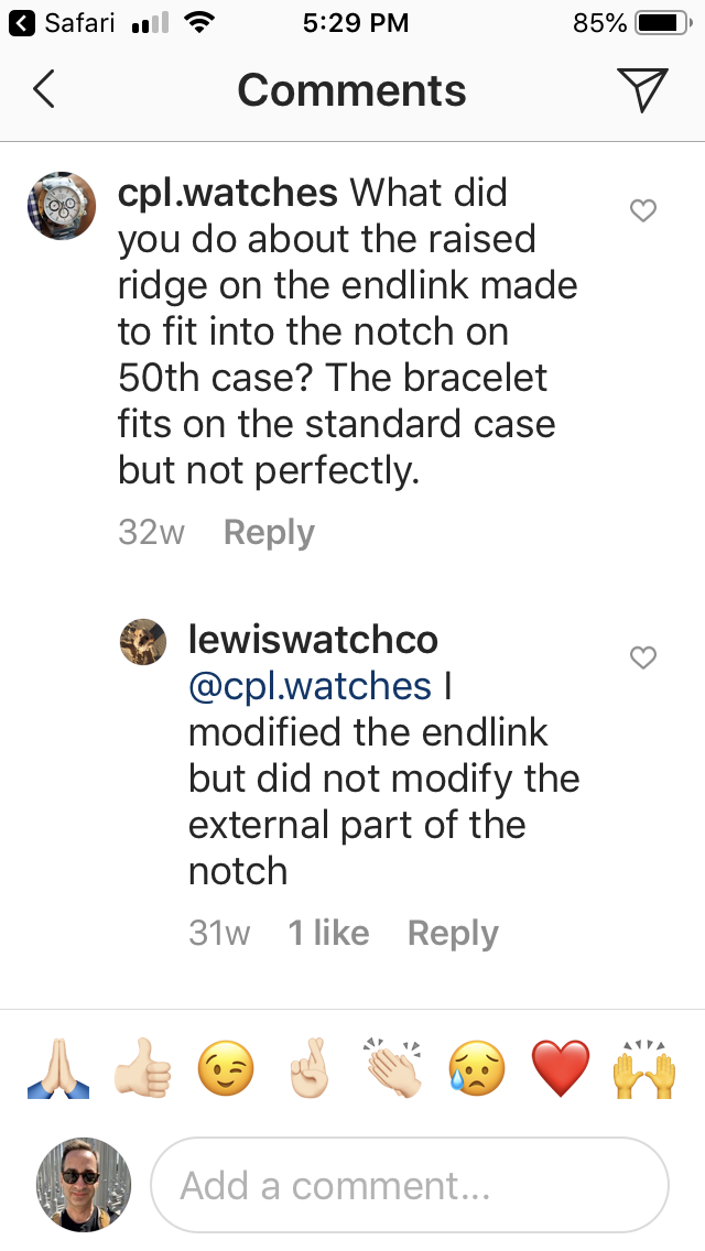

I only throw this idea out there because that's literally the only other thing that can be done to the endlink (I think haha) I have a modern speedy infront of me right now, without a bracelet on it and I have the 50th endlink off its bracelet mocked up to the case (with no spring bar in) The holes line up enough to do what you did with yours but the springbar hole on the endlink is off center with the holes in the case.
Good point and I indeed see the same here. The end link and the lug holes don't match up 100%, but it still works. Meanwhile I've spoken with a guy who ordered one and he requested not to share his photos nor give exact details (so I won't). But it all comes down to reducing the thickness of the lip so that the end link tilts up a bit. That would indeed require a very steady hand or a milling machine. So it's the same as with the 812 end links.
Yes it really comes down to that lip. The part you can remove (with the little screw) is recessed and doesn't touch the case. I'm not even sure why they made it like this. Perhaps this bracelet will become the new norm and they can provide a different piece to fit older type of Speedmasters (and the current Moonwatch that will replaced this or next year).
Anyway, now that I know the thickness of the lip is reduced, the comments of LWC make more sense. He did not adjust the part sticking out, but the height of it.

You guys are still under the impression that this removable part is the "lip".... it is not. This has no bearing on how the endlink fits the case. If you remove these screws the only thing that will happen is the endlink will break down into two pieces, the brushed and the polished parts. It's a weird way to make an endlink I'll admit so I understand the confusion

That's not what I mentioned (or tried to mention lol).
Because it's made up out two parts, one part ofcourse includes that lip and can be replaced with another part (theoretically) without having to provide two finishing techniques. Not sure why it's 300% overengineered otherwise. I wasn't talking about replacing only that lip, but the complete part it's attached to. The lip is part of the brushed link element.
Anyway, I just measured the thickness of the lip (with a plastic caliper....) and it's around 1.5 to 1.8 mm thick. So filing off 0.5 mm will just create a better fit for older Speedmaster, but will not make a big difference optically.

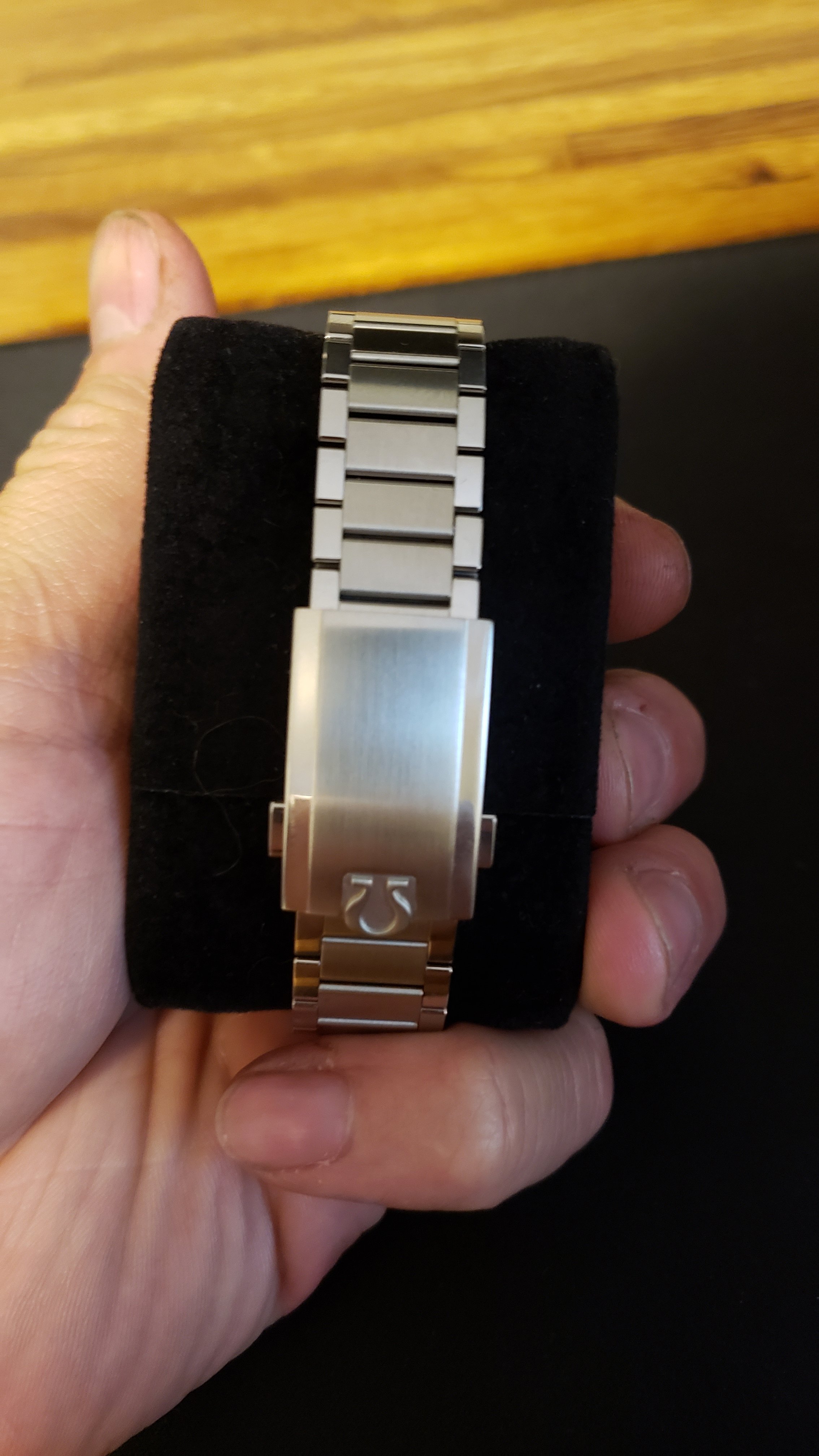

It's way more comfortable than the 1958 bracelet, which you will find on the current Speedmaster Pro Moonwatch. The links are much shorter and it wraps around your wrist way better. The lack of proper microadjustment is a shame, but so far so good.
1,023
1,019
It has the 1/2 link of adjustment in the clasp at least. I can get it good enough with link removal/addition to the point where that half link adjustment takes care of summer swell or winter shrink Haha.

For anyone still looking into this for their non apollo 11, I've been informed by a boutique technician that it can be done without modifying the endlinks and instead by using a slightly thinner spring bar. Said it had been done multiple times without issue so far.
795
1,159
Of course s/he would say that. That is the easiest way out for them but I wouldn't suggest you do that.
Using a thinner spring bar on a steel bracelet is a no go for me.

I feel like this issue is solved with the introduction of the @Uncle Seiko flat link but I just came up with the most simple solution (which is usually the most overlooked) Just use the 50th bracelet with a set of Uncle S's endlinks...... problem solved. Hope this helps those of you who prefer a heavy milled clasp like on the 50th. If the old style clasp doesn't bother you then I'd just keep about $630 bucks (USD) in your pocket, and grab the Uncle S. flatlink all together.
