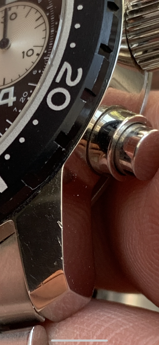

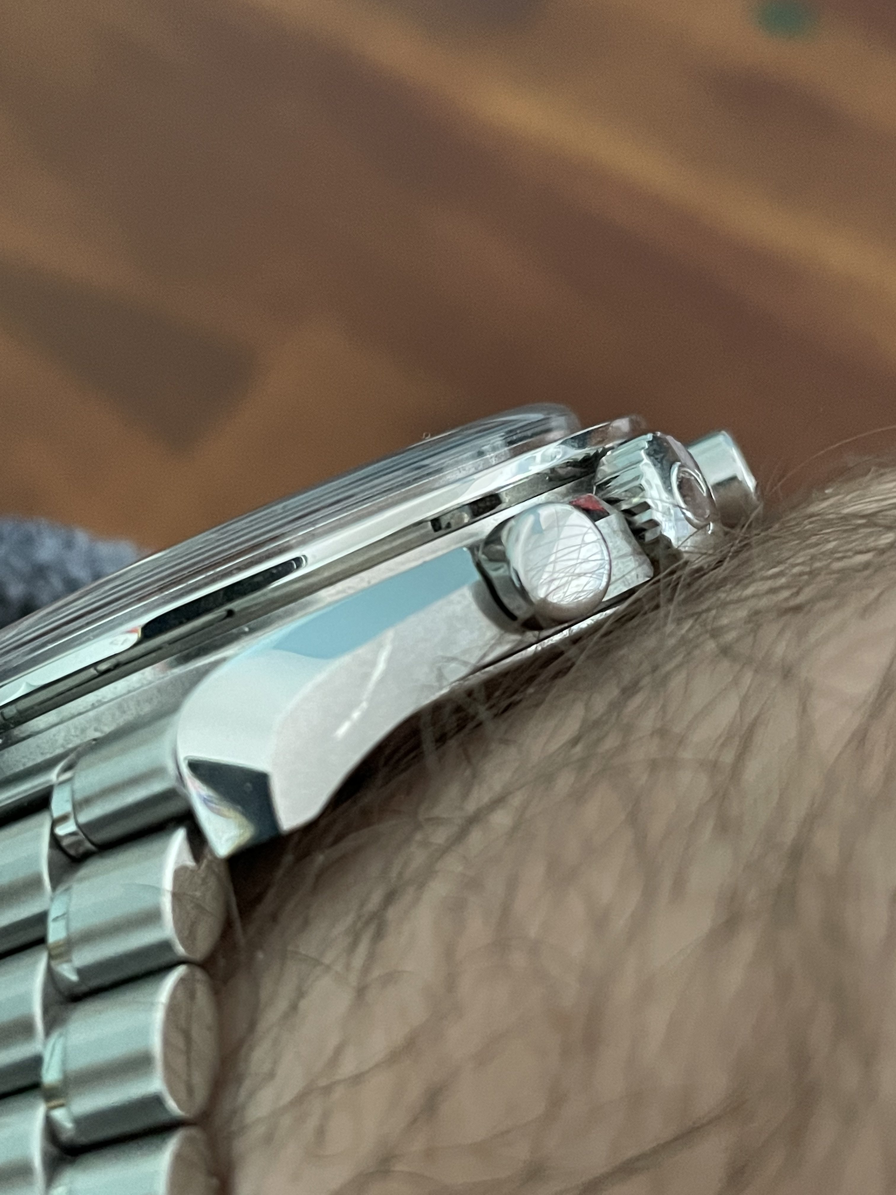

Anything I can do about this scratch?

New scratch on the brushed side of the case on 3861 speedmaster (steel). Anything I can do?

You can have it polished out, but it is only a matter of time before it gets scratched again. The first scratch on a new watch is always bothersome... give it a few days and it likely won't bother you anymore.
If I were you, I wouldn't do a thing. Just enjoy the lovely watch!

four choices.
1. take any abrasive pad and apply it until scratch is gone. pros - cheap, cons - so many things to eff up.
2. visit any watchmaker or jeweller with lapping machine and ask to fix it. pros - scratch will be gone. cons - I have no idea how it affects warranty, will cost you some money.
3. send it to Omega approved watchmaker or service center and ask to fix it. pros - watch will be like new. cons - will cost a lot of money, because of they might insist on full service.
4. most sensible option - do nothing. your watch will pick up more scratches sooner or later, learn how to live with them. You can fix them during first service in 5 or whatever years.

Remove the scratch with fine Scotchbrite after you mask the polished areas with painters tape. Work in one direction only rather than rotating the Scotchbrite.

Leave it and have it fixed at service. I'd recommend you don't try and brush it out yourself. You don't want to mess up the grain and direction.
Using scrotchbrite or similar approaches on the satin finishes found on many Omega cases (as opposed to the finishes on the bracelets/clasps) has typically not resulted in good results in the past. I've found these brushes from Bergeon to work fantastically, however. Much better control and I find the finish more consistent.

Even with improved control with the Bergeon brushes, I'd still mask the polished areas.
+1. Dampen the pad first with water and then wring it out. Rub GENTLY with the grain using only enough pressure to remove enough material to get below and remove the scratch. Take your time, stop periodically, clean the area with a clean eyeglasses cloth moistened with a bit of lense cleaner, and then resume with the Scotchbrite pad if the scratch is still there. Stay away from the polished surfaces, edges and chamfers of the case. The Bergeron brush is also a good suggestion. If in doubt, have a professional do it.
Oh, absolutely! But as I said, it's more about the finish. The ability to temper the stiffness of the bristles as well as the control of it makes a world of difference on that satin finish. For something like the clasp, which is more of a true brushed finish, I feel the pads are terrific.

Thanks everyone for the suggestions - I might try and brush it at some point when I'm feeling brave. Annoyingly I have only had this a couple of months - I had my last watch (Tag Heuer) for ten years without even the faintest of marks on the case despite never taking it off
http://www.ofrei.com/page251.html
Which brush is right one to duplicate the Omega brushed finish? There are four listed. I'm going to get one. Thanks
The 2834c is going to give you the lightest touch when extended. That said, I have not been able to replicate the satin Omega finish, but my results have been better than leaving a scratch or using scotchbrite
