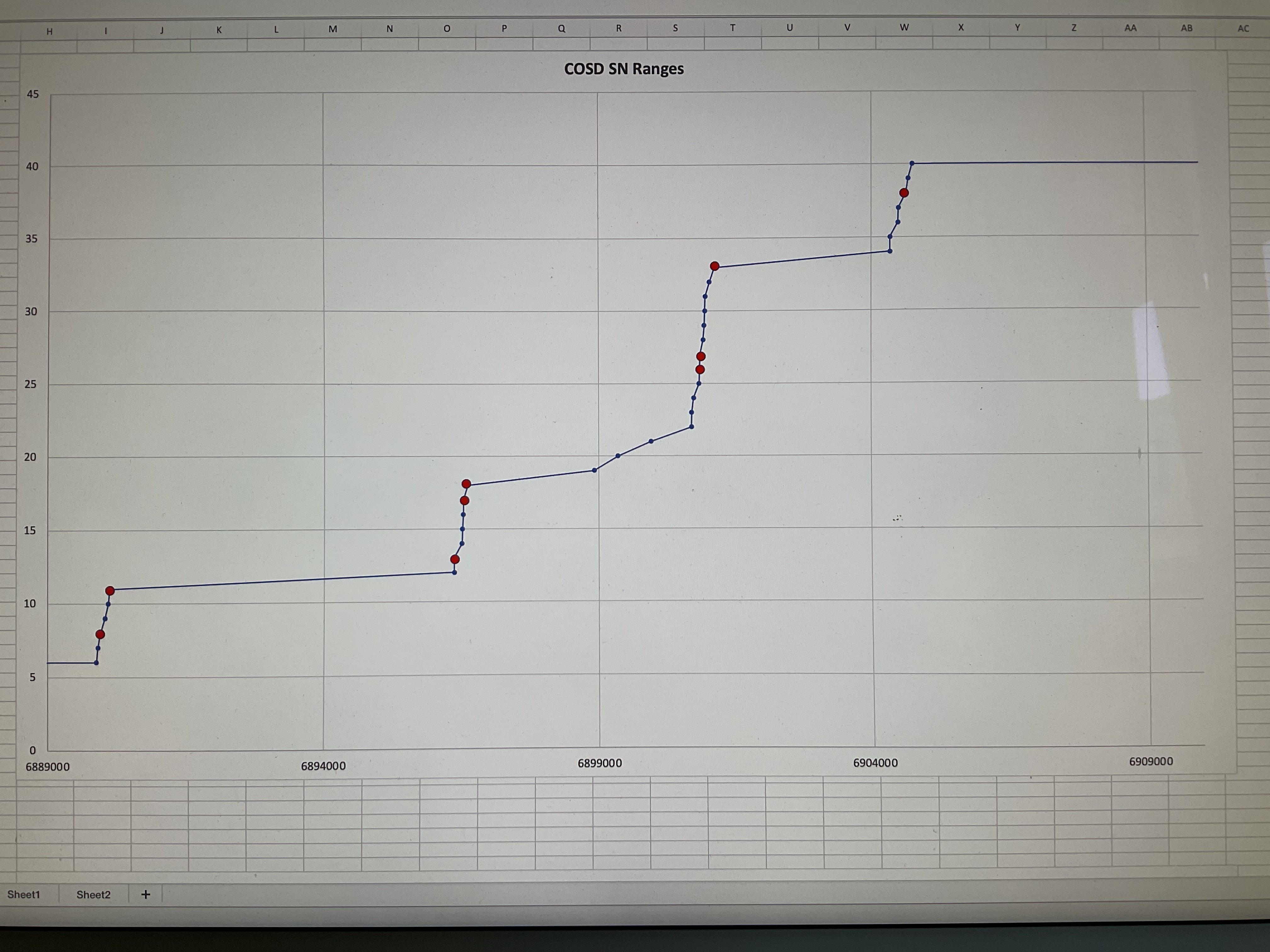

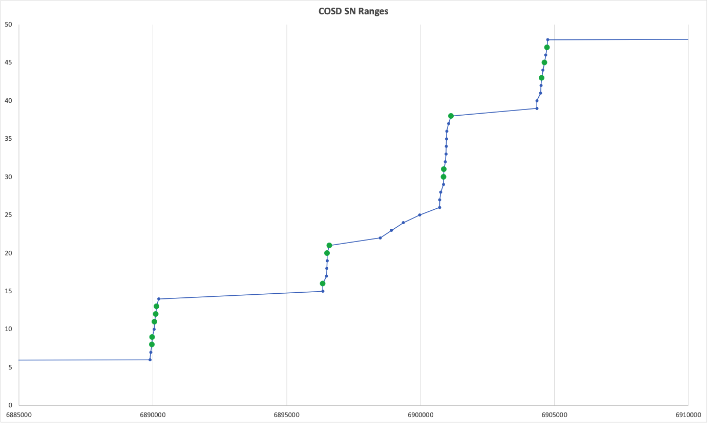

It only supports the premise that the serial range is correct. Not that all the members of the correct serial number range data set are correct. It's fine graph by the way, but again, only good for showing the data clusters.
2,597
5,666
It only supports the premise that the serial range is correct. Not that all the members of the correct serial number data set are correct.
I think it strongly supports both, but proves neither.

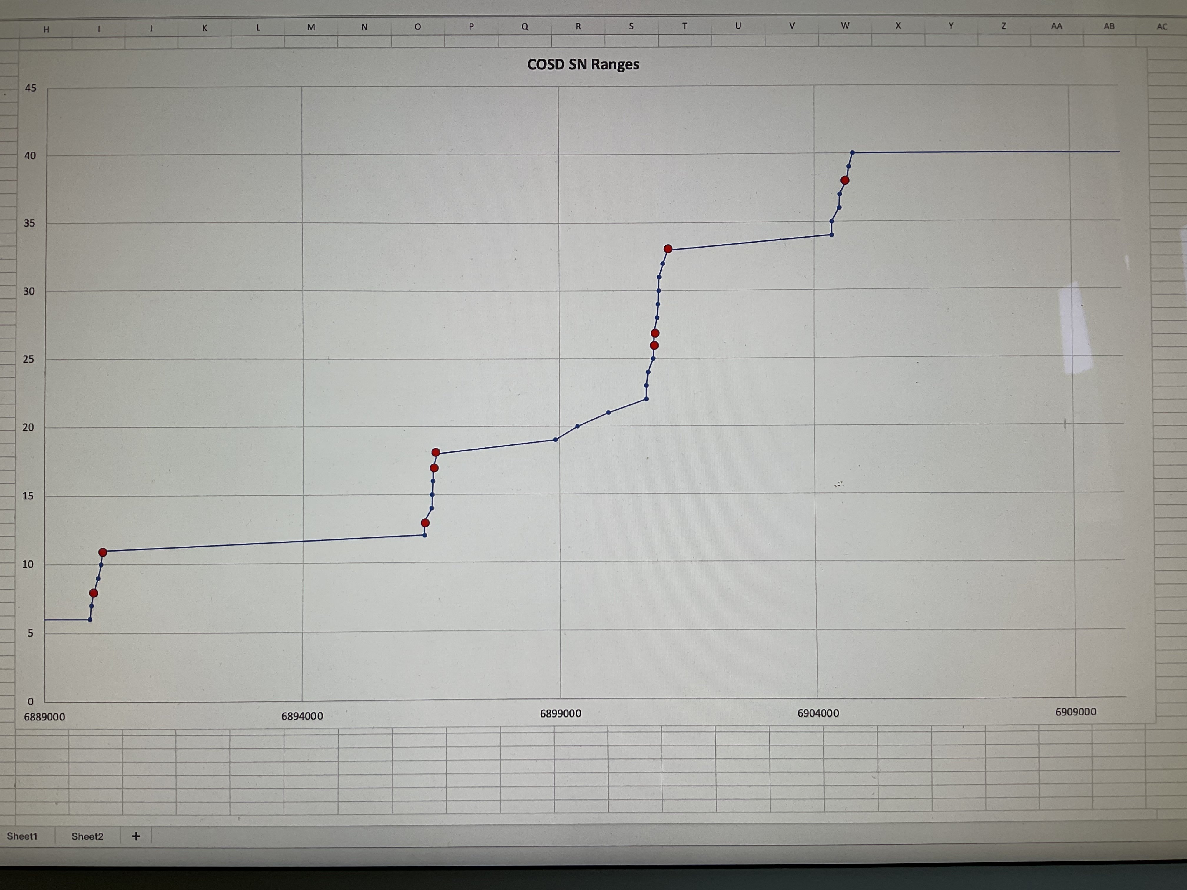

I’ll have a play this evening and highlight where the fifteen watches with extracts are. I think if there are multiple correct extracts in each of the four blocks, then there’s really strong support that those four blocks are somehow correct.
2,597
5,666
Sorry I’m useless at waiting. I’ve just highlighted the points in my plot that have “yellow” extracts in your spreadsheet. I haven’t updated this for over a year so a few are missing, but certainly all four blocks have at least two watches with extract.
If we take these red dots as being “good” (they are watches with “good” extracts), then I see strong support for the statistical hypothesis that there are four “good” ranges.
1,530
4,435
Yes, I like your hypothesis, now you just need to verify it with several extracts for those ranges that we don't have and extract for to see if it is true since that is about the only thing we can do without an actual photograph of those pages from the archives.

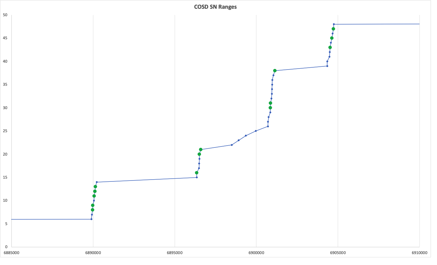

Here is the updated chart. Highlighting the ones with "good" extracts in green seems to make more sense than red. I've focused on what appears to be the area of interest for COSD movements. Off to the left are a bunch of 6b/159 serial numbers.

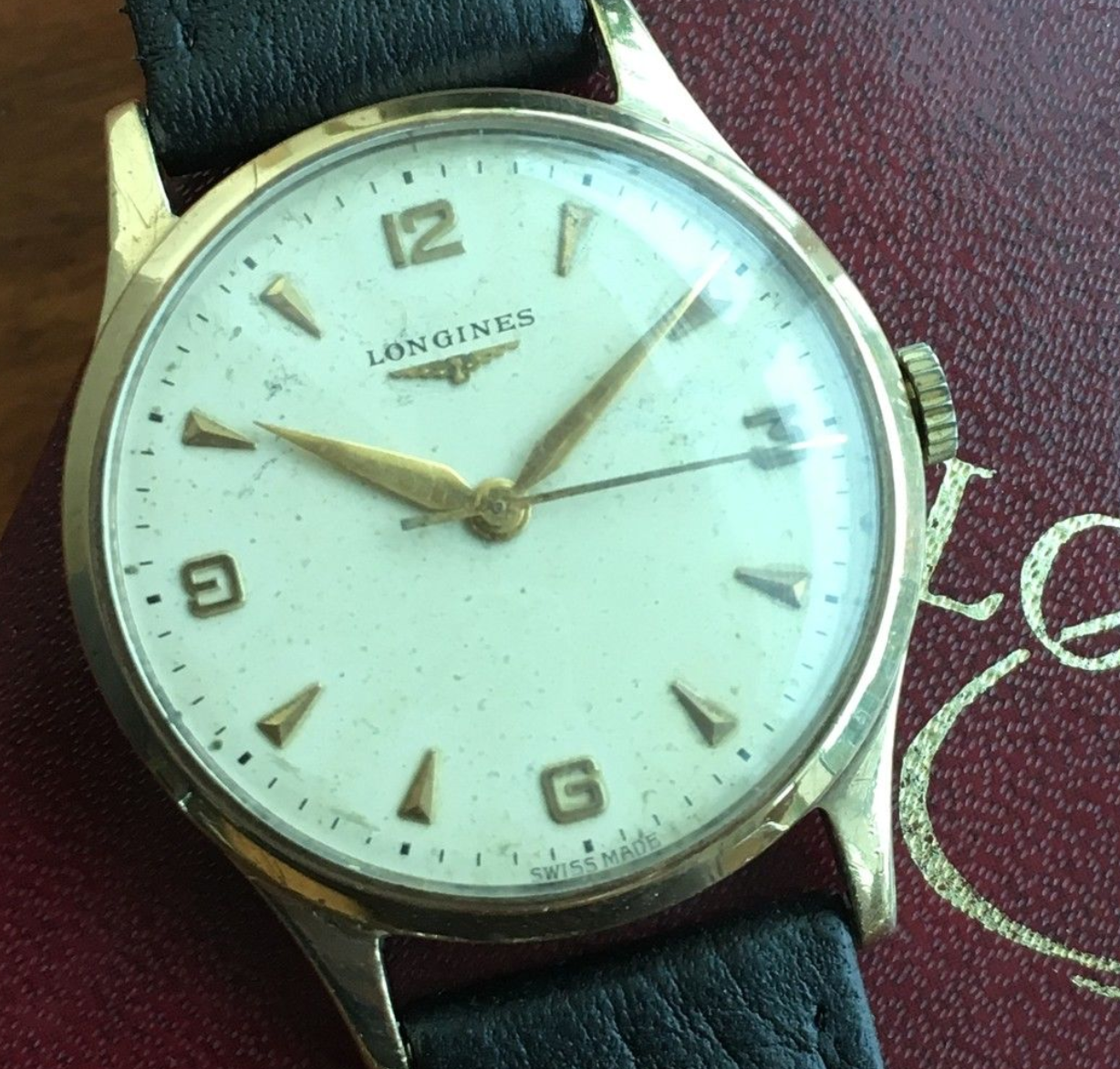

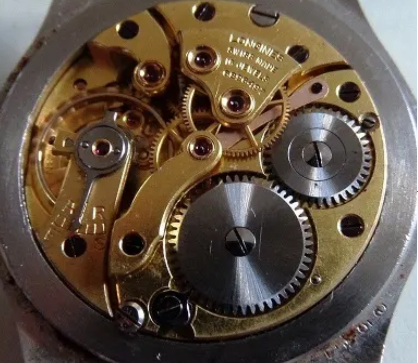

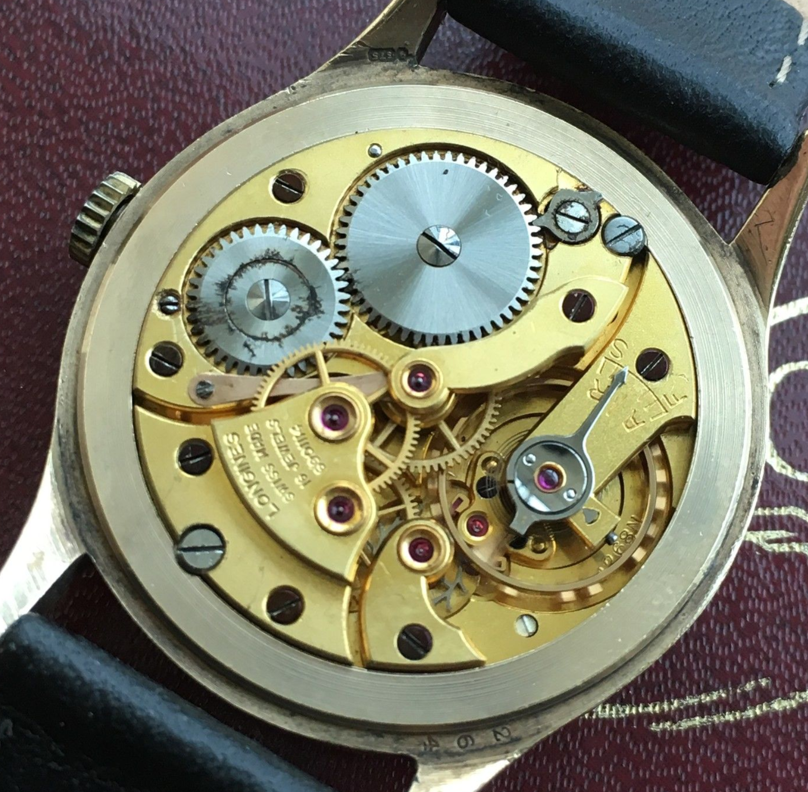

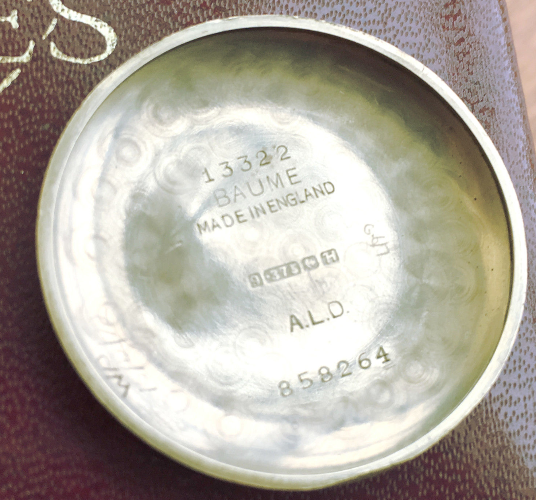

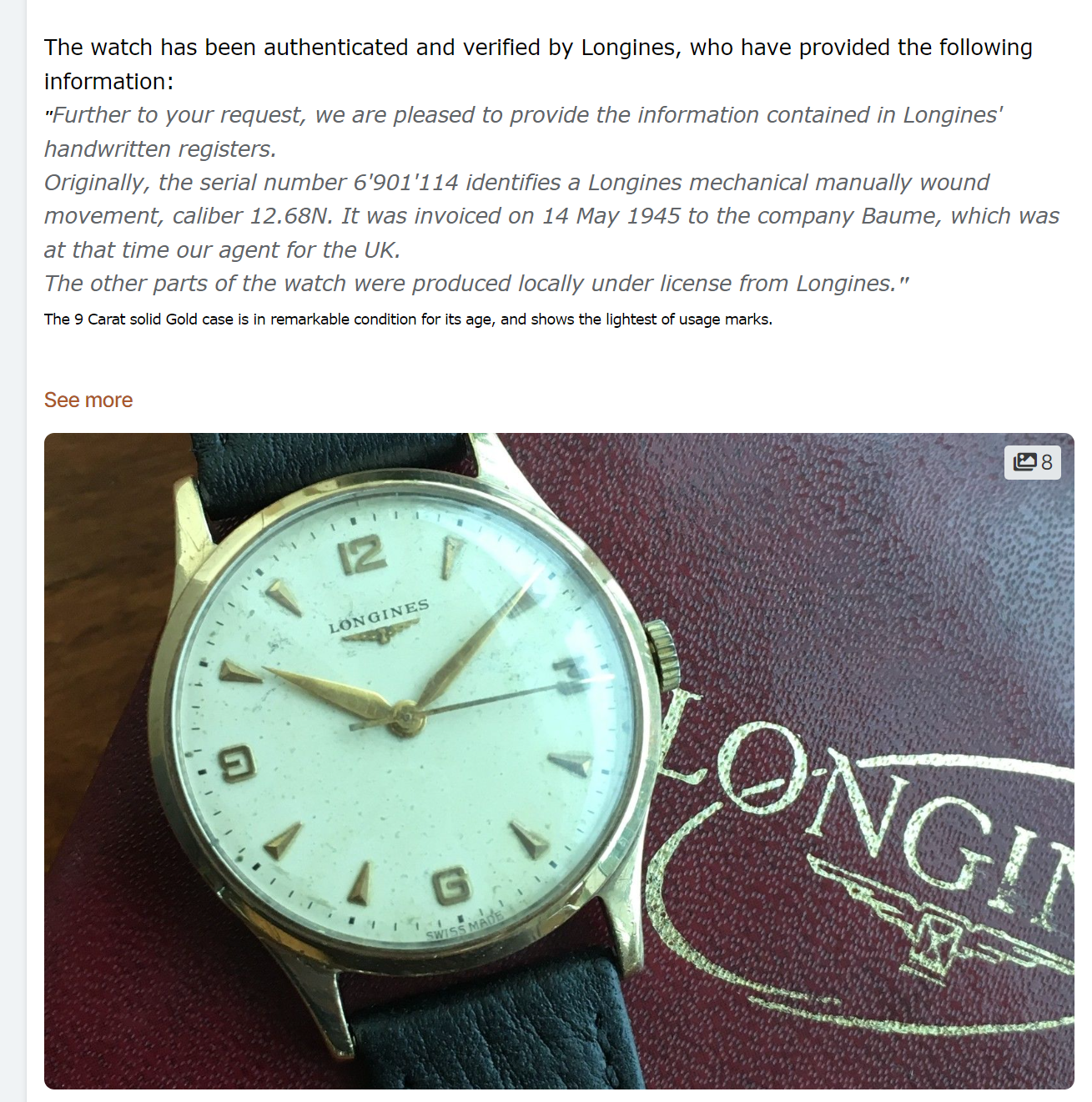

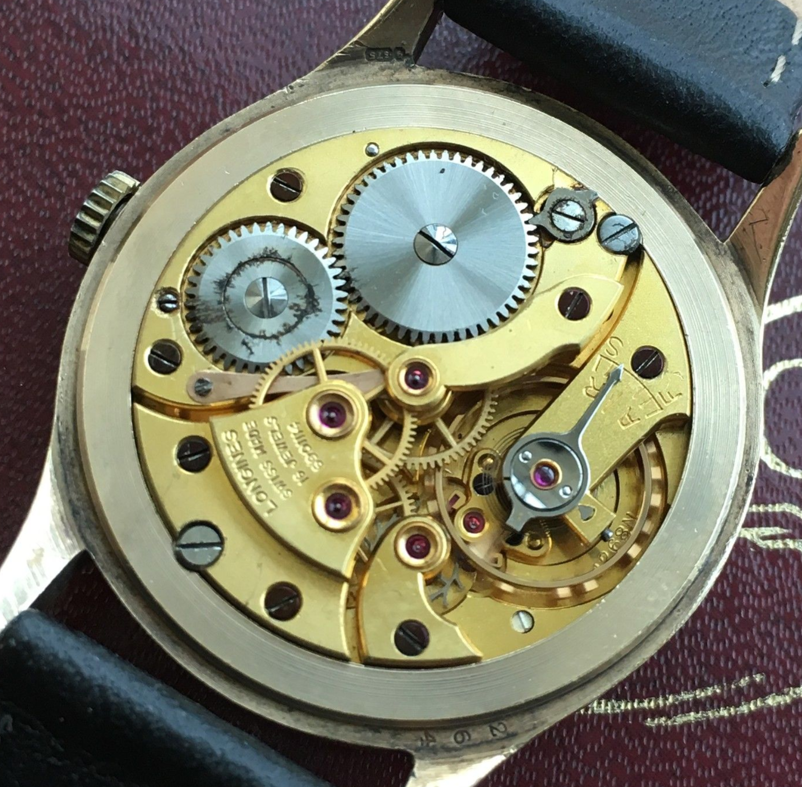

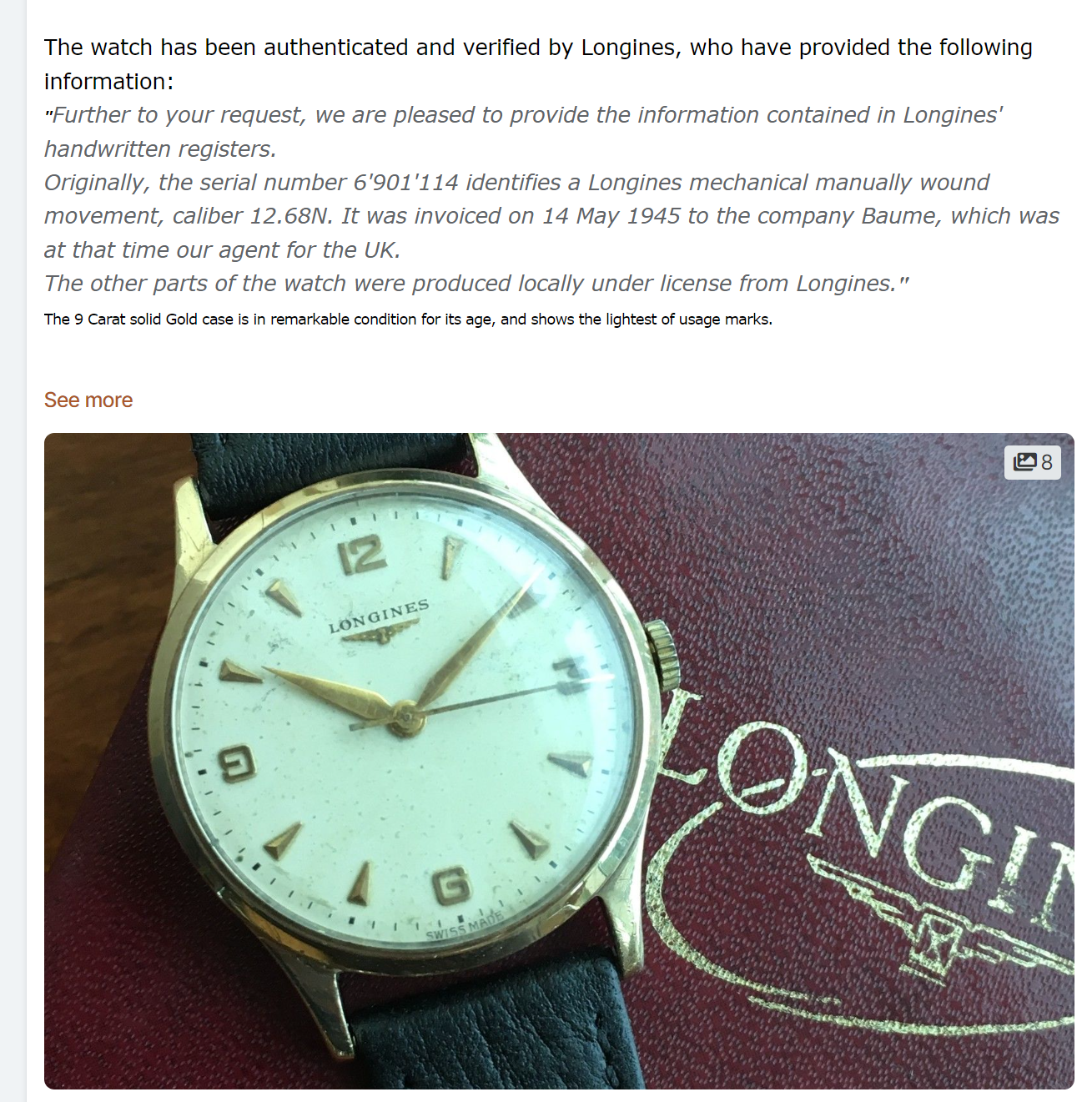

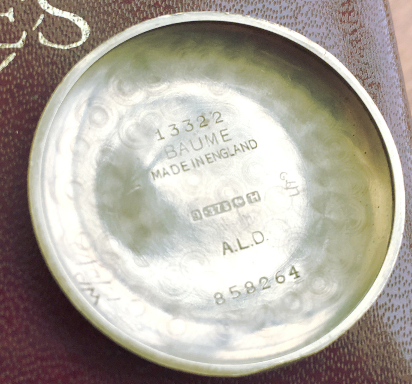

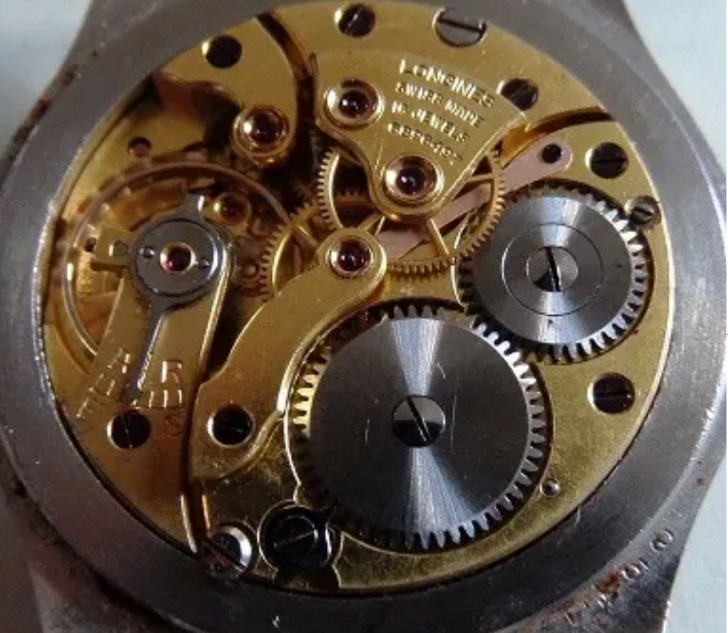

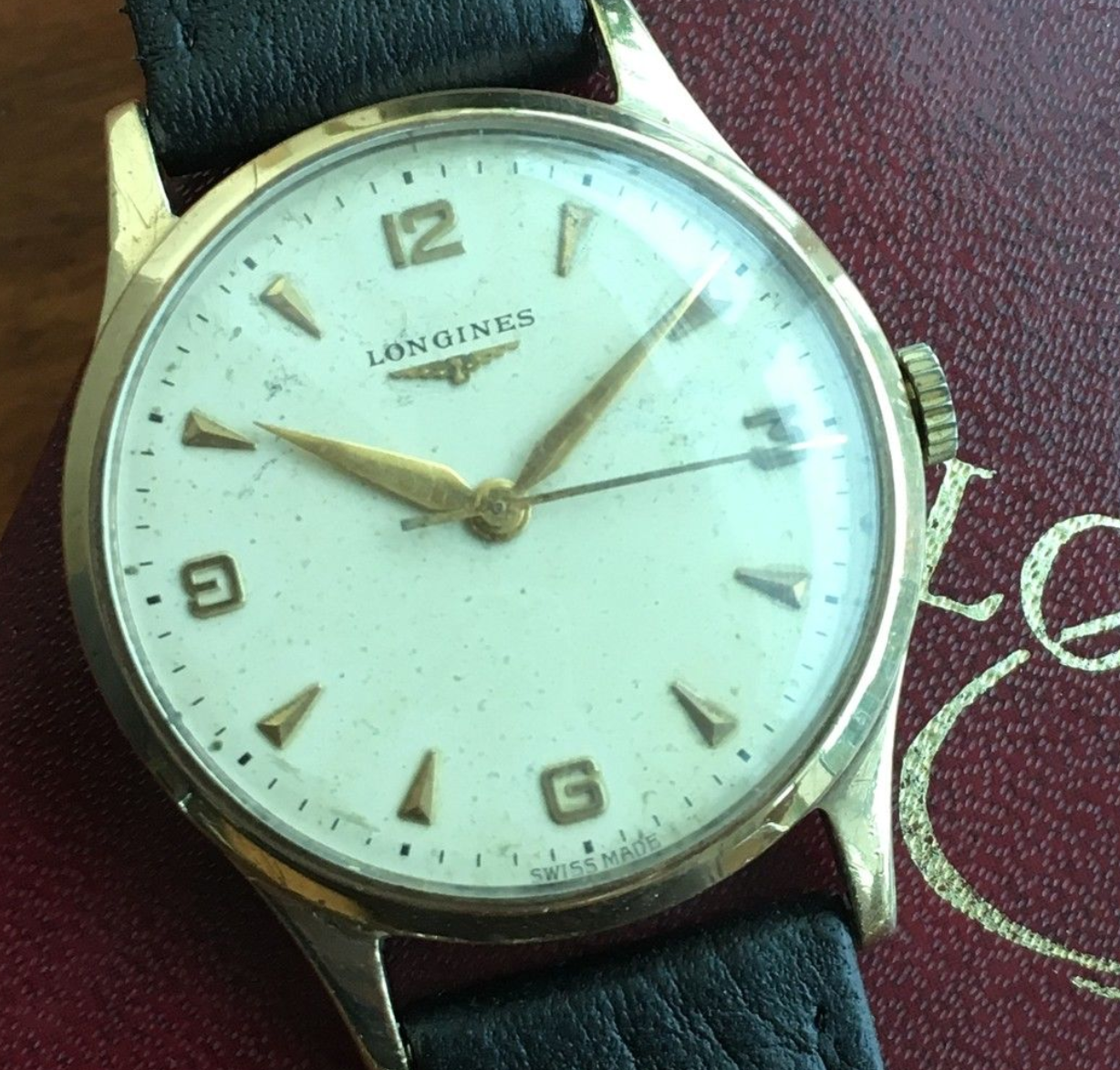

Here's the delema I was talking about. Both are in the range. Which one is the COSD?
2,597
5,666
Why isn’t that a COSD movement ? Is it a Dennison case ?
1,530
4,435
I think I owe you an apology. It does appear to have been a COSD gold watch. I guess I will have to put it in the table 😀
2,597
5,666
So I found that. Why is a 1945 movement in a 1957 case.
By the way… I went to great lengths to try and track that watch down last year !
2,597
5,666
The seller had sold it and couldn’t find a way to connect me to the buyer, as it was sold through an eBay account that he had closed down. But to be certain, it’s a real stretch to imagine this is strongly connected to the COSD. It’s surely just a surplus movement that was sold more than ten years after the COSDs to make a gold watch.
2,597
5,666
You really view this as a rare COSD watch ? There is literally no connection apart from the movement, and I think it’s most likely the movement was sold off in the 1950s and recased by a non-government business.
2,597
5,666
I will put it in the table so we have evidence of ambiguous movements.
Why is it ambiguous?
2,597
5,666
It looks like a correct movement, but was it ordered for the COSD and as you said wasn't used until 1957?
There’s no way to know. Did is start life with a radium-dial and in a tuna-can ? Was it part of a surplus stock (perhaps for planned repairs) that was never used ? Or something in between ?
