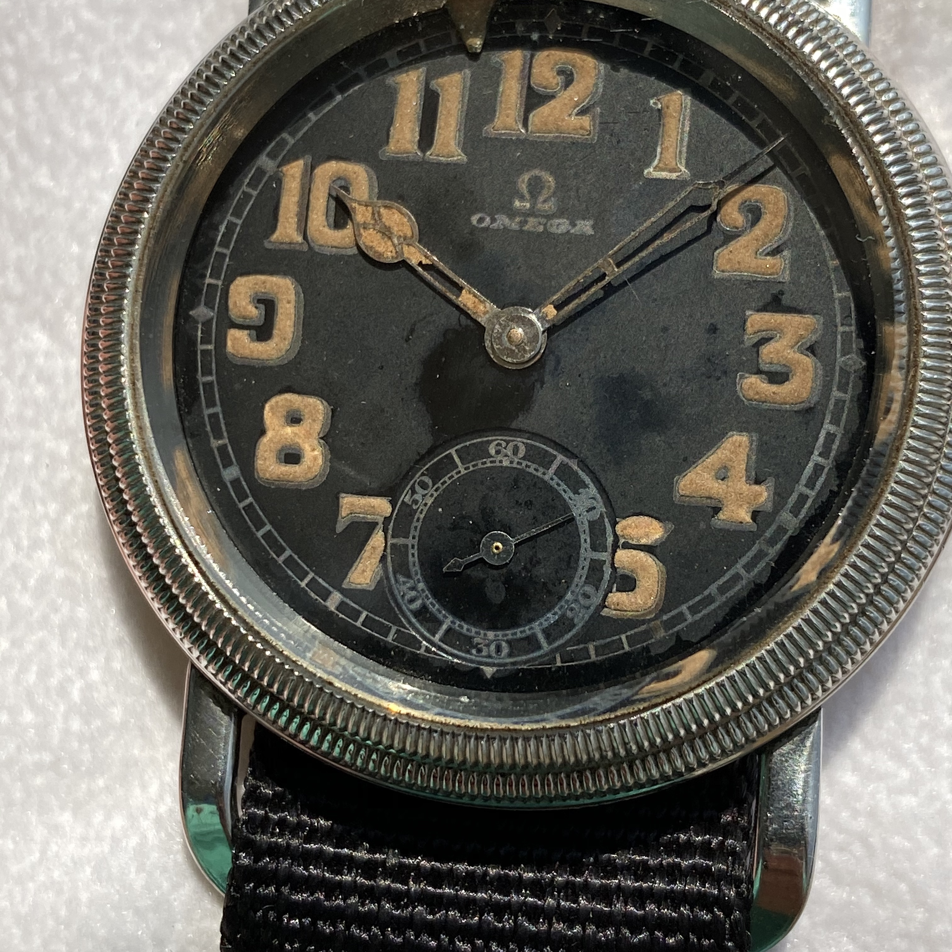

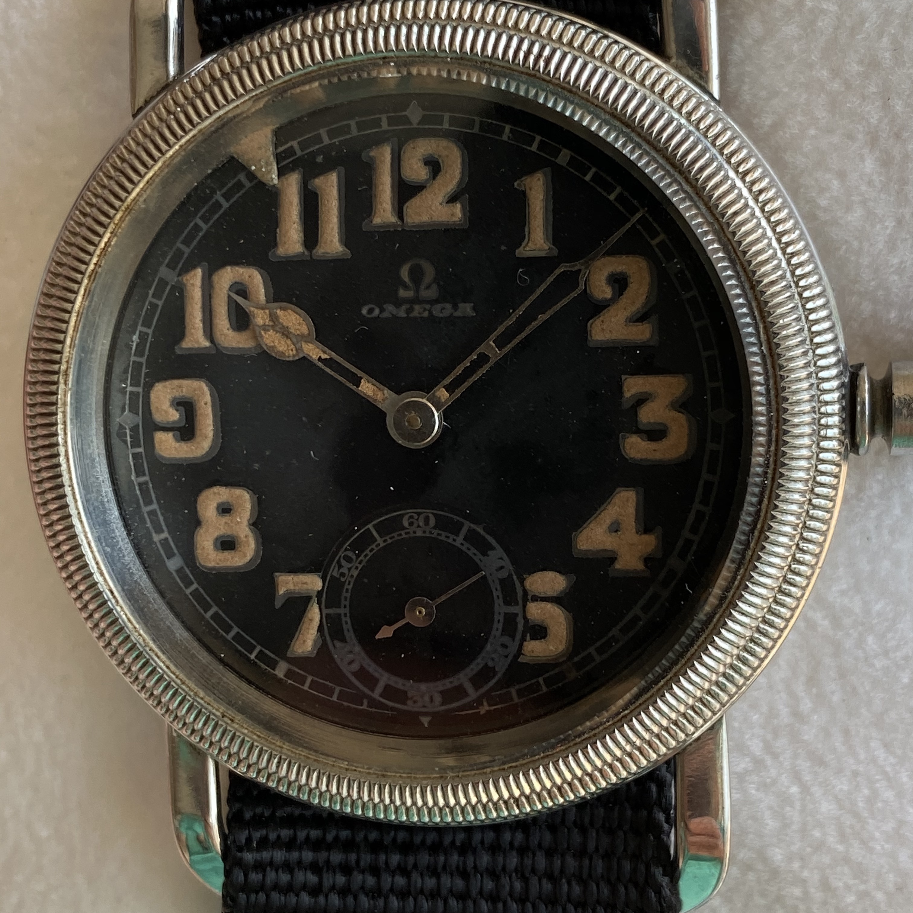

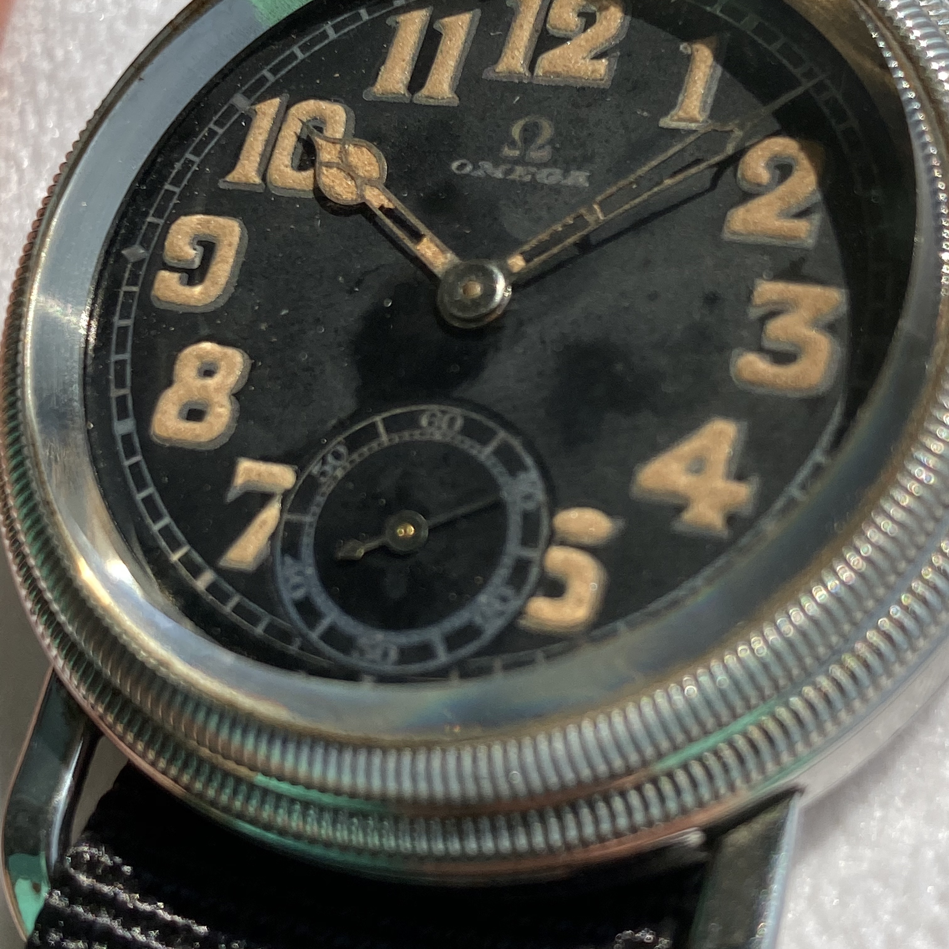

My Oomega pilot has a stain in the middle of the dial. What do you thing, it give it a historical touch o is just a stain
2,327
2,542
Looks like oil stain from a bit too much lube during a service. I wouldn't give it a second thought. It may just dry up and become invisible over time. Depending on the type of oil.
I wouldn't disturb the dial trying to clean it.

Everyone seems to be assuming that the dark patches are stained with oil - to me it looks like those patches are what the dial should look like, and the parts that are less black have something on those areas...almost powder like in appearance. If this watch came to me, I would first use the standard cleaning sticks from Bergeon to lift off any loose dirt, but otherwise would leave this alone.
Cheers, Al

yes Jw my reply was to confirm your thoughts on the similar techniques. I also assumed the dark patches on this dial pictured must be some sort of contaminant like oil but Al pointed out the reality. once we look closer at the pics it's clear there are also dark patches of dial within some of the numerals that match the larger dark areas on the inner portions of the dial. so it does appear the dark areas are indeed the original finish.

So the powdery coating is most likely the degeneration of the surface treatment...yikes!

Thanks. I was thinking to leave the dial apart and see if with that it dries

That was my fear. Affect the dial by trying to fix it. According to me, I could damage the color by trying to get a color that I may not notice, but surely that watch looks better with an even dial
Maybe that could help and is the simple one

I would not call that a "stain" given the age of the watch. It may actually be a part of the dial that has not aged as fast as the rest. Similar "stain" on subdial.
Thanks for that. It makes me feel better with my dial
